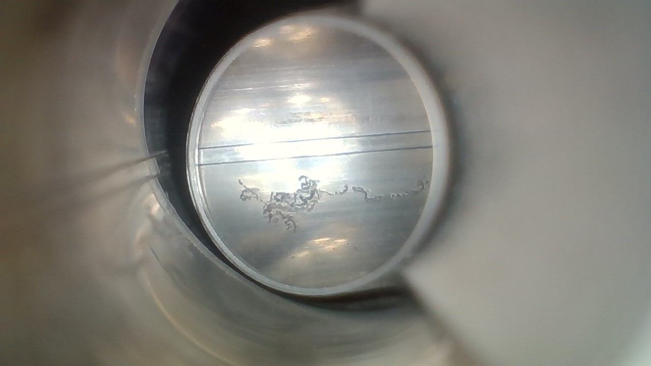

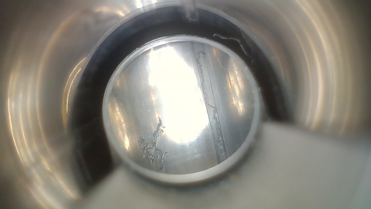

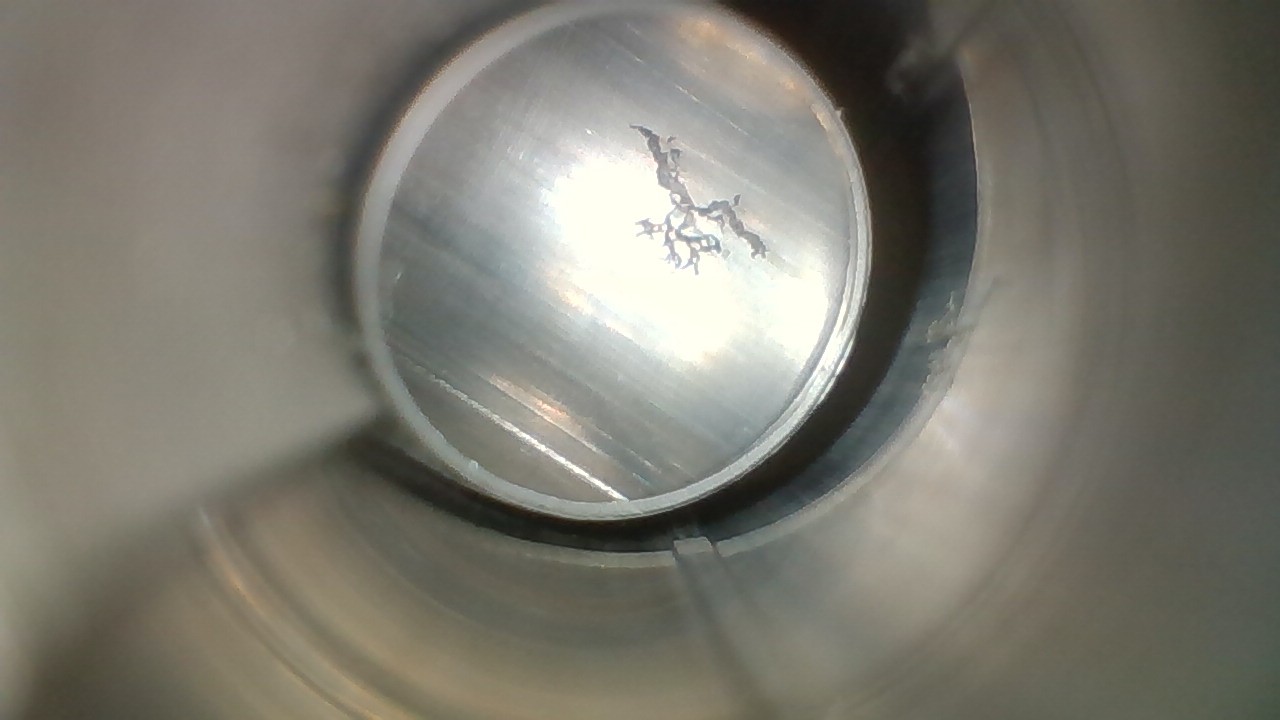

I have recently been diagnosed with the dreaded "barrel worms".
This is my 22-250 barrel. I don't scope it every time I clean it, but I keep track of every round fired by date, and every cleaning.
It happened somewhere between 218 (2/13/22) and 742 (11/14/24) rounds. Looking at my notes, it's not uncommon for it to sit dirty for several months during this time span.
View attachment 8549777View attachment 8549779View attachment 8549780View attachment 8549782
What's odd is that I scoped the rest of my 10 rifle barrels, and this is the only barrel with this issue. I even have another barrel from the exact same manufacturer that uses the same powder, and I've used a similar cleaning regimen on, and it does not have this issue.

- All of this occurs in a section of the barrel about 3" to 6" from the muzzle. There is a lot of it in that stretch, but nowhere else.
- All rifles are stored in the same safe, inside my house, in the upper-midwest, with two of those rechargeable silica dehumidifiers.
- All barrels are stainless.
- All are cleaned primarily with Boretech Eliminator. -- I've never owned that M7 or whatever stuff referred to earlier in this thread.
- All rifles are shot suppressed.

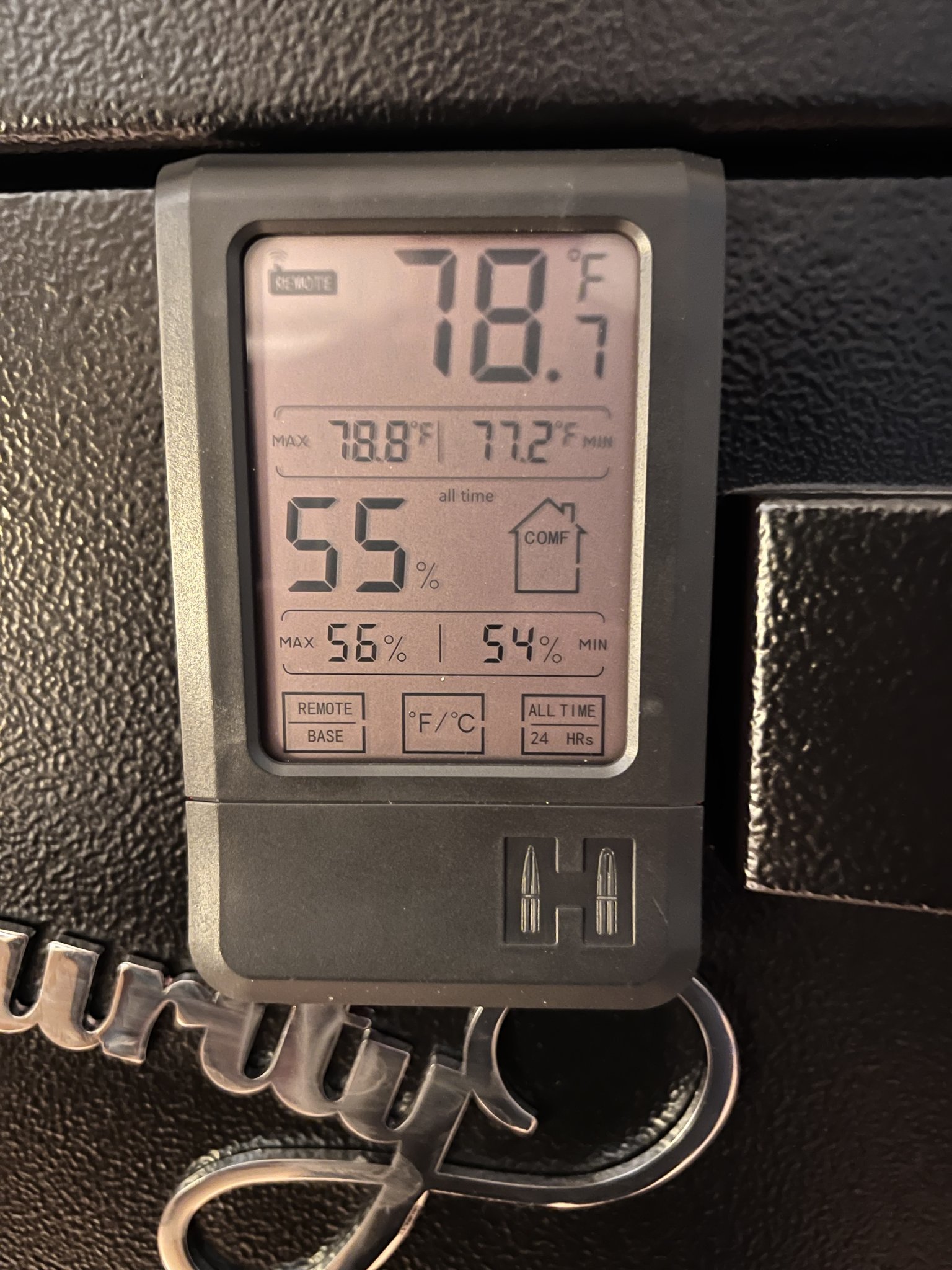

Now, I'll admit that my dehumidifying solution for the safe could be better. I don't stay on top of those rechargeable packs as well as I should. Maybe a plug-in style rod would be better. And obviously, I should clean them if I'm going to let them sit for a while, but I don't always know when that will be.

Considering the location of the "worms" is limited and none of my other barrels have this issue, I'm inclined to think that a defect in the steel could be a factor. However, this was not seen the 2 other times I scoped this barrel, at 0 and 218 rounds.
That's the funky part bud..... when and how it happens is kind of a mystery but that's what you have.... barrel worms!
Put the gun away dirty for X amount of time.... pitting/etching will occur even in SS barrels. Conditions the gun is stored in and type of powder used etc... are the big variables it seems. Moisture in the air reacts with the powder fouling is what does it.
Also I feel some solvents.... a guy doesn't get the barrel all the way clean.... and the solvent is left in the barrel and pools in spots.... and bingo.... etching/pitting/barrel worm BS shows up.
A couple of years ago... had a guy with a 223 bolt gun. Shot it suppressed for like 700 rounds. Put it away dirty for X amount of time... he got lucky... when he went to clean it and took the muzzle attachment off... the whole face of his muzzles crown was all pitted but nothing happened to the bore at all and the gun still shot great afterwards but can't explain how nothing happened inside of the bore and it was just regulated to the face of the muzzle crown.
I'd get some JB Bore Compound and or Rem. 40x cleaner on a patch only and run the cleaning rod and patch up and down the bore 10x. Clean it out and look at it again and see if you got it all or most of it out. Then shoot it and see how it shoots. Might get lucky and it will be o.k.
Other times.... the barrel doesn't come back and doesn't shoot anymore. I'd say a 50/50 chance on it.

That said four years ago I bought the one made by Hornady, It's the two piece deal - battery powered. I use rechargeable AAA.s Works great It has a magnetic display that sicks on the outside of the safe and a separate sensor inside. On sale now for 26 bucks. They make a less expensive one but it's one piece and sits inside the safe. Mine, I don't need to open the safe, just look at the display panel. Here's the link: Hornady Hygrometer
Finally, just keep shooting and cleaning it or hit that section with Iosso. I use it on all my firearms no later that 300 rounds and never had an issue. Read the instructions!
Hey! I’m down with that! Thanks man
NP! I use one large rechargeable bead dehumidifier and it works well as the Hornady hygrometer says. Picture below, stays in the fifties % humidity no matter the weather. Pics was just now:

Powder type and cleaning agents are still suspects, but no arrests have been made.
My takeaways: Clean more often and leave a thin layer of some type of corrosion inhibitor in the bore.
Update:
I cleaned the affected barrel using JB Bore compound the way @Baron23 detailed in post 159 above. After shooting about 10 rounds to settle it back in, I shot these two groups (scope adjustment in between).
Still very much 'minute of prairie dog'.
I don't think the dreaded "barrel worms" is necessarily a death sentence, but I am going to be more mindful of cleaning and storage. Currently the golden rod has my safe running about 40% humidity.
