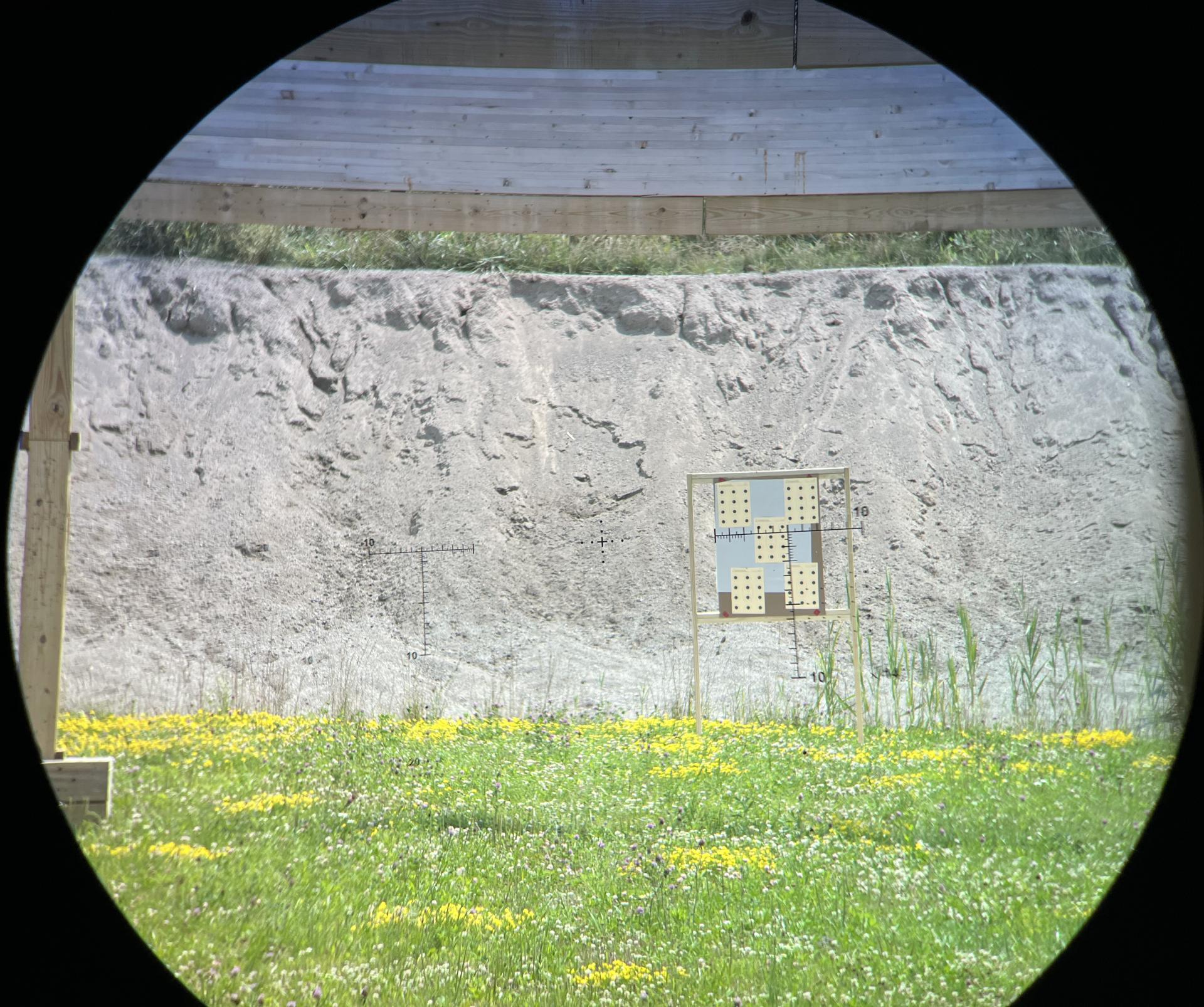

First off, I took it to the range and used it as a spotter in conjunction with the screw on range extenders. In this configuration, the 10x set that I am using are 14x. The resolution, magnification, and etched reticle were quite sufficient to be used as a spotting scope. Acting as a spotting scope for zeroing will by no means be the strength of these binos. I expect most will be far more interested in spotting misses and trace at distance. I think it is still important to note that the binos did function in this role though and hunters using low power scopes can use these binos to zero their rifle at 100 without having to walk out to the target to check the impacts.
Also, take note that unlike some of the other previous through the lens photos, this one doesn't appear to have a blue tint. Go figure, it was a super bright sunny day just like the previous squirrel photo and both were south facing. Anyhow, it is looking like usually the user won't notice a tint but in some conditions it becomes more apparent and sometimes a camera makes it even more apparent.

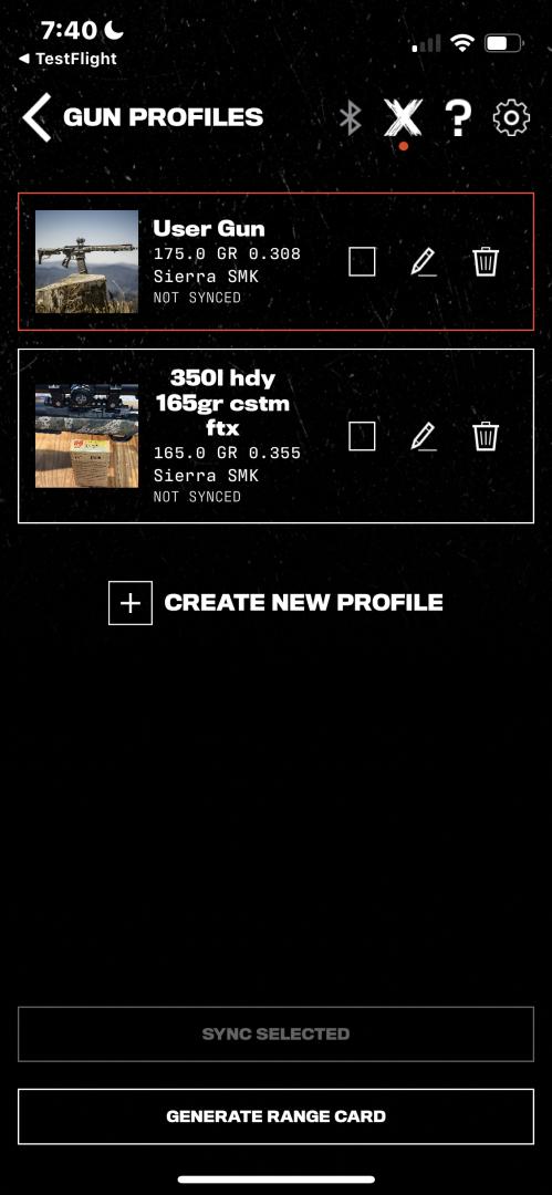

1) The ballistic profiles screen lets you load in screen shots for a profile. I know there is not a lot of function to this but I really enjoyed the feature and it looks real nice. BTW, you can E-mail yourself one of the range cards to print out and put in the clear pouch of your rangefinder case as a backup. Others also do this but it's still worth a mention.

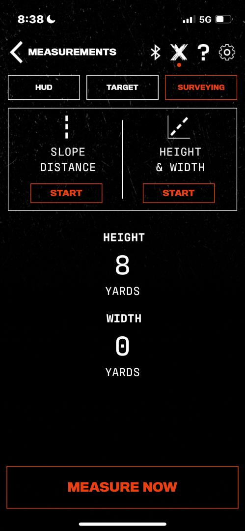

2) A survey function exists for calculation dimensions of buildings and such by ranging different points. This was certainly fun to play with. It will be interesting to see how accurate it is as it utilizes the binos internal compass and inclinometer and neither of those instruments has to be tremendously accurate for ballistic purposes.

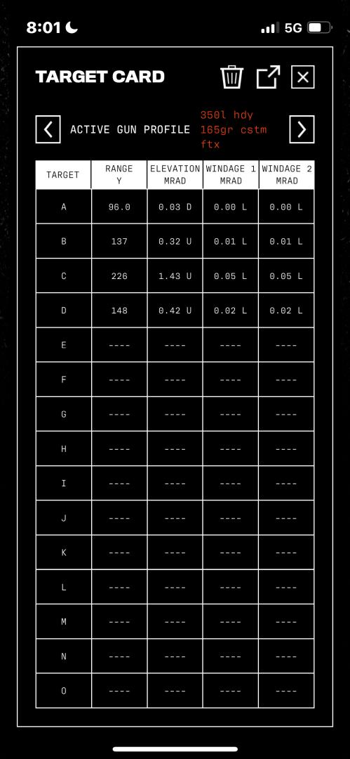

3) The target card feature in the Vectronix software struck me as a particularly good implementation with intuitive population of the ranges using the rangefinder. I will be interested to see if its windage values update in real time with the Calypso connected and if those updates take into account the different directions to the different targets and how the wind interacts with that.

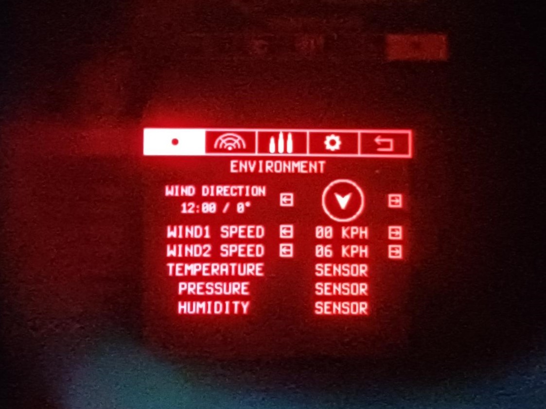

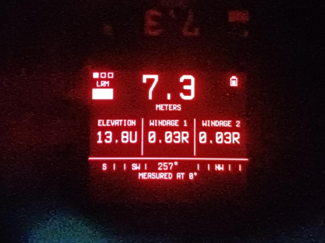

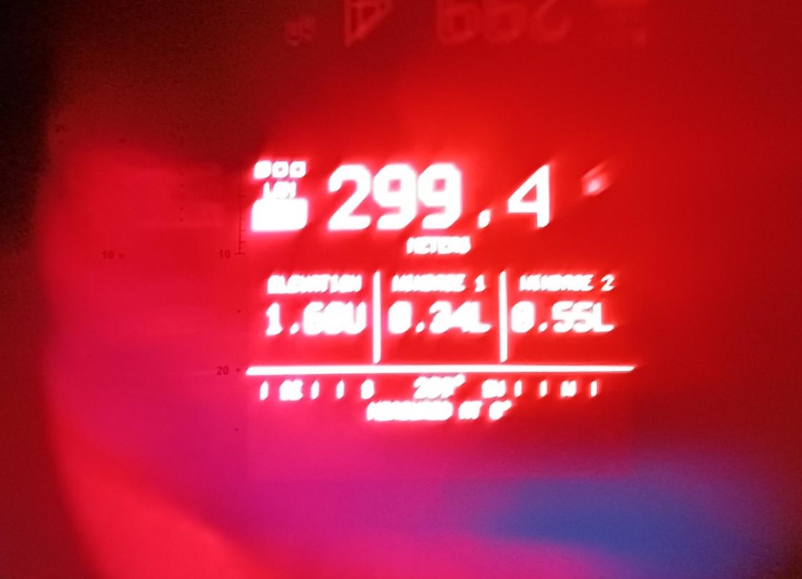

I went back and played around with the kestrel/bino's this morning. I managed to get them paired.
First up, i thought they broke. It changed all my brightness settings to Night Vision 2.... I couldn't see the display. So that's the hiccup.
It appears at this stage that information sharing is one way only, as in the bino's will send the lased range data to the kestrel, but the kestrel won't send data back to the binos. This is supported by the fact the bino's have no search/pair function. Just bluetooth on and off. All pairing is done by the device pairing to the bino's. So if the device you want to add doesn't have this function itself, then it's highly suggestive that device won't be compatible.
The HUD displays "KSTL" noting that the kestrel is connected, but in the Environmental Screen displays "sensor" in the bino's (however manual in the app). So information on environmentals isn't being shared to the Binos from the Kestrel.
Additionally, it's blowing an absolute gale here. The Kestrel is about to take off the fan is spinning so hard.... Bino's think it's paradise. It states 6kph because I manually input it and forget to zero it.

So you saying there’s no option to toggle the environmental on board sensors to the Kestrel?
Correct;
In the device it says "sensor" but you can't flick those over to any other option.
On the app it says Manual or Internet for options when the Kestrel is connected and adds "LRF" for when the kestrel is disconnected.
So the Calypso AB will send environmentals to the Vector X and the Vector X will calculate & display a solution on the HUD ... but a Kestrel won't send environmentals to the Vector X & the solution will only display on the Kestrel?
Surely I've misread something?

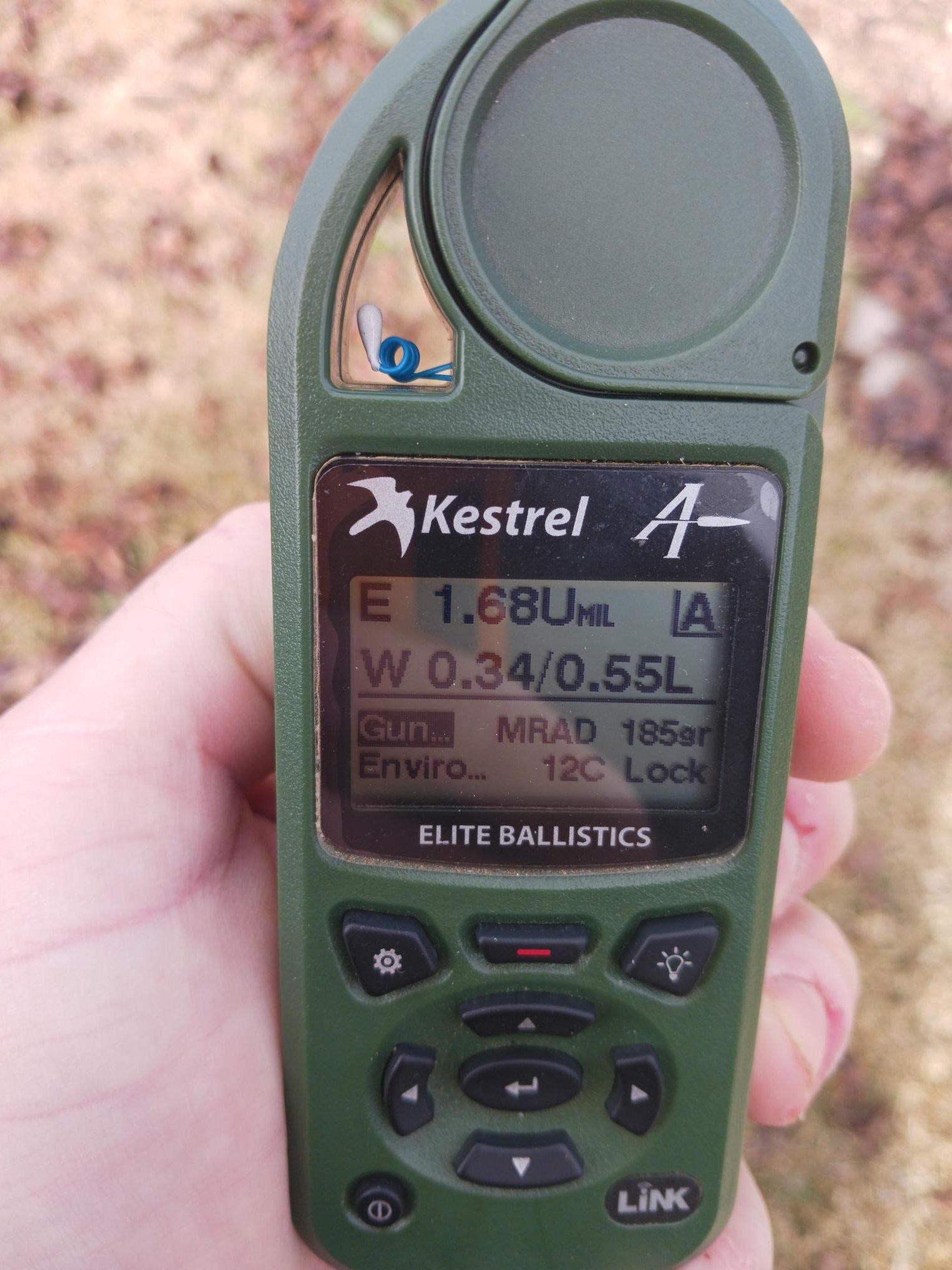

Ok, we left the bino's on a tripod outside (it's just dropped to 3°C), and then sat in the car with the Kestrel with the heaters on.
The app says input in the bino's is "manual" and doesn't indicate the Kestrel is providing data to the Bino's.
In the Bino's menu, it says "sensor" and this can't be changed - so who's sensor is it using?
It's using the Kestrel.
The only way we can ascertain this is to look at our elevation data. The FGMM 185gr Ammo has a MV Temp shift of 2.8fps per °C. It's 3° in the wind and 32°C in the car. There would be a huge disparity in our drop if the 2 devices weren't talking to each other.
The Kestrel Hold = the Bino's Hold. The only way that would be is if the Kestrel was providing the environmental data to the Bino's. So with the Kestrel synced, the Bino's transmit Range, the Kestrel provides environmental data and wind.
One other thing we noticed. If you have input info manually on the bino's (Temp in this case) and then connect the Kestrel. It won't update temp. You have to disconnect the Kestrel, connect the app, set the environmentals to LRF (sensor), then reconnect the Kestrel.
Reactions: R_A_W
Sorry the info is a little disjointed and going backwards and forwards. Our priority was using the Bino's as they come so we didn't dedicate much time to playing with other devices. Thanks for the check in and the questions @J_D
Reactions: DRWilson

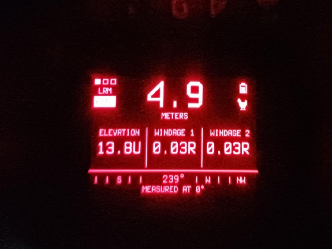

Ok, we spent all day using the binos. This is our observation on connecting a secondary device via Bluetooth;
With the app open on your mobile phone, the app takes precedence. Connecting the kestrel to the bino's wont occur. You must close the app to connect the Kestrel.
Once the Kestrel is connected, you can't change any settings in the App without disconnecting the Kestrel first.
Once the Kestrel is connected, it states KSTRL in the HUD, but nothing else, in the App or in the Bino's, is suggestive of the Kestrel providing information.
Prior to Kestrel connection, all fields in the App for environmentals MUST read LRF (sensor). Anything that doesn't will no be updated by the Kestrel.
The information labels don't change from "sensor" in the Bino's to indicate the Kestrel is providing the data. It was only through trial that we discovered it was.
The App, when the Kestrel is connected, reads "manual" for data input, again giving the impression the Kestrel isn't working.
There's some kinks here that don't intuitively provide information regards what is connected and how the data is being collected.
However;
With the App set to "sensor" for input types, turn on the Kestrel, and it's all working as it should. Range a target and you'll get distance and direction data to your Kestrel.
Environmental data collected by Kestrel is shared with the Bino's.
However (again);
Change the range manually in the Kestrel, and that information isn't sent to the Bino's. The Bino's will take on info from the Kestrel based on the environment, the Kestrel will take on range data.
So there you go. That's how connectivity works with the Kestrel and the Vector X - It's not very refined, but it does 100% work.

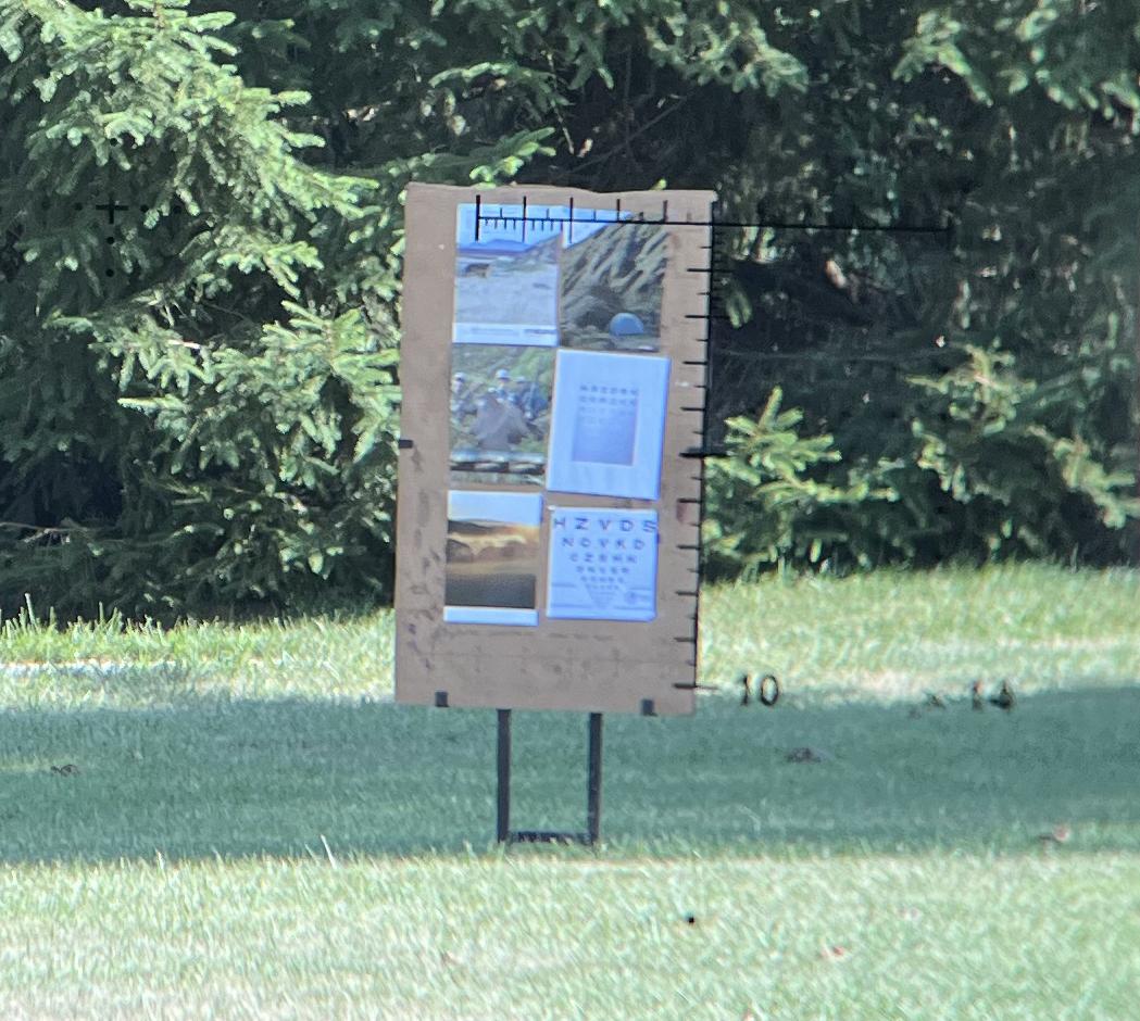

I have been spending some time the past few weeks doing optical evaluations of laser rangefinders. I mentioned in my earlier impressions that I thought the Vectronix Vector X was quite good optically. My further testing has certainly born this out. I actually found them to edge out the excellent Leica Geovid Pro’s in resolution. They also have a bit more field of view in comparable models. That is pretty impressive stuff. I frankly didn’t expect those results. I will get more detailed in the full review but suffice it to say that the Vector X’s are top tier in optical performance in laser rangefinding binos.
Furthermore, I have now done some systematic optical testing on the “Range Enhancers”. That name is so bad I can never remember it and it annoys me when I have to look it up every time. They don’t meaningfully increase the range of the binoculars and that isn’t their function anyway. I’m not even sure what enhanced range would mean as enhanced doesn’t generally mean more, but instead better and I’m totally unclear on what better would mean in that context. Vectronix should call them magnification boosters or something, anything, else. Anyhow, I didn’t note any detectable degradation in either resolution or edge-to-edge performance with them on. I was quite pleased with this as the idea of having the ability to morph the Vector X binos into a spotting scope replacement role is a huge added feature. I will mention here as well that the etched reticle in the Vector X binos tested accurate with less than 1% deviation on both 10x and with the mag boosters at 14x.
Testing the Vectronix Vector X milling grid accuracy and optical performance on my calibrated test target.
