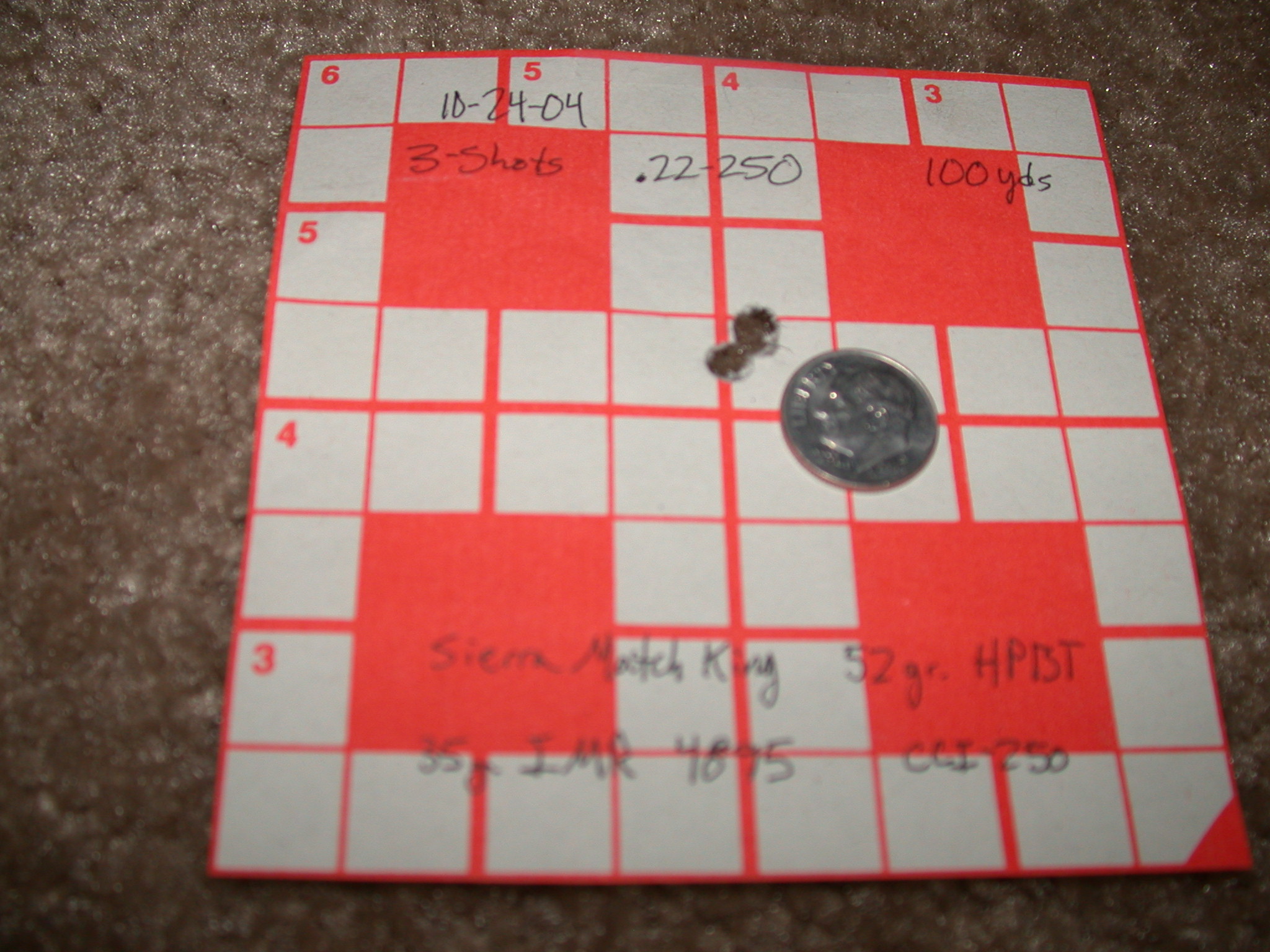

I have a Remington 700 VLS in .22-250. I purchased it back in the mid 90s. Since then I've put a KRG Whiskey 3 chassis, Timney Calvin Elite trigger and Vortex PST Viper 5-25X Gen II scope on it.
The rifle has taken a lot of groundhogs. The only problem is that the barrel twist is the 1:12. Which is too slow for heavier bullets. The maximum effective range that I've been able to shoot is 600 yards. Beyond that it's a matter of extreme luck if I hit a groundhog.
Right now, I have several thousand rounds loaded with 55 grain bullets. After those are all shot, I plan on putting a barrel with a twist of 1:9 to shoot heavier bullets.
Bergara is producing a rifle in .22-250 with the 1:9 twist. So there must be something to it or else a company like them wouldn't be making a rifle with fast twist rifling.
The advantage to a fast twist barrel in .22 caliber is obvious to all of us. The only problem you will have with a fast twist barrel is shooting the traditional light weight bullets. I don't plan on doing that as barrel life would be pretty short.
If I were you, I would re-barrel the rifle with a fast twist barrel and shoot the heavier bullets.
