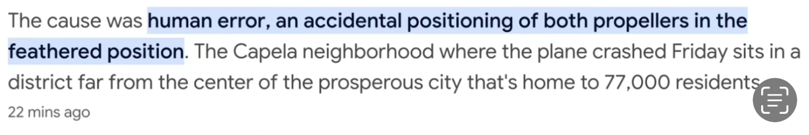

I'm curious about the previous post that says both props were feathered. It has no citation, and that information came out VERY soon after the accident - too soon to trust whether it's true or not (I'm not saying it isn't true, but neither am I willing to accept it at face value just yet).
Reactions: BurtG and Cody S
I remember in the 90s (I think, maybe early 2000s?) the ATRs were having icing problems. They used boots instead of bleed air, the boots were too small, and the pilots sometimes operated the boots too often, creating an ice bridge that the boots couldn't clear. As I recall, they actually flew ATRs behind a C-130 spraying water on the plane in freezing temps to study the problem. I believe they changed the design of the boots, and the procedures for deployment as a result of that study, and I haven't heard of another ATR icing accident since, but yeah - they at least have a history of icing problems.

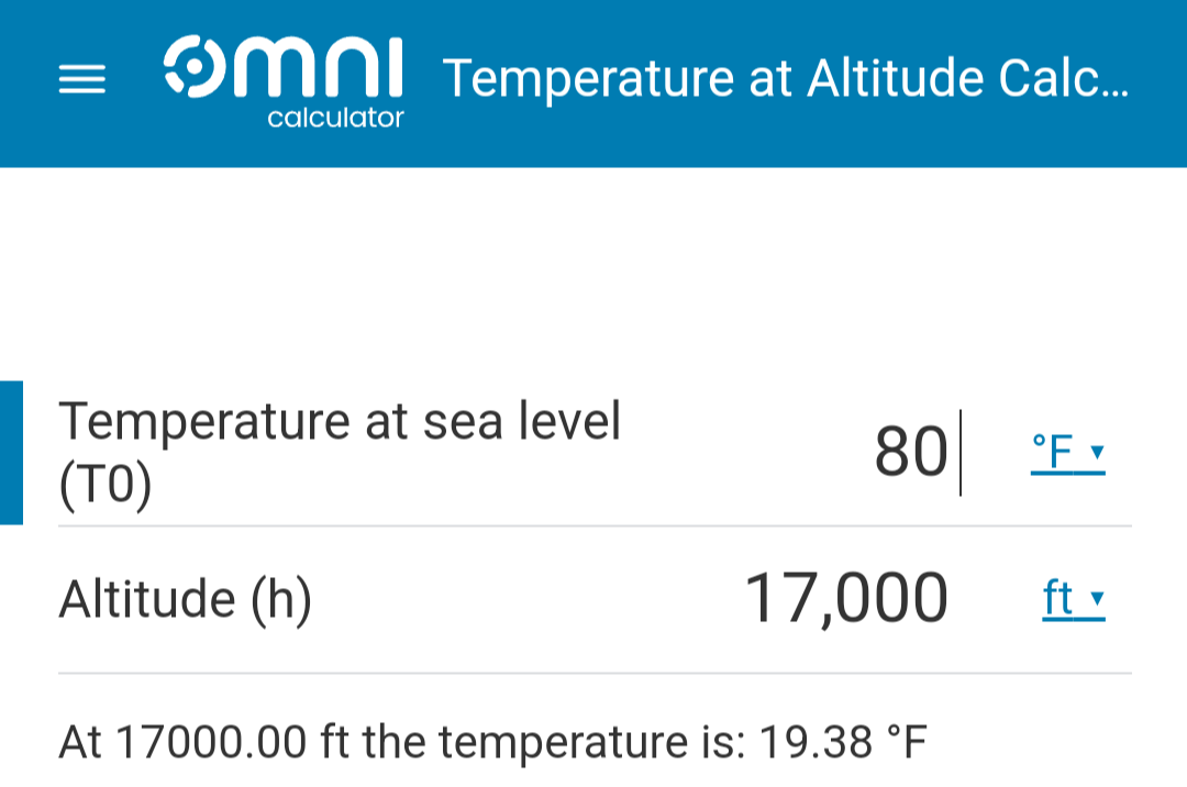

I always take "severe" reports of anything with a grain of salt until I hear what reported it...
"severe" in a king air might be moderate in a 737+ size aircraft...
If an Airbus or Boeing reports something as severe, ill take heed.
