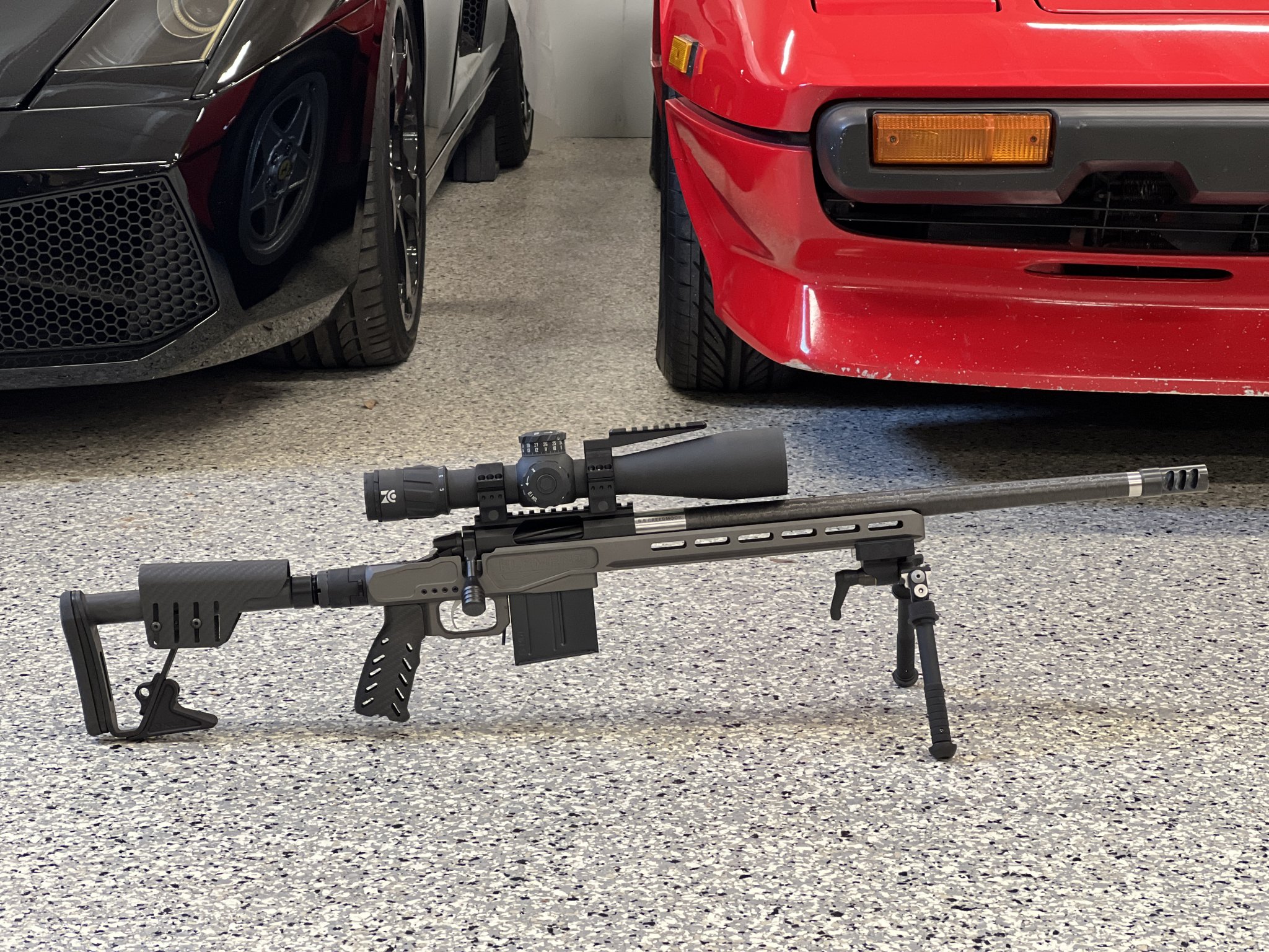

I'm in the same boat and had this debate internally, since I was only able to buy one recently I went back and forth between the ZC420 and ZC527 for a NRL Hunter(ish) type build. I think in the future it will wear a ZC420 once I build more of a ELR type setup and move my ZC527 there.
Even with a 20" 6.5 CM my co-worker setting it up and doing load development it was very consistent out to 1,200 yards and was getting out to 1,600 less consistently with the wind conditions last weekend.
