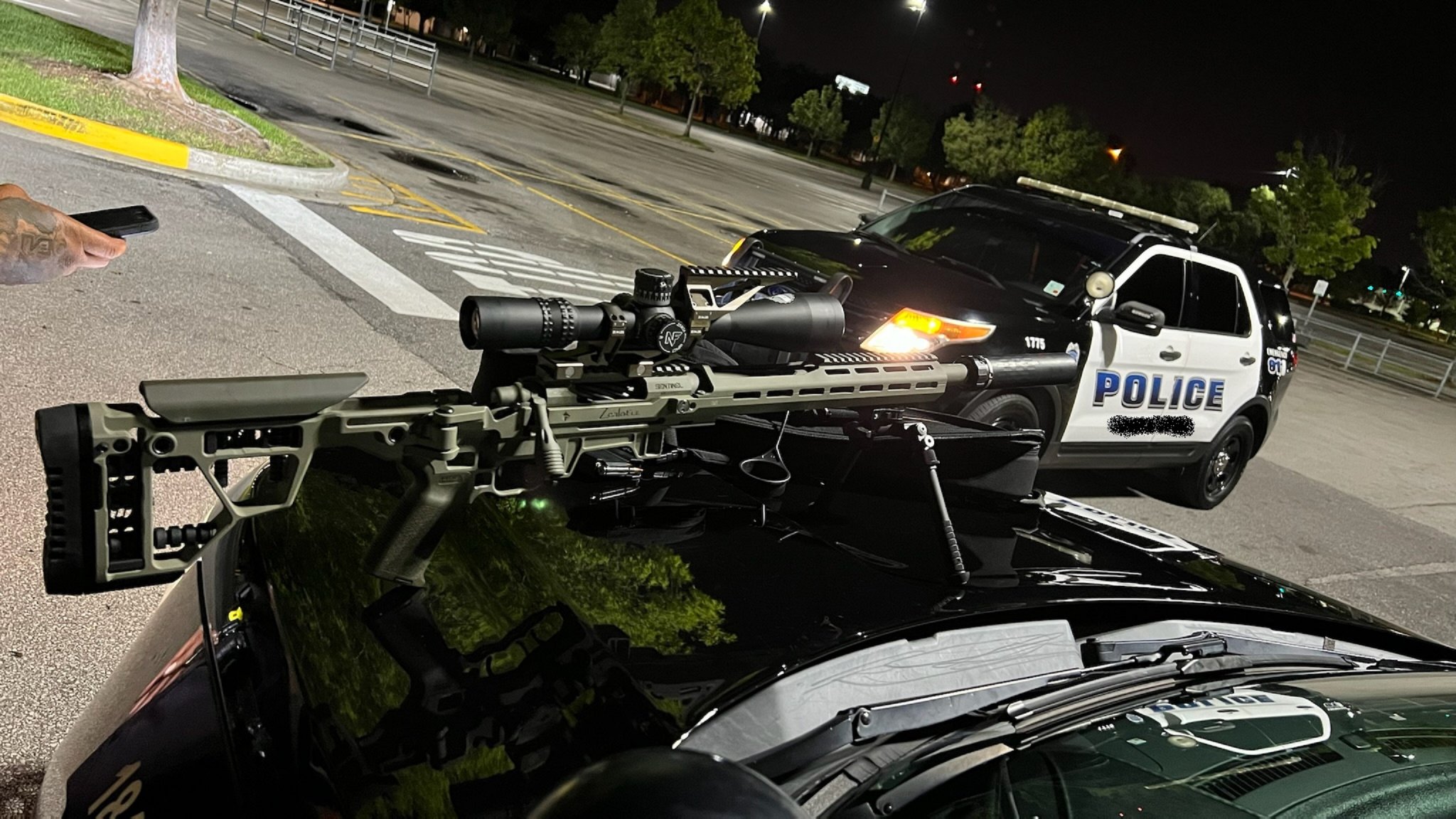

Some of the first Zealots that are operational in the wild.
Photo credit to a shift at 2AM somewhere in the U.S.

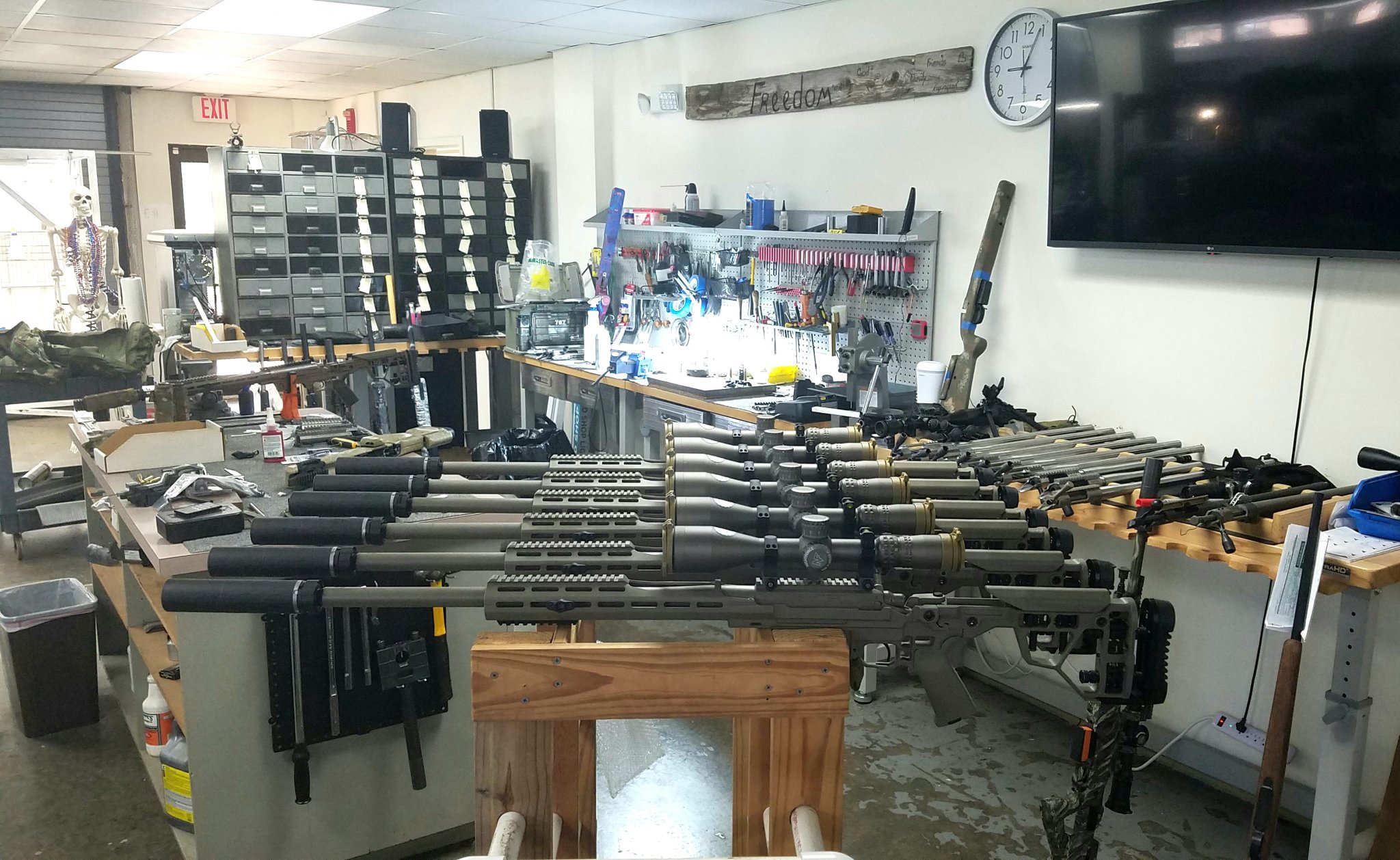

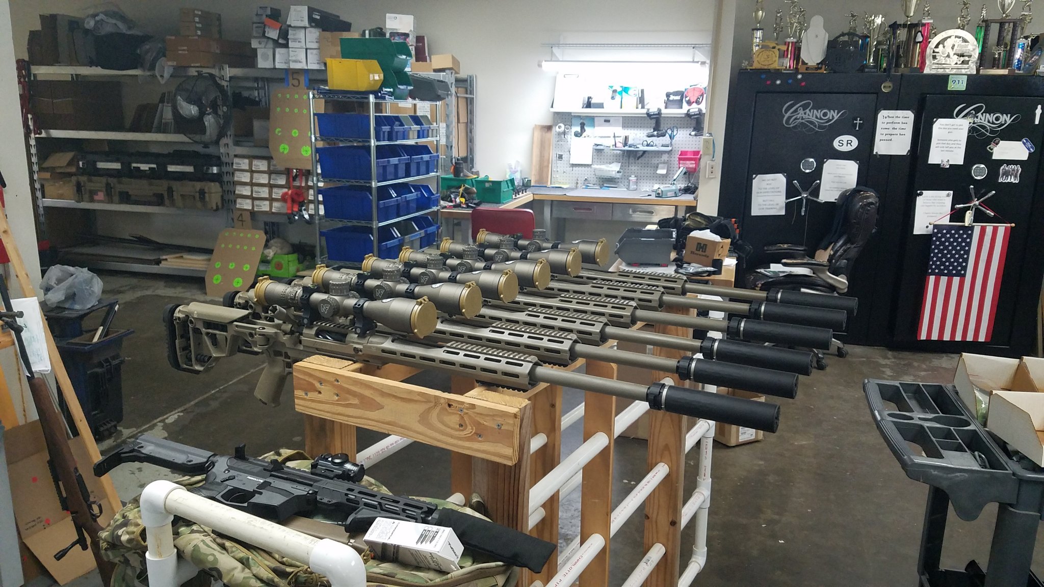

Here are a couple of crappy phone pics I snapped just now of another shipment. Just test fired and getting ready to ship.
