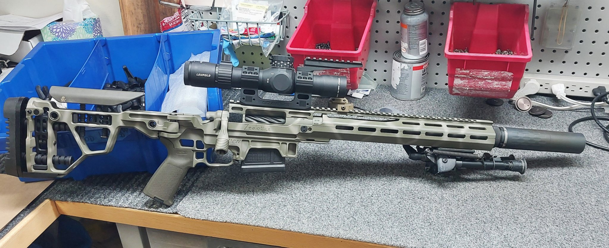

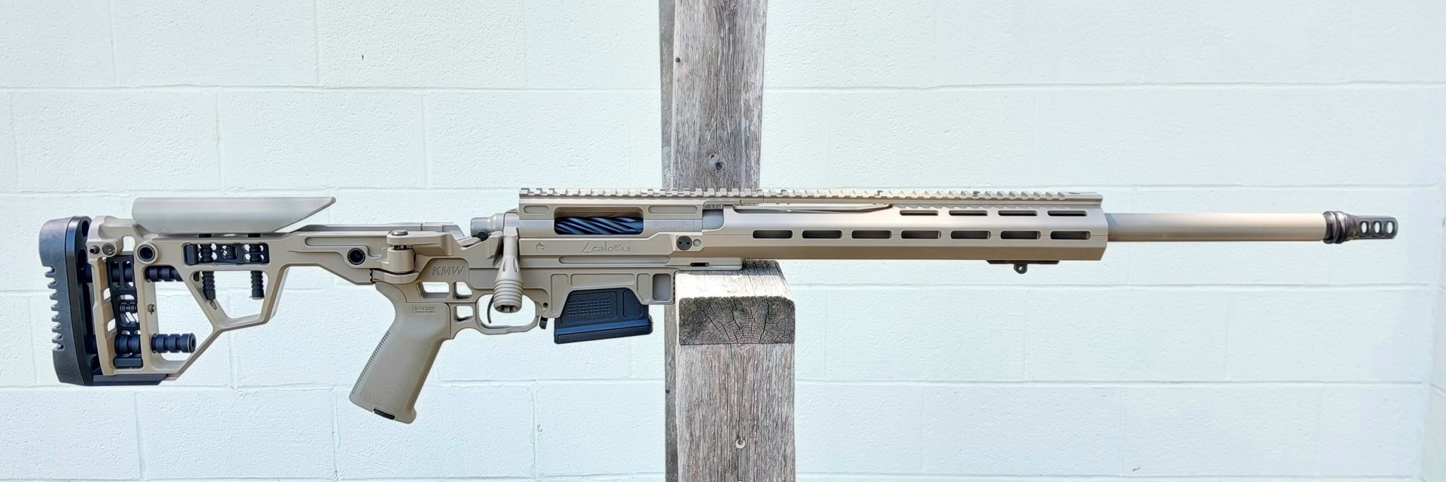

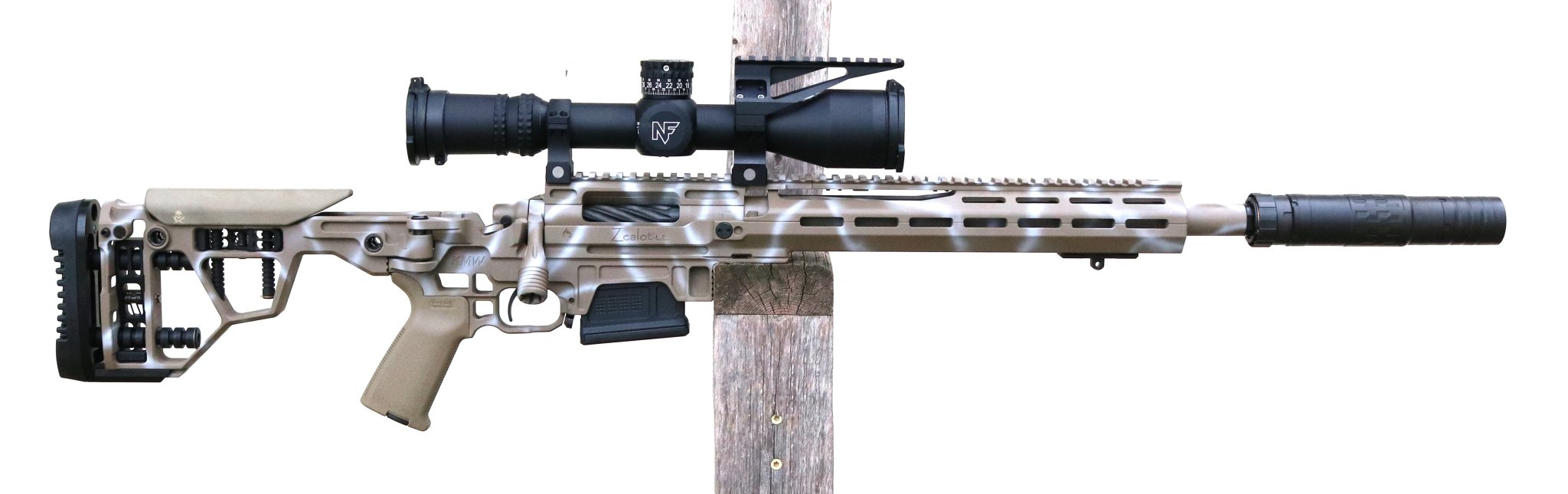

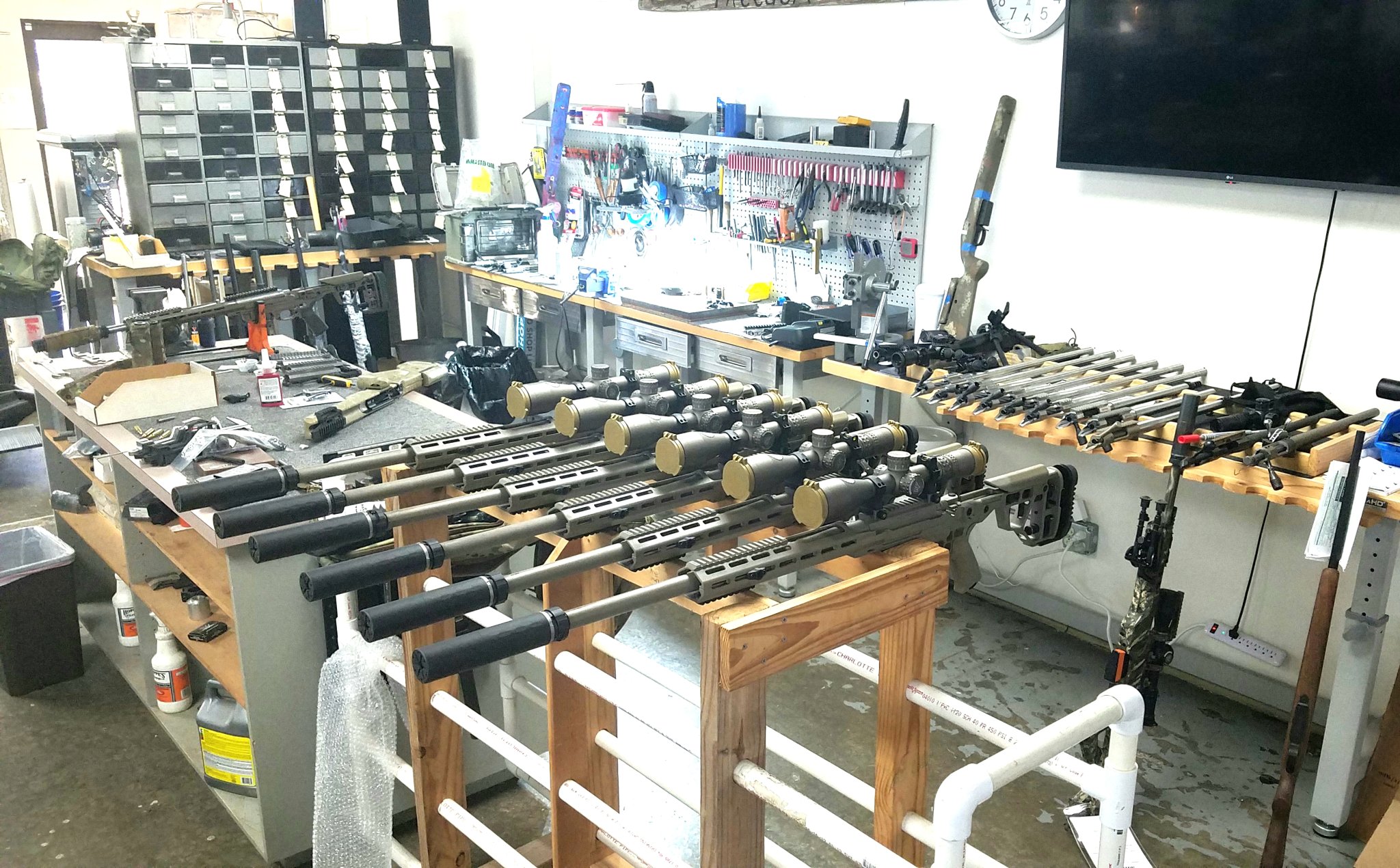

I am staying backed up with work guns going out on the Zealot so rumors of its death are greatly exaggerated. (poor attempt at a Mark Twain'ish comment.)

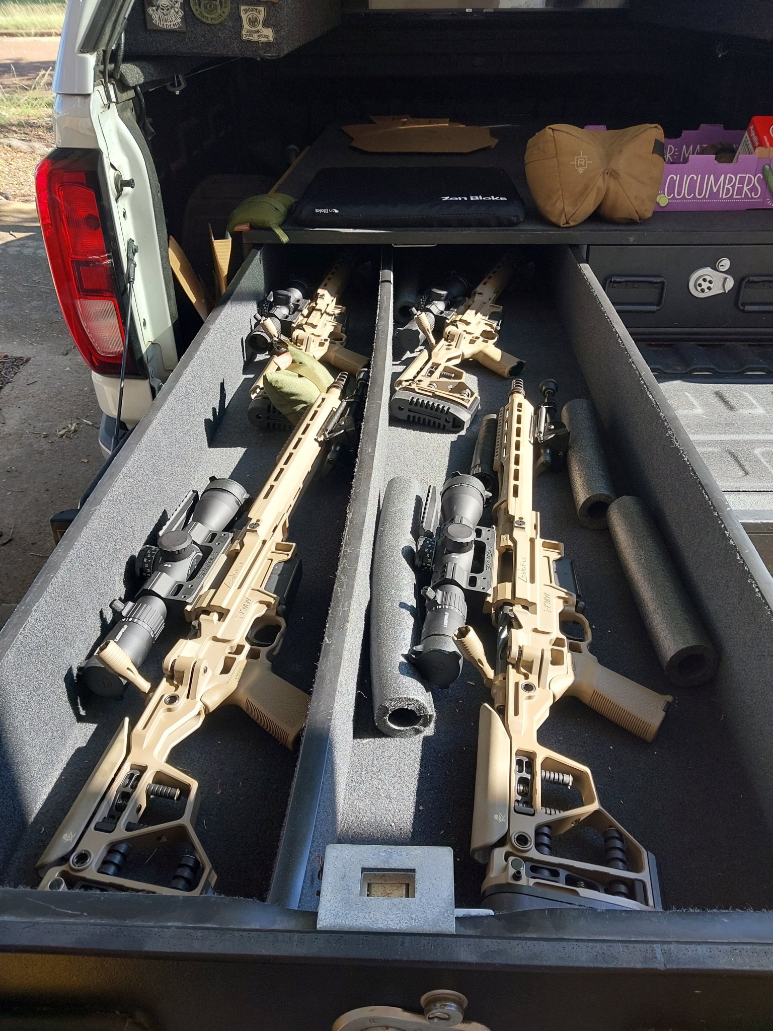

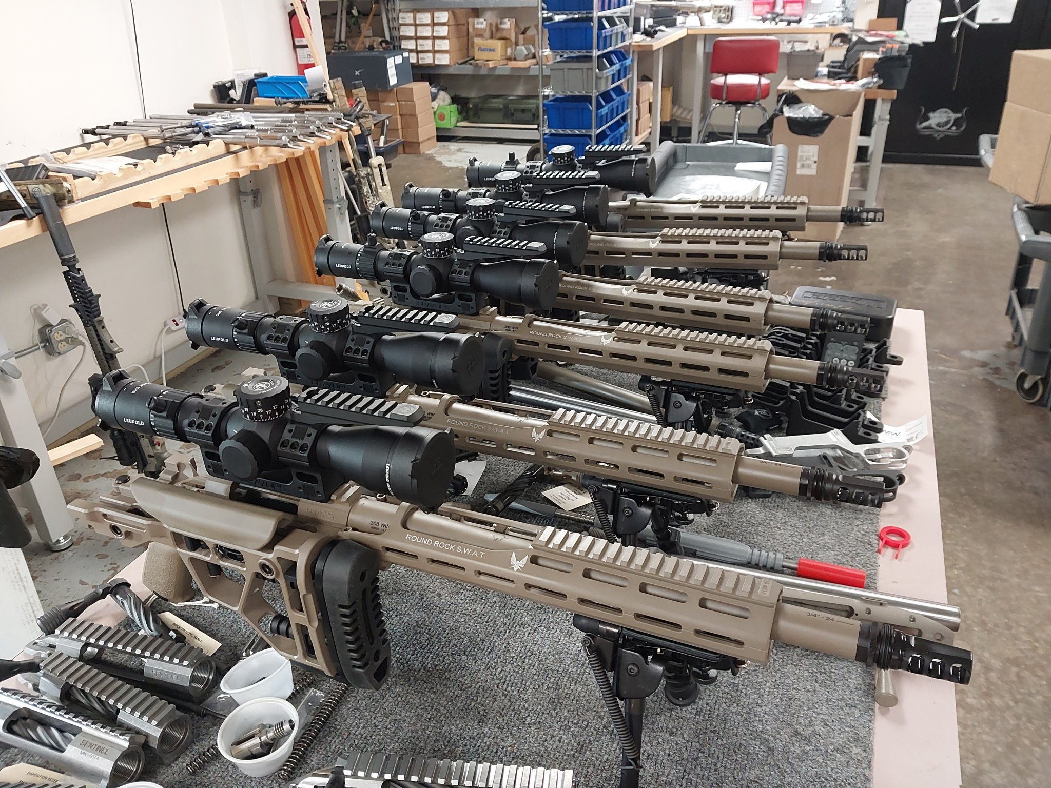

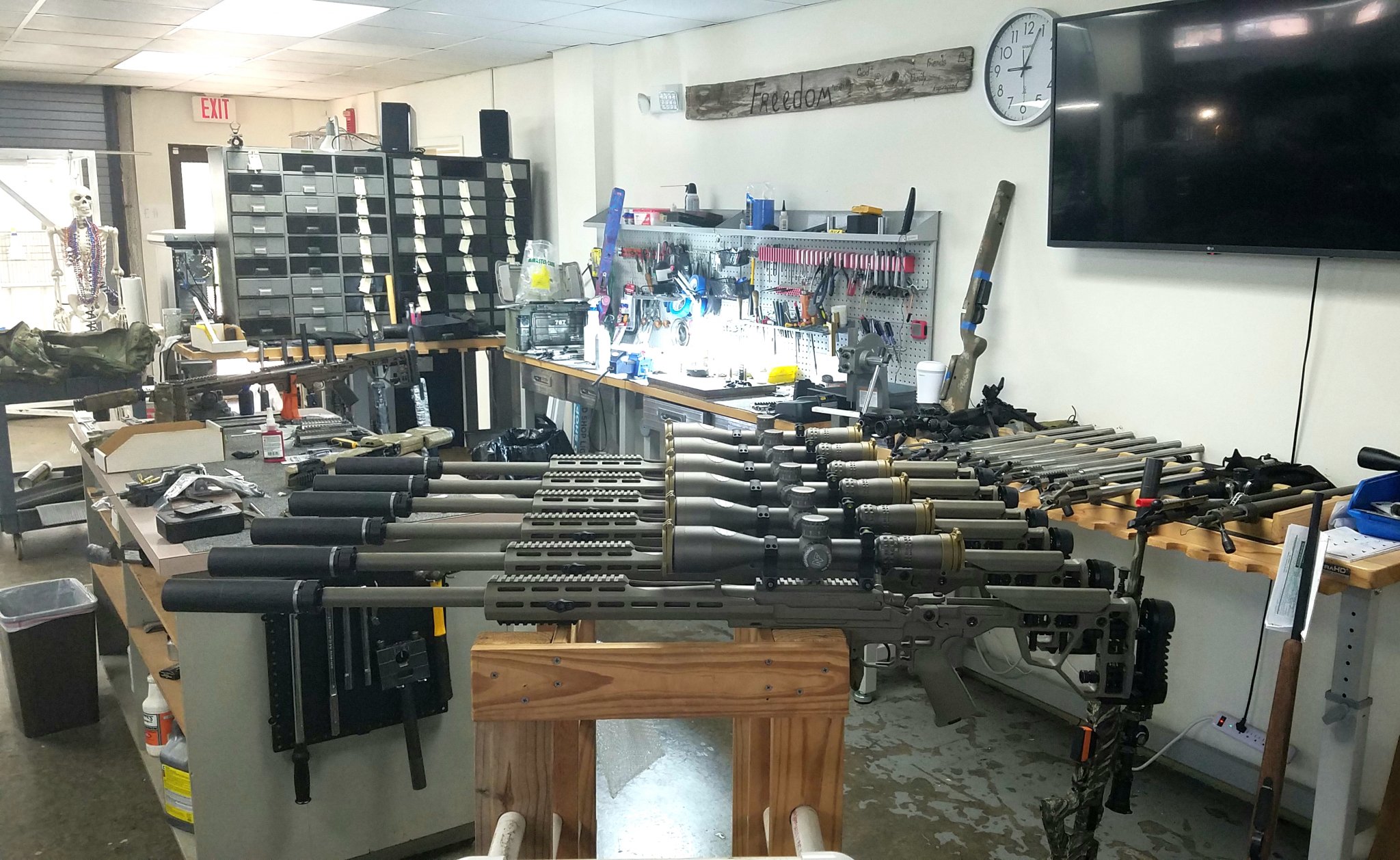

Here are a couple of crappy phone pics I snapped just now of another shipment. Just test fired and getting ready to ship.
I understand that it is in my best interest to start pushing these into the mainstream user (you) lane ASAP.
It is also in my best interest to make sure I do not ship anything out that will make the phone ring once it is received.
I can tell you that I am very happy with 99.9% of the chassis performance and all the current users are happy as well.
I will share that I am not happy with the performance of a compression spring that is in play. We are working with that right now and may do a total re-design of that one aspect before pushing the GO button to run a bunch of these for general consumption. Most would not see any issues but I want to be the worst critic compared to what I would expect if I were the customer.
I want this fixed now because I will not proceed with the Long Actions and Lefty shorts until I am happy with what might be called the Mk1 Mod1 revision of this one feature. Any future users will benefit from not being early adopters even though those early adopters are happy.

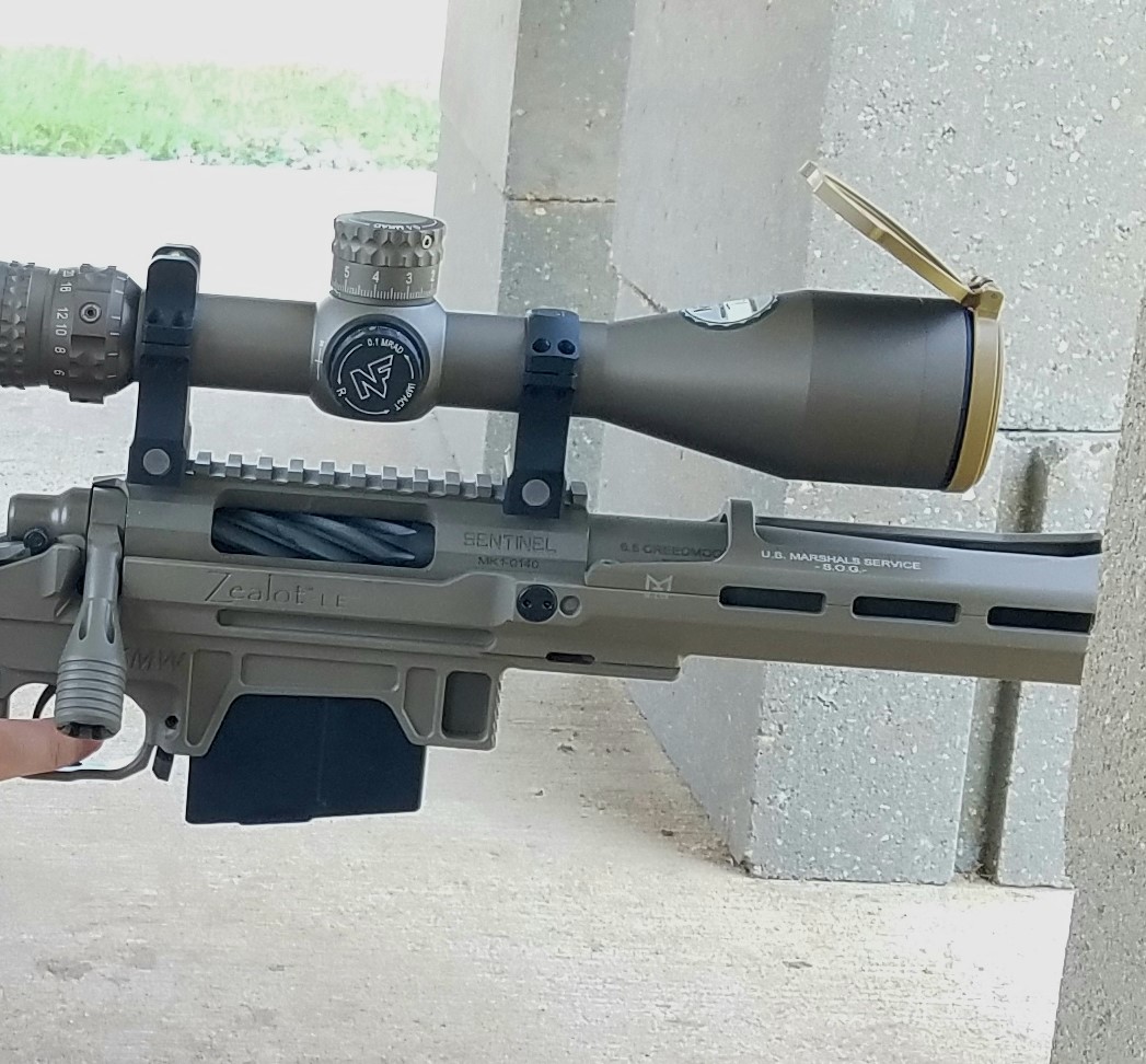

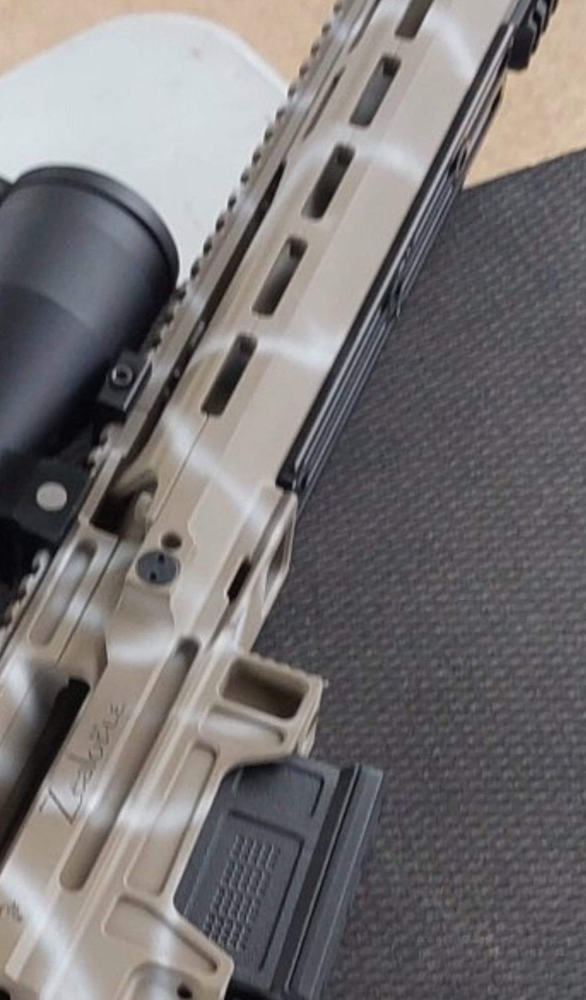

This rail an optional top section ?View attachment 8457529
Yes and No.
This iteration is only being done because I have complete control of the receiver dimensions and how they interact with the chassis. I can only do this on complete rifles because I have no clue what action a customer will want to use.
Hundreds of possible combinations of receivers with integral rails and receivers drilled and tapped for dozens of different 1913 Pic rails. And every F'ing one of them place the Pic rail at a different height above the centerline of the receiver. With that variable out there, there is no way I could offer the chassis and rail combination shown in the above picture. To do so, I would need a couple dozen SKUs with several of every possible height on the shelf knowing the possibility exists that half of them may never move.
This poor redneck capitalist isn't that rich OR brave.

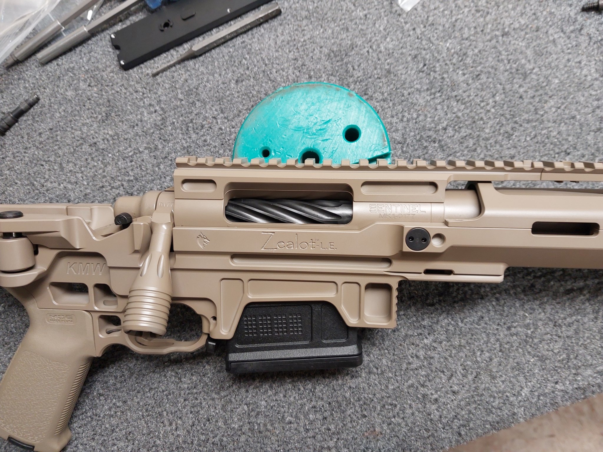

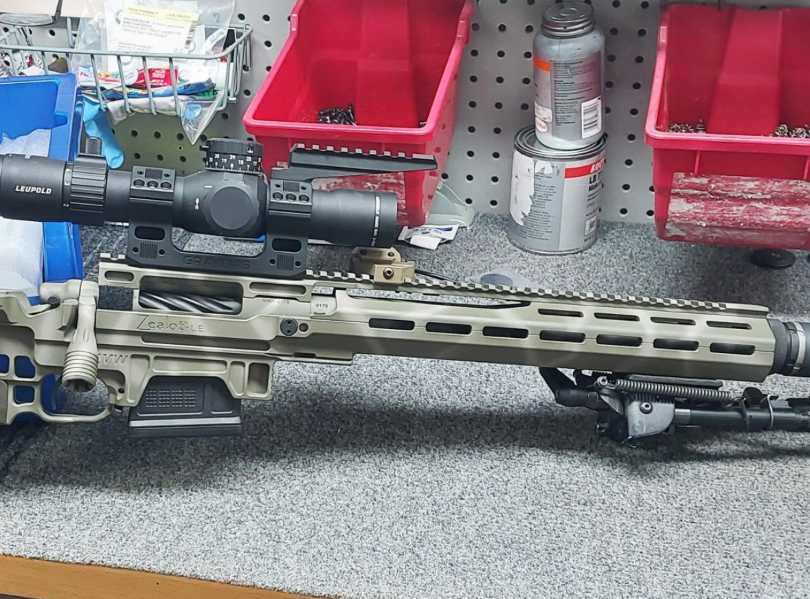

**The setup above is actually a 2 piece rail. Both pieces merge about 2" in front of the receiver. The combined pieces create one uninterrupted row of 1913 slots with 20MOA built in for the entire length. I modeled the scope base to be light weight and sculpted to my receivers but be bomb proof. The main base snaps onto two 1/8" hardened locator pins sunk into the receiver and secured with four 8-40 T-15 screws. I'm really happy with the result.
I attempted to blend the corners and flats of the receiver ejection port with the base so the user could still have a huge hole to hit with single round feeding or to reach a finger in to clear a case. Good close-up pic of that port matching is in the #2 pic in my post #318 above.
That looks real nice.
Reactions: Terry Cross

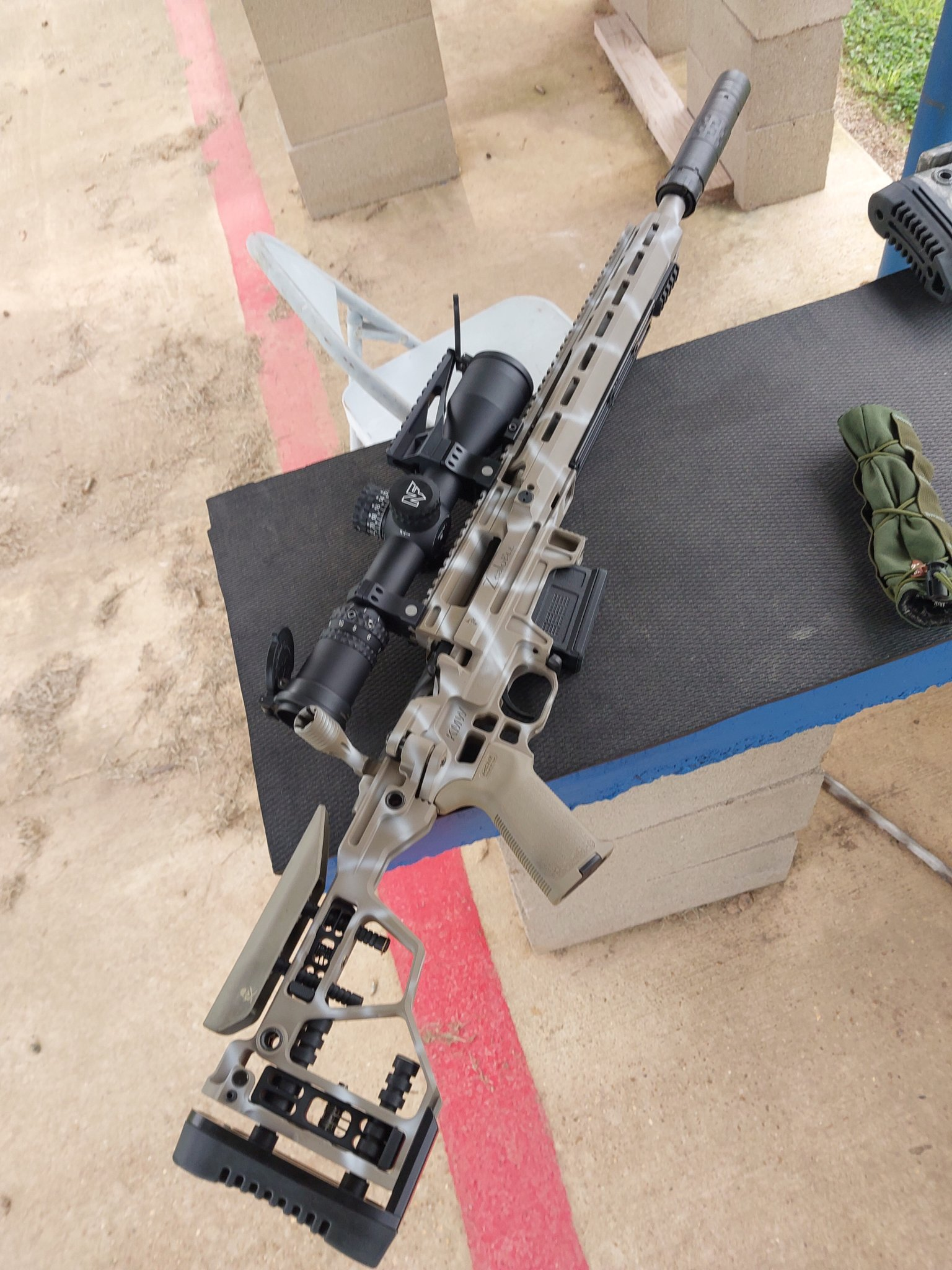

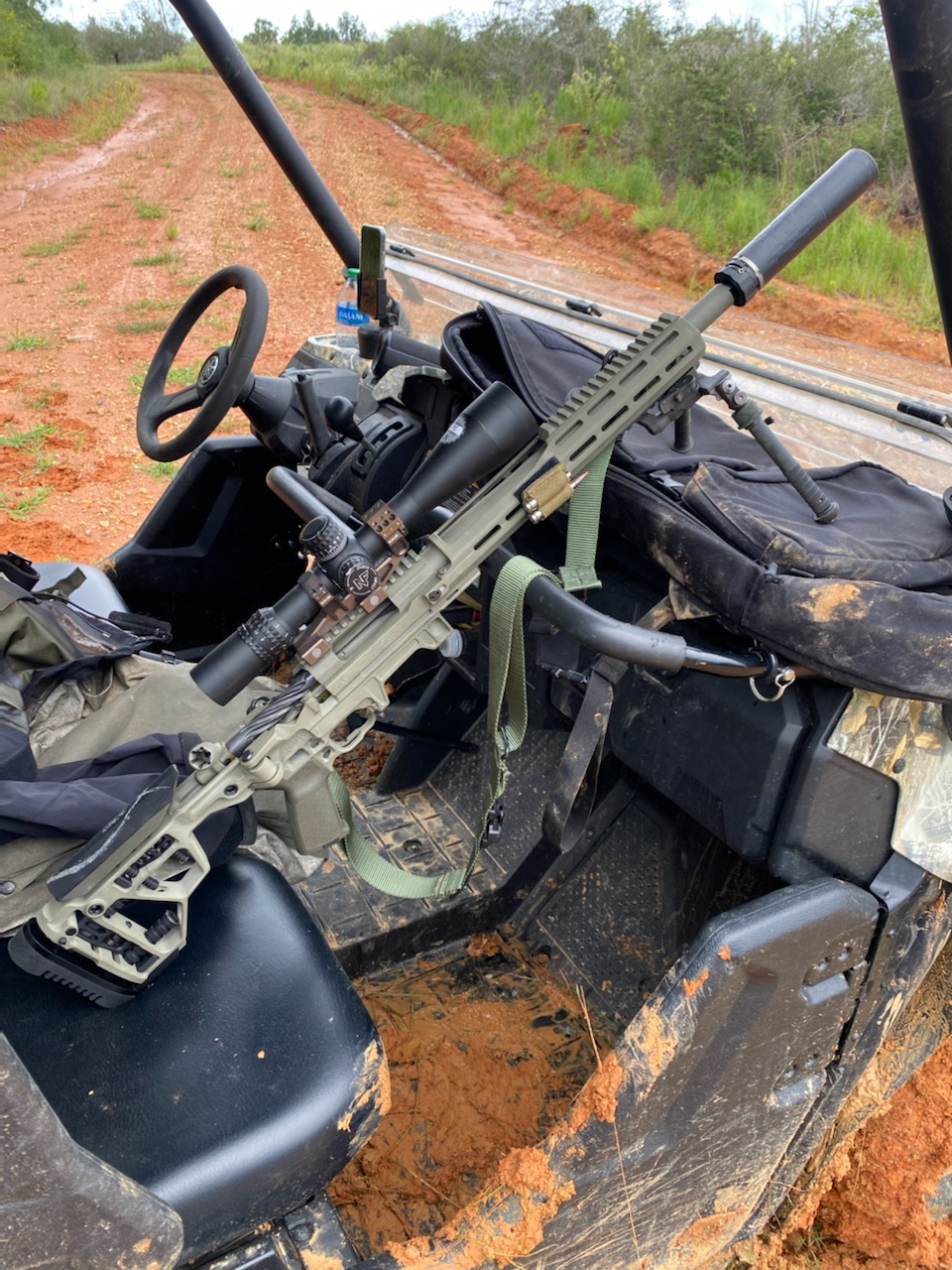

I know you designed this as a chassis for a work gun and she’s sexy but I could throw an arca rail on the bottom and have a sweet PRS chassis.
There is a 2" section of integral ARCA immediately in front of the magazine housing. You can see it in most of the pics posted above. This section is close to the balance point on most configurations and it fits the ANVIL 30 ballhead/clamps perfectly.
Also posted above is this pic that shows an additional longer ARCA mounted on the bottom of the forend.
This chassis has M-Lok slots for days so you can ARCA the hell out of it if you want.
