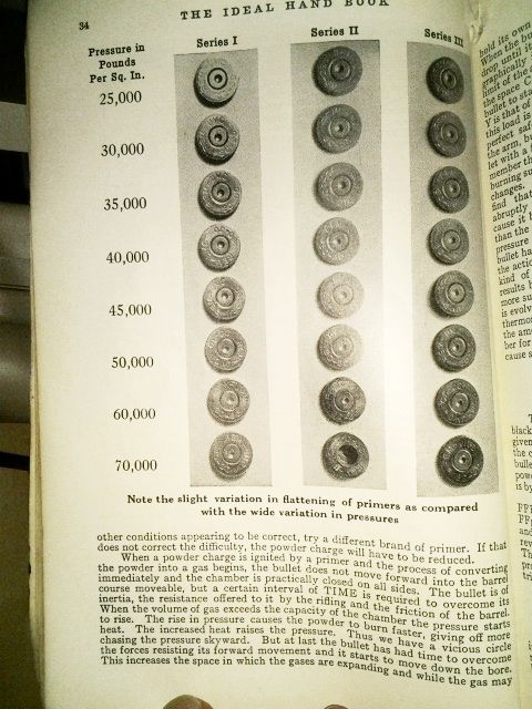

It takes well over 70,000psi to make lesser brass flow into the ejector pocket like that, as well as make the primer pocket go from a circular shape to an egg. Primers will often blow at 70ksi, but the case head might not have anywhere near that much eschar/soot.
I agree with 357max, that if this wasn’t Lapua brass, we’d be looking at case head separation and a blown ejector at a minimum.
My guess is that this was anywhere from 75-90ksi, maybe more.
How much pressure does it take for the letters on the case-head to engrave into the face of the bolt?
