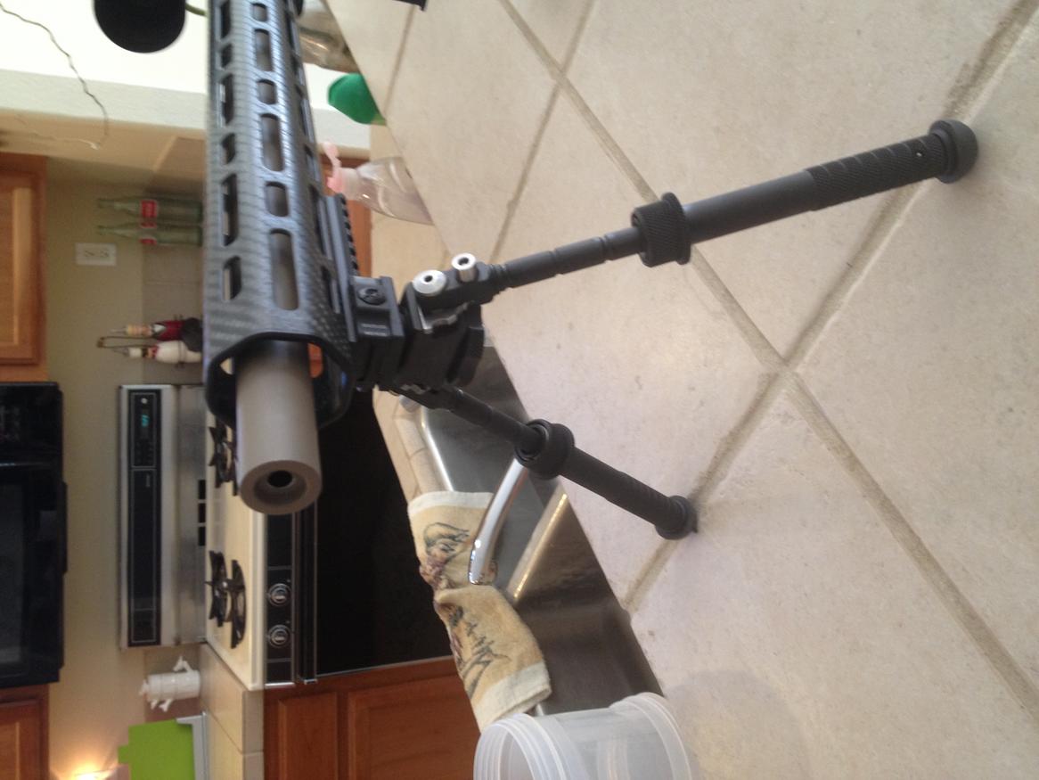

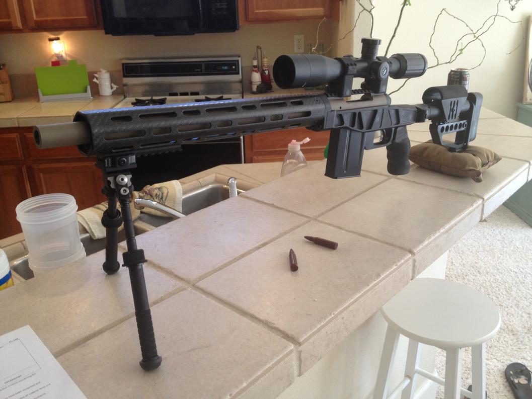

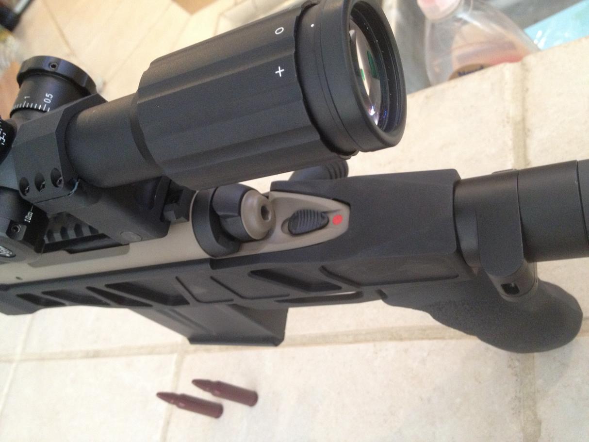

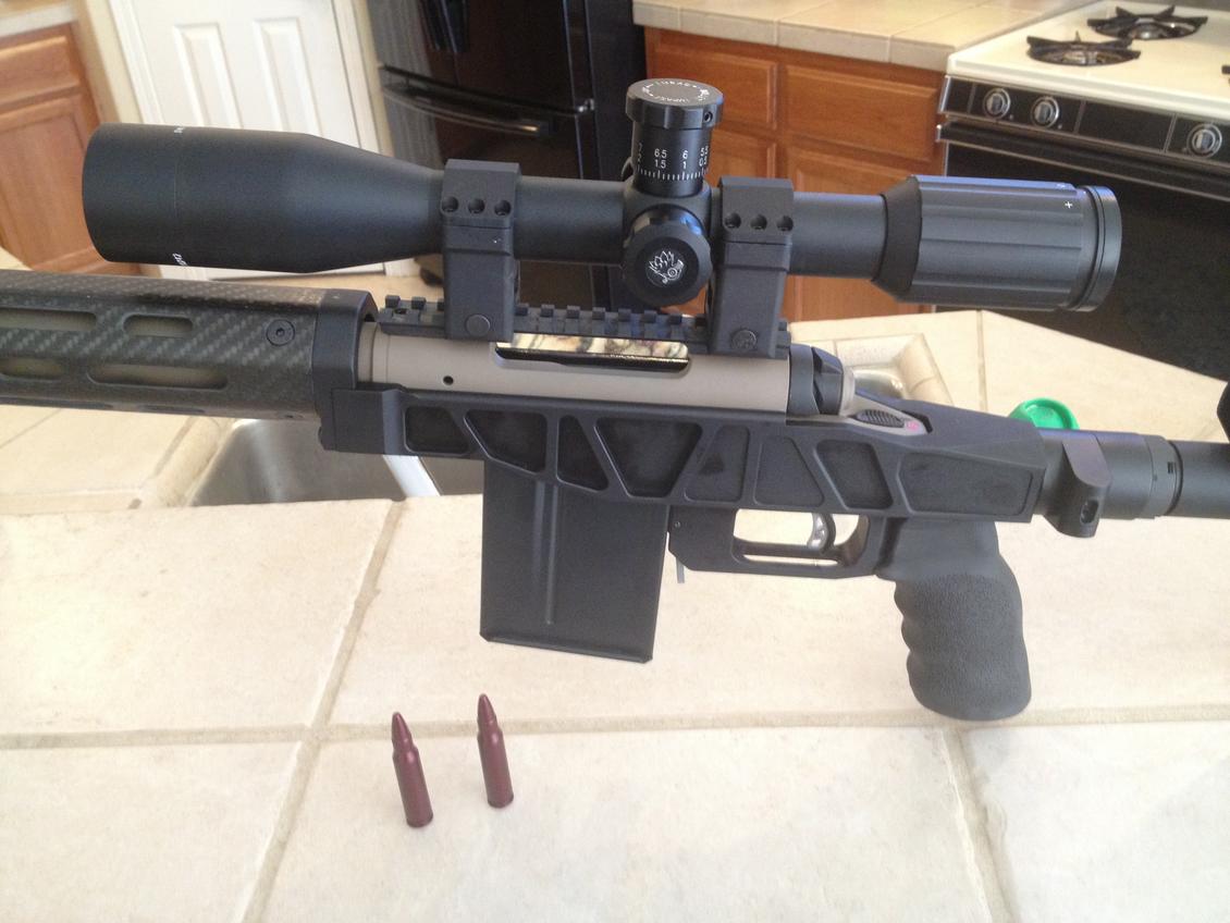

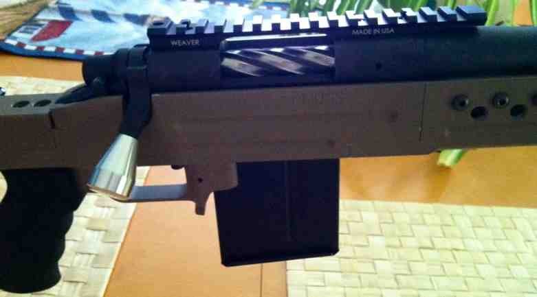

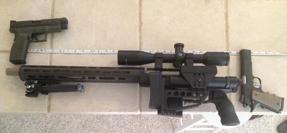

I want to give thanks to Kyle at XLR for really going above and beyond with his help and service. And to Keith at Phoenix Custom Rifles for making this action out to be everything that I ever wanted. Those two individuals there were top notch and I would highly recommend them! So here it is, 10 months in the making...
My Savage S/A .308 with a new 18 inch barrel, Atlas Bipod, XLR Carbon Chassis, Badger rings and mount, and SS 10x42
Now I just need to wait until tax time to throw on some top dollar glass. This thing is 28 inches when folded!
View attachment 14174View attachment 14175View attachment 14176View attachment 14177View attachment 14178
What are the barrel specs? Looks pretty heavy in contour. Did you keep the barrel nut?
Ben
That savage looks like a pretty handy little setup. What velocities are you getting out of it?
0 so far! Haven't gotten a chance to shoot it, and now the whole thing has to go to Manners for some adjustments. I just put it together to make sure it 'felt right' as long as it was going to visit Manners anyway. Very happy with how it will be when I get it back.
Here are the specs. I have not got to do load development yet. Today's load was a 162tho with 42gr of varget. It is too hot of a load with the can on the rifle. I blew a primer about 7 shots in. Speed was 2660fps on these loads.
