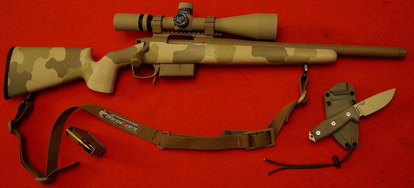

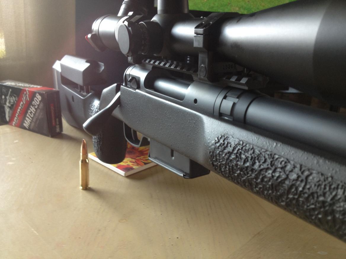

Old 700 PSS that I picked up on consignment for $500. Chopped to 16" and put it in a McRee Compact Folder. Shortly thereafter I didn't feel much need for my other bolt guns.
ImageUploadedByTapatalk1379924985.945787.jpgImageUploadedByTapatalk1379925065.423188.jpgImageUploadedByTapatalk1379925107.626152.jpg

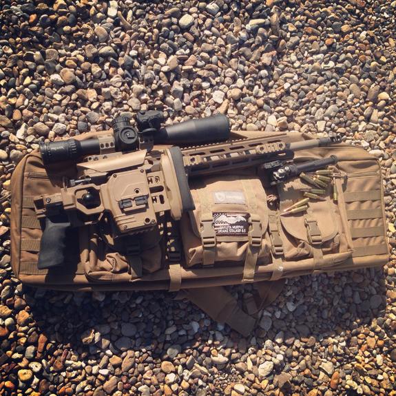

Well played sir! it's actually back at PCR having the rails and bipod coated..as for glass its either sell a testicle or bed some old rich lady. Hopefully I can get a Mark 6 on it soon
I had that exact plan as you for the 18" in a Manners folder, with MK6 on top. Spent about 3 months looking for the TF4, and ended up running across a Whiskey 3 chassis. The gun should be getting finished up in a week or 2, and the MK6 is in my safe waiting. It's running a 18" Rock chambered for 6.5CM though.
Sounds like a nice stick. A 6.5 in a Whiskey 3 is next on my list. Post up some pics when you get it together. Best of luck

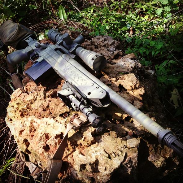

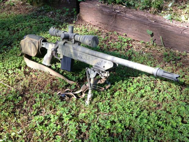

My 16" 223 Savage in an XLR chassis. A huge thanks to Kyle at XLR industries for the warranty work after I fell of the cliff with this package. Chassis held up to my 230# drop on the rifle and I only broke the mag release lever off after trying to impale myself on it. New parts from XLR and I am shooting .2moa at 100y again! A great system that holds up to some crazy whoops!
700 action worked by PPR (as well as bolt knob)
Slot milled for keyed recoil lug
Fluting by LRI (high helix)
Timney trigger factory set at 1.5
18" Criterion light varmint 6.5 CM
barrel nut for rem/age system through NSS
Manners EH1 with mini chassis
(Still in safe as I just got it in)
Nightforce ultralight direct mount
PST 4-16 FFP
Atlas Bipod
With the aforementioned mounted

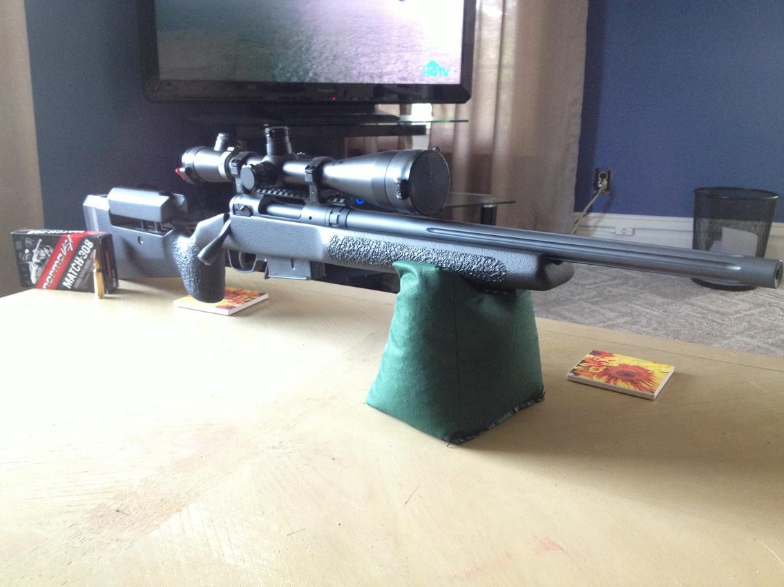

.308 Savage short action, Mcgowen 18" stainless barrel 6 flutes, manners T2A stock, leupold mark 4 8.5-25x50, badger ordinance 20 MOA base, medium rings and 9/16" pillars. Atlas bipod (not pictured) sniper gray cerakote, sharp shooters supply bolt knob and recoil lug. CDI bottom metal. 15#'s

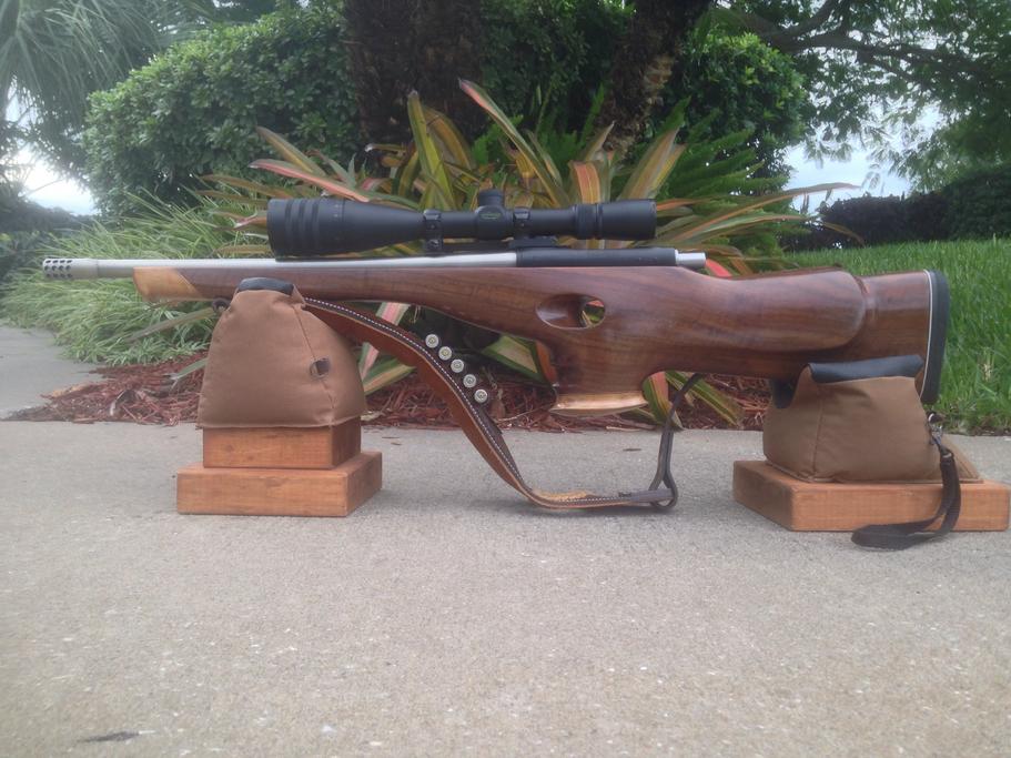

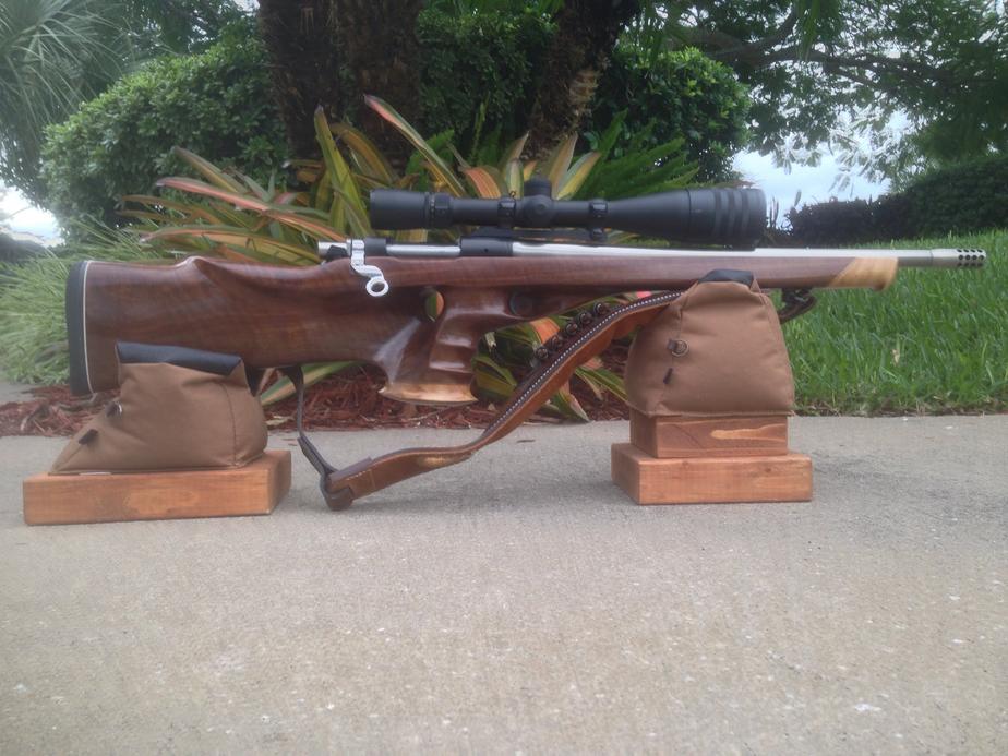

Last year I purchased a 10 pack of used Hart Palma barrels in different contours and all were 1:11 to 1:13 twists. I have four sons and a daughter that will eventually need "first rifles" so these should suffice. I built a budget "shortie" hunting rifle with a used 30" Palma barrel that I cut down to 17.5" and it is one of the best shooters I have so I am really impressed with the life in these barrels once cut and rechambered. The top one is my 7 year old's and it is a medium Palma taper and is 1:13 twist it is in a McMillan Hunter Stock I got here on the Hide.
The bottom is a heavy Palma and 1:12 twist with a Choate varmint stock I picked up for $150 that was already duracoat'd.
Thanks, I could tell the upper looked more like a 700 V contour and lighter than the lower which looks like a straight taper, they should shoot great! Thanks for sharing and enjoy those rifles.
Very nice to see something different. I've never been a fan of thumb hole stocks but yours certainly fits in with other XPs.
Thanks for posting it up!
Yeah, I'm not big on the XP100 pistol or the thumbhole, but this combination just intrigued me. So I built it using an old junk REM7 XP action. To my knowledge, only two of the bull pup stocks were ever milled way back when by these nice folks out in Kansas. Final sculpting, fitting, smithing, glass bedding and finishing left up to me. But the little sucker shoots straight.

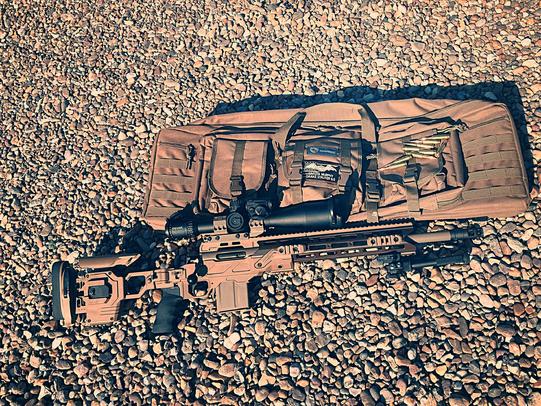

6.5 creedmoor 18" 1/8 twist Saturn
6,5texas.shooter, that is a nice looking rifle. what kind of velocity are you getting out of that Creedmoor and what bullets?

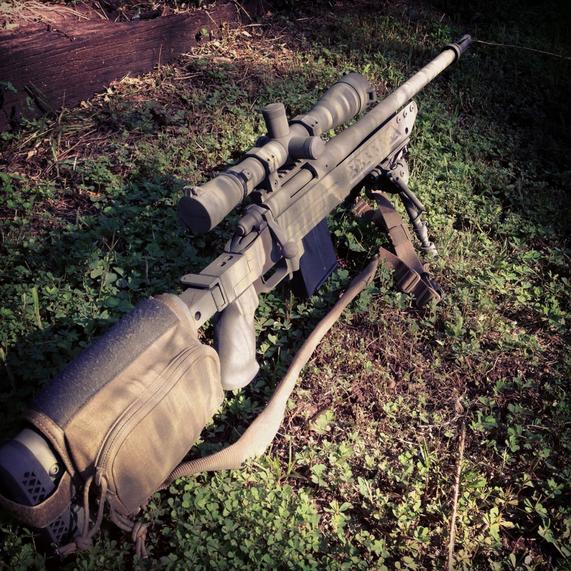

Icedragonmx, that too looks sweet. I have a savage .223 and an xlr and want to chop my .223 barrel and put it in the xlr if it doesn't sell shortly. I just don't know if I should cut the factory barrel or just wait until I can get a 1:7" chambered in .223AI.

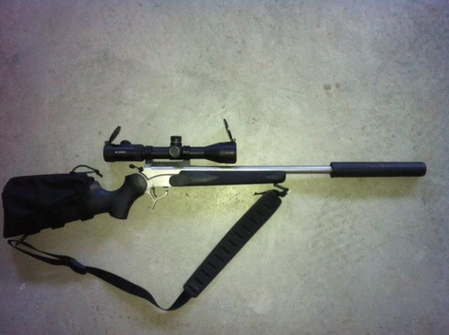

Ok, so its not a bolt gun, but its 18". 40" OAL with the suppressor attached. Thats the same length of my Rem700 in the Manners T4 stock without a suppressor. Was built for harvesting deer in my neck of the woods. Short shots, tight forest, and suppressor friendly. Most compact OAL was goal, and single shots cannot be beat. Im still playing with scopes and mounts. Will probably get a Zeiss Duralyt mounted on a EGW base and rings. The talley, while nice, do not allow enough fwd movement to get the scope away from my face and still have it supported correctly. Thats the downfall with single shots.....everything is much closer to your head.
Nice set up, so I assume it was chopped? In 308? What kind of accuracy are you seeing and have you done any mods to trigger or pin?
Yup, 308. Adco cut it for me. I set it up this way for deer in my area.....and distance is not possible. Its zeroed at 100yrds but ive never had to shoot more than 50. Accuracy (with me shooting) is 1" at 100. I would love to find somebody to do a trigger job on it. Know anybody?
Thought about a cantilever mount? Such as a Bobro or SWFA? That would allow full support while gaining the necessary eye relief
