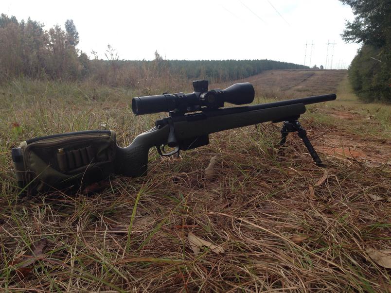

My work gun. 16.1" Bartlein M40 profile on Stiller TAC 30 with McM A5 Edge stock.

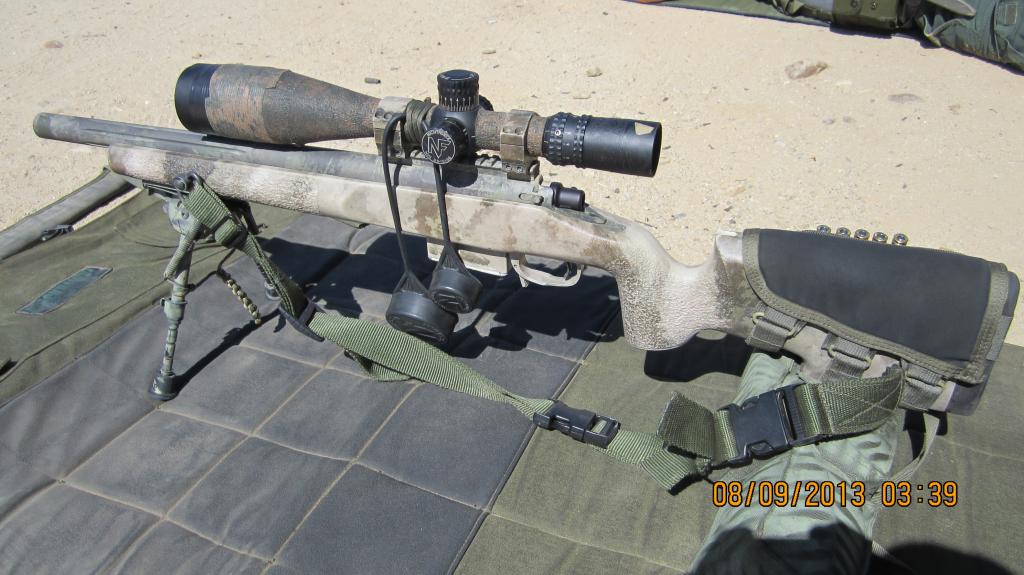

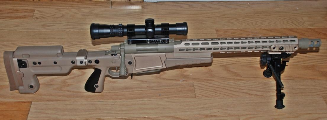

This barreled action has seen the shorty thread before but I figured since it got a new EH1 with mini chassis yesterday that I would show her off again. She's 18... Inches, and he's 225 pounds.

How heavy are these short sticks with DBM and 50mm glass? Hunting weight, or punching paper weight?
Really depends more on contour than length and brand than objective size. A 16" MTU will weigh more than a 24" sporter. A 50mm Nightforce will generally weigh more than an equivalent size from another maker. There is also stock fill to consider.
That being said, these rigs are all probably around 10lbs.
Mine came in at 11lbs on a bathroom scale. 2 pounds for the G2DMR. It was a 26" Tactical or Varmint but at 18" it balances perfectly in this EH1 which makes it feel lighter than it is. Hell I hunted with it in lock ons, ladders and climbers when it was in the T5 which was almost a pound heavier. I'm also 6'3" and 245 so I'm used to a little extra weight. I don't hike all over the woods with it very often and I'm not in the mountains or plains. I do have a very lightweigt 7mm08 but it's stayed at home ever since I cut this one down and put it in a Manners w/ mini chassis last year.

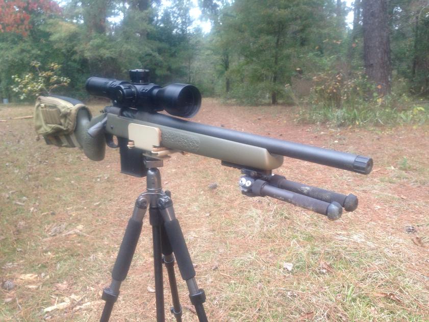

I can finally post a picture of my 16" 308 now that I finally got around to painting it.
Stevens 200 action, Mcgowen barrel @ 16" 1:10 308 win
Manners TF2 stock painted in the brand new 5 color Ghost Nighstalker
Badger rings, Bushnell HDMR 3.5-21 scope, Atlas bipod.
All ready for deer season now.

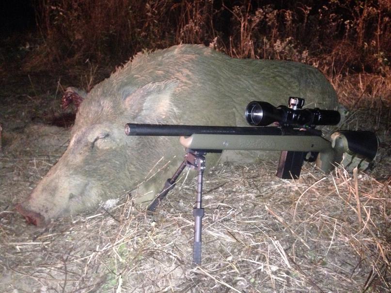

18" AAC barrel on a trued remington 700 short action. Cerakote and gunsmithing done by PCR.
Who knew a simply investment in a 1/2 off AAC barrel would land me with this beast. I'm not complaining, but my wallet is.
That is a sweet set-up! Love the size and balance. What's the felt recoil like given the lightweight of the rig, and the 175's?

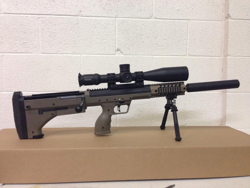

I shoot a lot of big calibers and shot guns, so I am not very recoil sensitive. 308 Recoil seems minimal to me. That said, short barrels tend to rise more than traditional length barrels due to increased blast and lack of forward weight. When shooting in prone with natural point of aim, watching your trace and hits through the glass is easy without a brake. But off of the bench or some other positions, muzzle rise pulls the scope off target every time unless you really torque down on the rifle (which messes up accuracy). I installed a BABC brake that I had laying around for another build and it completely eliminated muzzle rise, reduced felt recoil, and did not hinder accuracy (although POI was a little different than without the brake). It added a little weight, noise, and length to the rifle, but it is worth it IMO because you don't always get to shoot prone.
The gun loves 175 SMK and 178 A-Max. Pic with the brake on it:
Desert Dog

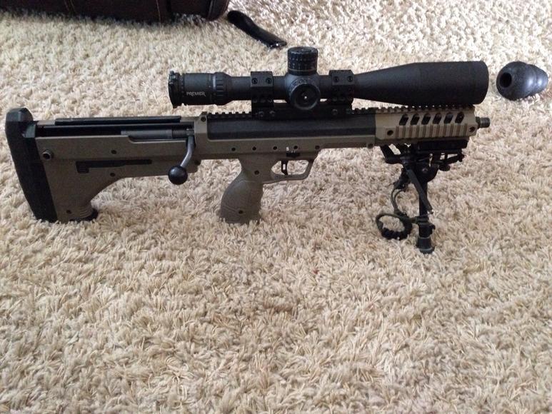

18.5" rem 700 SA XCR Compact with AAC non-mount brake in our own carbon fiber stock.
murphy precision titanium base, murphy precision titanium rings.
Leupold CQBSS H27D on top
weight is 8 lbs 12 oz as pictured (no mag)
