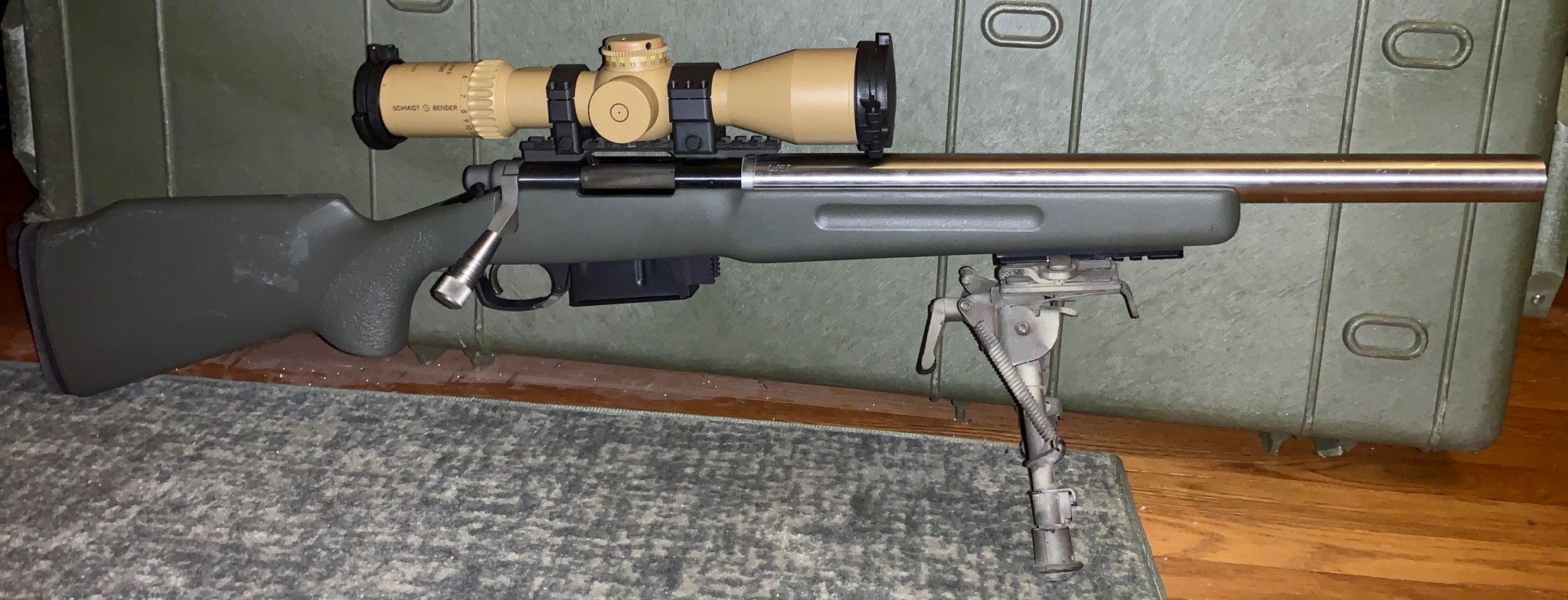

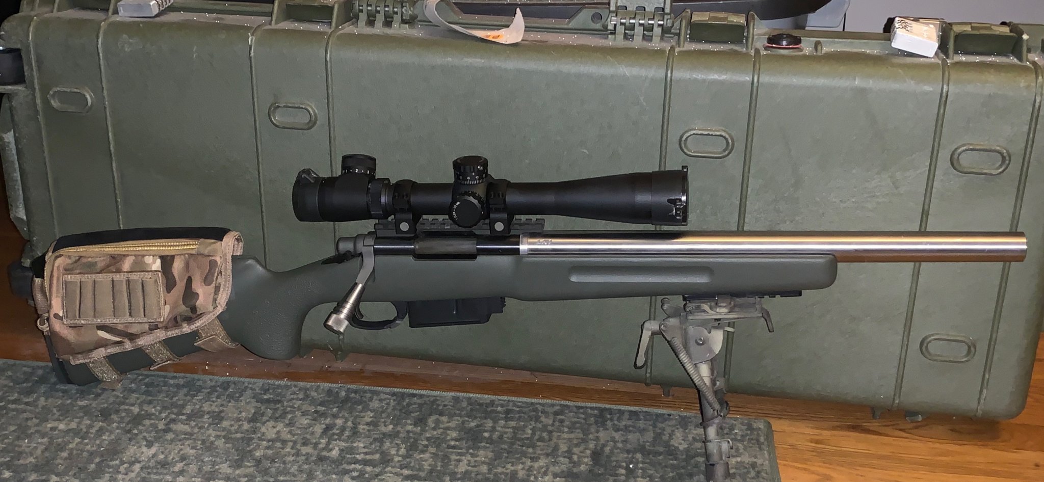

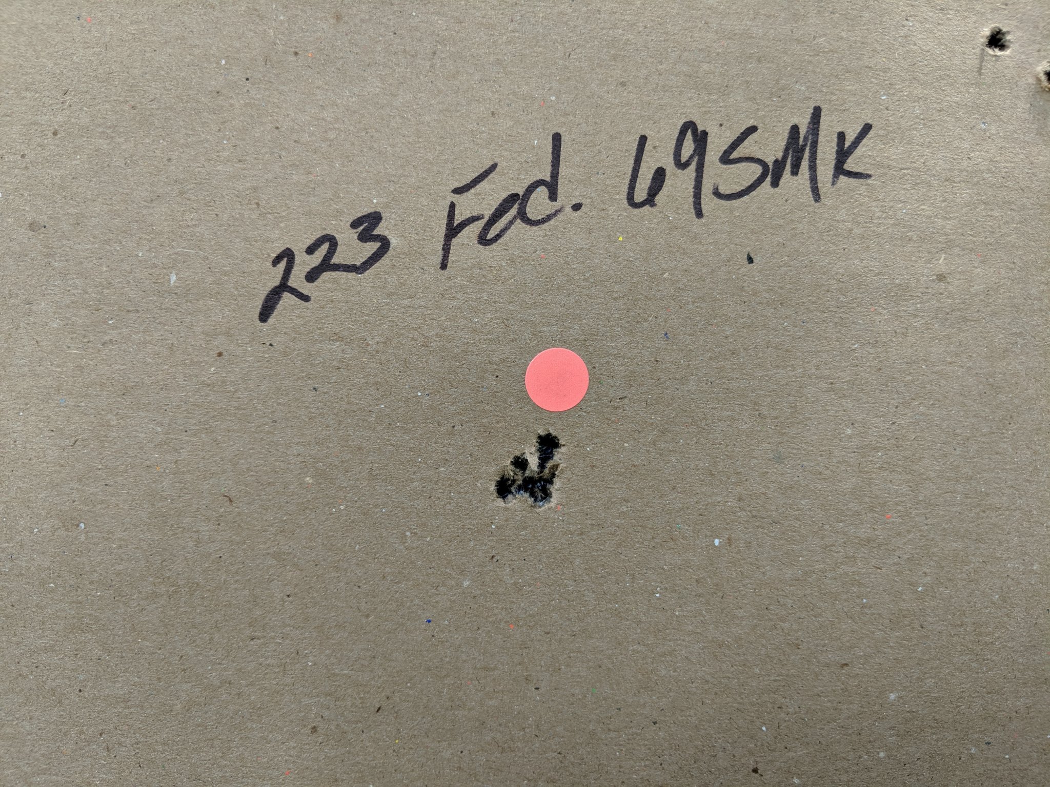

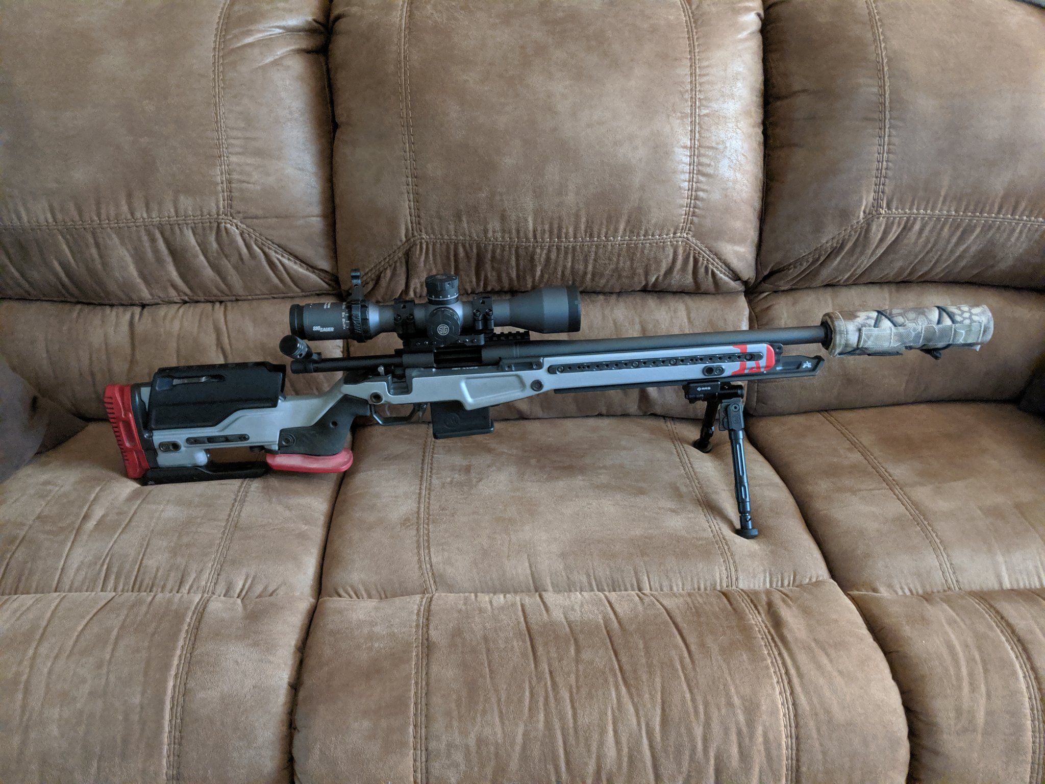

Tikka Varmint in .223 cut down to 16in and threaded.

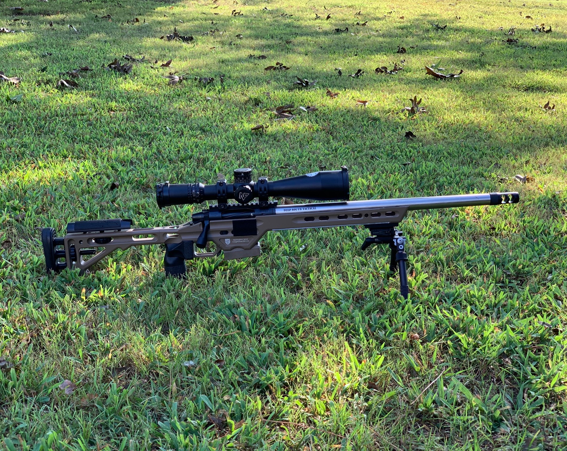

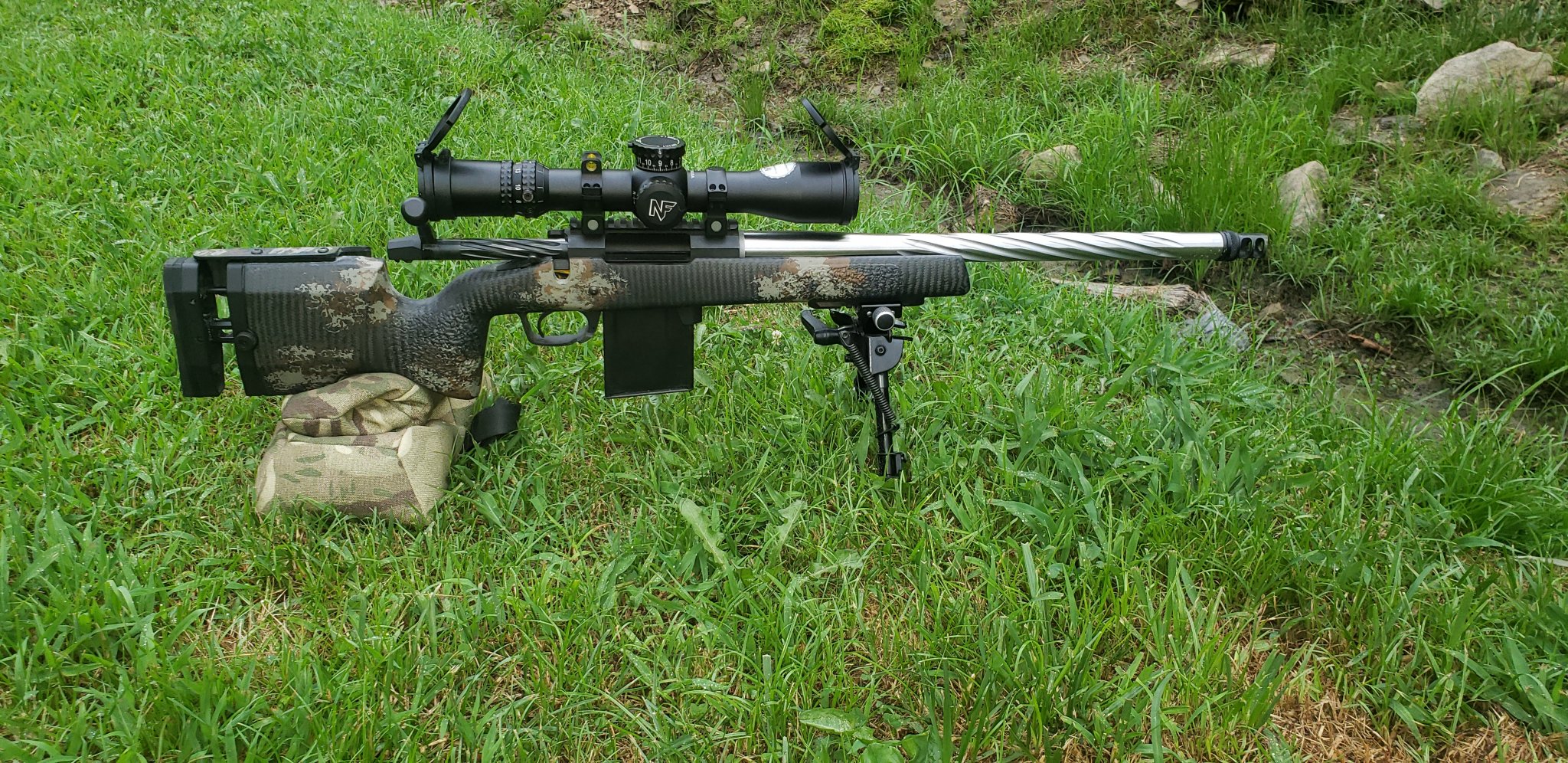

I will be shooting the 103 eldx this hunting season once I get a load developed for it.
It’s a criterion 7.5 twist, exactly like my old barrel but 6” shorter. The 10 rounds of my old load with 105 rdf .020 off the lands in norma brass with 39.4 h4350 got me 2780 at the 85 degrees here this morning. That would have gotten me to 2980 in the 24”.
This new barrel should speed up a tad after it gets worn in.

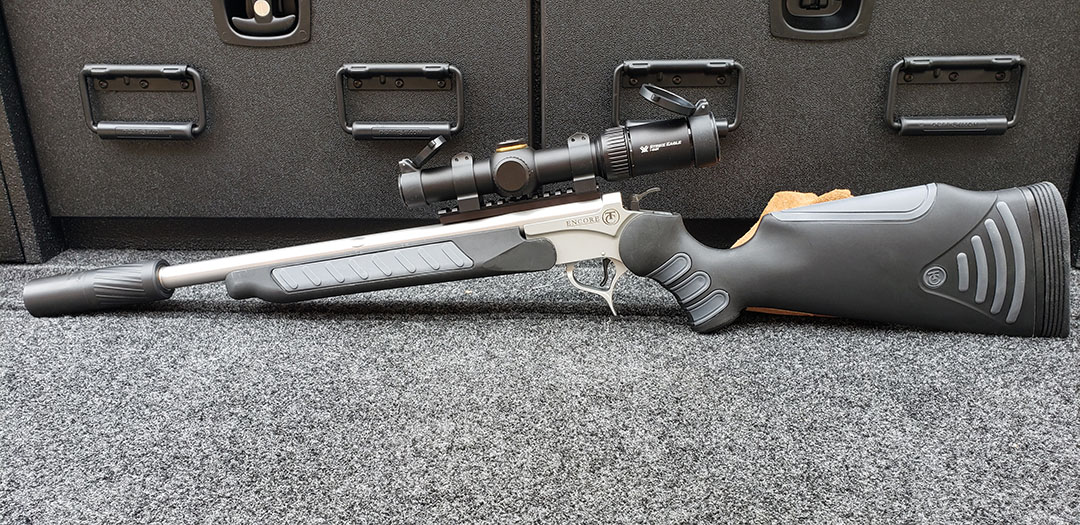

I built an 11" 308 pistol. It's a better shooter then I figured it would be.
Don't have pictures at this time but maybe I'll take some and update this post.

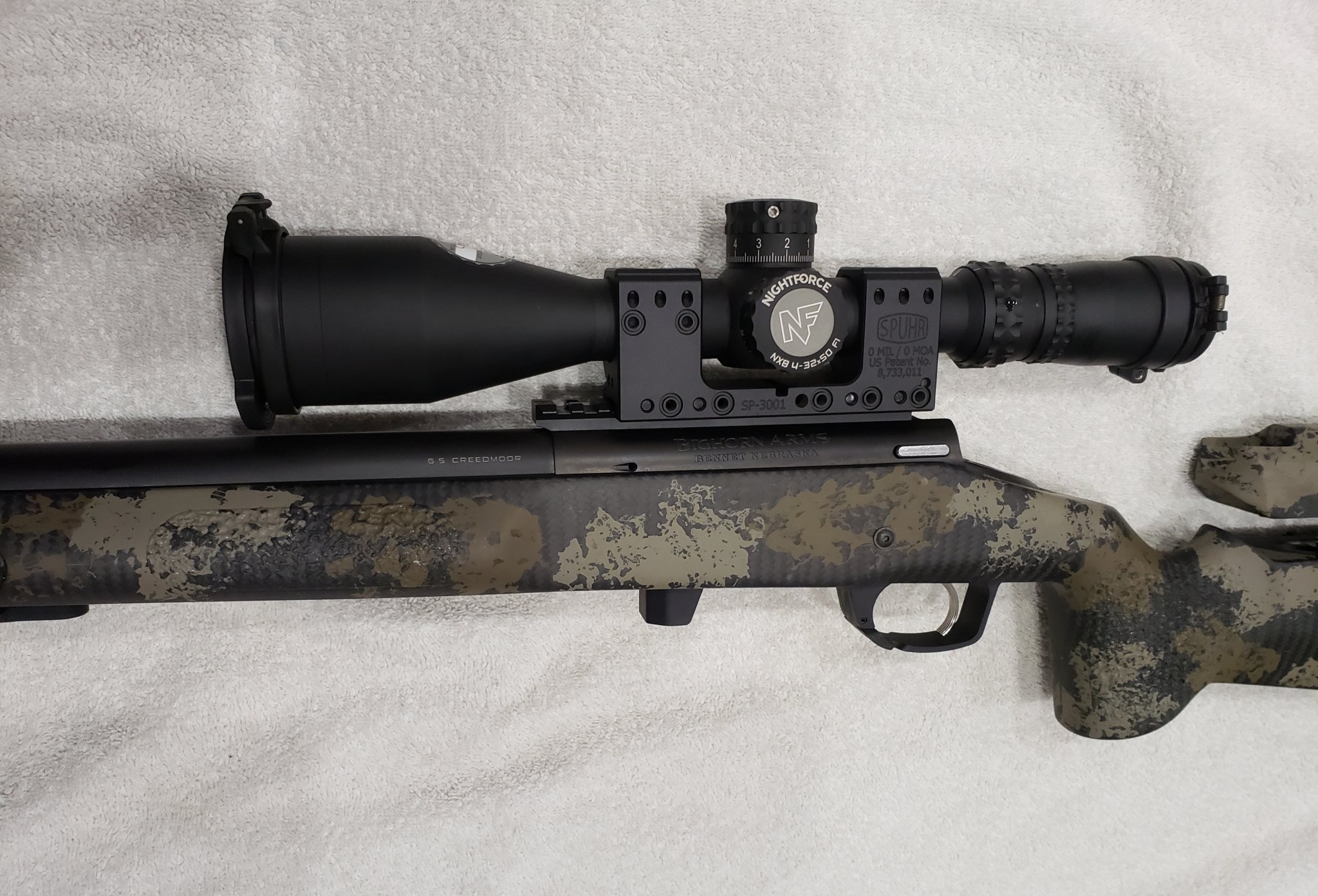

Why do so many of these 16-18in guns have such massive optics? Seems weird to see 4.5-27 or 5-25 on top of them?
I am looking for an optic for my 16in fix and I am wanting small and light

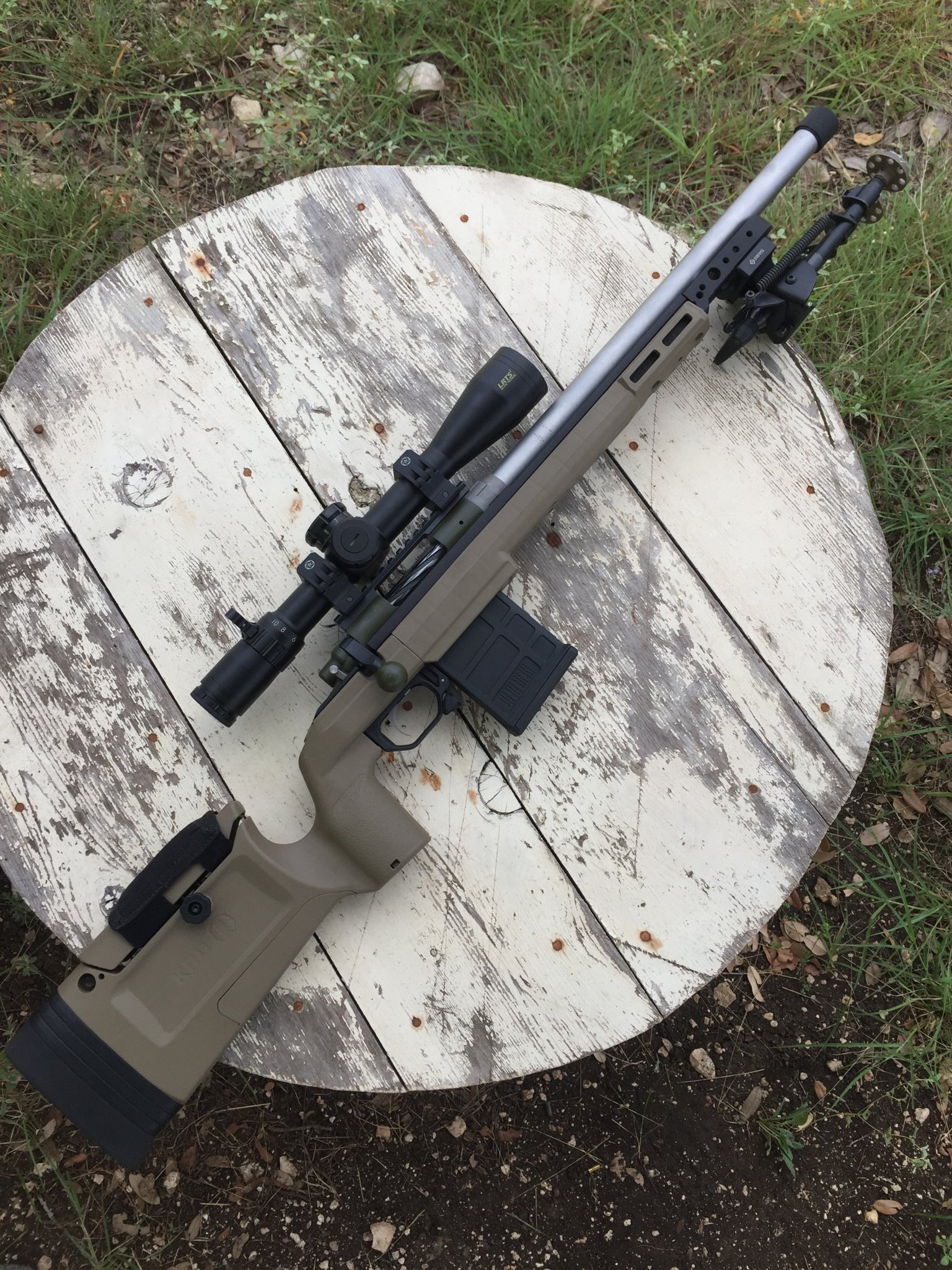

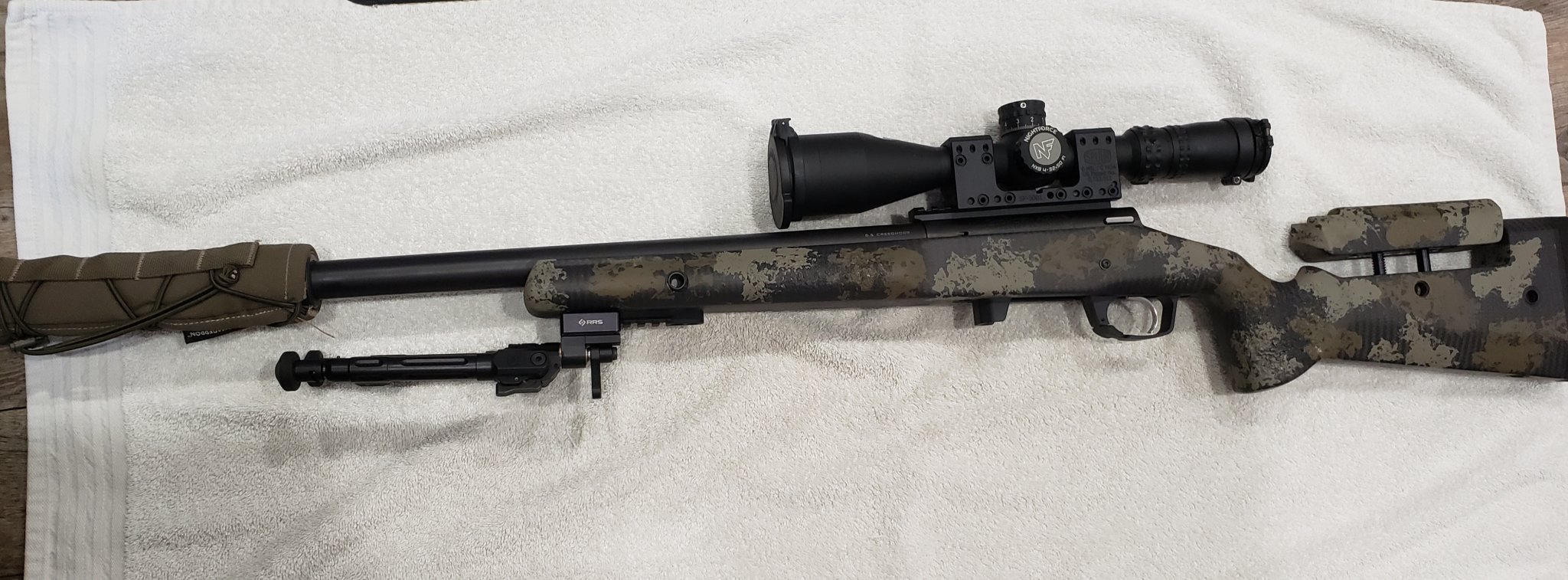

While i'm usually a big proponent of ultra-shorts on short rifles, almost solely on an aesthetic basis i actually love this look. Also this is my brother's 308 which he wanted to be as heavy as possible. So he really needs a Gen II razor instead of my ATACR or the PST Gen II he owns.
