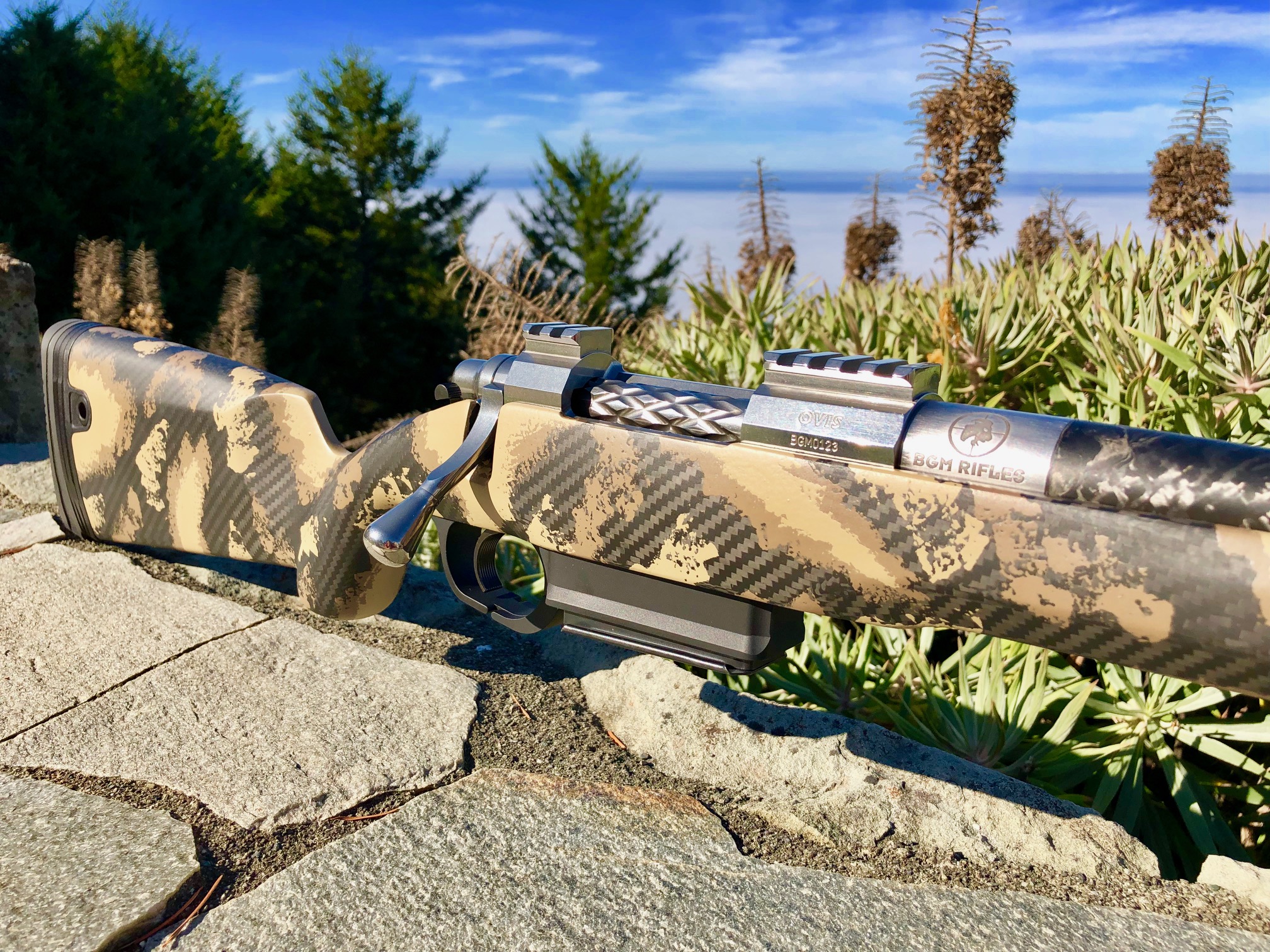

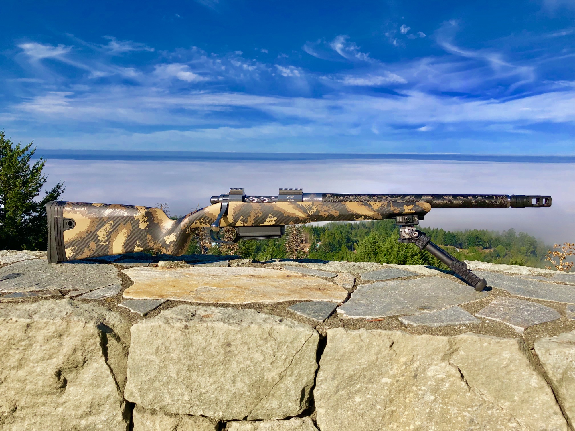

16-18 inch shorty rifles

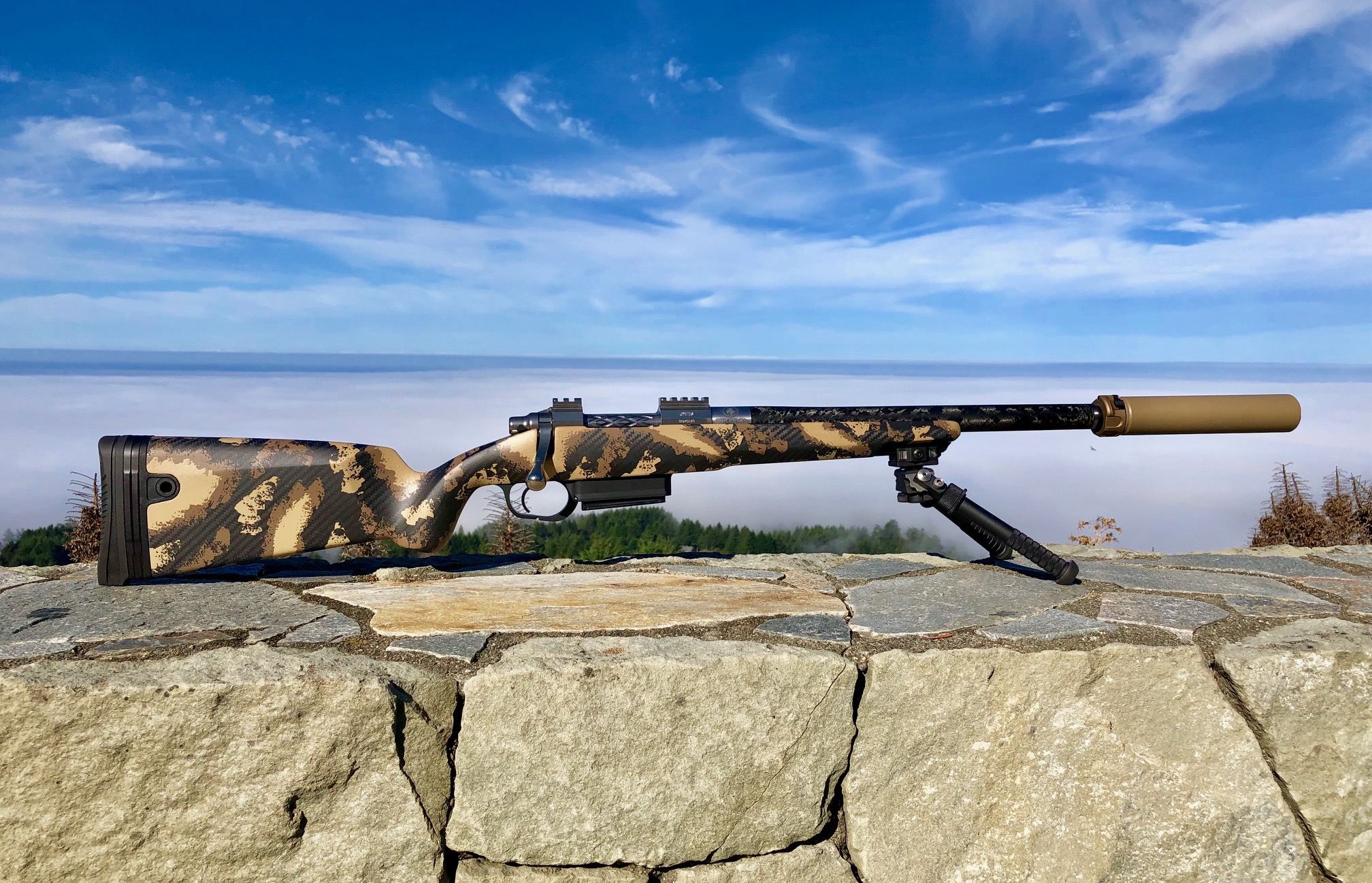

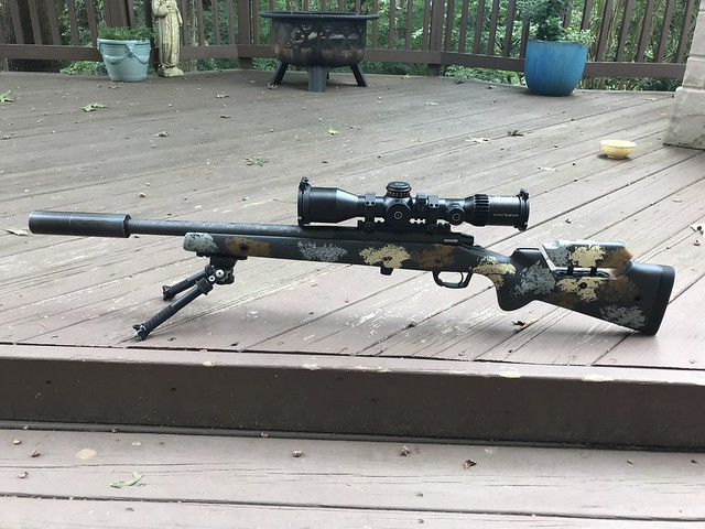

I like it, no regrets. Very handy, still shoots 178 amax over 4064 lights out. Both pics are of the 16.25” barrel, with and without can for comparison. Gave me an opportunity to finally do a barrel swap on a savage, though it was more of a pull and reinstall of the same barrel. Easy peasy once o removed the stubborn smooth nut with a pipe wrench:) Still thinking of putting the folding stock adapter on.

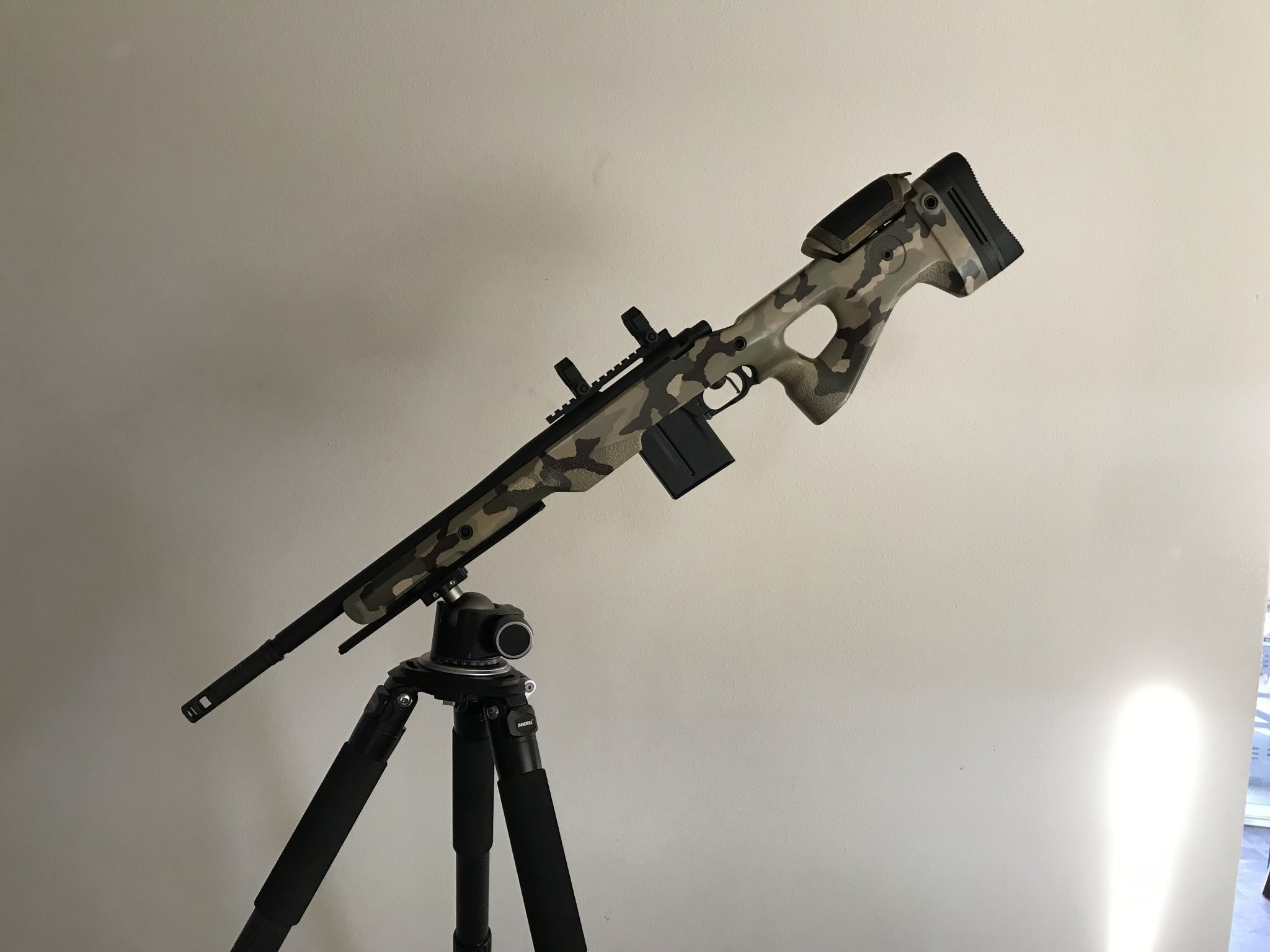

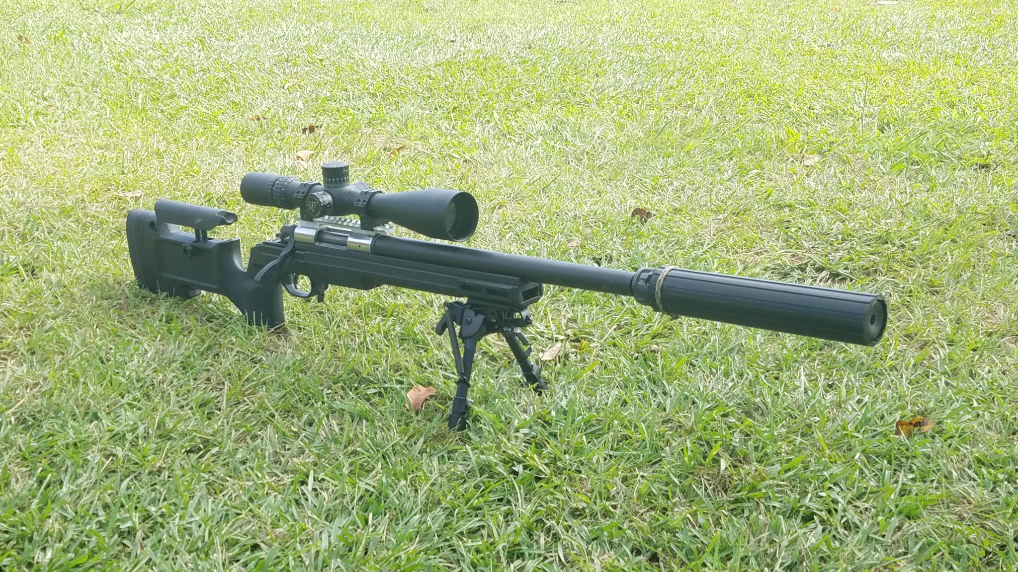

In a world of fde and fiberglass, here’s a different take. AAC-sd 308 bedded to a walnut stock. Gray krylon for the metal, boiled linseed oil for the wood. Still have to fit a legitimate buttpad to it. Deer season is only 10 months away...
Good looking rig. Where did you get the stock? I've been looking for one just like it to go on a 26" 308 I have.

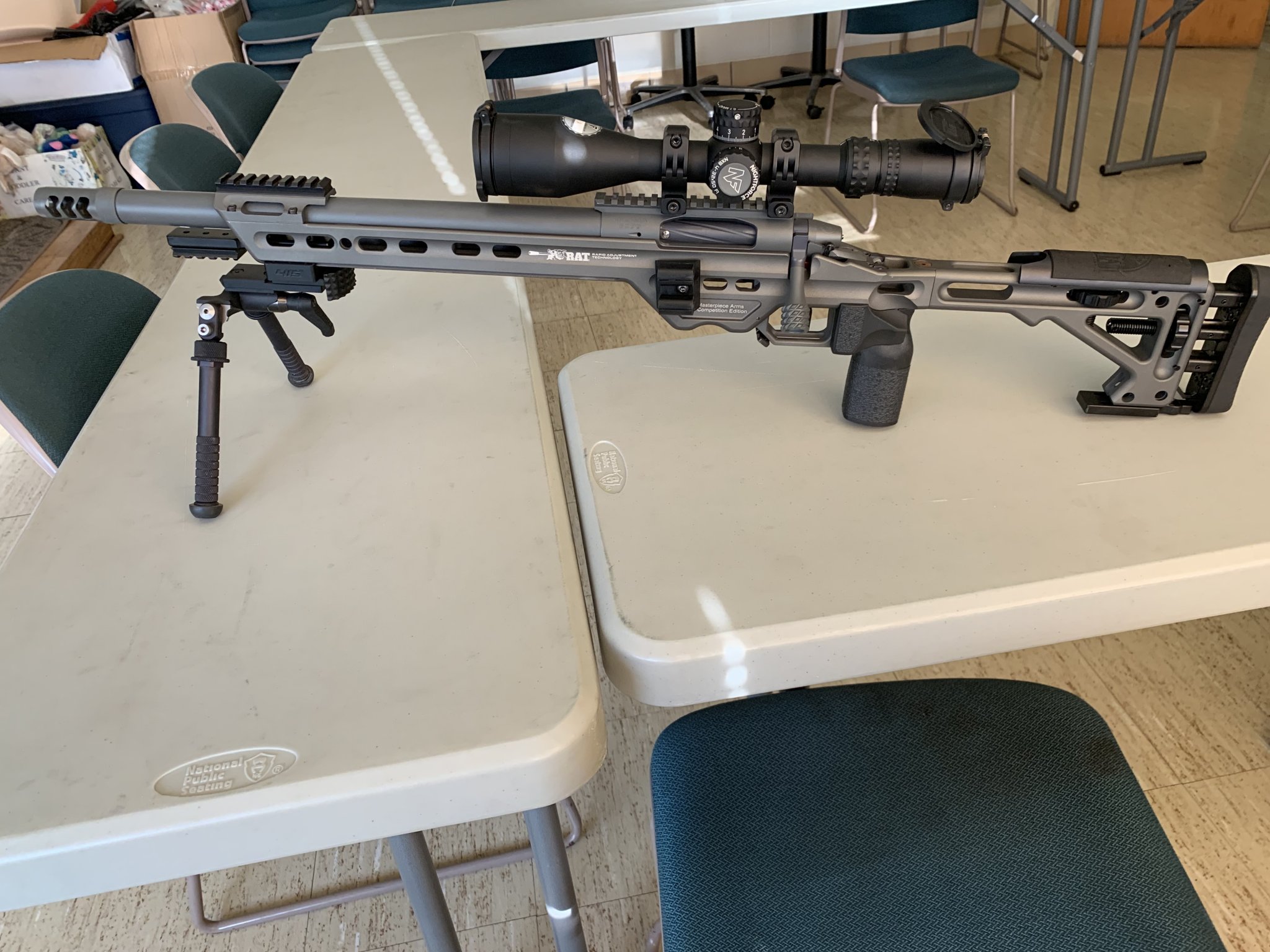

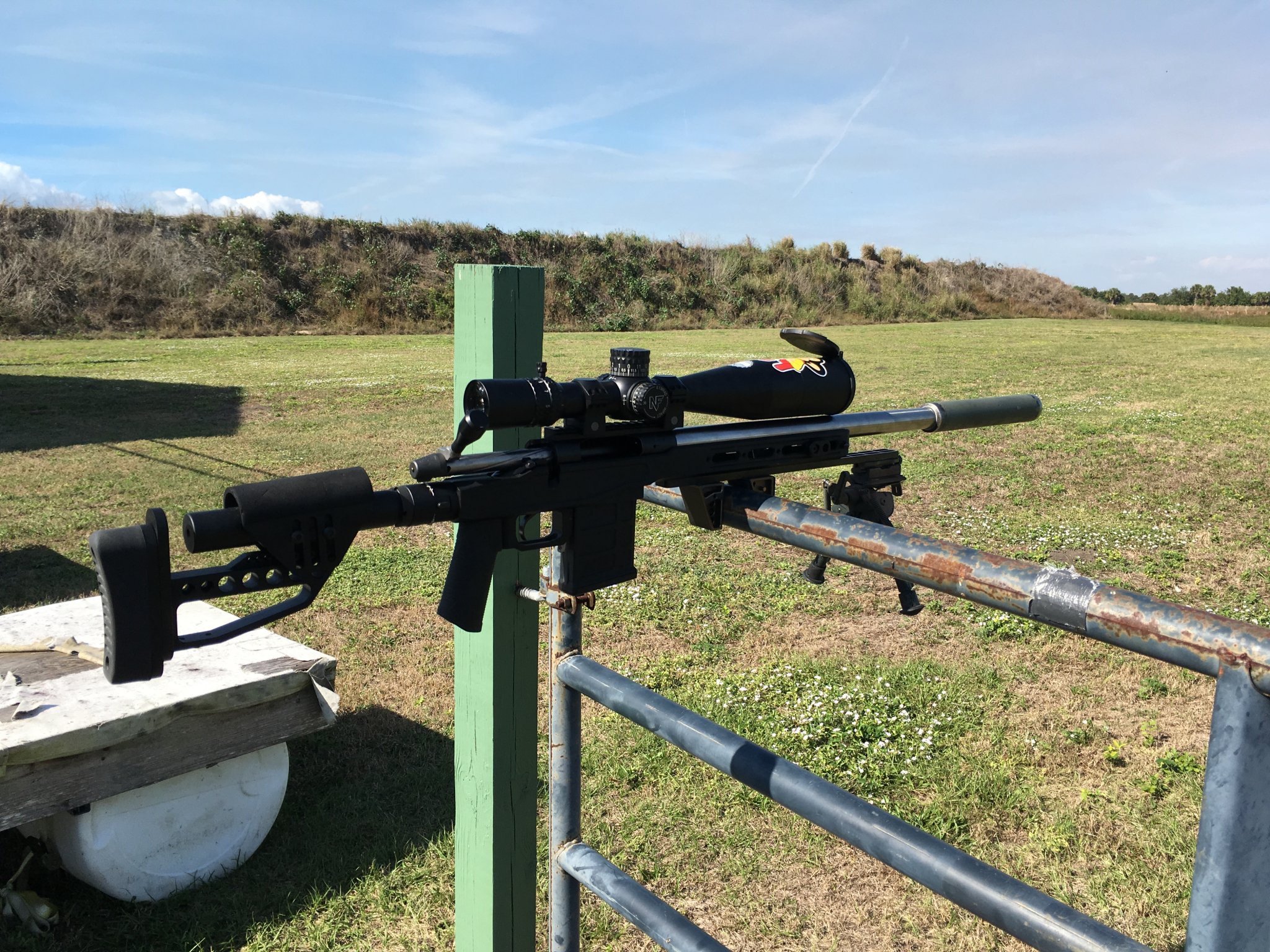

Put a new scope on this little guy, S&B 3-20 Ultra Short with MSR2 reticle. Badger rings and accuracy first level. Love this little rifle. Shoots 143 eldx's into .2's and .3's with ease at 2553fps according to the labradar.

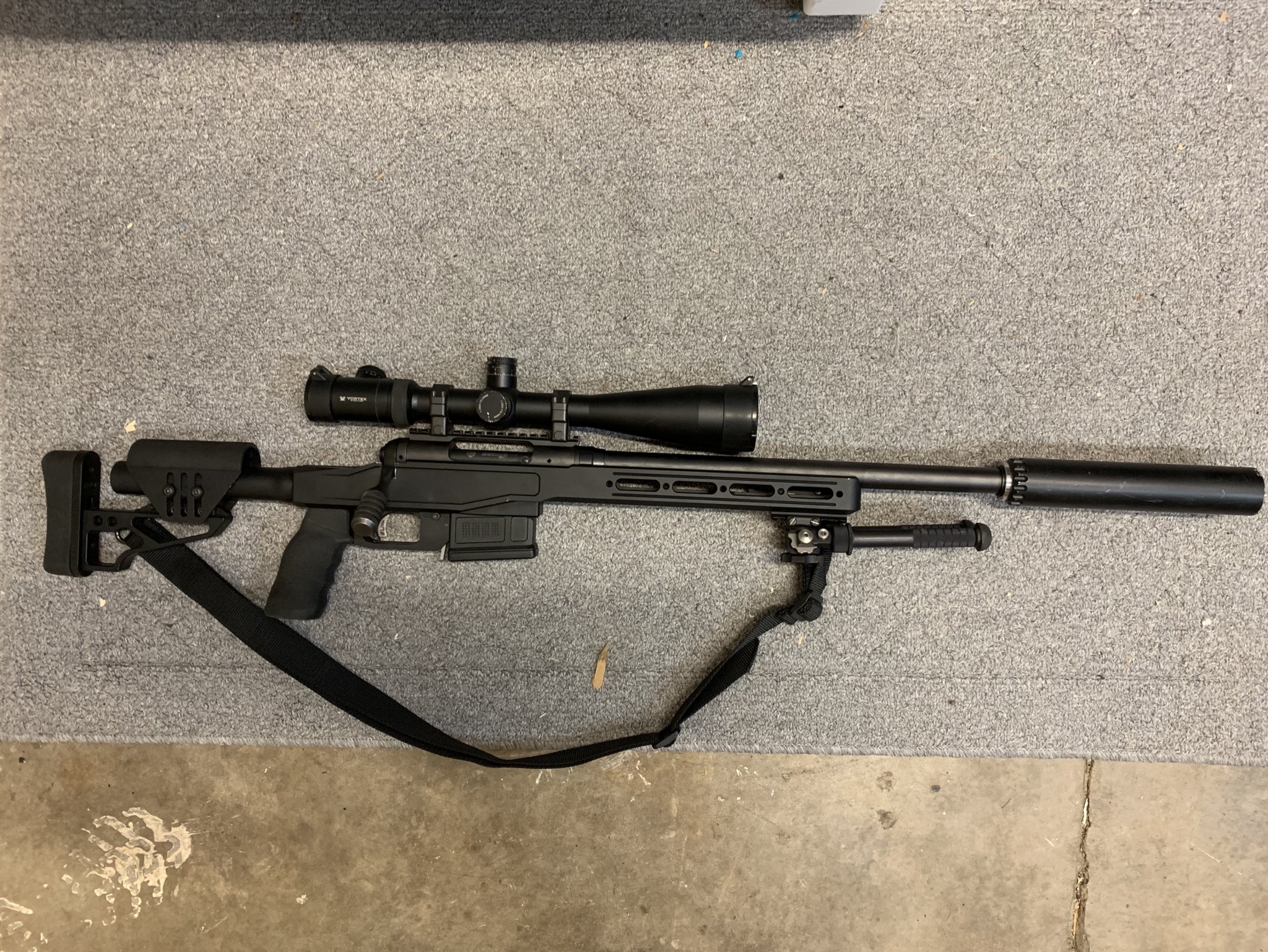

Savage model 10 chambered in 308
Chopped the factory 20” down to 16.25”
XLR element chassis
Vortex pst gen 16-24
Griffin armament sportsman taper mount

That's a beauty and i'm thinking of building something similar. Do you mind telling me the OAL from the threads of the barrel to the end of the stock? I'm assuming there's about an inch gap from the stock to the tube. Thanks!
From barrel tip to recoil pad it’s right about 35”. That could vary, of course, based on a shooters individual LOP.
