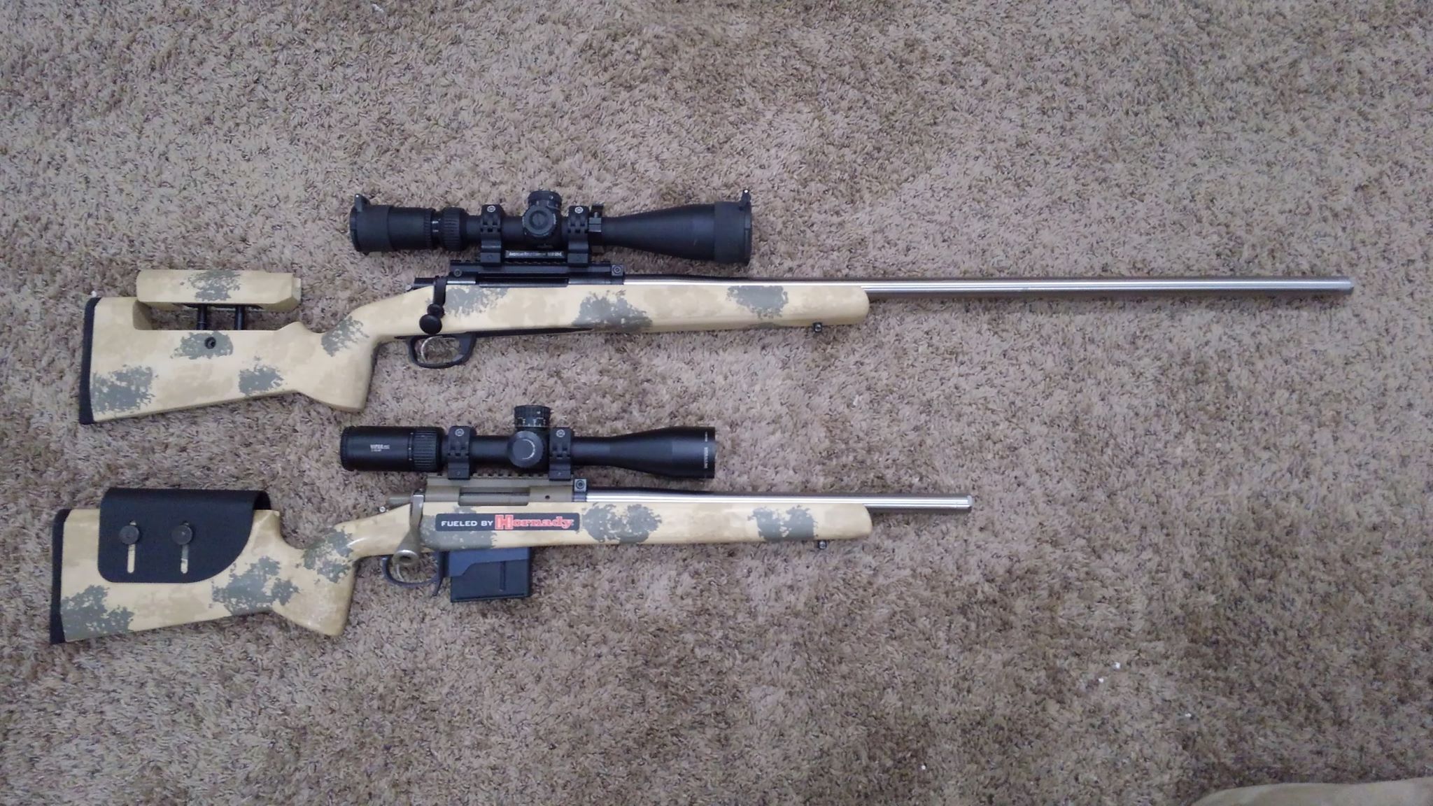

16-18 inch shorty rifles
16" Tikka .223 Stainless, just got my first coyote with it last night

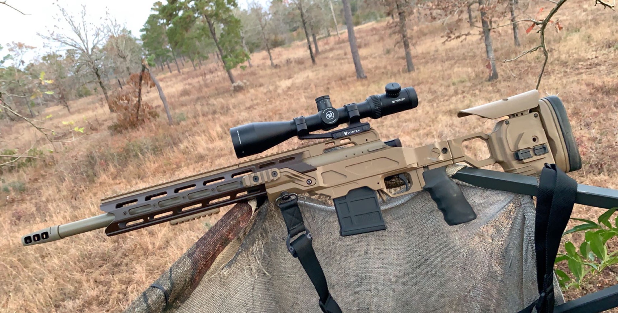

Here is my new one in the works.
16,5" Krieger 6XC
Defiance defiant
Trigger tech diamond
Vortex AMG
I ordered a manners prs2 for it and a grayboe so I can use it while waiting for the manners to come in. ( The grayboe should come in any day now, the manners will take another 6months or so)
