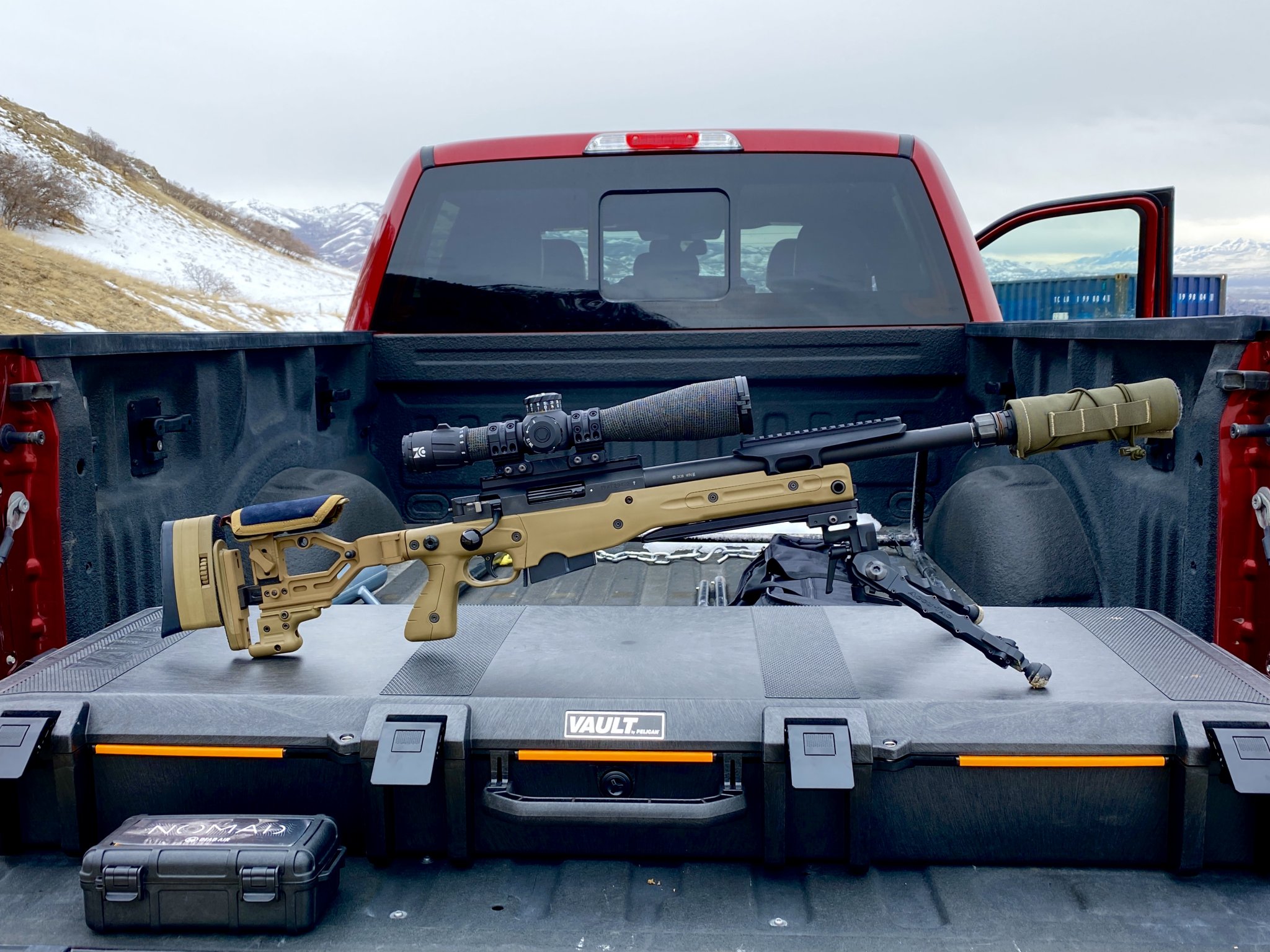

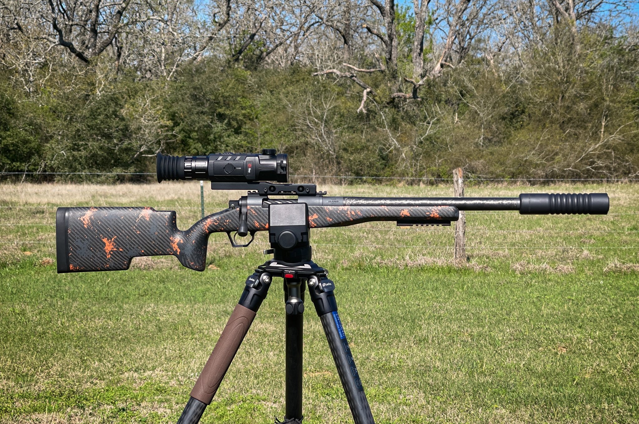

16-18 inch shorty rifles

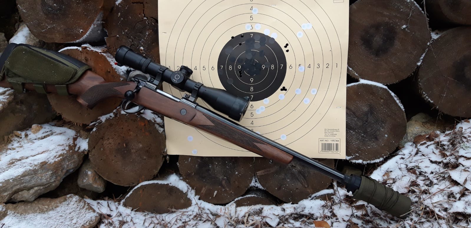

I'm using this thread as inspiration to do the least sensible thing I can think of. I think my Tikka T3x project rifle just became a bastardized scout project. The magnum caliber of my choice, 18 inch barrel w/ a Dead Air KeyMo something or other on the end of it...drive on. McM Game Warden is already on order, got the Red Snake bottom metal already. Just need a barrel...
top is a 18” 6.5 creed
Hand load 120gr SMK at 2750
Bottom is a 16” tikka 243
hand load Hornady 87gr bthp at 3150fps
Shoots factory monarch 100gr soft points at 2500fps moa accuracy and are only $11 for a box of 20
Shoots factory Winchester 58gr v Max at 3500fps
Also run a 16” 30-06 Rem 700, not pictured because it’s getting threaded.
Runs 215 bergers at 2580fps with rl17
My tikka 338 win mag is also about to get chopped to 16” as well so I don’t have to track 300 lb boars at night anymore.
Every since I got suppressors everything has been getting the chop.

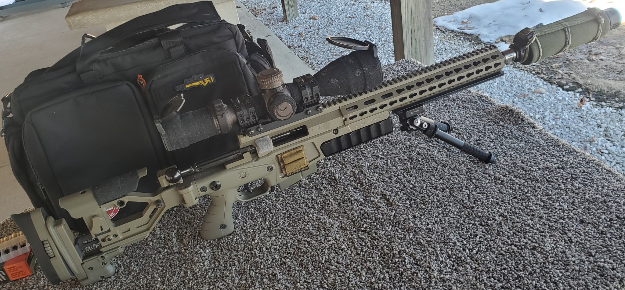

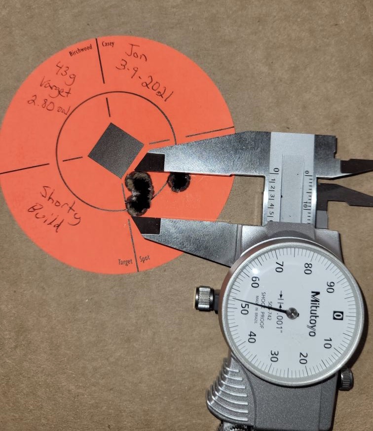

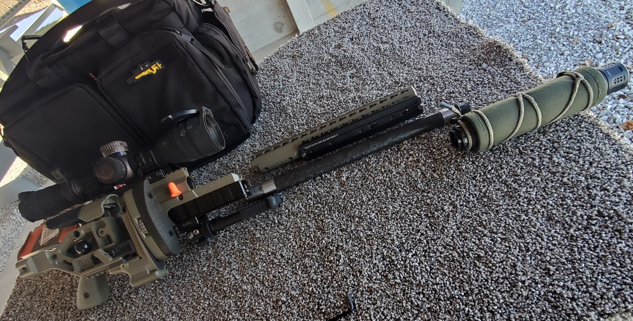

Shot the 18" tikka 6.5 today and she was right at the speeds I had guessed.
My 140 berger load was shooting 2700 in her at 24" and now is at 2552 avg over 10 shots. SD of 7.4. Shot 2, 5 shot groups on paper and center/center measure 0.22"
I think she's gonna put the smack down on a deer.
My load is seated out long, for hunting, Im going to seat the 143eldx's a little deeper and hopefully get 2600
I am curious to see the velocities I will get with it. This is going to chambered in 6.5 Creedmoor as I already have a Tikka CTR chambered the same. Easier in current market to reload what I already have than find new. The CTR with 24 inch factory barrel is very accurate but slow. I know that the short barrel will be slower already but the numbers others have shared look like I might actually be in the same ballpark as my CTR. If so I might order up a replacement barrel for the CTR so I can get the most out of that rifle.
Where were you guys when I was trying to sell a proof blank a couple weeks ago? haha. I decided to just use it and sent all my parts to GAP, but I have a thought on the short barrels that I would like to try someday.
What do you guys think of a faster twist because of the shorter barrel? I want to try a 16.5" 6.5CM with a 1:7 left hand twist. I'm a right-handed shooter.
Also I would love to try some 120gr match bullets that have David Tubb's nose ring cut.
The overall idea being to make a shorty punch above its weight class so to speak.
What are your thoughts?

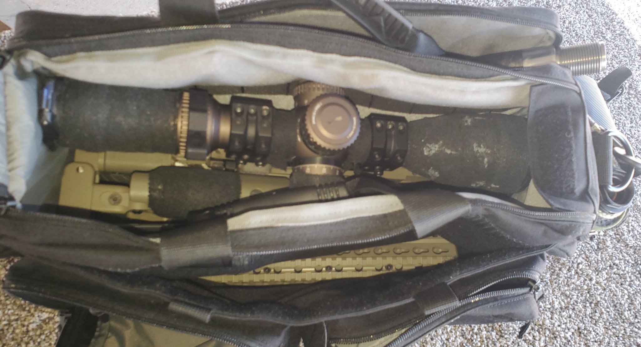

Couldn’t resist when I saw this for sale, added another M2013 shorty to the stable.
M2013
16” Krieger 1:10 .308
APA LB
AIAX
5-20 Ultrashort
Jewel HVR - which I’ll swap for a TT special to match my other guns.
Also came with the RRS arca plate.
I love my M2013 as well.

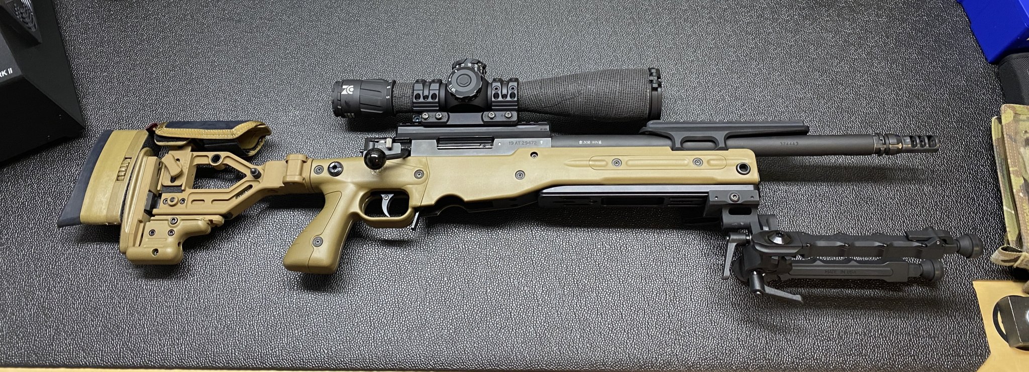

Wish I could find a AX chassis but here's my M2013 in a AT

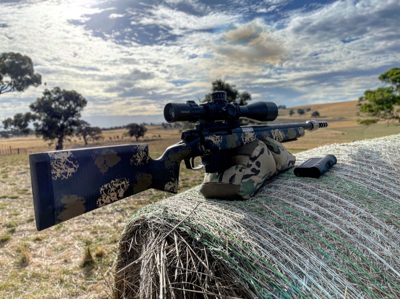

18" gap/Bart barrel, McMillan A3 Forest camo
Four in a nice little group and a flyer to remind you that your human😆 That is a great shooting rifle my friend. I look forward to shooting more of your ammo this summer😁

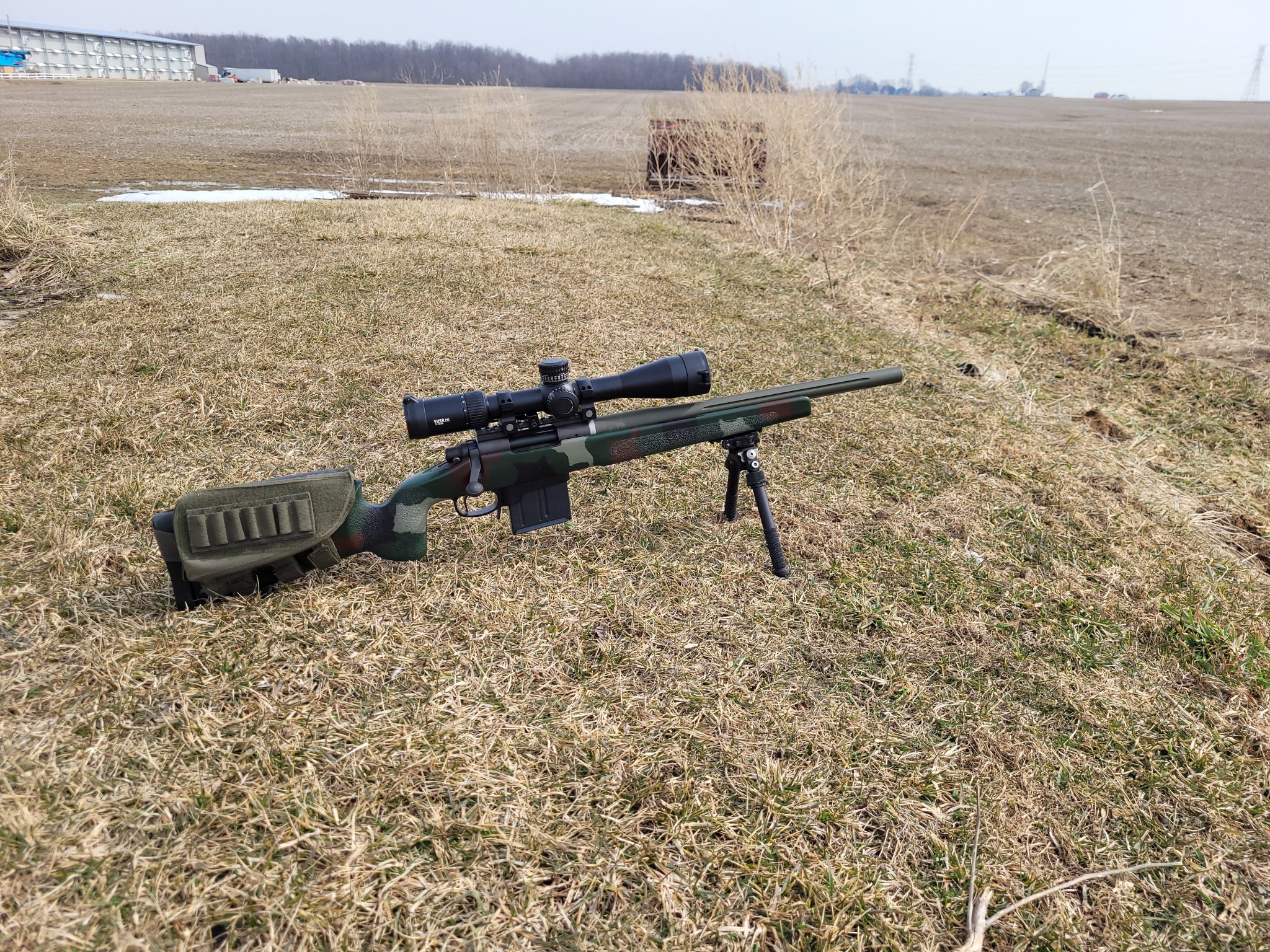

Not finished.
Still needs some cerakote on the barrel, the newer tuner brake and a Kahles 18i but it’s dropping roo’s like it’s nobodies business in the meantime out to 600m with just Hornady precision hunter ammo
Manners EH1 with mini chassis gap camo
ARC Archimedes action
Proof 16.5 inch 1-8 twist 308WIN
Withoutwarning tmb
ARC rings
Kahles 525i
Henderson arca rail
Triggertech 2 stage special
ARC mag
