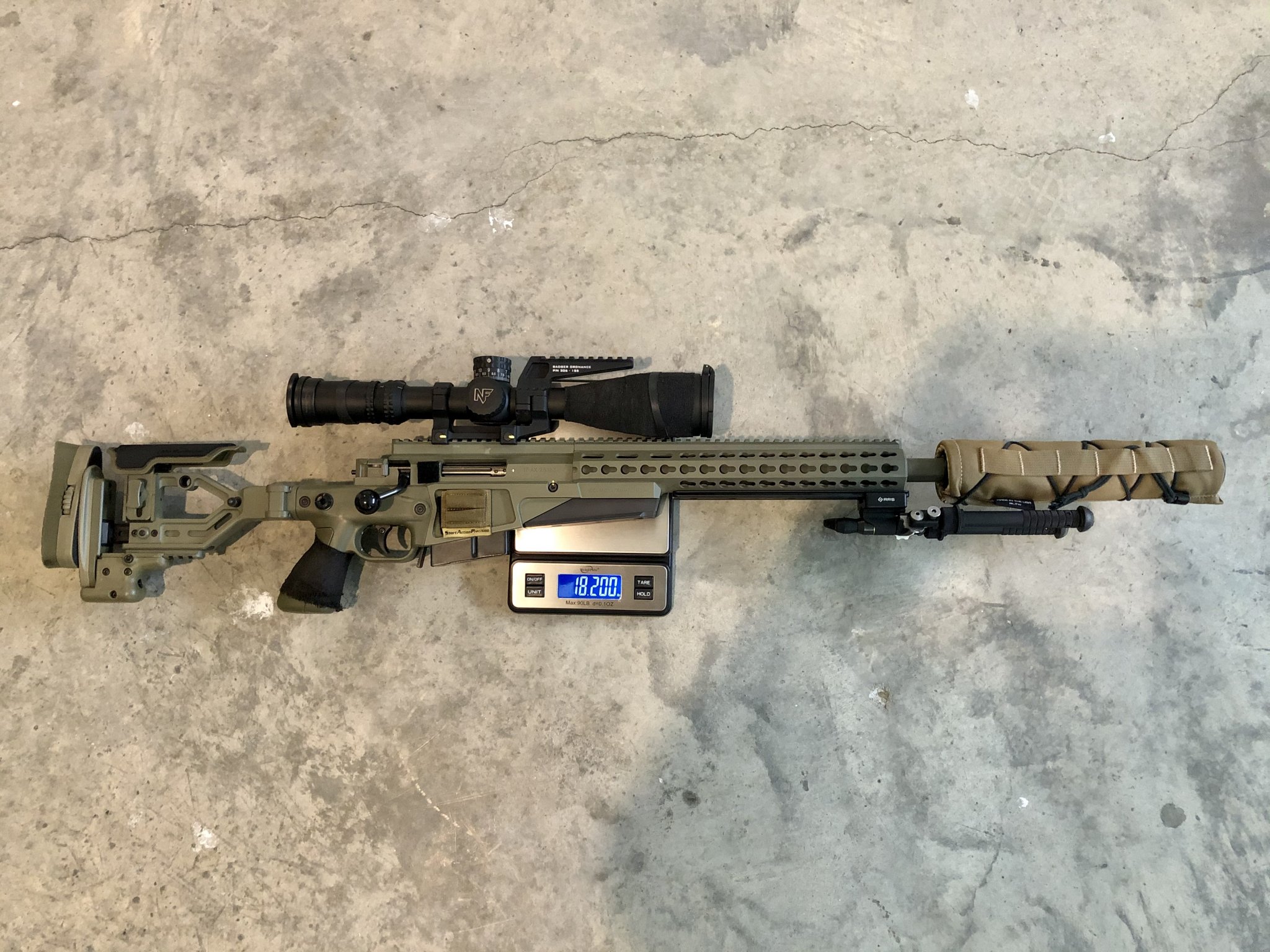

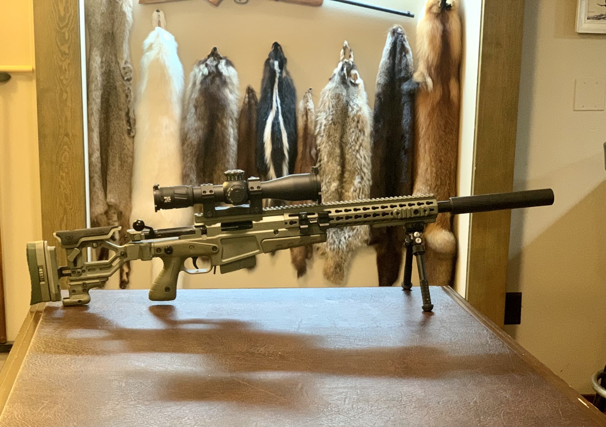

Looks like an NX8? You wouldn’t by chance happen to know what that setup weights would ya?
7-35 ATACR + 338 Ultra. Switching to the 4-16 ATACR and Dominus will save 1.5#

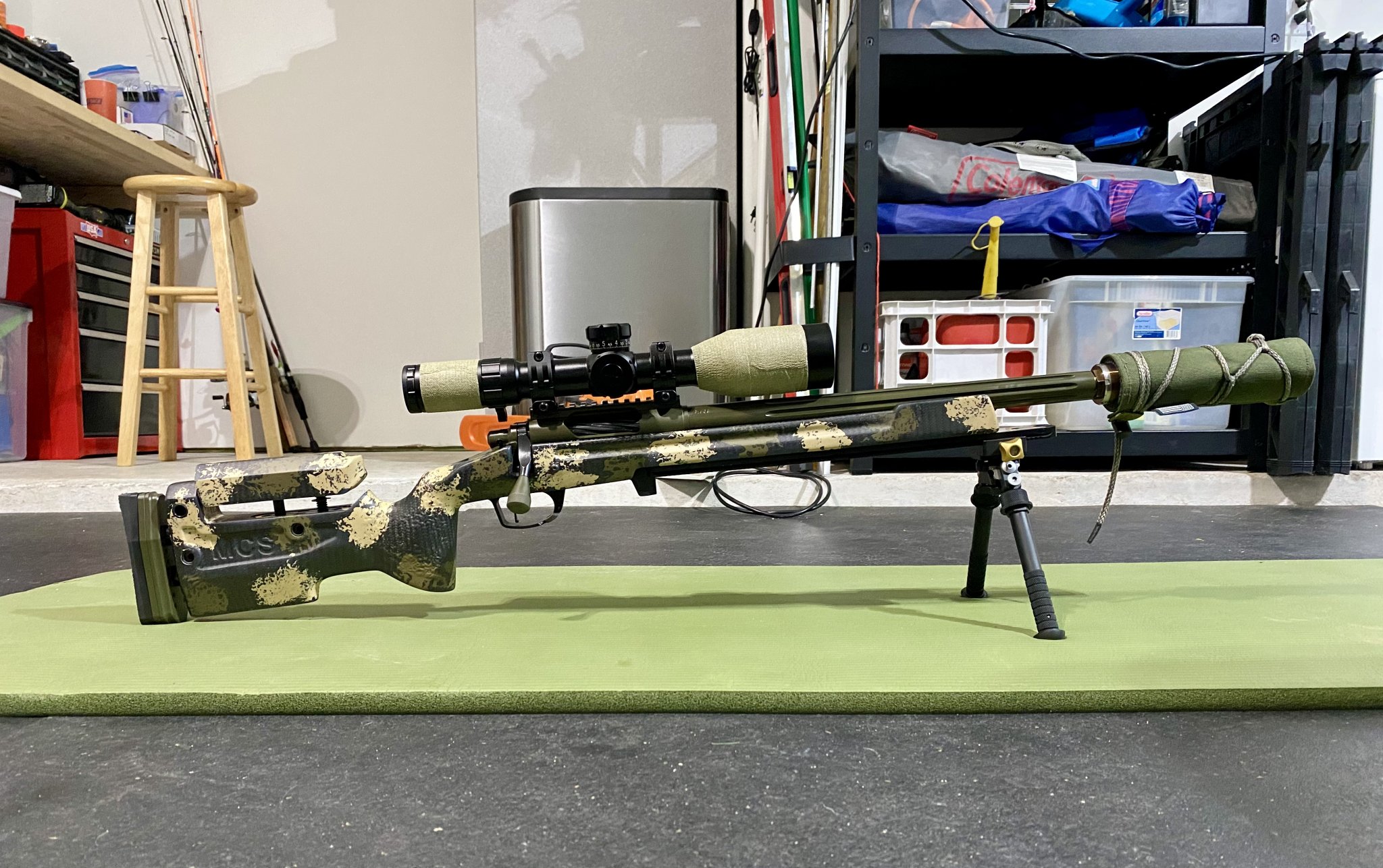

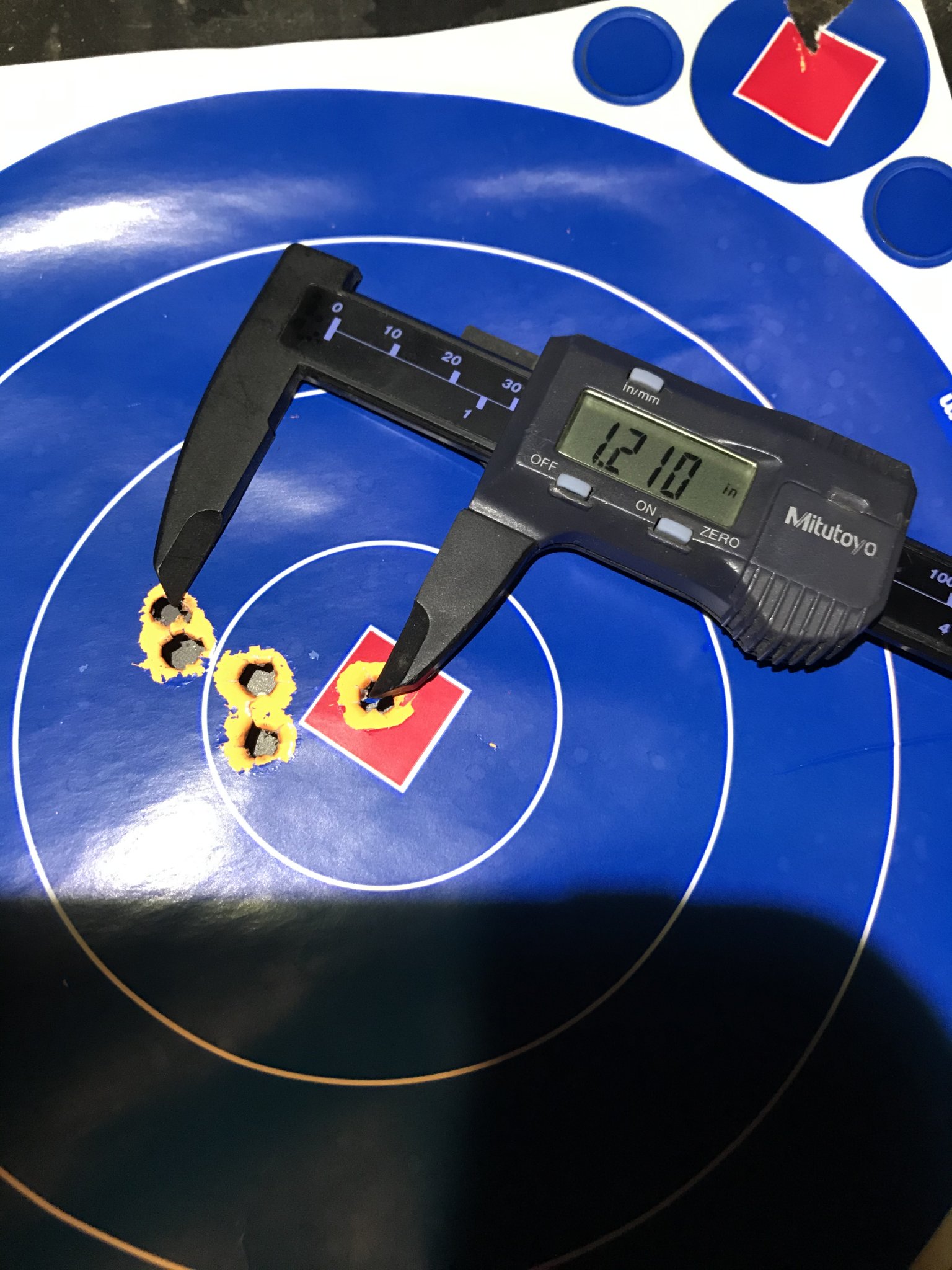

16.5 inch Bartlein M24 6mm Cm. Prime 107, 65 degrees. 2,757 FPS avg with SD of 7.2.
5 rounds 318 yards. This is during break in, about 50 rounds through the rifle.

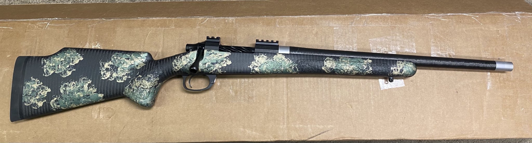

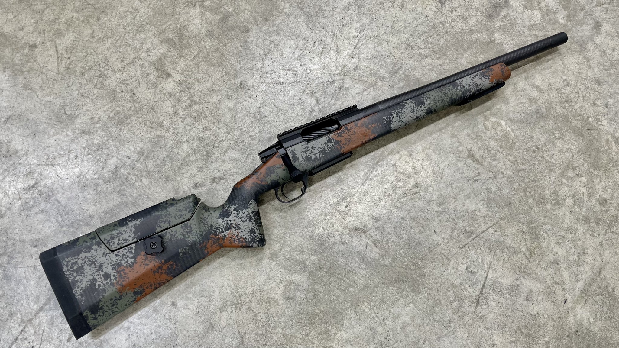

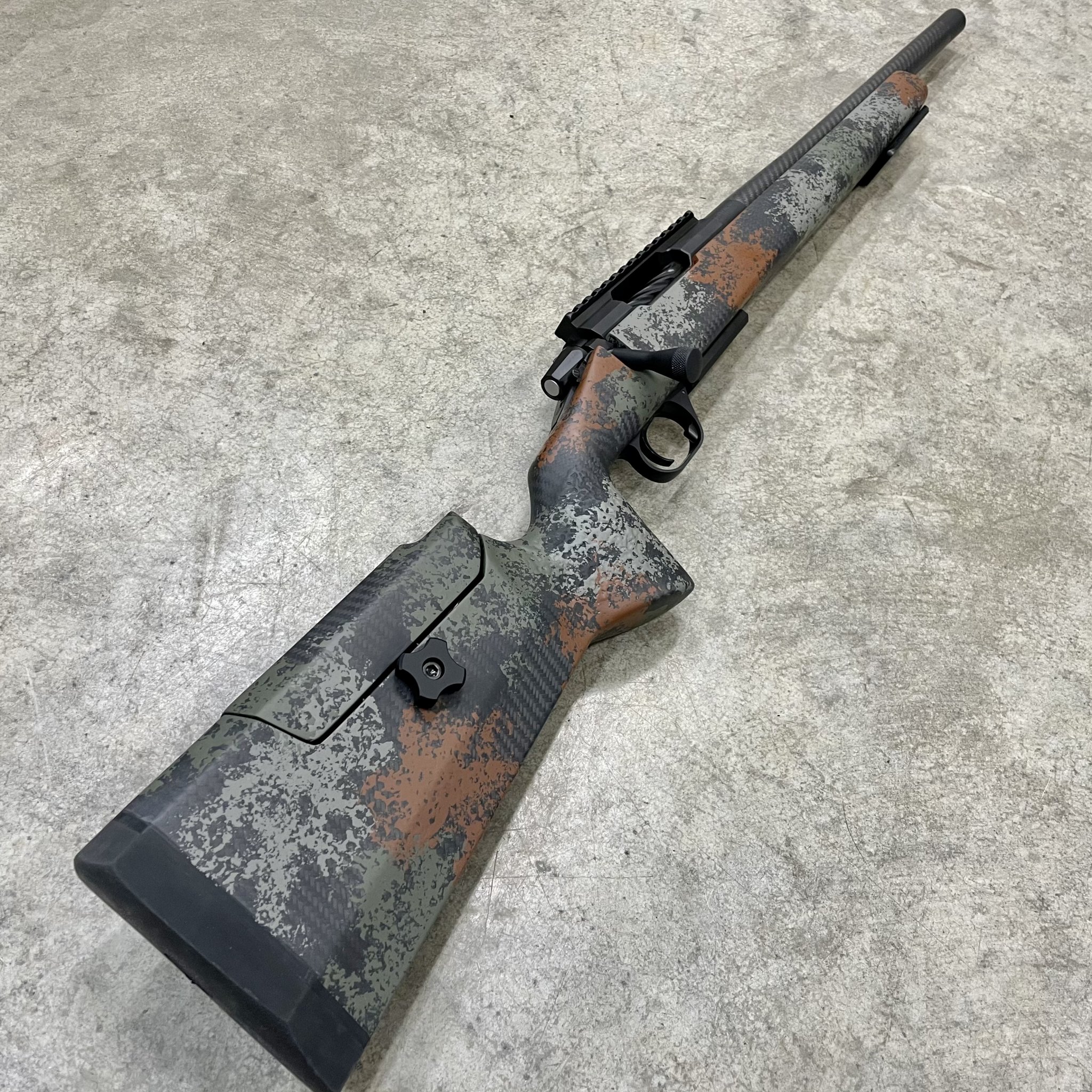

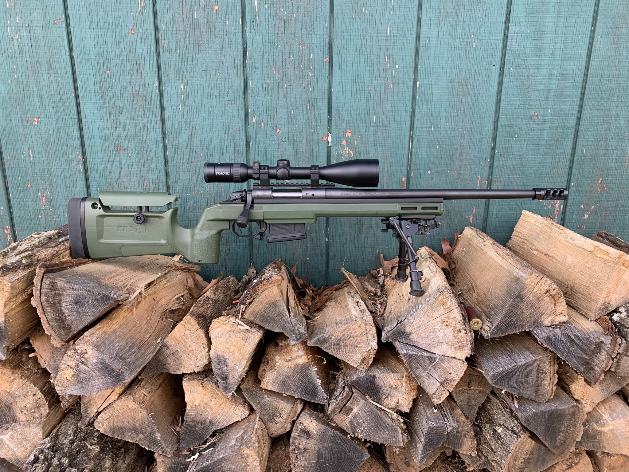

TS customs has 18” 6.5 benchmark carbons in stock as of a couple weeks ago. Had him use one to spin me up a shorty. My build is similar to yours.
manners eh1a
Lone peak fuzion
18” benchmark carbon
TT special pro curve 2 stage
Hawkins flush dbm
Arc rings
K318i
Travis just sent me these pics, build is done and looking fine! Should get it end of this week or next
