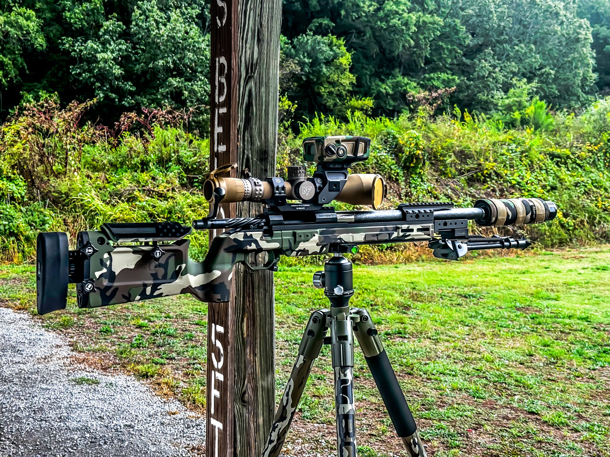

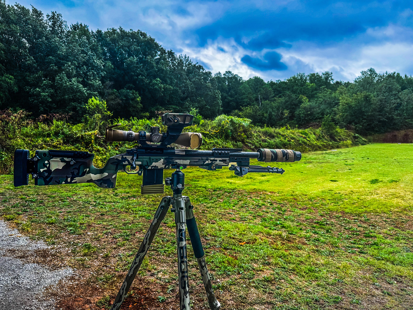

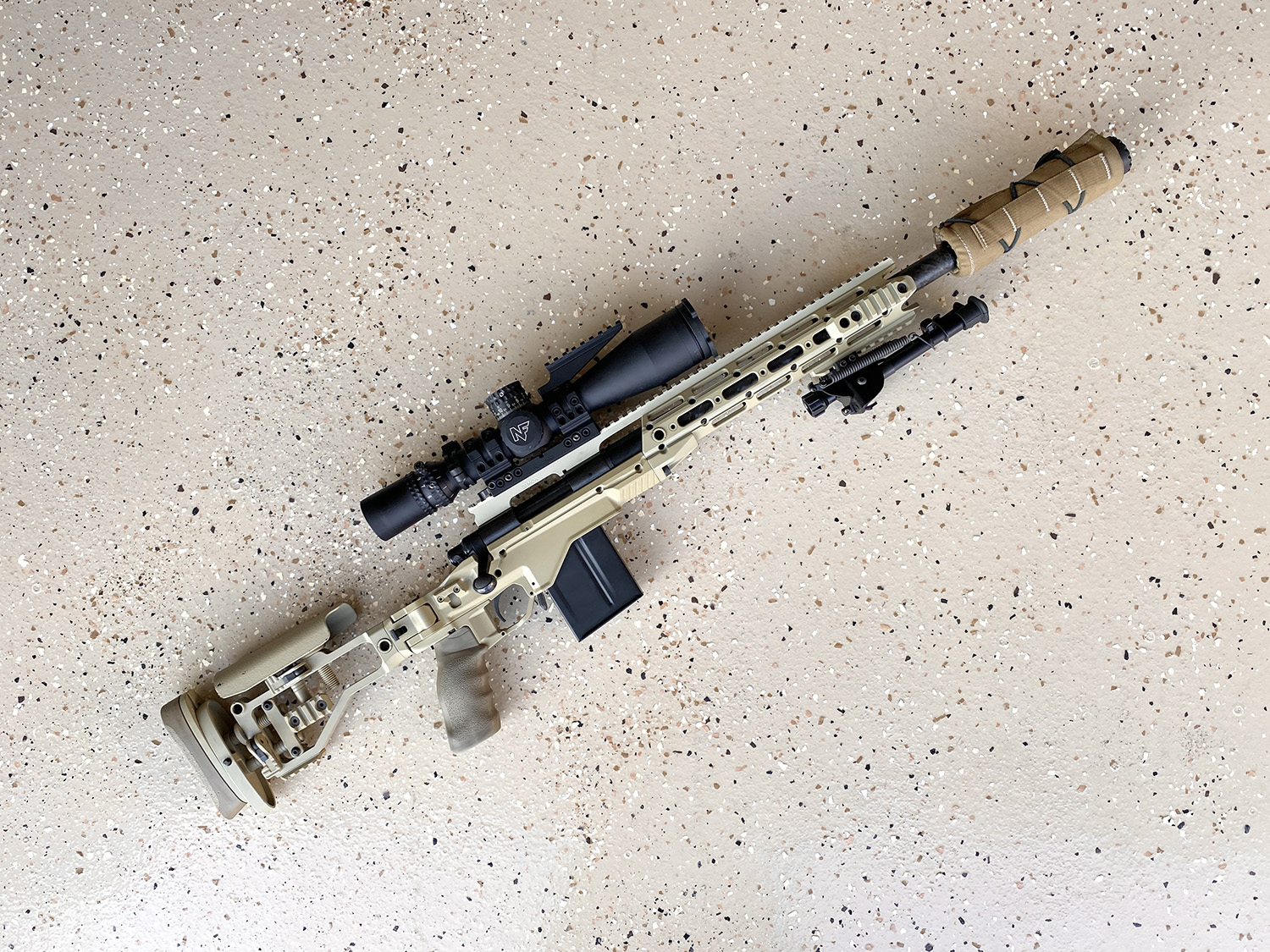

What caliber is that? Looks great! How do you like that chassis? folder robust and lock up tight?
Thanks! It's 6.5 CM right now, it came with 24" 308 barrel which I have as a backup. My only minor gripes about the chassis are it not having an integral arca rail and the cheek riser interfering with bolt removal if it isn't folded. The lockup is rock solid though, not even the slightest play. All in all I think it's an amazing setup and am very happy with the purchase.
Awesome! great to see other folder options out, how's the weight on it?

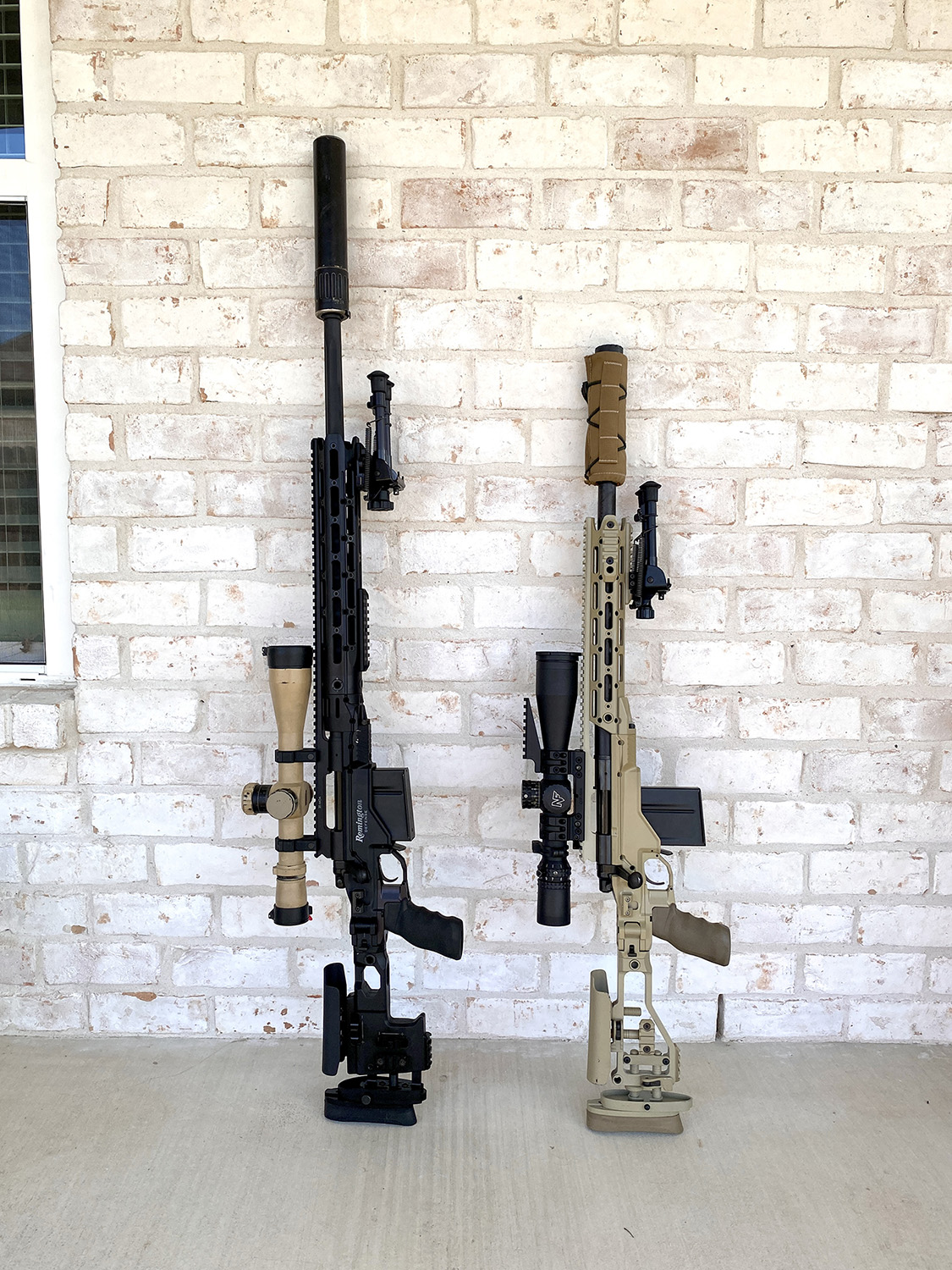

Here's mine. Seekins Havak Hit with an 18" MTU. Swapped the vertical grip out for an Ergo Deluxe, trimmed the cheek rest so I can remove the bolt without folding it, Area419 bolt knob with extension, Crosstac MK109 brake. I'm currently working on designing a full-length fore-end enclosure to 3D print for it. I had some problems getting the barrel done by Straight Jacket initially, had it fixed locally and it's a fuckin' hammer. Best group was 0.24" 10 shot group with factory ammo. Once I can accept funding the ATF I'll get a can for it.
Looks awesome. What’s the weight on it? I have one of these, having a 16.5” 6.5 PRC carbon fiber spun up for it by Mos-Tek, can’t wait. My only gripe is the bolt binds pretty bad for me but may go away once it break it in. Have you run into the binding issue?

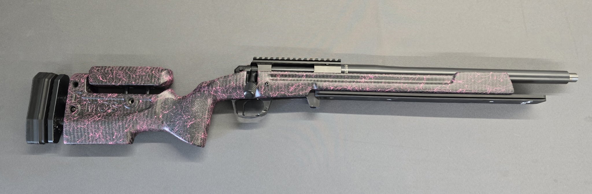

Got out to the range really quick this morning headed to work. I needed to function test an AR I built, but had about 5 minutes to set this up and shoot it real quick. Boresite to a large rock at 100 yards, shot, missed, realized I didn’t account for height over bore, dialed around 2 mils, shot again, rock exploded. So she’s minute of rock right now with 143 ELD-X. Then I fired 5 rounds of 147 ELDM and chronographs that. Those were doing 2600-2650fps. Barrel had 50 rounds in it when I bought it, and I shot 8 rounds today just messing around. When I actually have time to go properly site in, set my scope, and shoot groups, I’ll get batter data, but just messing around that puts me about 45-95fps slower than Hornady 147gr ELDM 6.5CM per the box velocity at 24”. So I’m right under 24” creedmoor performance in a 16.5” PRC. Hope it speeds up a little. Hornady lists the same load for the PRC as 2910, which puts me 285fps slower than advertised 24” velocity, so a loss of 38fps per inch. I’m thinking for factory ammo, maybe an 18” might be a better option to match 24” creedmoor with factory ammo. I don’t reload, wish I did. Hopefully it speeds up a little once broken in. This is my first experience with the 6.5 PRC but my initial thought is I love it. Off the tripod suppressed there’s like 0 recoil. Reminds me of my Tikka Tac A1 18” 6.5 CM.
Got out to the range really quick this morning headed to work. I needed to function test an AR I built, but had about 5 minutes to set this up and shoot it real quick. Boresite to a large rock at 100 yards, shot, missed, realized I didn’t account for height over bore, dialed around 2 mils, shot again, rock exploded. So she’s minute of rock right now with 143 ELD-X. Then I fired 5 rounds of 147 ELDM and chronographs that. Those were doing 2600-2650fps. Barrel had 50 rounds in it when I bought it, and I shot 8 rounds today just messing around. When I actually have time to go properly site in, set my scope, and shoot groups, I’ll get batter data, but just messing around that puts me about 45-95fps slower than Hornady 147gr ELDM 6.5CM per the box velocity at 24”. So I’m right under 24” creedmoor performance in a 16.5” PRC. Hope it speeds up a little. Hornady lists the same load for the PRC as 2910, which puts me 285fps slower than advertised 24” velocity, so a loss of 38fps per inch. I’m thinking for factory ammo, maybe an 18” might be a better option to match 24” creedmoor with factory ammo. I don’t reload, wish I did. Hopefully it speeds up a little once broken in. This is my first experience with the 6.5 PRC but my initial thought is I love it. Off the tripod suppressed there’s like 0 recoil. Reminds me of my Tikka Tac A1 18” 6.5 CLil?
Dude, that paint job is tits. Who did it.
All my rifles need to be that way from now on, I can't unsee it lol.

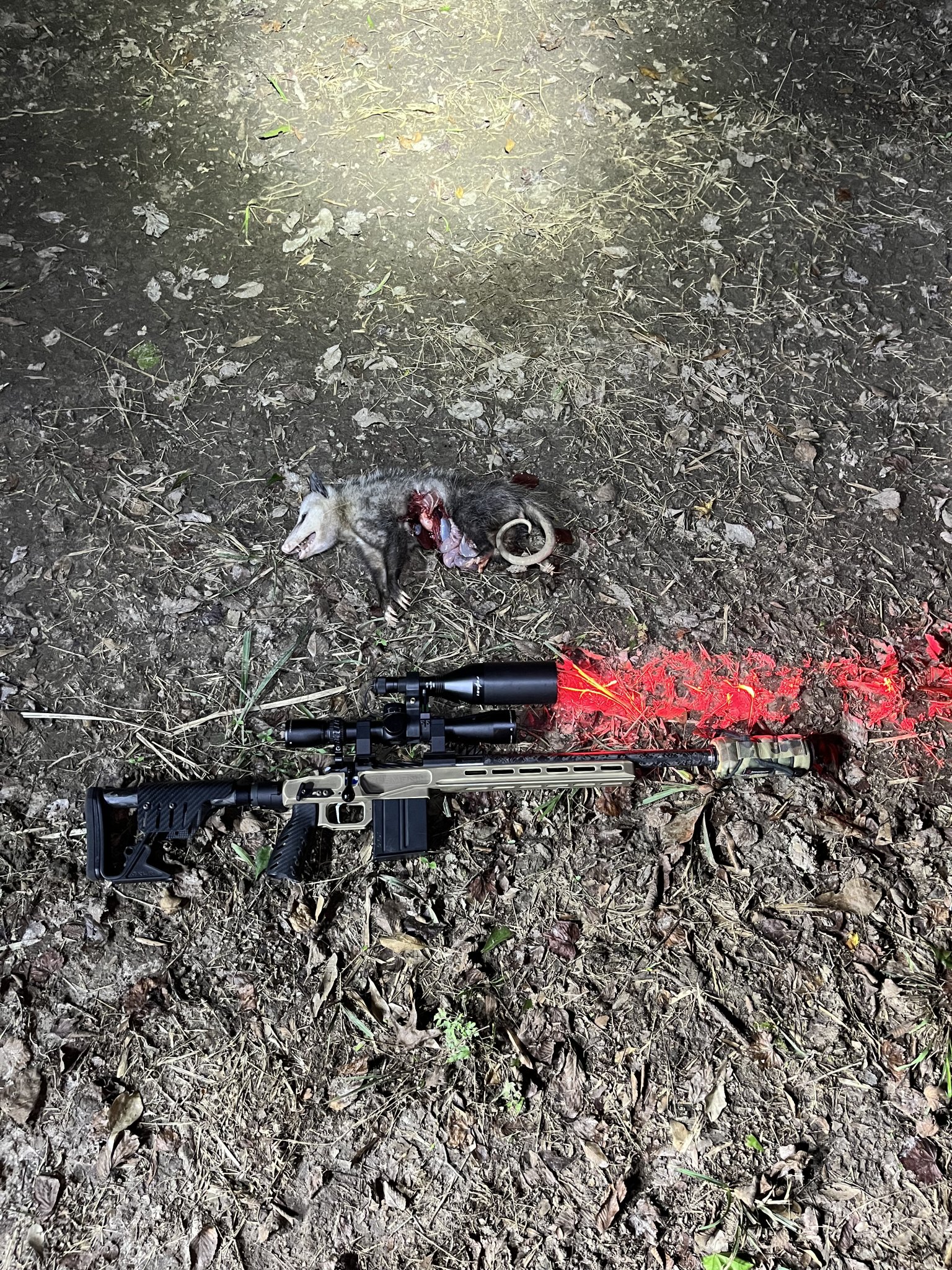

@MxTexas I recently built a 16” 22br, slowly working on getting a load worked up for it but love the form factor.
I went 22br due to state requiring 22 cal for predator hunting during big game season, otherwise I might have gone 6br/dasher.
I hit pressure around 2800fps with 88eldms so I backed it down to 2750 which happens to exactly match my 26” 223 match rifle.
Got its first blood over the last couple weeks. Possum, 2 recovered pigs and 1 that my amigo hit in the guts and we were unable to find. The 88’s are pretty nasty.

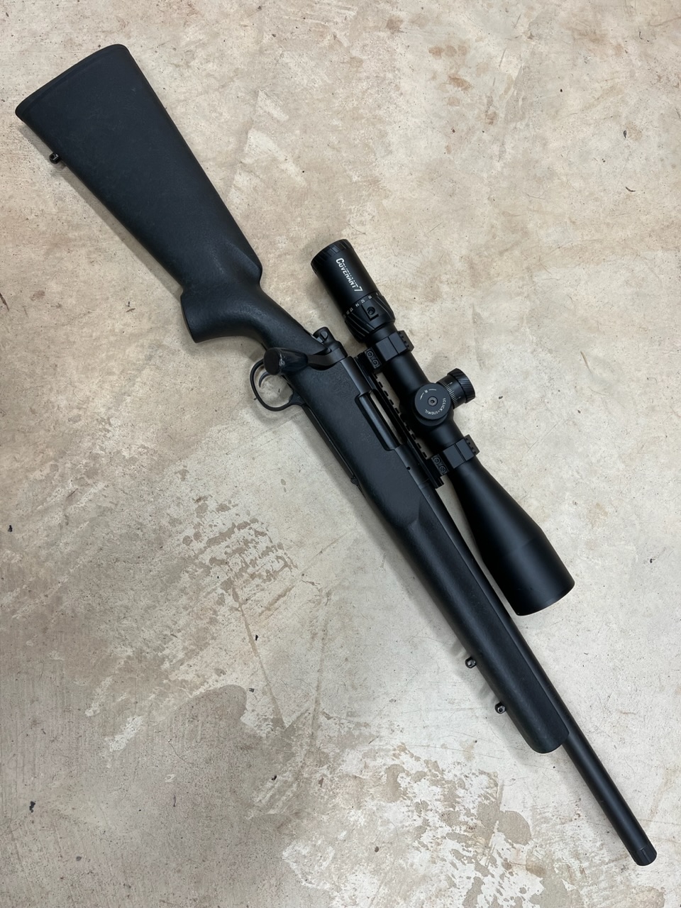

Another cool option is the 223ai with 75’s, I don’t have my data but I think my old tikka was running 75eldms around 2650 out of a 16” 223ai. I could be off on the numbers but benefits of super cheap brass, bullets, barrel life, sips powder.
Sounds like this is just for fun and what’s more fun than a 223 that’s cheap, lasts forever and has no recoil. 700 would be plenty doable but a little more challenging.
So I got some weights on mine for those curious.
Rifle w/ barrel removed, no optics, Seekins ARCA rail and NV Bridge - 7lbs 6.2oz
Factory 24” 6.5cm Barrel w/ A419 Hellfire Match - 5lb 11oz
Factory 24” 308 Barrel w/ A419 Hellfire Match - 5lb 10oz
Burris XTR Pro in a 1.18” 34mm Seekins HIT Mount with level and dive board - 2lb 14.8oz
Vortex Impact 4000 - 1lb 0.8oz
SiCo Omega 300 w/ A419 Hellfire Adapter - 14.4oz
Total Rifle Weight as configured above - ~20.5lb.
I have a 16.5” 6.5PRC Carbon Fiber M24 profile barrel on order for it. I’m hoping it weighs in around 2.5lb. That would put it at 10.39lbs rifle with A419 brake. Depending on the scope setup, it would be possible to get this thing right at 12lbs I would think. With suppressor more like 13lbs.
As already stated, the folding stock lockup is very tight. Only issue I have with mine is the bolt binding.
Thanks! It's right around 15 lbs right now. I've run into the bolt binding if I apply any upward pressure while cycling which I understand is a consequence of the full diameter bolt body. It also hangs up if I fully insert the mag with the bolt open but I haven't messed with adjusting the catch yet. If that doesn't work I might 3d print some sort of solution to limit the magazine insertion. Overall though I absolutely love the rifle and Seekins is a great company staffed by great folks.

Gun is going for coyote and is the 16in action that Currently riding in the pink tcs (wifes/next excuse for a build)
Thoughts? And yeah im a manners whore
