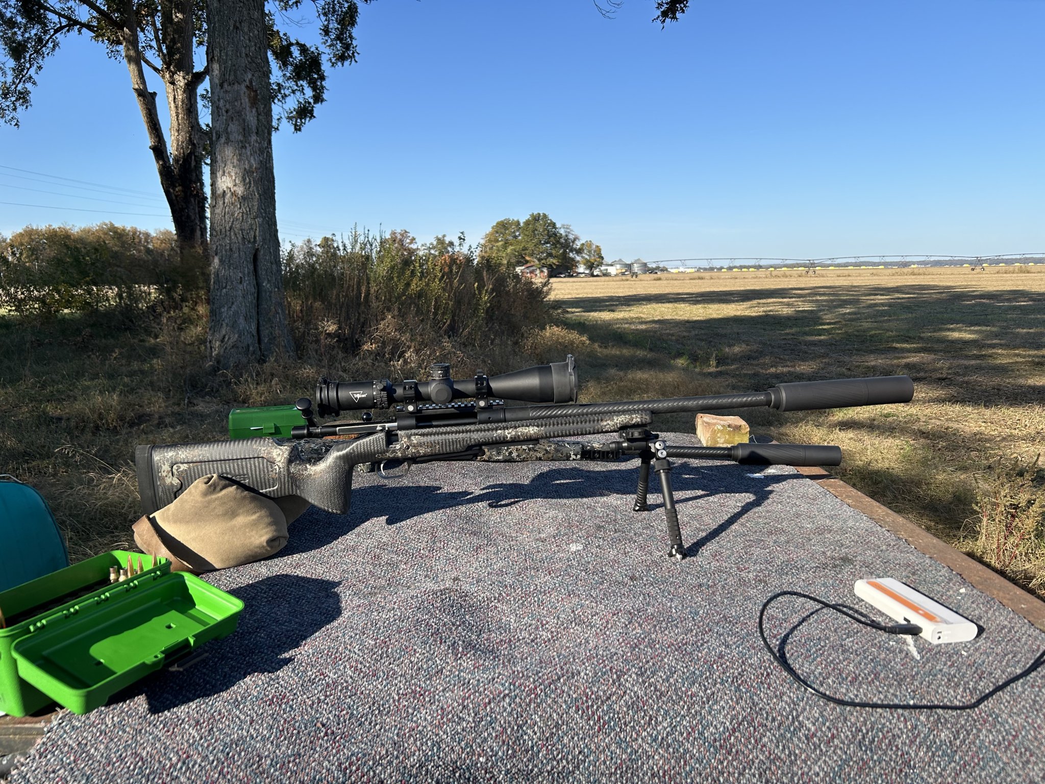

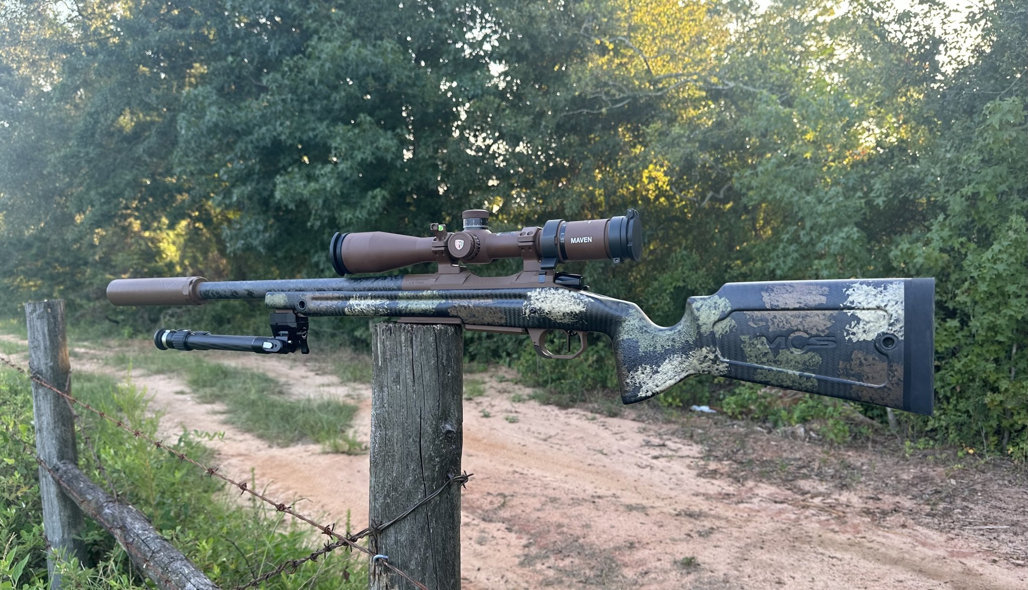

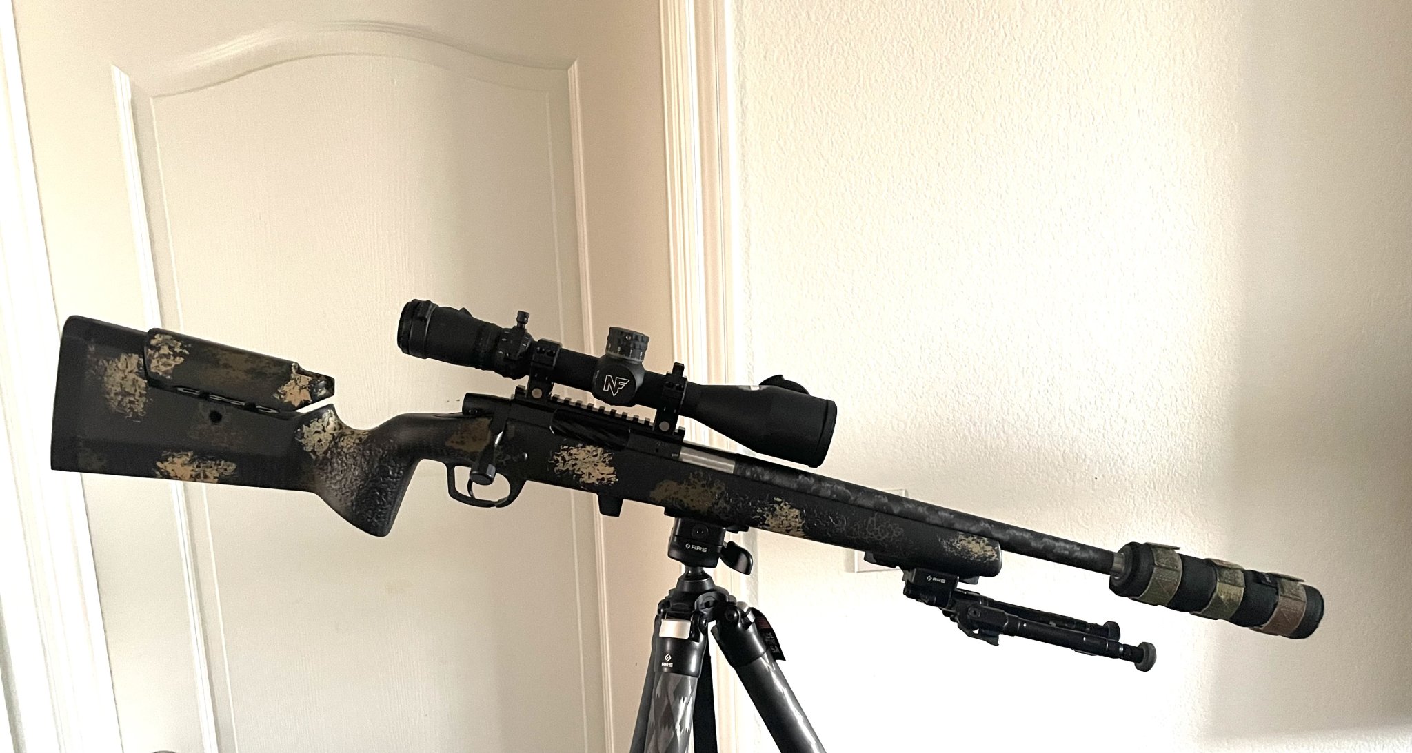

16.5” 22CM build. Heading to Wyoming this Friday for a mule deer hunt for its maiden voyage. Getting 3150 from 75gr ELD-M’s. So pleased with it I am building a twin to dedicate to night hunting. The Falkor LW7 is the craziest smooth action I’ve ever felt. Feeding is incredible.
Love the cerakote color on that rifle. Well done!

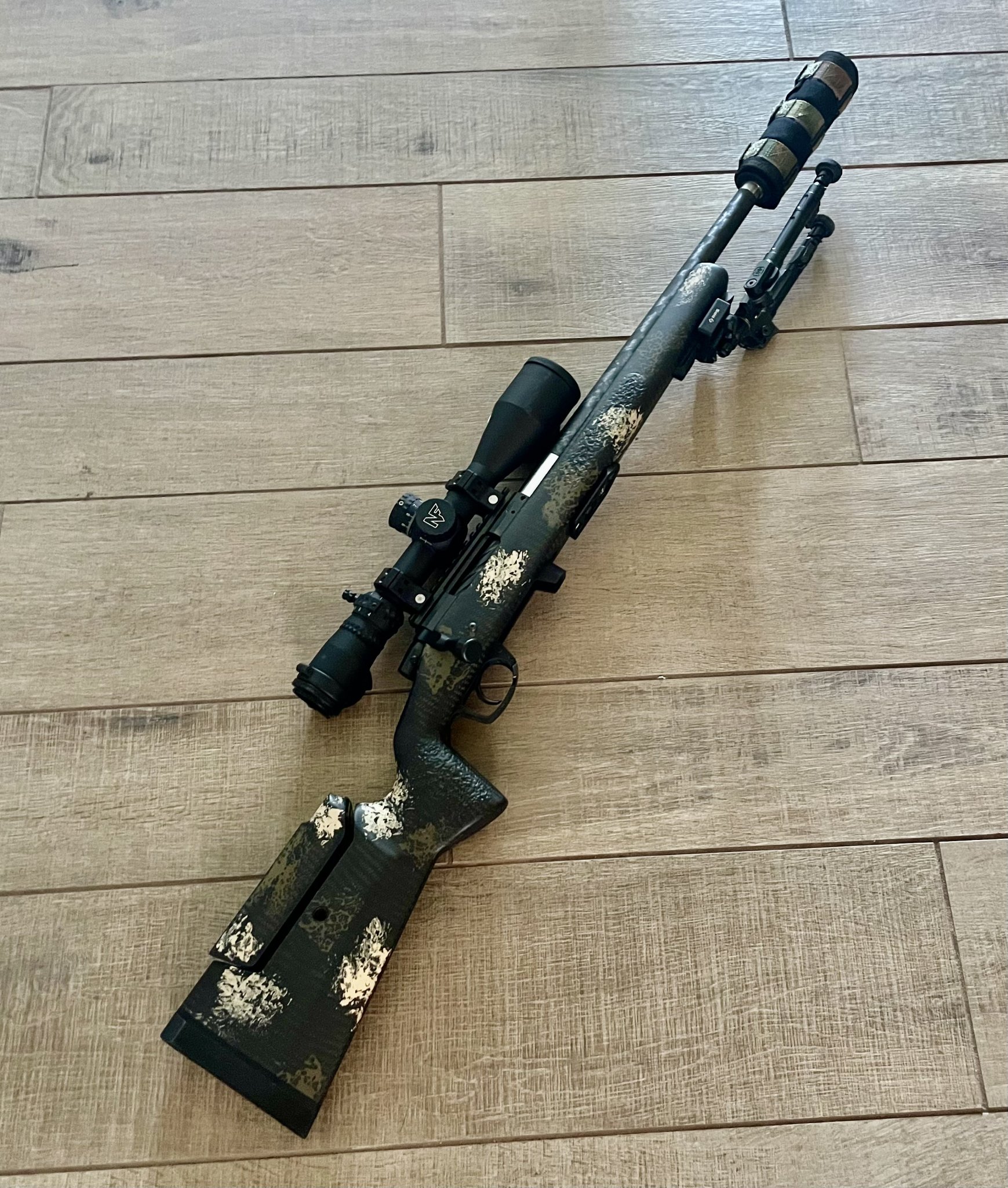

I’ve tried N150 I got to top viht load with poor obturation
RS62 42.7gr only 2700fps grea lt accurate load but I was hoping to get 3000fps
My barrel is a bit longer than 18” allowed on the shorty thread… but still short for a 6mm creedmoor

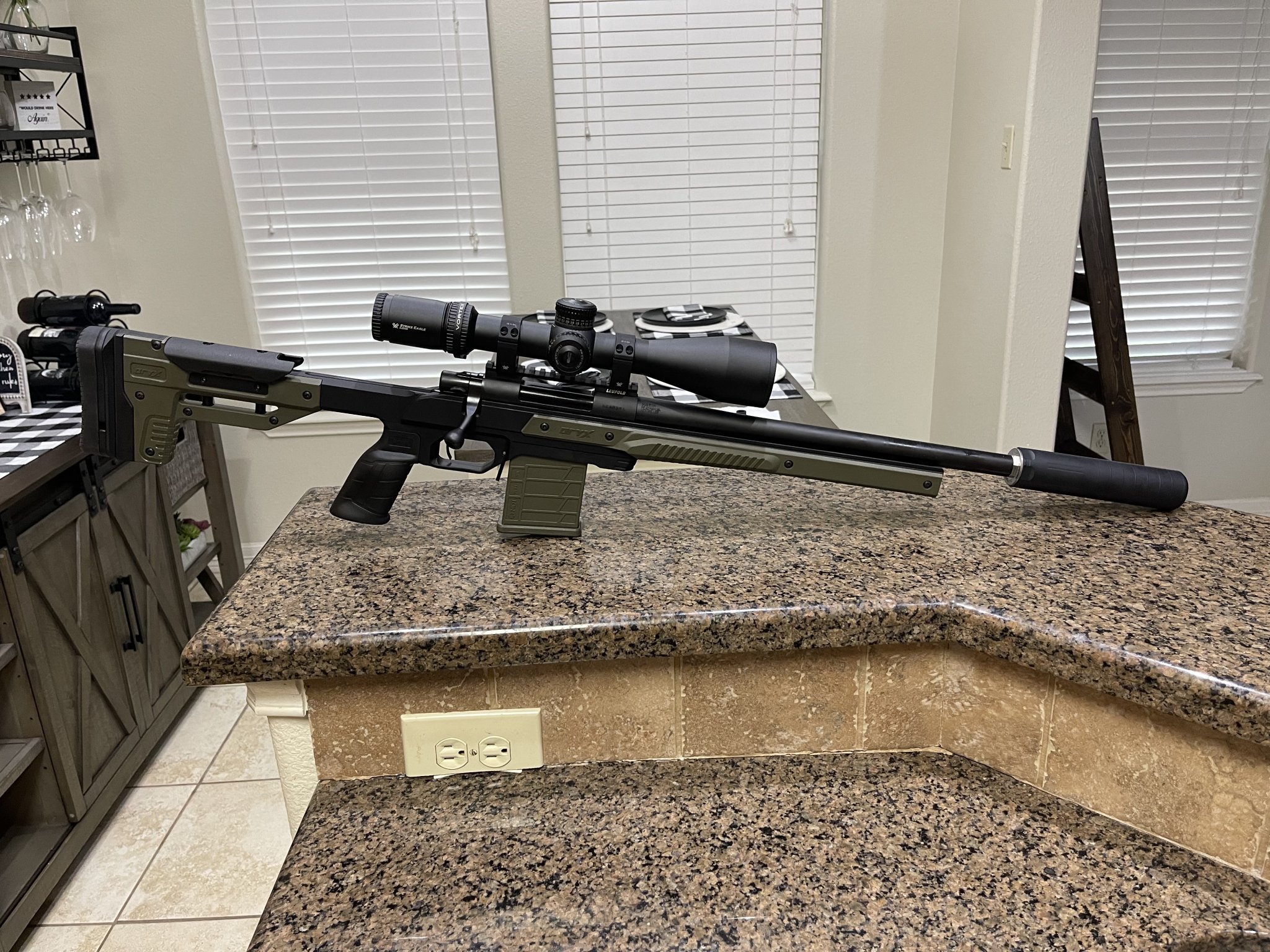

Trying to put together a budget setup for some deer and hog hunting. Have right at $2K into it so far.
Howa 1500 .308 16.25” barreled action
MDT Oryx chassis
Vortex Strike Eagle
DDC Enticer S

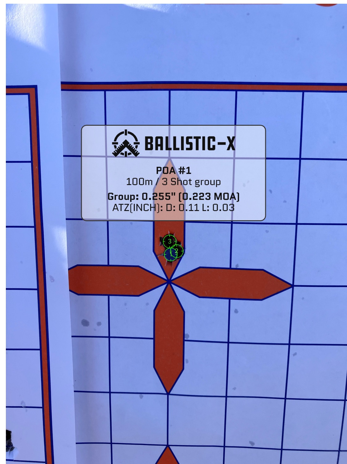

This was mine with the factory barrel still on.
15 rounds under an inch. 14 would have been 3/4

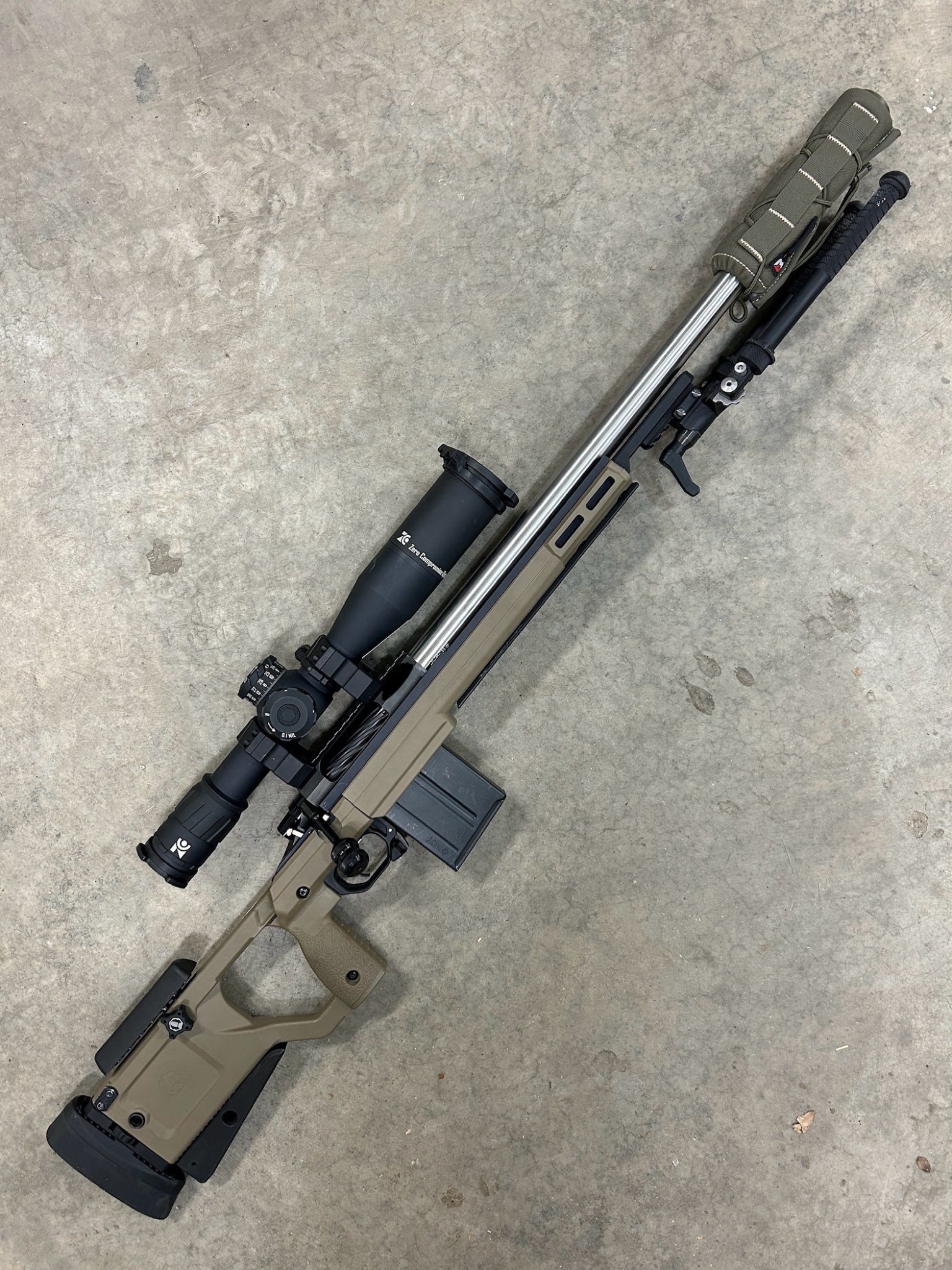

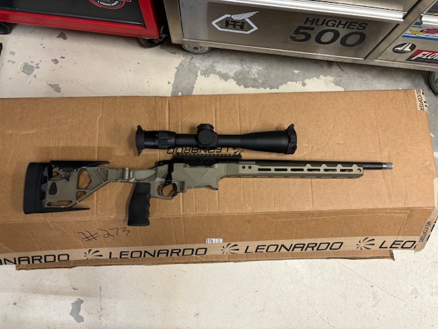

Probably one of the more unique builds I've done. This was originally a 22" 308 that sat in a McMillan A5 and then a KRG Bravo. I realized that I rarely do distance shooting, so it might make more sense to size down. Was hoping to get it to fit in a tennis bag, but it's just slightly too long.
Origin SA
JTAC Ind. Screech Owl Chassis
PVA 16.5" 6.5cm Med Palma
Nightforce NXS 2.5-10x42
Sitting at ~11lbs with everything. Might try a cf barrel in the future to shed some weight.
This is slick! One of these days I will do a build off that chassis, not sure on that collapsing stock though.

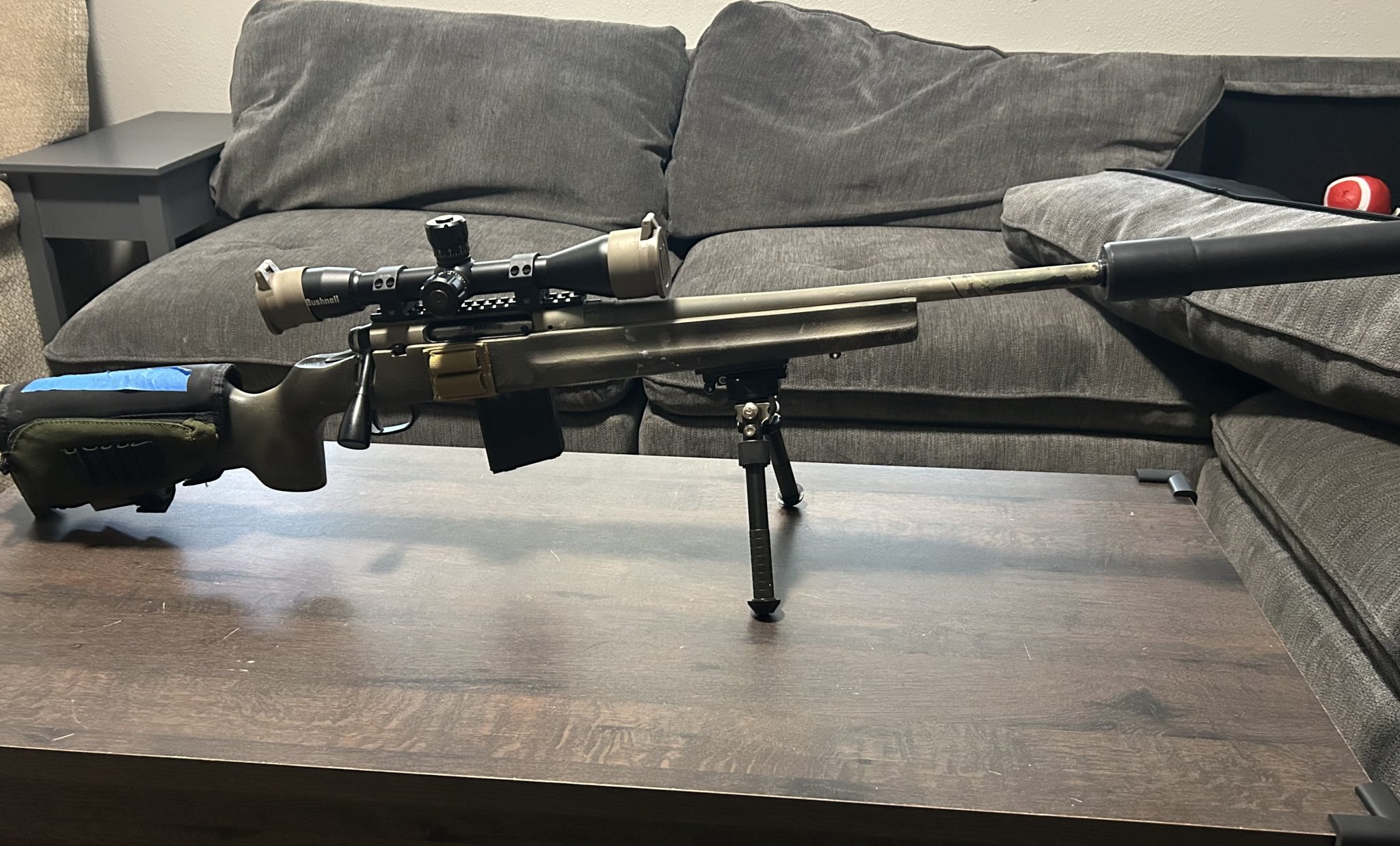

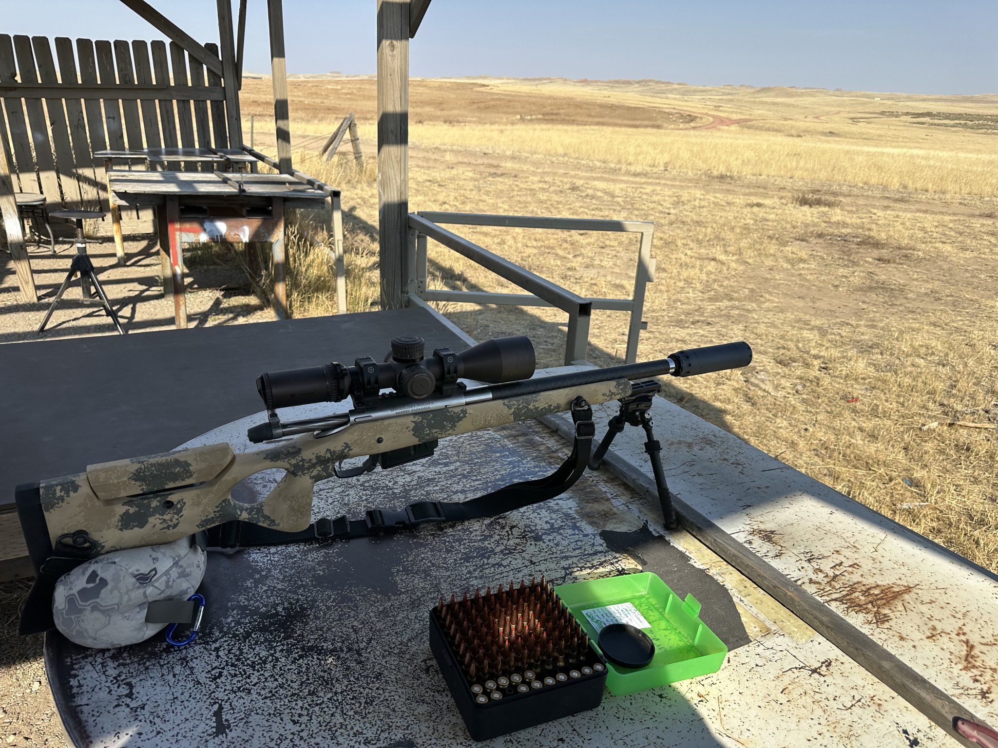

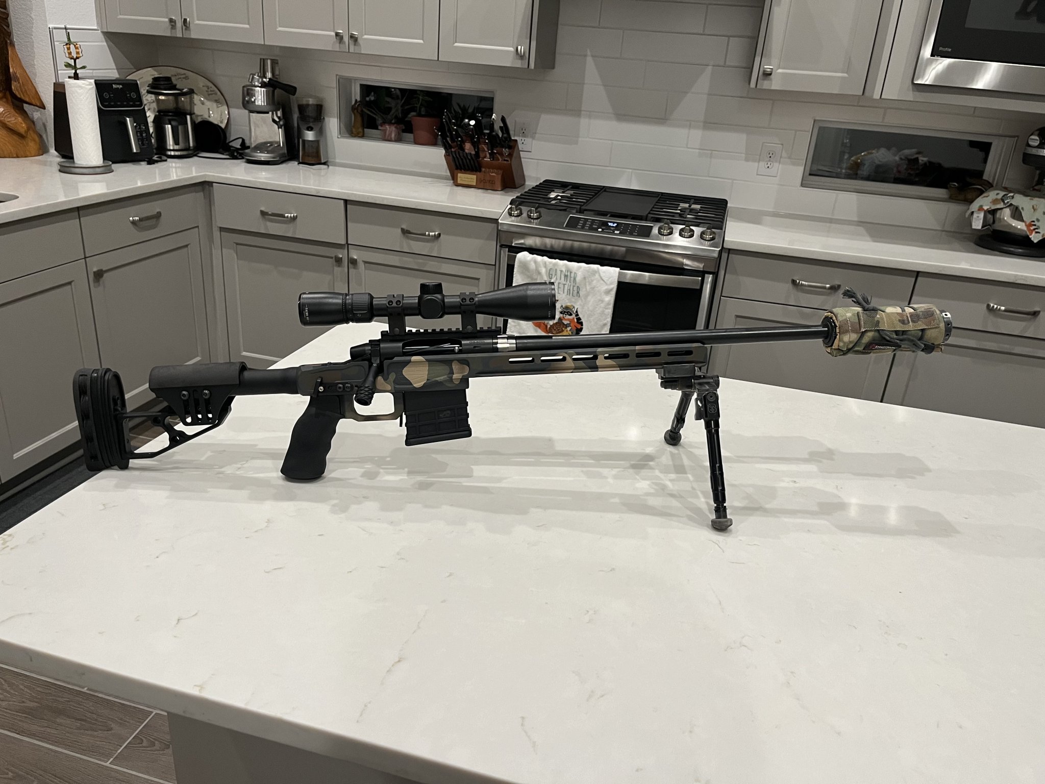

lol, Terminus Zeus SA, Manners EH1A with mini chassis, Proof Research 6.5 CM spun up by S&S Precision in Denton, TX. Mikael has done most of my rifles and all are hammers. Running a TBAC Ultra 7 with NF NX8 4-32. Hawkins 1 inch high rings, Cole-Tac suppressor cover. Bought the Zeus and Proof from FrontRangePrecision.

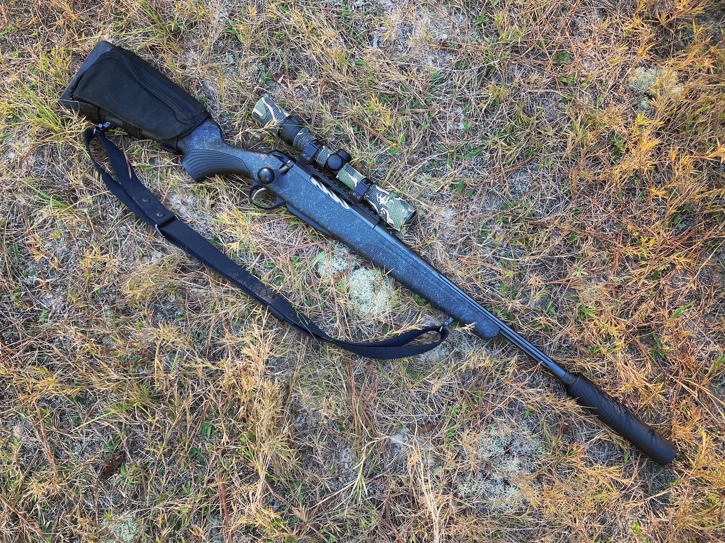

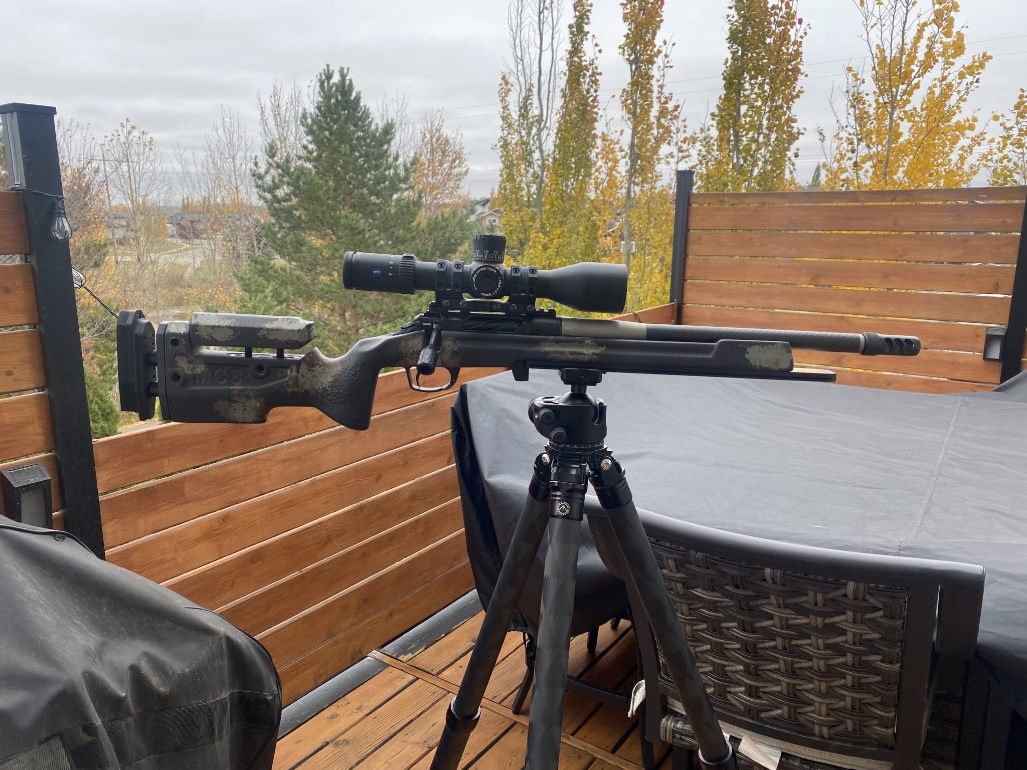

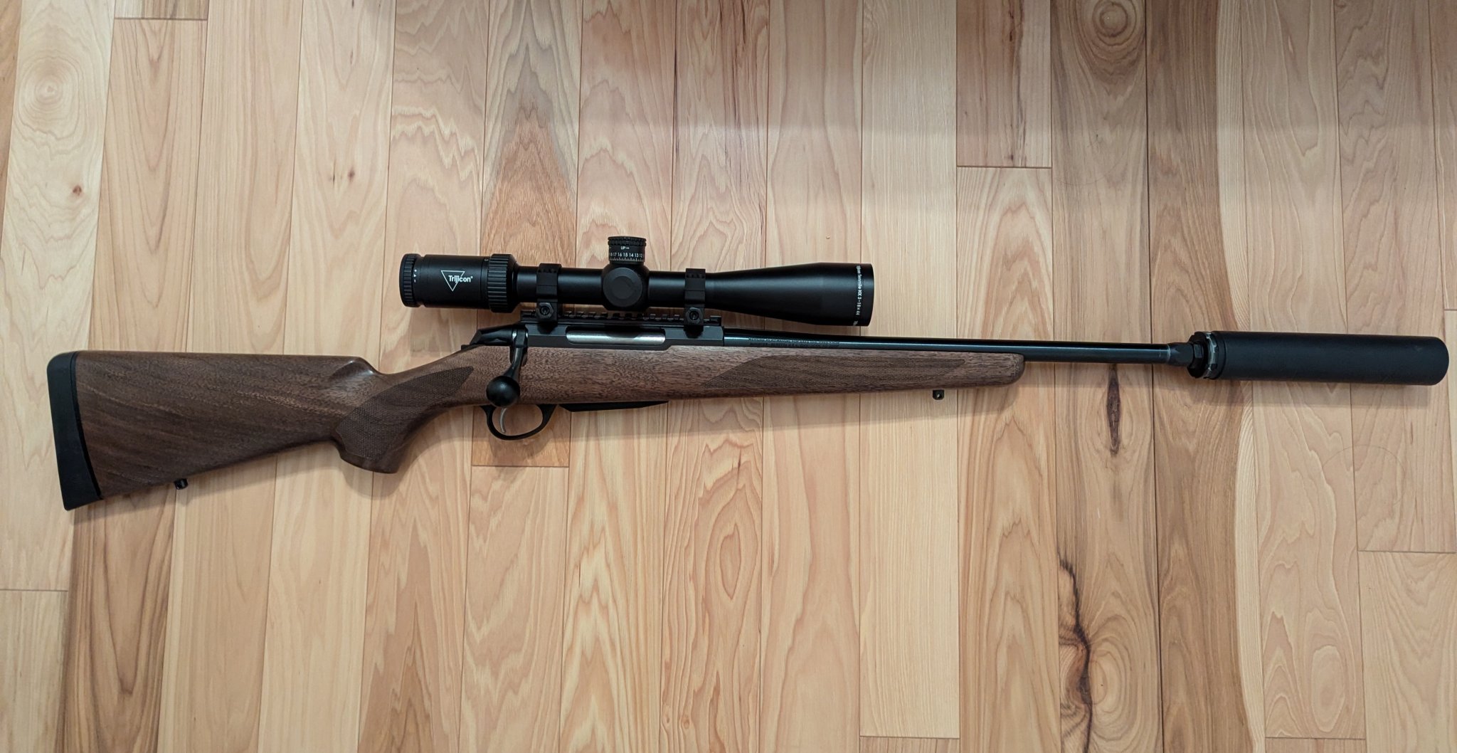

While much less exotic, figured this thread could use a classic. T3X Ranch Rifle. Currently has a Dead Air Primal on it, but will be getting a Griffin Sportsman UL to lighten it up even further. Scope is a Ten Mile 3-18 FFP which despite its length is actually quite lightweight.

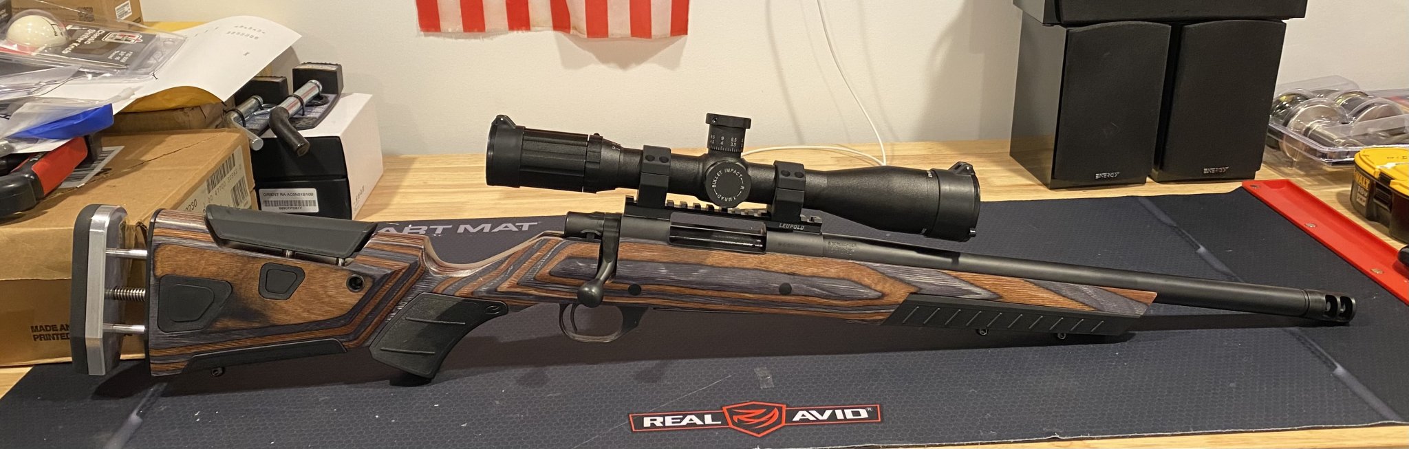

Just finished throwing together this general purpose, critter gitter, plinking, fun gun. Howa 16.25” 6.5 Creedmoor heavy barreled action from Brownells. Pillar and glass bedded into a Boyd’s At One stock. Mounts and optics a mixed bag of leftover Seekins rings, Leupold 20MOA rail and a 3-15 SWFA. Hoping to push 130 ELD-Ms to 2500-2550.

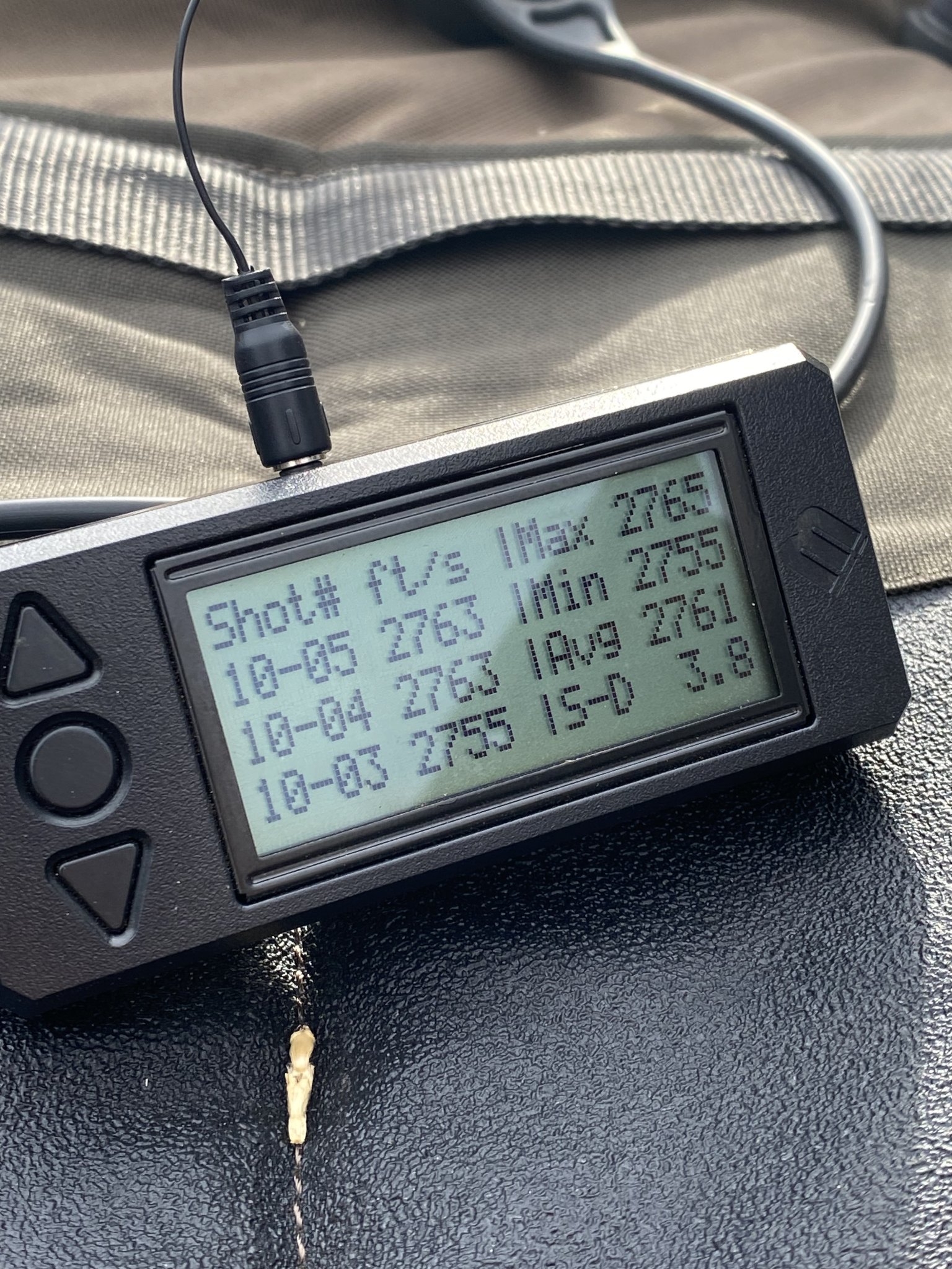

2867, I'm using 26.4gr cfe223. I have loaded them hotter with good results but I decided to keep it simple. No need to load hotter and longer.
That looks similar to what a 22ARC is pushing the 88g ELDM loading with a moderately charge out of a 24in barrel. For my use, I would either run the 22ARC at 20in to get 2720~2750fps for the actions with .441 bolt. But for a shorty, a 18in 22BR pushing the 88g eldm at ~2860 is nice.
I also picked up a T3X ranch in 308. Threw a Swaro 3-9 on top and it's already produced as a hunting rifle. No regrets, this one looks like a keeper.
