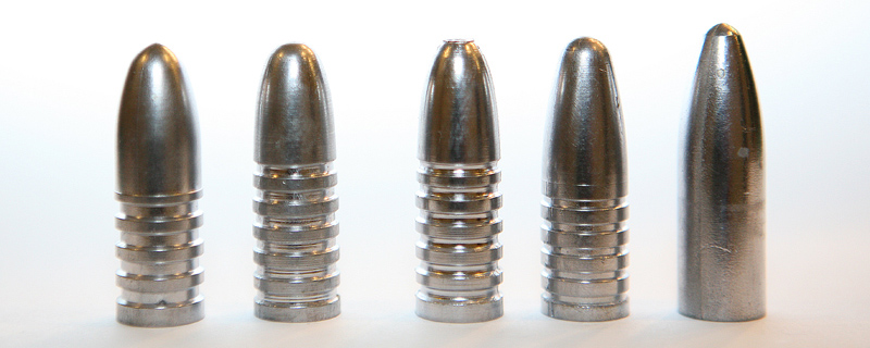

Collection of bullets from 45 cal molds I have accumulated over the years: Paul Jones Creedmoor, NEI Gunn 349c, 349C nose pour, PJ Money & PJ Money paper patch. I had Brooks make a mold for a paper patch with two diameters so that when patched it can be both bore & groove diameter. Just a long range target round that I haven't had much time to experiment.
Have ~ a dozen PJ moulds - hunting bullets, money, experimental .... my goal in retirement is to take my 1874 and 1877 shilohs and the moulds and get lost in them for months.

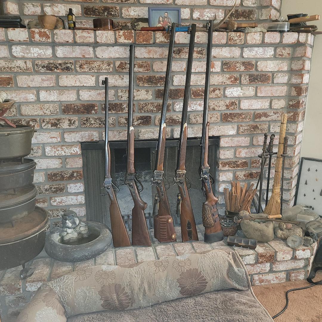

I'm going drop this here.
I just brought home the center Sharps in this family portrait this evening. It's a C. Sharps Sporting rifle with a 34" octagon barrel. Pristine and never been fired. Chambered in 50-140 Sharps. I didn't really want this calliber, but I got it for a song and I can always rebarrel it.
The Quigley on top is a 45-70 made by Pedersoli. I dearly love shooting this gun, and it's started an obsession with me.
The bottom gun is a .17 HMR, also made be Pedersoli. I got it to shoot it when my shoulder needs a rest.
I am so freaking jealous! Beautiful line up of rifles.

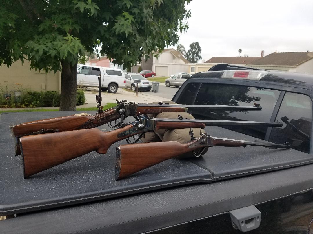

I've added two more Sharps since I last posted on this thread; Another Pedersoli Quigley in 45-110 and a Shiloh Rough Rider in 45-70
About the 50-140...(Far right)
It's very accurate, and very punishing to shoot. This means that I'll literally beat the hell out my self shooting it because I'm loving the accuracy down range. My shoulder can take the recoil if I use proper technique, but my brain gets slapped against the inside of my skull. After about the 3rd shot, I have to stop and let my vison restore. By the end of the shooting session, I'm decidedly punch-drunk and I have one hell of a headache the next day.
The 45-110 Quigley (2nd from the right.) is pure joy to shoot. It likes paper patched bullets, and I still need to learn more about them. The recoil is big fun without being abusive. I can't see it since I'm right behind the sights, but other shooters at the range have told me that the bullets tend to pull some bore smoke with them down range. This gun has me laughing maniacally the whole time I'm shooting.
The 45-70 Shiloh Rough Rider (2nd from left) is still a work in progress. It doesn't seem to like the 535gn Postell bullet that the 45-70 Quigly loves so much, and that's unfortunate because now it's trial and error until I find the right bullet for it. It has a 30"-barrel length. It too is a fun shooter.

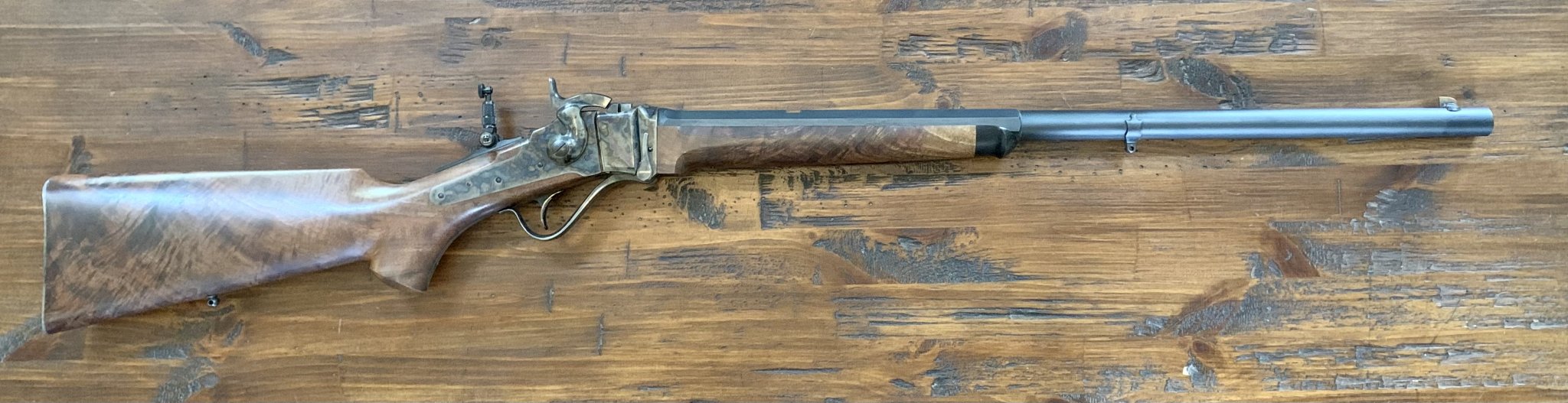

I have a Shiloh 1877 that has finally made it to the checkering shop, after two and a half years. Hopefully I’ll have it soon.

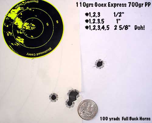

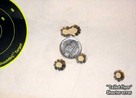

My .50-90 really loved 700gr KAL paper patch bullet and 110grs of 1F. It would "theoretically" shoot sub 1" groups at 100yards, you know... if you threw out the ones that weren't in the group. LMAO An "it's not the gun, it's me" issue, and I was just using the factory barrel sights.
When I was shooting it regularly, weekly, occasionally more often, I didn't notice the recoil at all. When I stopped shooting it for about 8 months and went back to it, it was one of those "Wait, I enjoyed this?" :D
