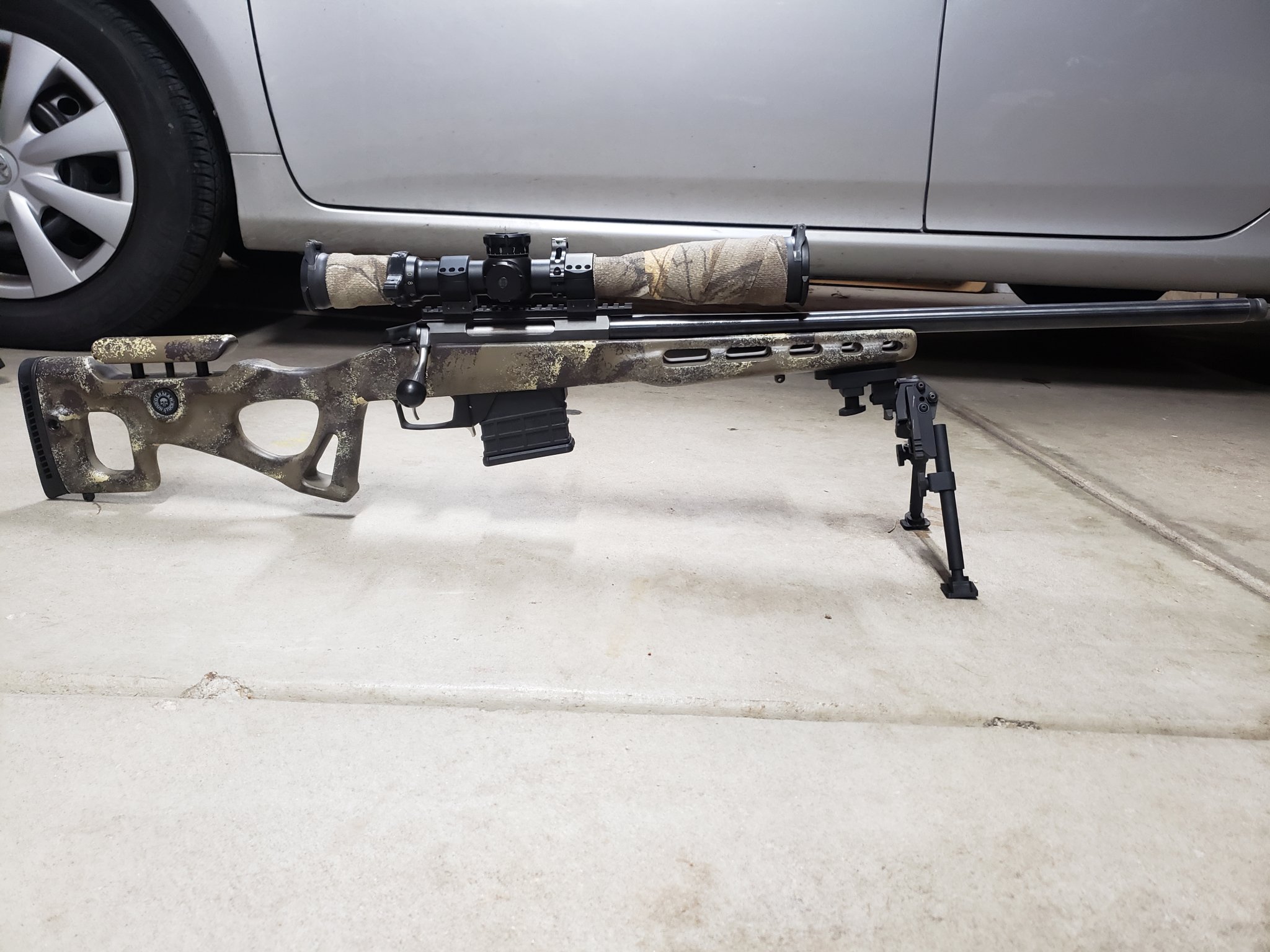

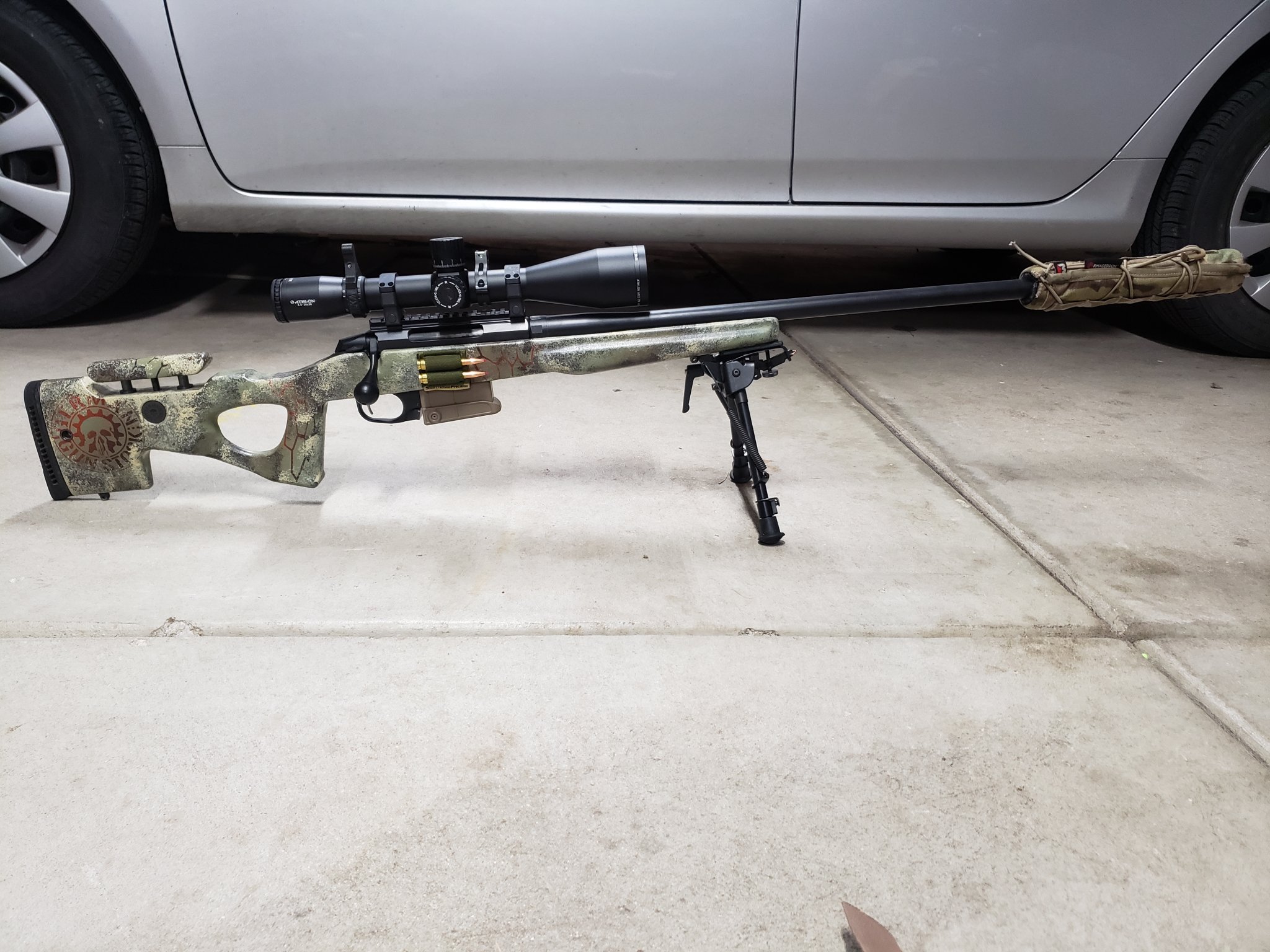

I have less than $1400 in the rifle in the X-Ray with 2 AICS mags and the cost of my reamer. (Scope and rings excluded)
My CTR started as a 20" 260 and I made hits to 1400 with it in the factory stock at local club matches.

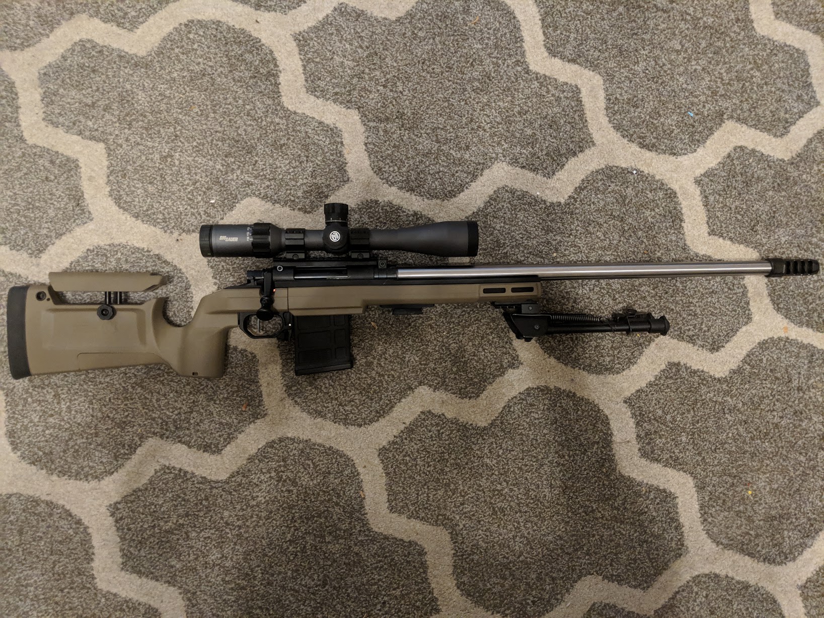

I really think if people are looking budget I would go the used/exchange route. This rifle was purchased entirely off the exchange other than the KRG was a local used.
Nucleus $850
TT Diamond $220
KRG $300
Used PVA 6.5cm barrel with less than 100 rounds down per hide member $450
Lambda brake I kept for another build but came on the pva barrel (thats $150 savings to my other rifle build)
Barloc was off another build and I swapped out for a NSS nut before I cashed it out.
I ended up selling the build for $2k since I am left handed and my son preferred a different rifle. This was essentially a John Hancock rifle with a much better trigger and no year long wait, it pretty much shot 1 ragged hole would easily get you 1k yds and was a great rifle. The moral is though if you are patient and know somewhat what you want you can get it at a good deal and most of these used parts are still in pretty much new condition, and when you decide you dont like that tt diamond you can sell it for pretty much what you paid for it (you'll love that tt diamond though cause its the bomb....).
So give up that money upgrade to a sellers account, buy some parts help out fellow hide members and save some damn money.
Normally I dont suggest used barrels but honestly starting out your going to whore around on calibers and wont last long enough on it to shoot it out anyways.
***Edit keep in mind you're gonna need tools if you go this route... go/no go gauges action wrench and barrel vise ....***

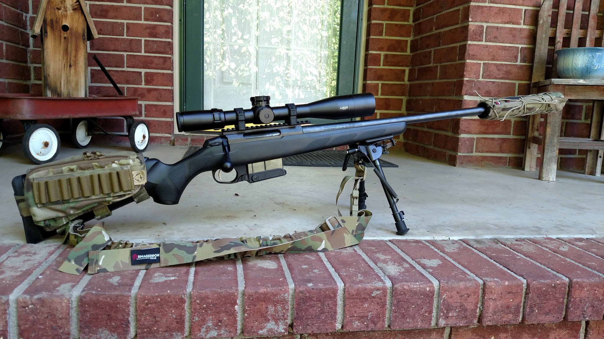

I was in your shoes not long ago and decided to try the Tikka T3x Tac A1. It's the best rifle I've ever shot by far and definitley out shoots my ability. No need to worry about upgrades, just mount the scope and go shoot. For ammo, I used Copper Creek starter pack then second since i don't have room for reloading bench at the moment.
