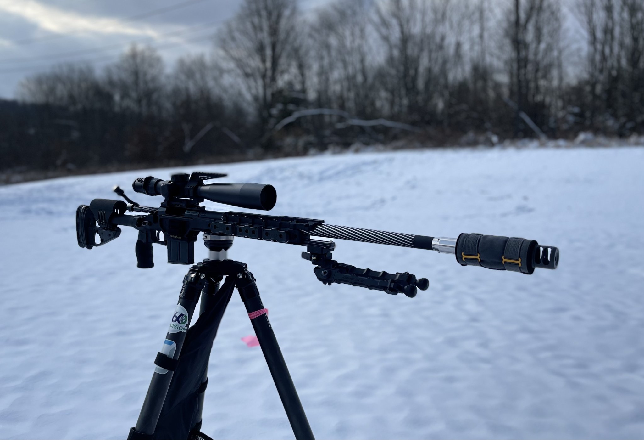

I shot the first 10 at 100 Yards without the suppressor to make sure they made it past the end of the barrel. Put the suppressor on and hammered a 6" plate at 420 yards to see how how they shot at distance. They were 1/2 moa and would probably be a heck of a coyote load. Problem is it is a 23 lb match rifle. I may cut it down to 10 or 20" from the chamber end and try it for a calling rifle. The 22 BR has been accurate with any bullet i put in it.

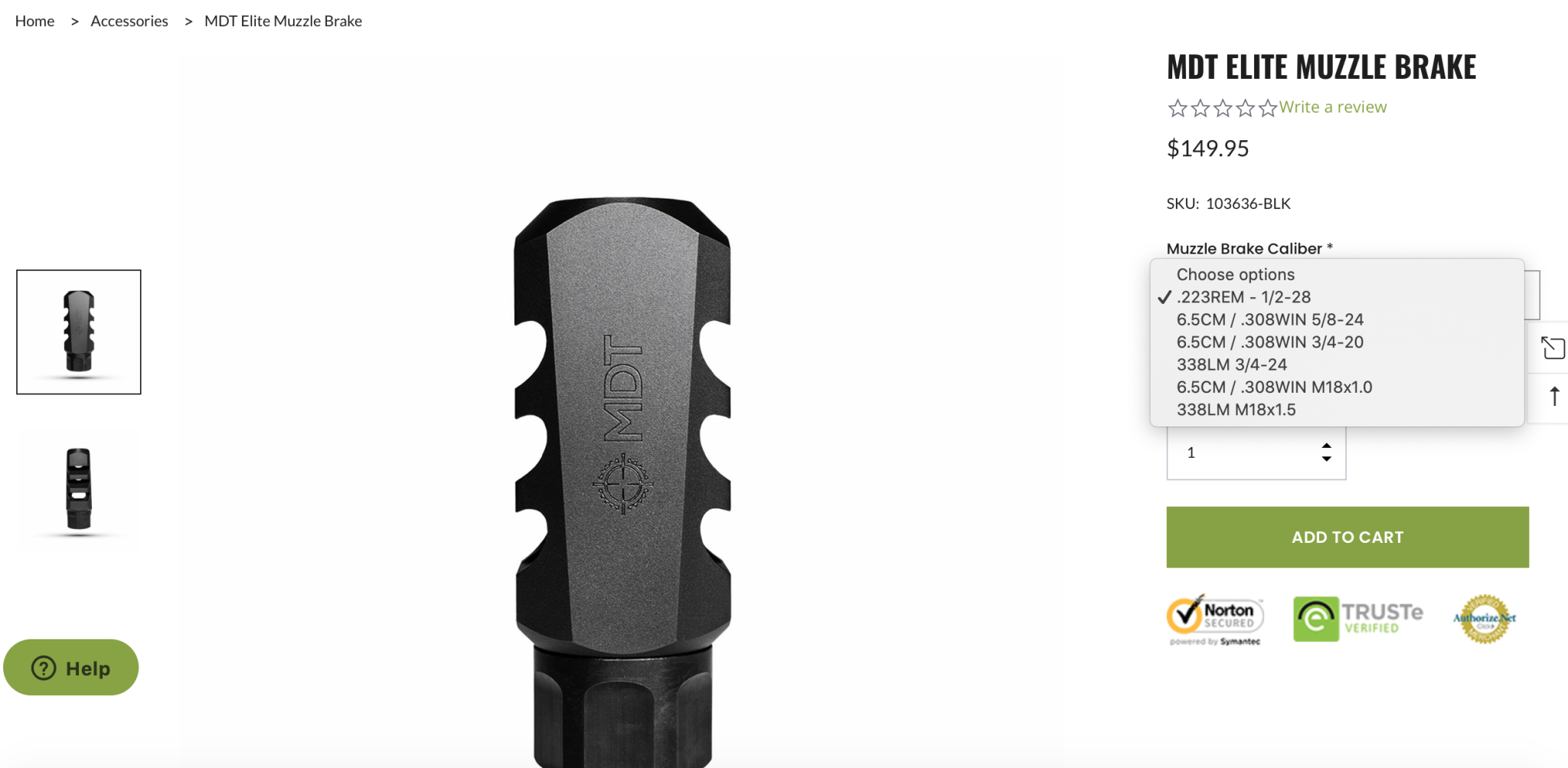

Why thread the muzzle 5/8 x 24? I was leaning towards 1/2 x 28 for 2 reasons (it is caliber specific for 223 whereas I cannot find a caliber specific 5/8 x 24 for 223 and I got it for a crazy good price in the recent Black Friday sale).

I don't get get what you mean by not being able to find a caliber specific 5/8x23 for 223. The 5/8x24 is a thread pitch. I would do 5/8x24 so you can use your same muzzle devices from other rifles on this one too. Simplicity!
You misunderstand.
All the 5/8 x 24 threaded muzzle brakes I found were sized where the bullet passes through for larger calibers (ie 6.5CM / 308)
1/2 x 28 was sized for a 223.
Picture is worth a 1000 words and all
You misunderstand.
I didn't misunderstood. You didn't say brake lol.
But I get what you mean now. And I do remember seeing a brake for 5/8 threads with 22 cal bore. But who cares if a 5/8 brake has a 30 cal hole. Last I checked 22 cal fits inside 30 cal hole. I can guarantee you that you will not feel or notice the difference when shooting. I would just go 5/8 so that I can share suppressor/muzzle devices across all my rifles.

I would not thread the muzzle 1/2-28. Does not leave enough material at the muzzle for best accuracy. Why have a 3/4” diameter or more and then remove a bunch of material at the muzzle where the bullet exits? 5/8-24 is king imo or don’t thread it at all.
