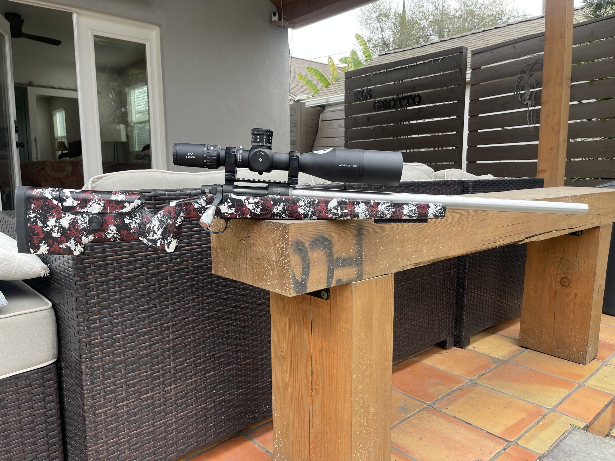

Update, I completed the build and finally got it to the range today (been busy with IPSC / F Class etc).
REALLY liking this build. The KRG Bravo just works (has to be one of the best chassis for the price point?) and it fits me really good, I also love the enclosed forend. I was worried the Terminus Zeus bolt throw would feel heavy after the 90 degree Impact I run on my other main competition rifle (it is really light / smooth) but it doesn't at all. The Zeus is probably a little heavier on open but it almost closes itself. Feeding was flawless all day (100 rounds)
I just picked up some Leica Geovid Pros and this was the first time I used them in anger. I plugged in my data and used them to get DOPE at various ranges (200 / 300 / 440 / 550). Worked great - first round hits on small swingers at all ranges.
I ran the 75 BTHPs up to just over 2900 (24 grains of 8208) and was not seeing any signs of pressure. Will play around some more next time out (have heard that many people have had good luck with between 23.4 & 24 grains of 8208 with 75s) but the loads from today worked pretty good with minimal effort (0.5 MOA).

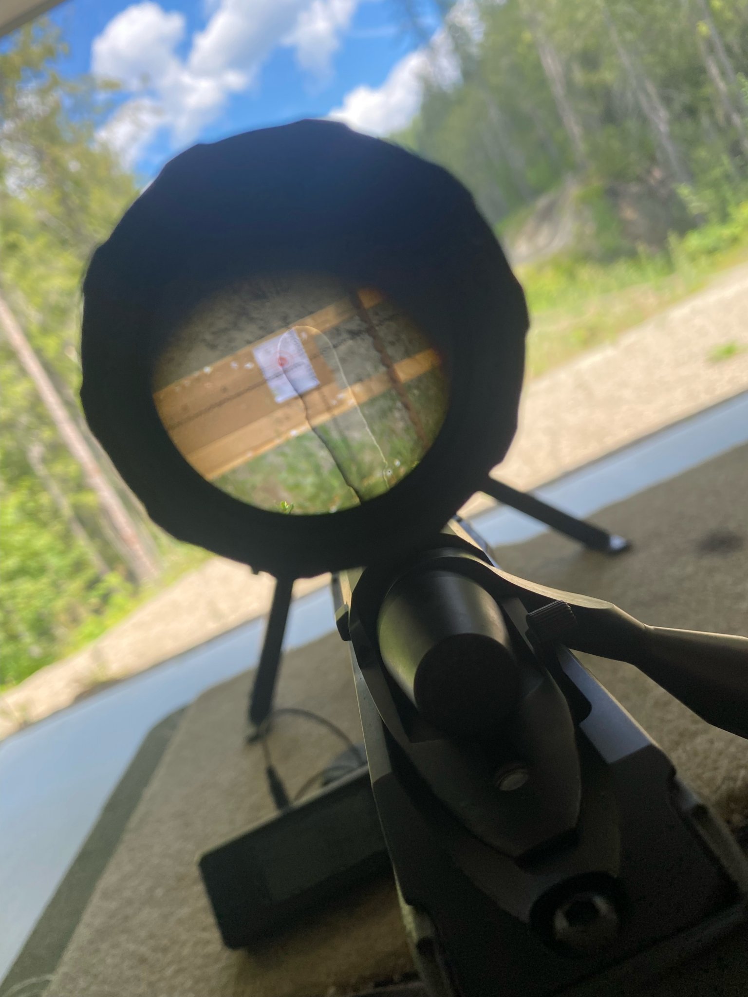

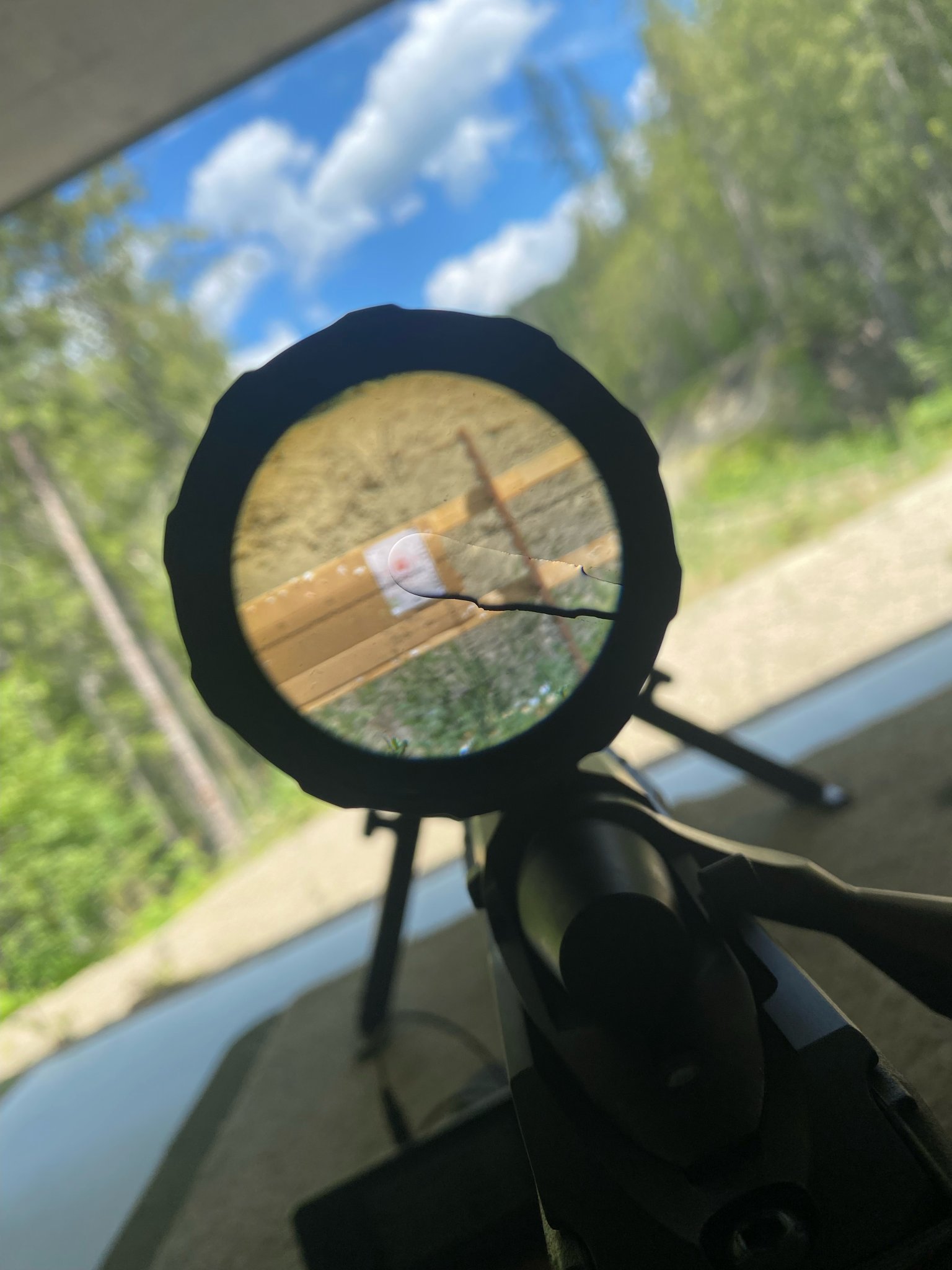

Only downside was that my ZCO developed a weird issue throughout the day, a blurry blemish appeared in the glass. The blemish moved when I adjusted the Ocular but did not move when moving the zoom. I will reach out to ZCO to get the ball rolling.

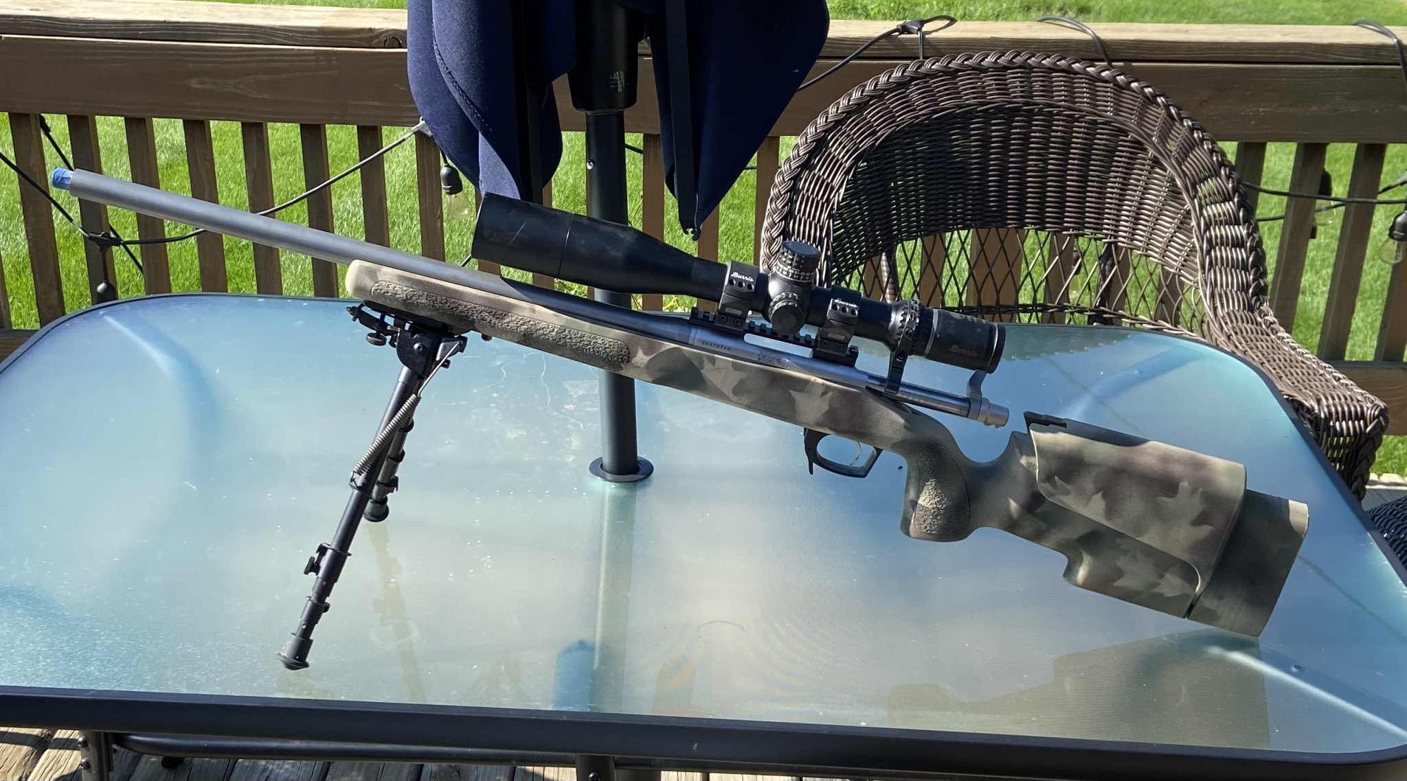

I built a 223 Rem. off of a Rem. Model Seven action, a 25-inch Bartlein M24 contour barrel, a McMillan stock.
I had the barrel throat set up so I can seat the Hornady 88gr ELDm bullets with the base flush with the base of the case shoulder.
Haven't really shot it yet, waiting on the scope to show up. Built the rifle a couple years ago then got sidetracked on other things and kind of forgot about it, lol. Recently renewed my interest so ordered a scope and started prepping brass. It should shoot some bugholes and do well at distance.
