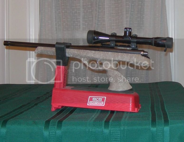

I think there is another to consider, going in quite the other direction. The .221 Fireball. Small, very miserly with the powder and with a fast twist barrel can even shoot the heavies. No recoil, and not much noise.
We have been shooting a couple of Fireballs in XP-100’s. One is stock (since sold) and one is a full on custom. Though I must admit, it is not real happy shooting 80 grain Berger VLD’s it shoots them accurate and with enough momentum to take down 65 pound Rams at 200 meters. It loves 69 grain Sierra’s.
We use a 15 inch barrel and I suspect a 20 barrel would do nothing but enhance all of its qualities. Then add a suppressor and it would be a fun gun that would be just perfect out to 400 yards.
