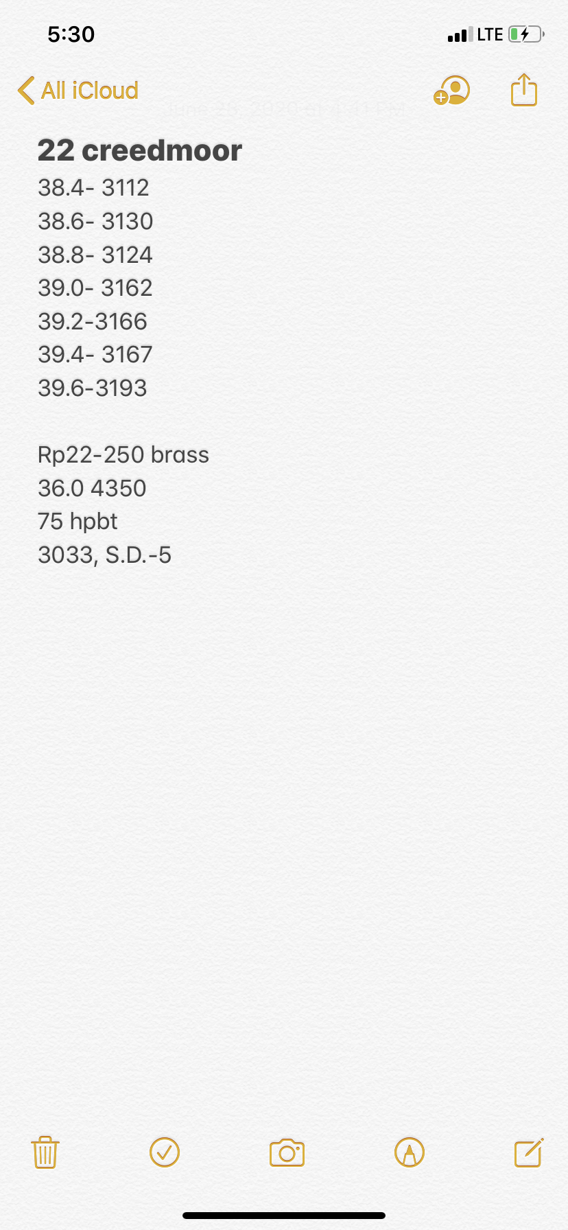

Bartlein 7 twist at 22". 40.7 H4350, 2.67 OAL on a .100 throat, CCI LR primer, alpha brass, 88 ELD doing 3190. Had several .25 groups at 100 and a 1.25 3 shot group at 600. Load development done and hoping it keeps perking with these for a good bit.
Edit: Switched to new lot of 88 ELD and ran into pressure with above. Backed off to 39.8 H4350 and all good.

Find H4350 if you can, I'd start around 39.0gr, work up in 0.2gr increments, record all data, enjoy! Lots of people find themselves between 40 - 41gr of H4350. :)

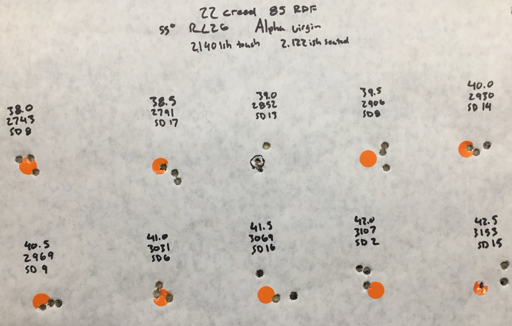

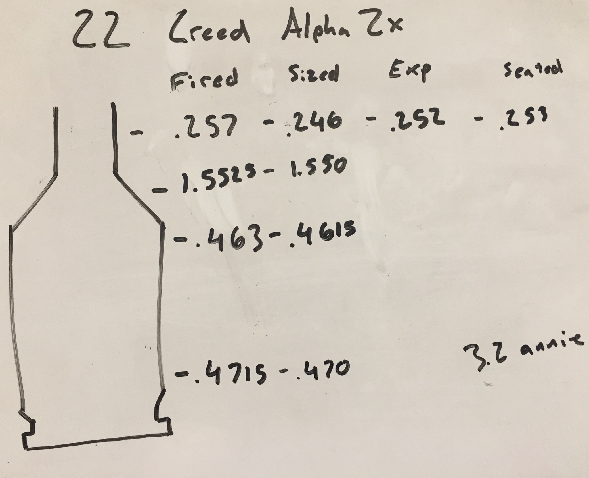

I’ll dump my data here for others to look at
26” 7twist 22 creed with pva 062 freebore
Alpha 22 creed srp brass, 100 cases total
85 rdf
Rl26
Cci450
Virgin cases, took it easy to get an easy forming load
Measurements after one firing

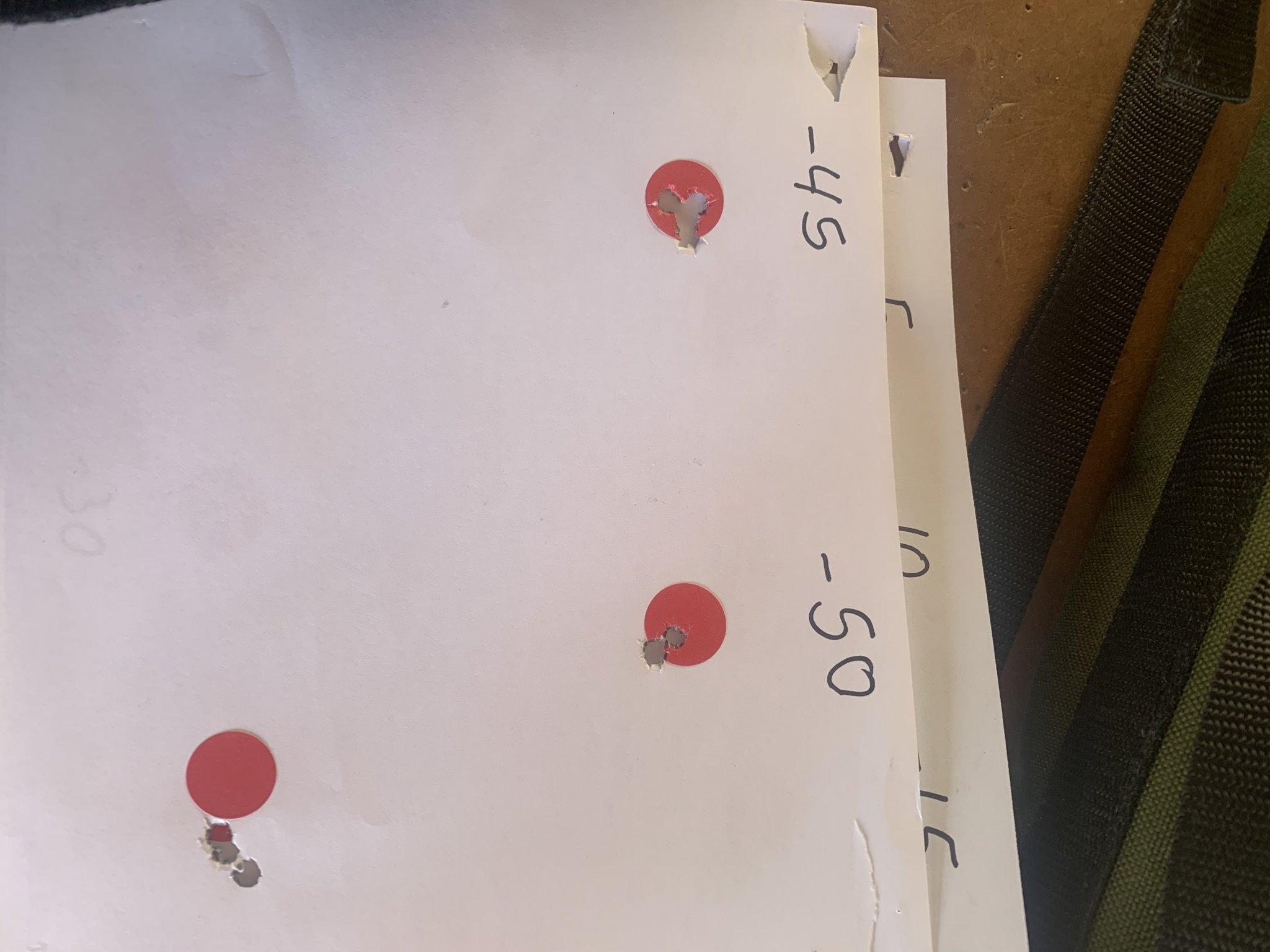

First test in .5 increments at 100 yards with fire formed brass to find pressure and it was in a light misty rain, 44 started to give slight ejector marks and slight bolt lift resistance, functional max found
Do it again but at 500 in .3 increments, I suspect that 42.5 flier got absent mindedly shot at the wrong dot so looks to be something at 42.2-42.5 and then something at 43.1-43.7
Checking out that top node in .1 increments
Now it’s all been shot twice
Seeing how seating depth effects it, pretty tolerant
10 shot confirmation, I’ll just load them at this for the next few firings while the lands erode and see if I need to change it at 500 rounds.
Hopefully this was evidence enough to give some guidelines with this combo
Reactions: TEAMSENDIT

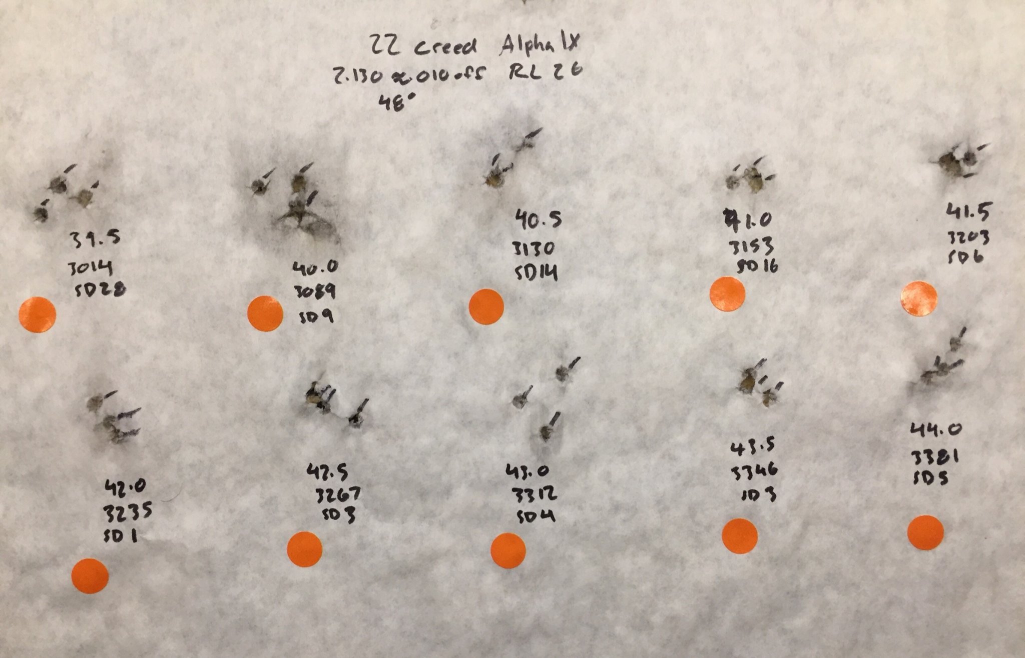

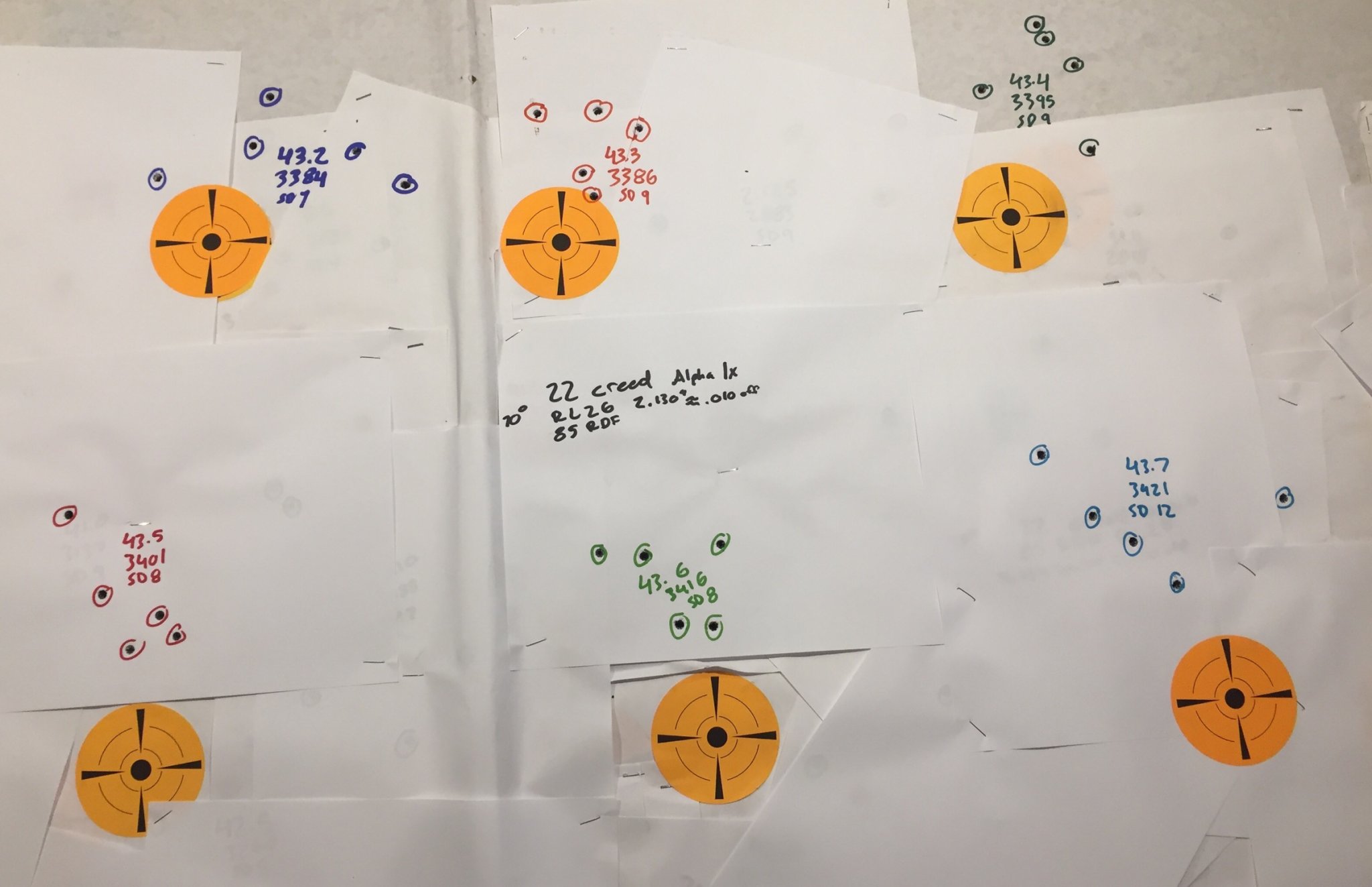

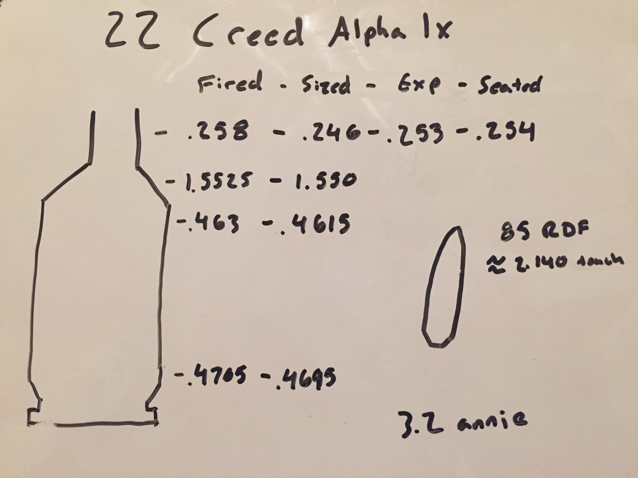

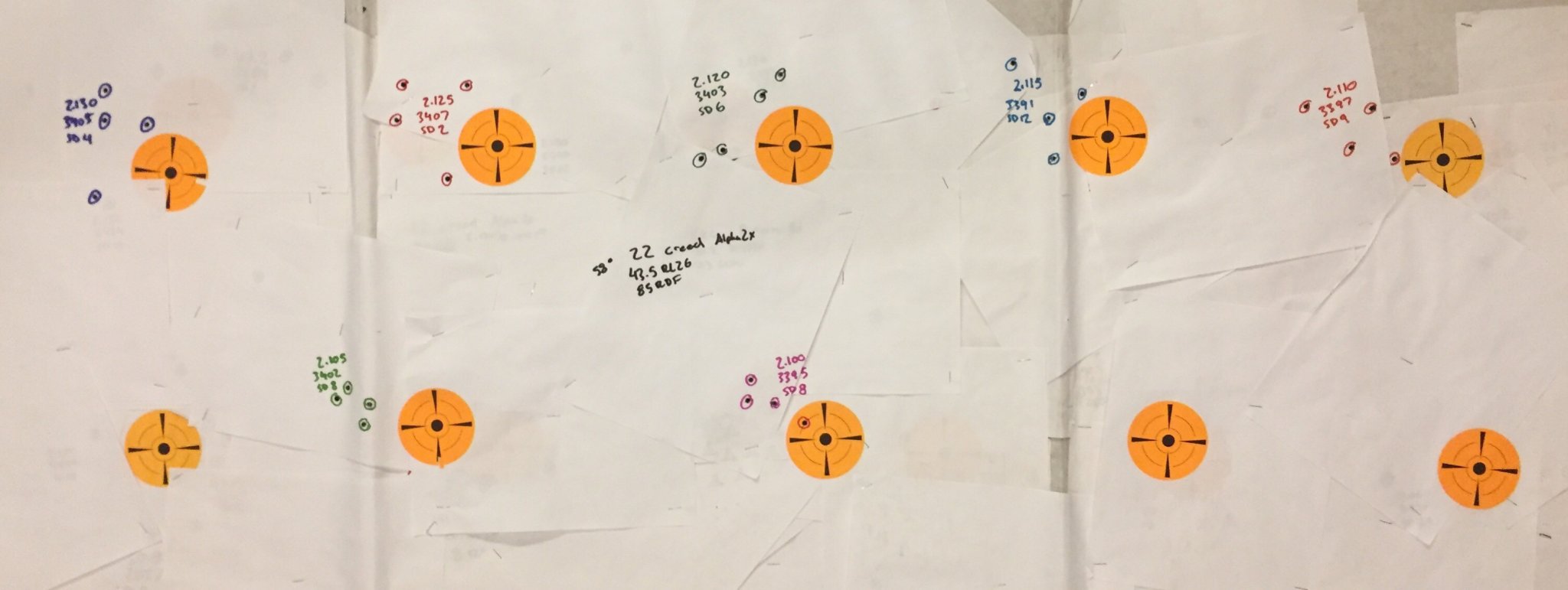

26” 22 creed with pva 062 freebore
85 rdf
Rl26
Cci450

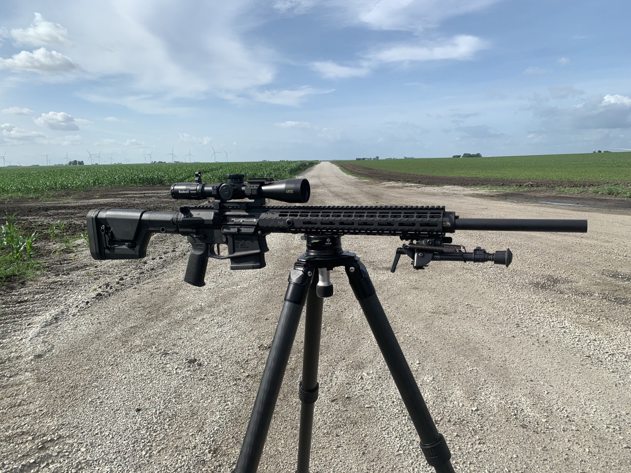

Has anyone played with a 22CM in a gas gun? This is my first large frame. It’s a 24”, 8 twist, +2 gas, Bartlein chambered by Craddock. JP BCG and SCS. I ran a few loads with 4350 and 75s with Alpha SRP brass. I came into pressure early on in my load work up. I’m playing with other brass and breaking in the barrel with some powder puff loads before I start dialing in a load, but I am curious to see if anyone else has had success with 75 class projectiles in an AR-10. My goal is to run 77 gr Cayuga solids at 3300 fps plus for night coyotes at safe pressures.
That will be a really fun round..

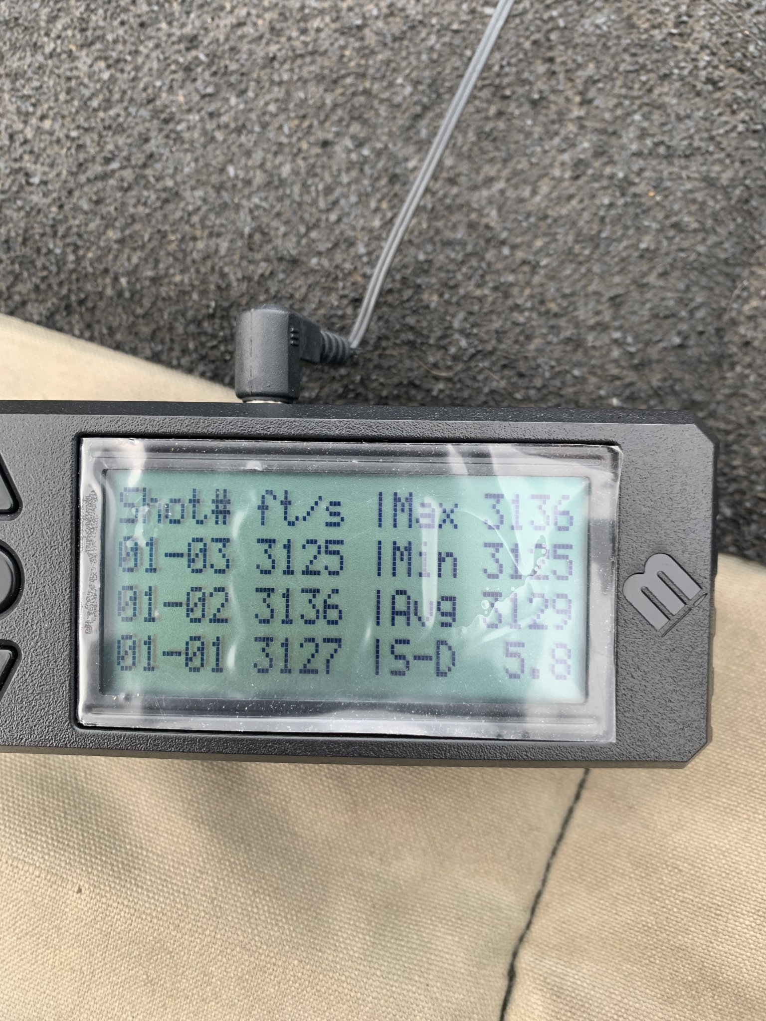

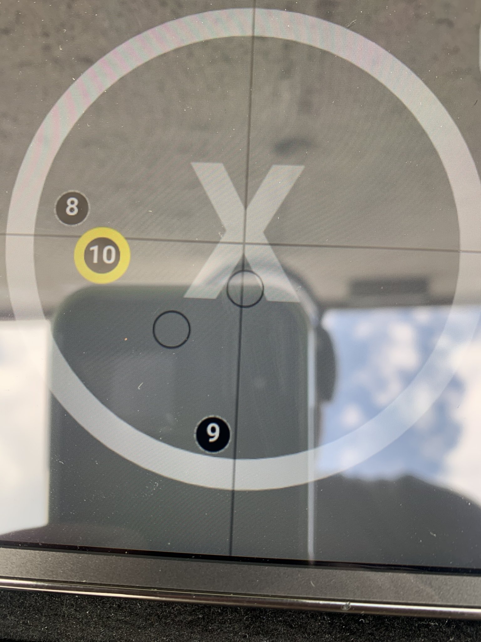

Got to get out to 300, 400, 500 and 600 yards today. I got the kestrel all dialed in. Barrel sped up. Average 3129 velocity SD in the 5s. I’m running the g7 at .292 with the 95smk and it was lining up at all the yard lines. All proned up you can see the trace of the bullet. Even doing positional shooting I could see trace. Here is a 3 shot group at 300. The target is a 200 yard high power target. So X is 2.5 inches?? I messed the second shot up. But, its still right around an inch.

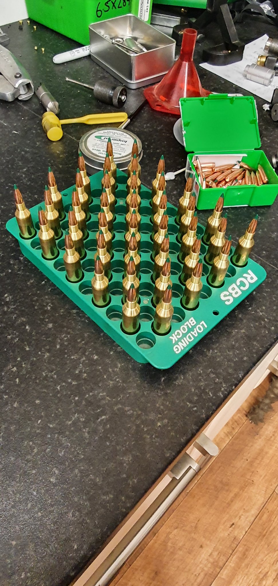

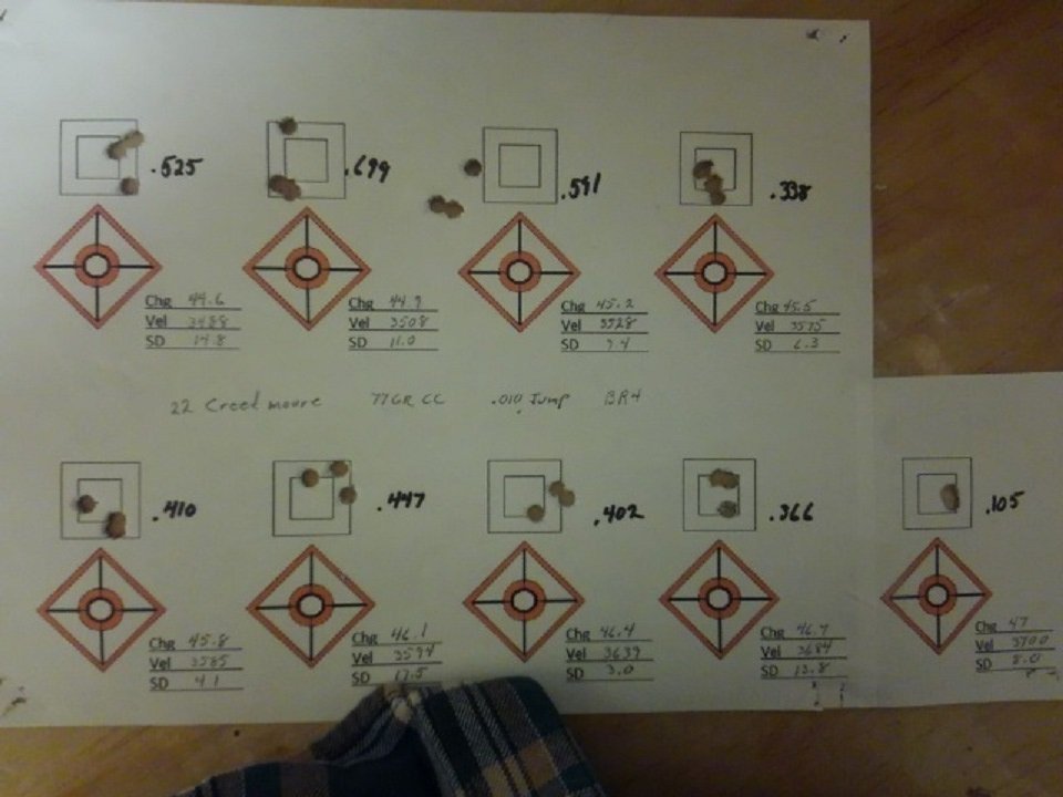

just got some rounds loaded, 45gr of reloader 26, 2.110, 3500 fps, 77gr tmk. .3 group at 100 yards. lapua 6 creed brass necked down to 254 run through an expander and turned. this load was used in another rifle, did not develop at all, dont know the jump. i will just shoot it how it is.
