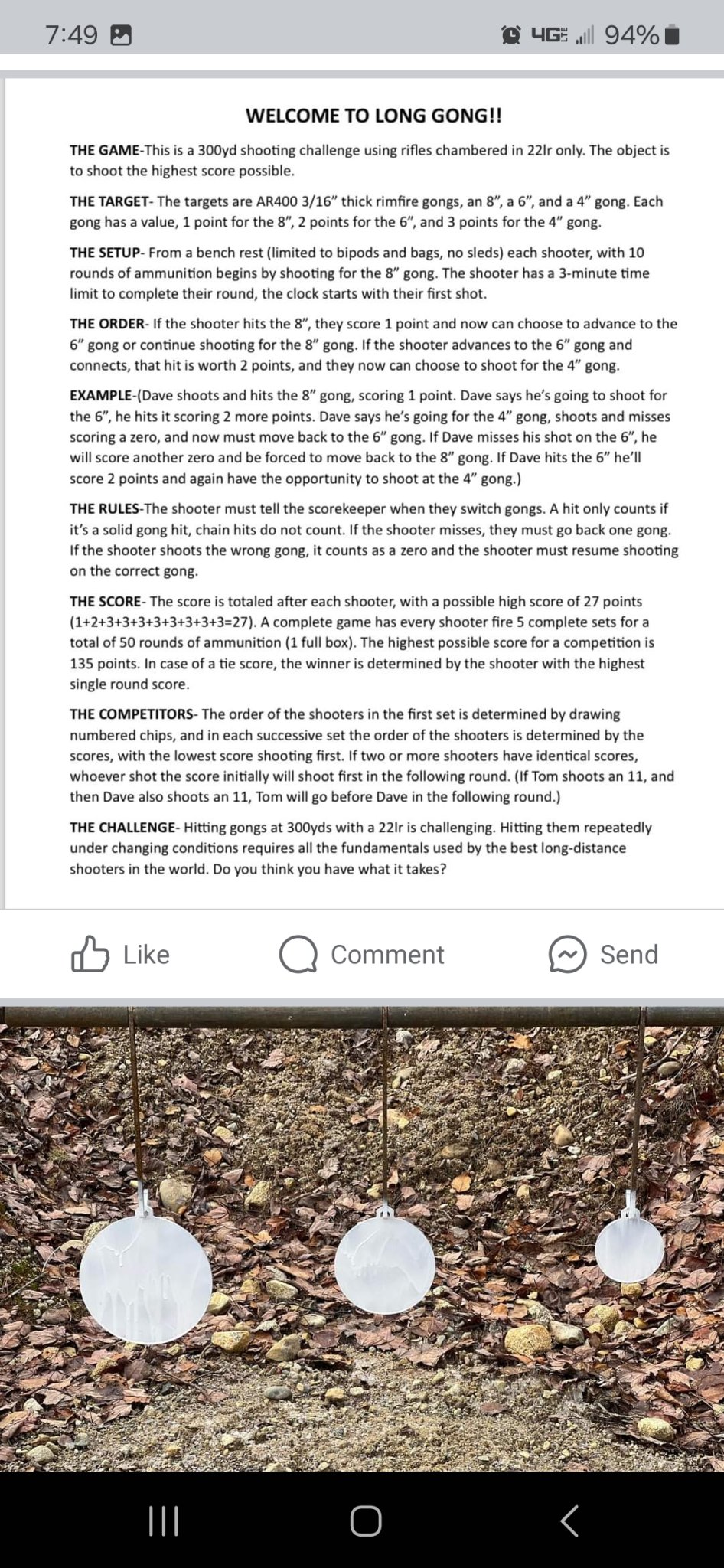

My T1X 20" does very well. I had it out today, with Tac22 ammo, out to 300yds. shooting some long gongs 8", 6", 4",and 3" start with the 8", if you miss you have to go back one target. I ran them a few times clean. 200yds 4", 3", 2",and 1". The 3" at 300 is tuff. The 1" is tuff also. I have more trouble with the 2" for some reason.
The long Gong game is 300yds 8", 6" and 4" gongs. start with the 8" hit ( 1 point ) to move to the 6" (2 points) hit to move 4" (3 points). with 10 rounds. If you miss you move back one target. High score wins. I added the 3" for myself. I just run it 10 rounds to see how many hits I can get. Same setup for 200yds
So how consistent are the hits on the 4" at 300 yds?
The rules.....
All depending on the wind conditions. The best I have done is a 21. I ran the 8", 6" and 6 hits in a row on the 4" when the wind did a 180 degree change, I missed on the next 2 shots. I can run about 60% hits on the 4" most time. Now the 3" is about 30%, I did hit 5 time in a row before the wind changed.
Last week I was doing well with a 6”@300. Today not so much mirage and some winds made it much more difficult. Can’t fault the rifle one bit but the ahole behind the rifle and same with others. It’s challenge which is why we do it.
