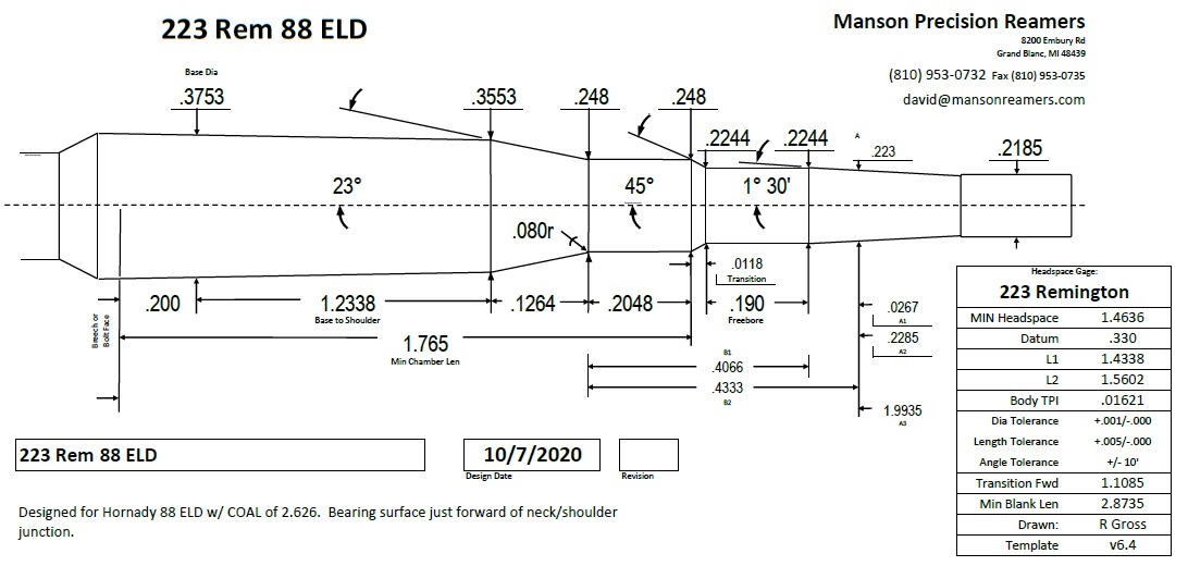

How much freebore do you have with that setup that your running?
0.145" on the current chamber.
Here's my new reamer, which has 0.045" longer freebore (0.190") than the current chamber.
I'll be spinning up a new Benchmark 1:7 over the holidays with this reamer.
This 0.190 freebore places the base of the 88 ELD M bearing surface just ahead of the donut.
This reamer is designed for a COAL of 2.626". To use this in a repeater I had to modify an AccurateMag to accommodate the increased length.
I am turning necks for this BTW.

This is why I love this sight. Diagrams. I do appreciate it! I've always wanted to try the 88s in a 223 for local matches but lacked the info to pursue it.

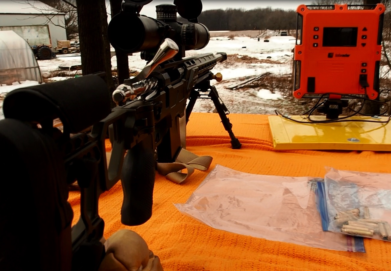

So, I got out today with my new 26" 1:7 Benchmark barrel chambered with the new reamer. COAL was 2.625" with 88 grain ELDMs and 90 grain A Tips. Fed from the modified Accurate mag with no issues at all.
Brass was full length resized IVI brass all weighing within 1/10th grain. First time being fired in the rifle after being neck turned. The next firing will be more meaningful.
With 88 grain ELDMs I was getting 2891 to 2926 FPS with 25.5 grains of Varget . That's the hottest load I tested and pressures were just fine. Primers are flat but with nothing flowing into the firing pin hole and edges of primer are still rounded.
Lowest velocity spread was with 88 grain ELDMs with 25.0 grains of Varget where all 4 rounds were within 4 FPS... 2861, 2857, 2858, 2857. Small sample I know. Mainly just testing for pressures right now.
I only tested 5 shots with the 90 grain A Tips with 24.5 grains of Varget and speeds were 2796, 2771, 2752, 2789 and 2772. This was actually the smallest group of the day, but velocity spreads were nothing to be exited about. Probably need to test different seating depths.
For reference, the 88 ELDM with the same 24.5 grains of Varget were going 2796, 2814, 2808, 2787, 2818.
Accuracy was around 1/2 MOA for all loads, but the bipod was admittedly not very stable. It was cold and after shoveling the ice and snow off my shooting bench, I was impatient. Next time I'll get serious about my set up and work on getting better accuracy.

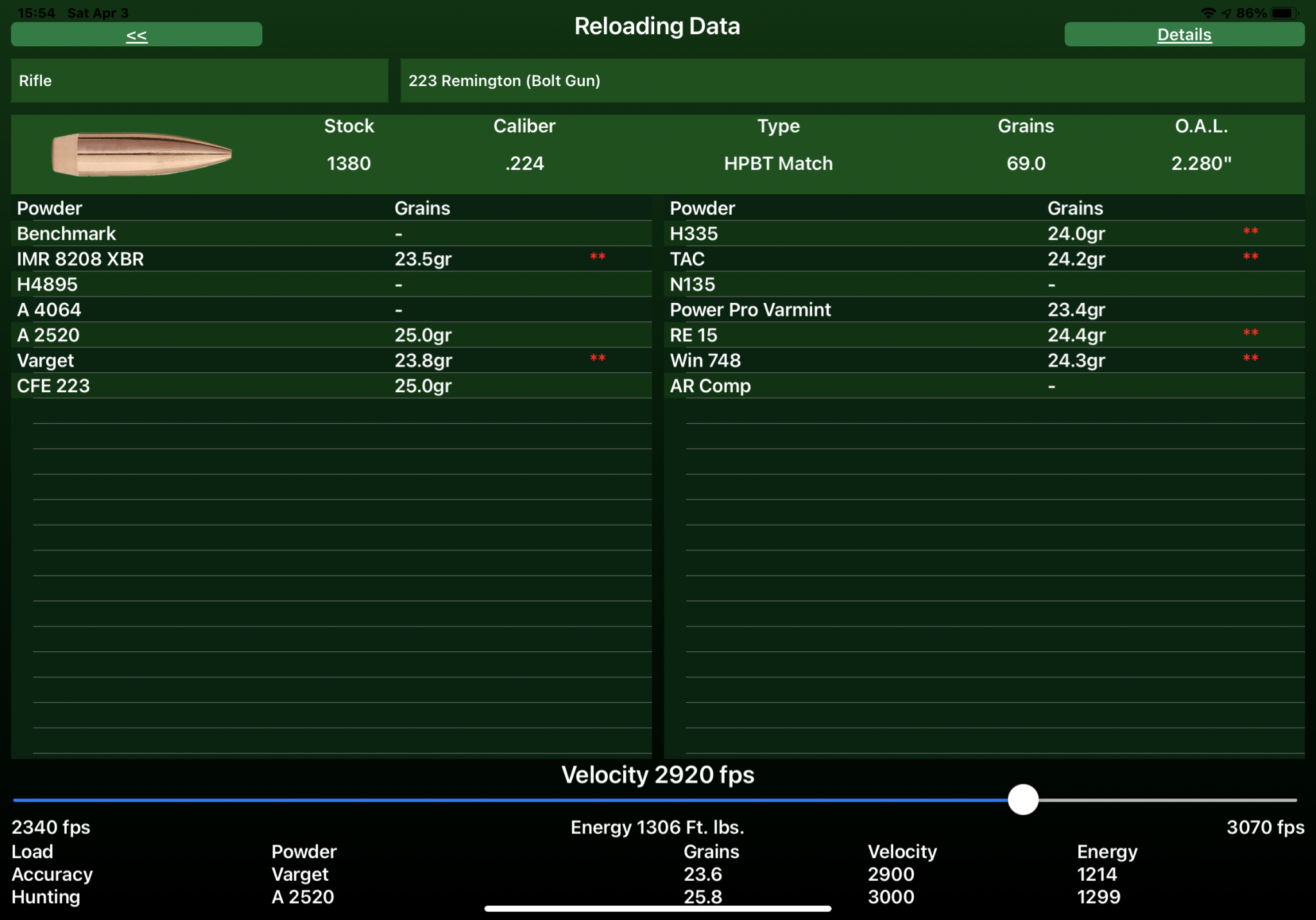

Can someone explain to me the differences in the two published load data sources. I have a pic of the book for SMK 69gn for bolt gun. Also have thier app for load data. The pics are below. As you can see the book shows an OAL of 2.260 in the bolt gun data. The app shows 2.280 for bolt gun data. I will be using Varget. You can also see that the book data shows a max load of 26.4 grains at the 2.260 OAL and the app shows max at 23.8 grains at 2.280 should there be that much powder difference for .020 of bullet depth. Maybe I’m just crazy Lol.
26.4 varget at 2.26 coal with a 69 gr bullet does seems really really hot to me. I’m showing 66-70K PSI in Quickload depending on case capacity.
Yeah, I’m just wanting to do some load testing with this bullet since i have quite a few on hand. Trying to find out where the max safe load is, so i can load down in .2grain increments for 10 - 5 shot groups Over a chrono.
