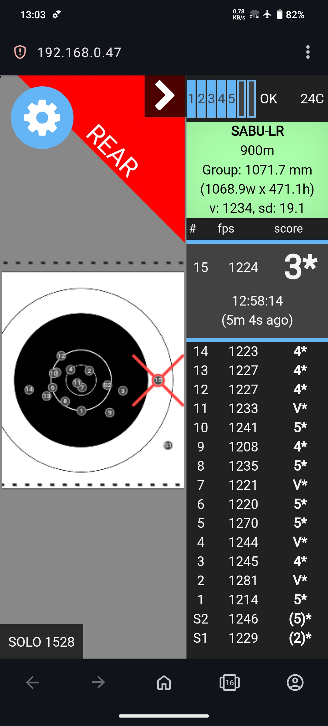

I go to 1000 with a MV of 2910. Still supersonic enough for Shotmarker and SiverMountain targets to pickup
On this one of the sensors were not completely plugged in.

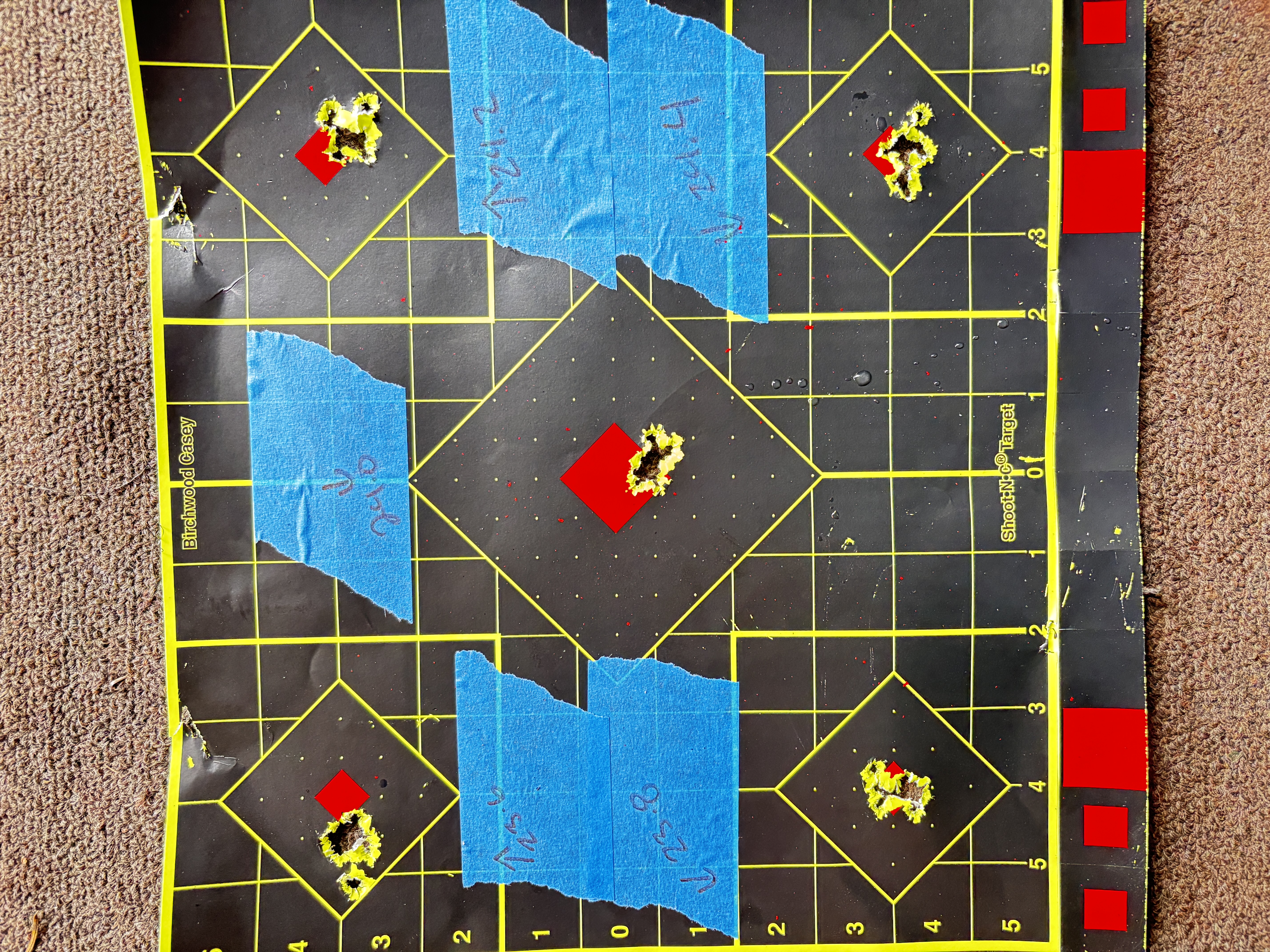

Still tweaking it.
25.3gr varget. Hornady brass formed to rifle, neck sized only,
Cci400
2.280" coal
Bergara b14 ridge sp 18"
Yhm t3 can.
2881avg sd9, es21.
25gr did a nice 3 shot clover and 1 stupid flyer.

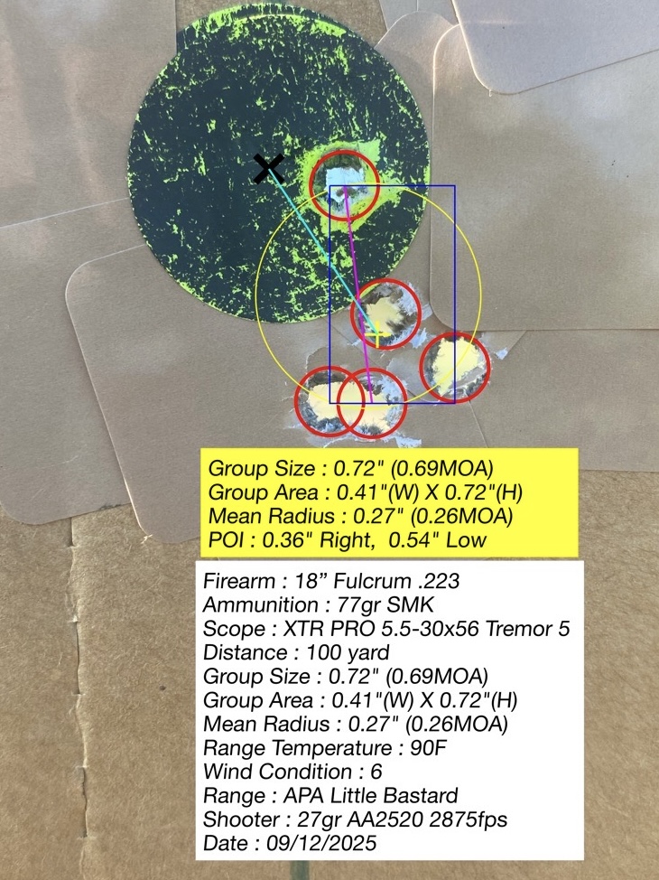

I typically wouldn’t copy a load but tried for grins. I was curious if I could find a load to use across a couple guns to consolidate components and the Berger ammo is supposed to be like magic pixie dust. The groups from the copy load at 100 are as good as any of my hand loads out of a bolt gun and ar but the load is very compressed which caused a lot of intermittent bullet runout. Like 5thou one load and 2 the next. Just wondered if anyone else had tried it and had luck before I wasted time and components trying it at longer ranges. I’m assuming the runout will cause problems at distance anyway.

I was surprised by the runout since the components are good. Well at least they aren’t cheap! It’s new Lapua brass sized on an Area 419 die with a 2thou mandrel. Used both a Forster micrometer die and an SAC seating die. Same bullet runout issues with both seating dies and the Berger 77otm’s. Brass has 1-2 thou outside neck runout after sizing which is normal for me.
Interestingly, I tried 77smks and had zero issues. 1-2thou runout after seating with the tried and true smks.

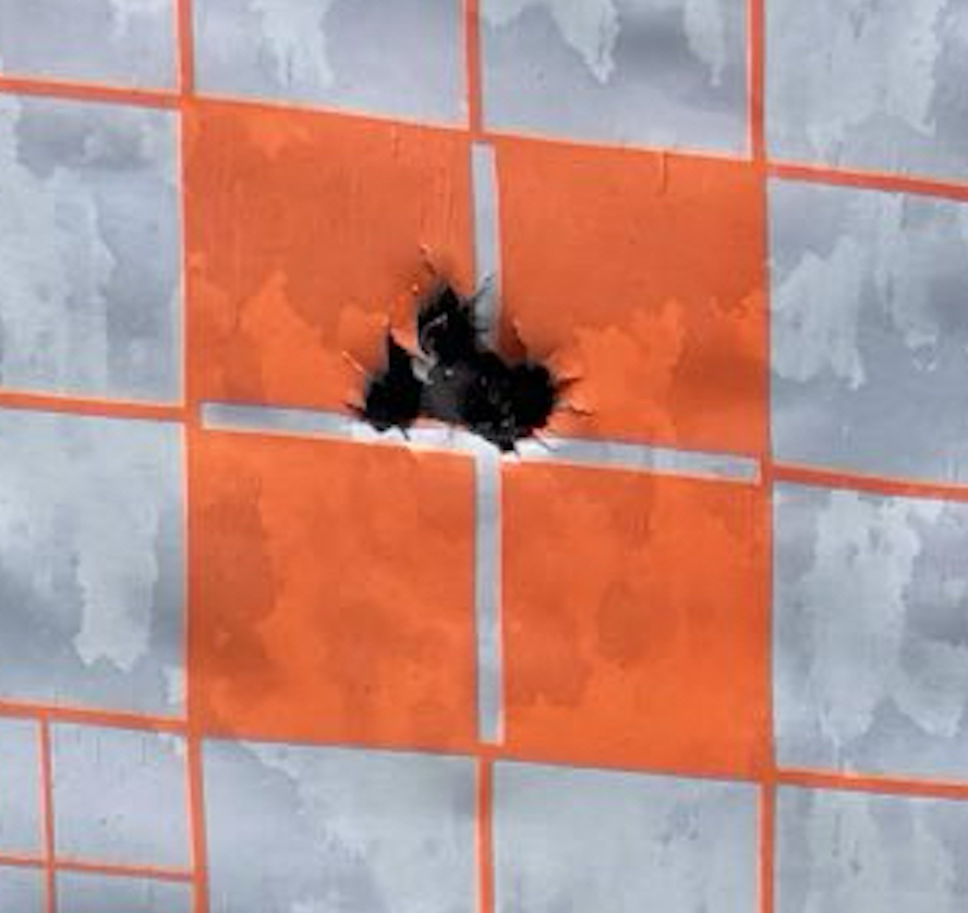

80.5s over ARCOMP shot tiny groups out of my 26" Proof right at 2870 fps.
Several others I shoot with have stumbled into that same velocity window...
I was trying to figure out a load for the 75's when I remembered I had a box of these bullets. Loaded a bunch to do velocity check at a COAL that would fit in mags, and it put up a 5/8" group. Immediately gave up on the 75's and am never looking back.

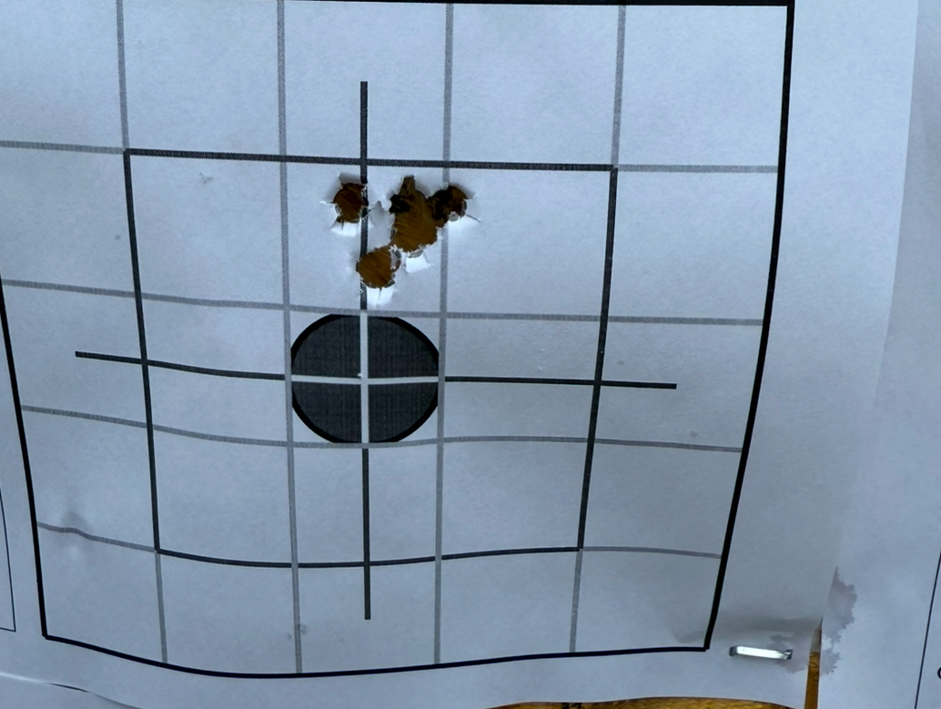

Trying this again with 77gr OTM’s. These bergers just group with such little effort. The tiny fliers I knew as soon as I pulled the trigger. Ended up with 24.3gr of N540
77gr OTM
Hornady Brass
24.3gr N540
205M primers
26”
1.97CBTO
12SD. I’m sure I could chase single digits but the wind will buck the bullet far more than losing 3SD will make a difference.
