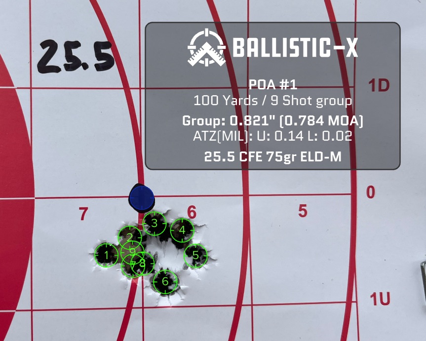

I was doing 24.5 gr of XBR, loaded long in a much longer throat than wylde. Winchester brass gave up after a few firings though. If I were to use that combo again I would drop the charge .2gr or so.

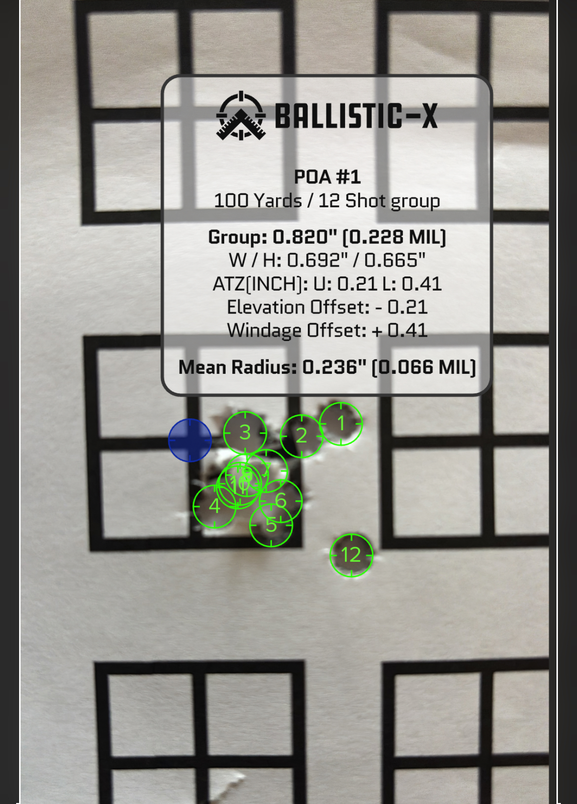

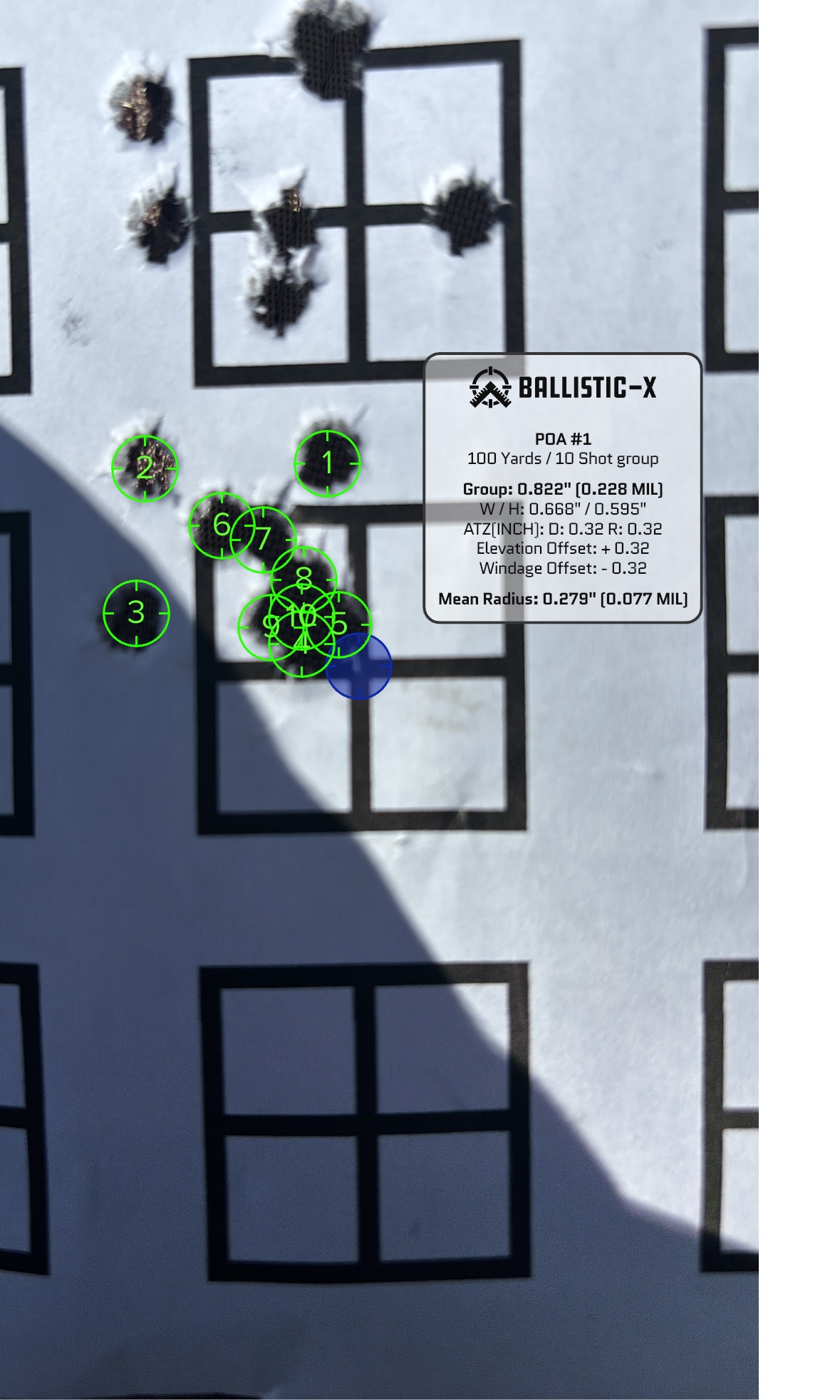

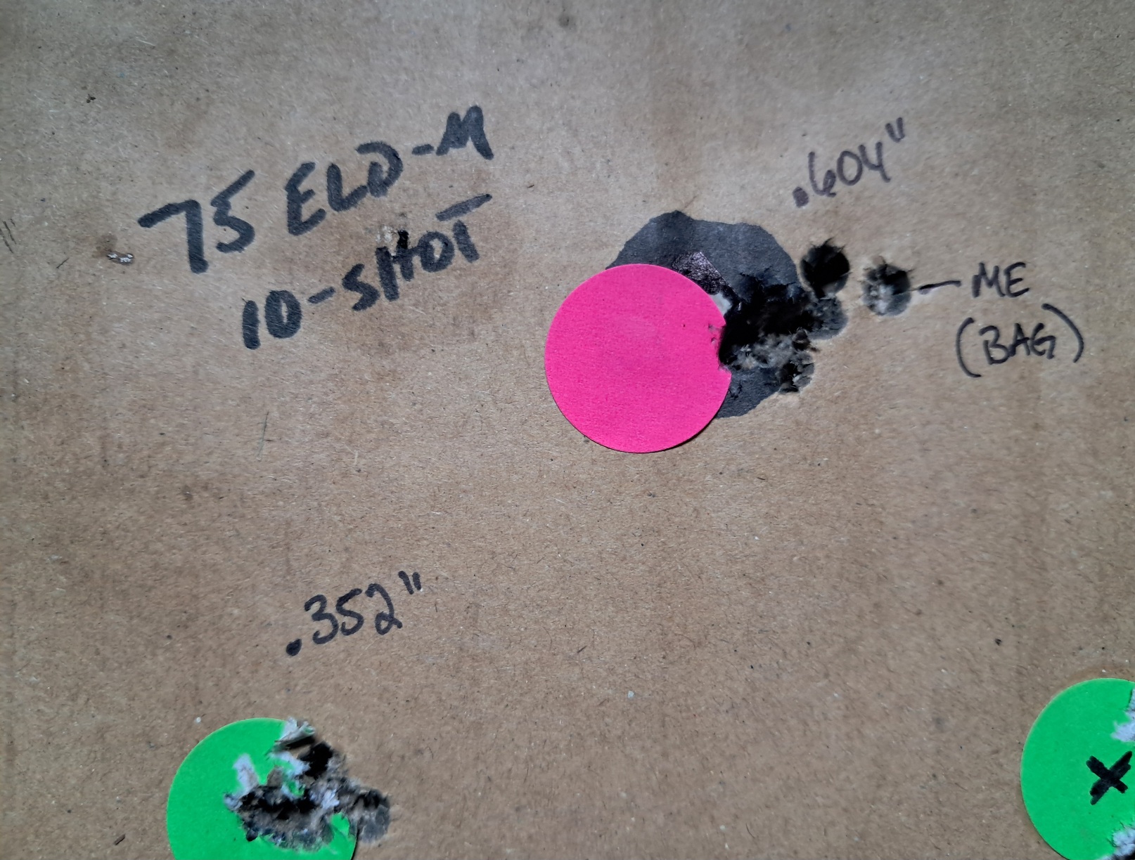

75gr ELD-M/ N150. Load specs are above in this page a couple times.
Shot a 10 shot group (pink dot) just now in pretty crappy conditions (39*, W 13MPH according to the Weather Channel). The green dot was an old 69gr SMK / Reloader 15 load test...I just re-used an old target. Please ignore.
Chronograph read 2,801 / 30 ES / 11 SD. I didn't have the ammo out in the cold for too long (20 mins?), so at least it is initially looking like N150 is a tad temp sensitive as it lost 17 FPS from when the ammo was sitting out in ~62 degree weather. I'll need to control and measure this better. Prior to shooting, it sat in a house with the thermostat set at 68 degrees.
I did pull one shot...but looking at the target now (blown up), it looks like I put another shot in there too??...so I'm sticking with that .604 group, and not leaning on an excuse.
*** I'm out of 75gr ELD-Ms at the moment, but will resume this testing when it warms up. I'm curious to see if 1) velocity increases when I store and shoot the ammo at 80 degrees F, and 2) If accuracy tightens up a bit when the load is a tad warmer.

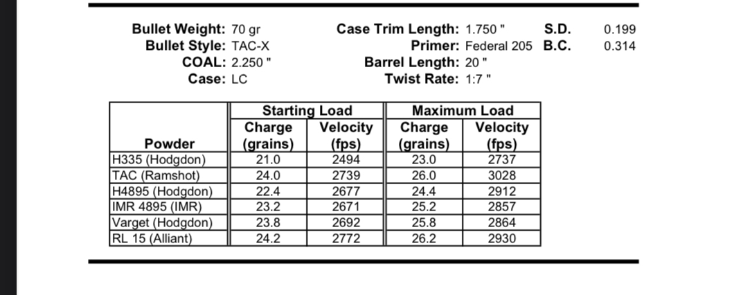

I am wanting get a 20in barrel with a Wylde chamber. And be able to shoot to the maximum of my range, 820 yards, with “decent” repeatability. *I understand the 6 arc would be better suited for this.*
I’m at about 800ft above sea level for reference.
The load data I am seeing leads me to believe this is possible, some show 70gr some show 77gr. But the overall theme I see is, you can get them moving fast enough to make it happen.
But I don’t hear many people talking about it either.
I feel like if I can get a 75gr BTHP moving at about 2850 then I should be good. And the seems obtainable based upon what I am seeing in the attached load data.
I do like my face, so I’d prefer to keep it intact.

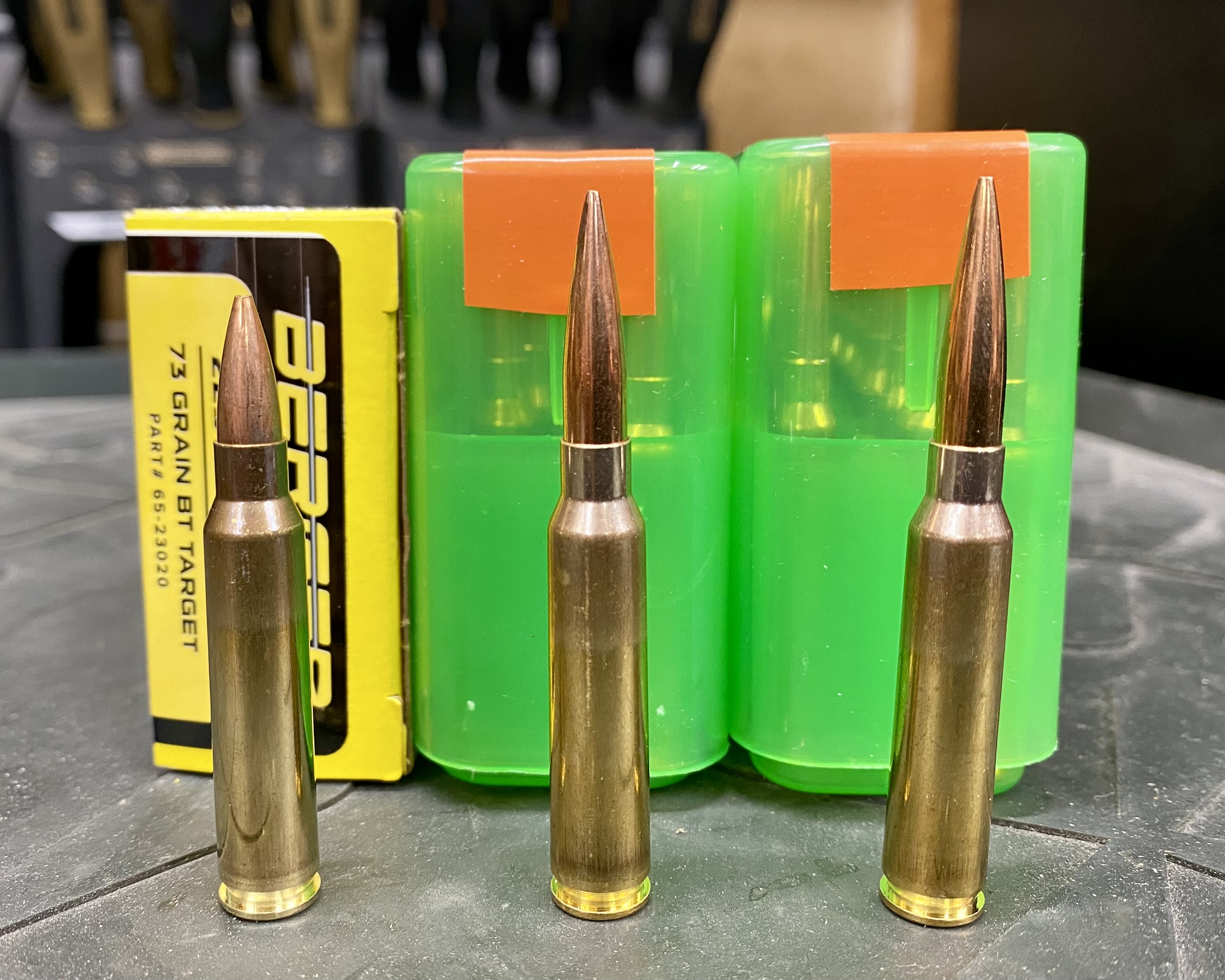

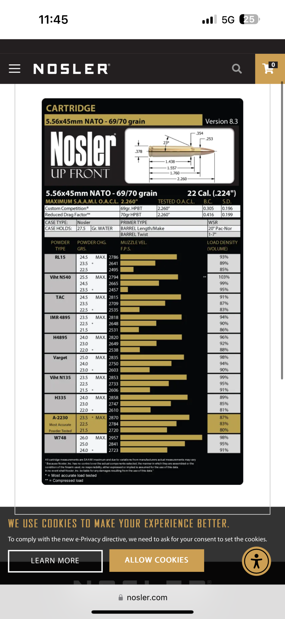

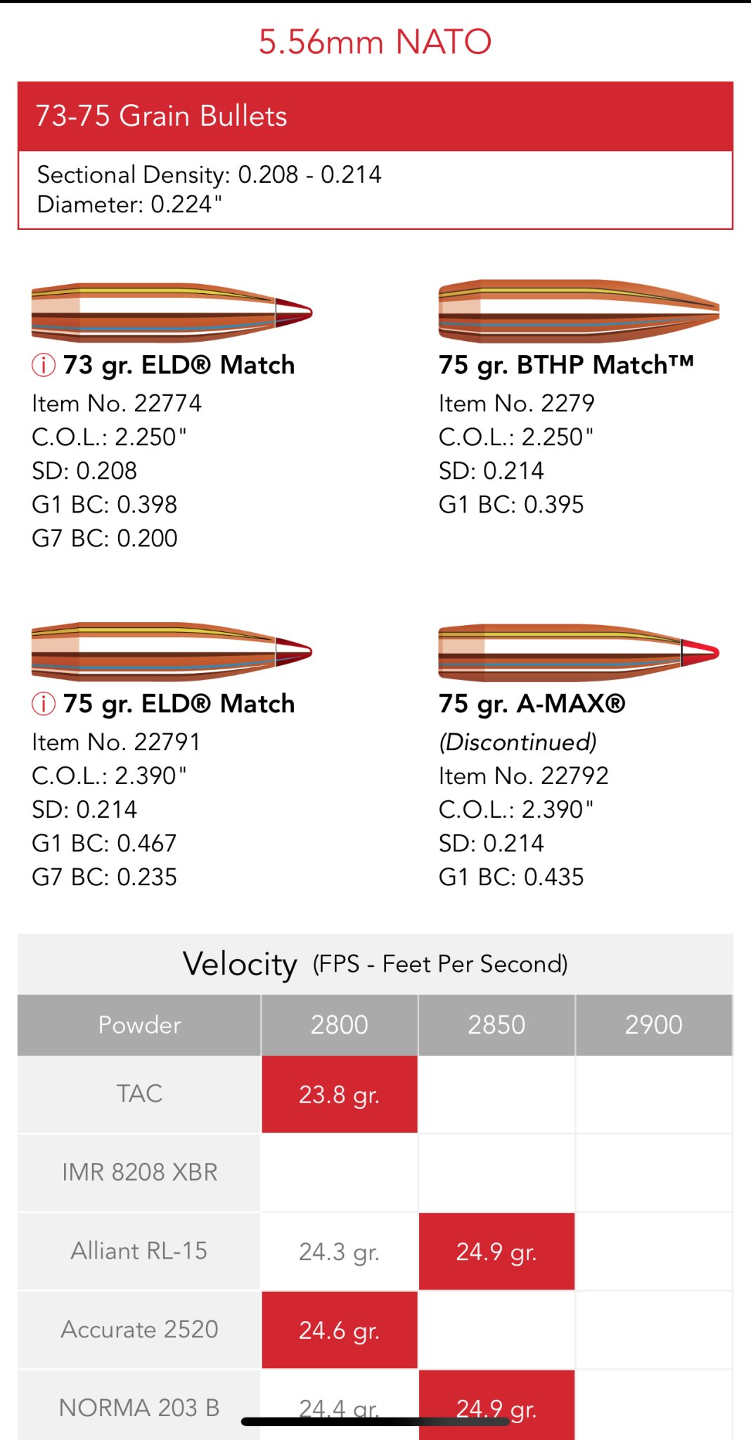

What specific barrel brands are you looking at? Id imagine you’re looking at Proof, White Oak, etc. stainless barrels? For chrome lined chrome moly barrels Criterion core is a solid option.
It’s definitely doable but good luck spotting your impacts/misses at that range with a .224 bullet if you dont have a spotter. The repeatability will be largely dependent on the quality of the handloads, quality of the barrel you choose, whether or not you purchased a quality bolt headspaced to the barrel, and the overall build quality of your gun (factory build, built by you from scratch with all proper torque values, etc.).
For bullets id look at the 73gr ELD-M due to its better BC compared to 75 BTHP plus it fits in AR mags (it has one of the best BC’s while still being able to fit in AR mags). There’s also the Berger and Sierra 77gr OTM which are both fantastic for long range shooting but their BC is slightly worse than the 73 ELD-M.
To give you some idea of recommended bullets and powders for 223 long distance shooting (note the COAL listed for some of these bullets, i.e. the 75 ELD-M are only for single feeding/bolt guns bc they’re too long for gas gun mag length) from the Lyman long range precision rifle reloading handbook:
Reactions: three horsemen
Thanks!
Looking at a craddock with a rock creek blank. With them providing the bolt. Figured it was the best starting point!
I could put it In an aero enhanced upper or a VLTOR. I’m undecided at this point.
73 ELD-M looks promising. And I’m surprised Varget does as well as it shows in that handbook.
But definitely worth a look

You’re welcome. Nice, the craddock/rock creek should get the job done nicely especially with a headspaced bolt.
Another upper to consider would be a stripped blem BCM (its a nice tight thermofit with the barrel), pretty good deal for around $80

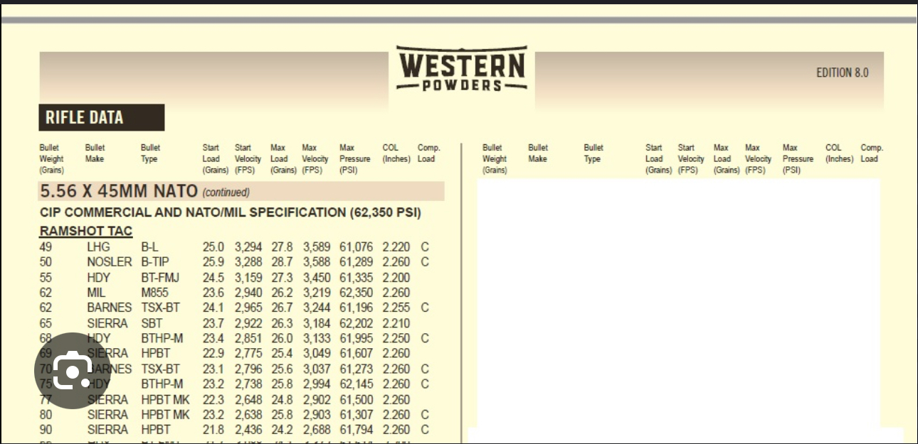

I assume I can use 5.56 load data if it is once fired brass from my chamber?

I remember reading something similar about loaded bergers so def be careful with them.
You can confirm with craddock re: whether or not your chamber will handle 5.56 pressures but 223 wylde should be able to handle it. If you dont have some already Id def get some go headspace gauges for 223 (1.4636”) and 5.56 (1.4646”) to verify exactly how much headspace your chamber actually has regardless of how its marked on the outside or what Craddock says.
For example does it close on 223 go? Does it close on 5.56 go? If it feels like it can barely close on the 223 go gauge you may have a slightly tight 223 wylde chamber and Id be careful of loading 5.56 pressures. As always start low and work your way up. A wylde chamber should close on 1.4636 but not on 1.4646 (its supposed to have headspace in between 223 and 5.56 but I dont know the exact spec off hand). You can keep adding pieces of scotch tape to the 223 go gauge until it stops closing and use that as an estimate. Each layer of tape is a little over .002” thick.
Note the load data in the pics I provided is based on 223 pressures not 5.56 so you could use them as starting points and go up from there.

Just finished up an old jug of powder for my 223 bolt gun that I bought years ago and then put away and didn’t use for a long time after I sold my last AR. Was shocked to see what I paid for it. Primers were around 2 or 3 cents each at the time if I remember correctly.
Reactions: st1650
20" white oak barrel
.223 chamber
Lake city brass
Cci400
22.5 grains of h335
Hornady 75grn bthp @2.2500 Hornady 80gr match @ 2.4745
75s are running about 2780
80s at at 2600
The 80s are single load only, not a chance they are going in a mag.I just started loading for the 80s so I haven't tried going up yet, but they shot well in my last highpower match. They are currently about 10 thou from the lands
Reactions: jLorenzo

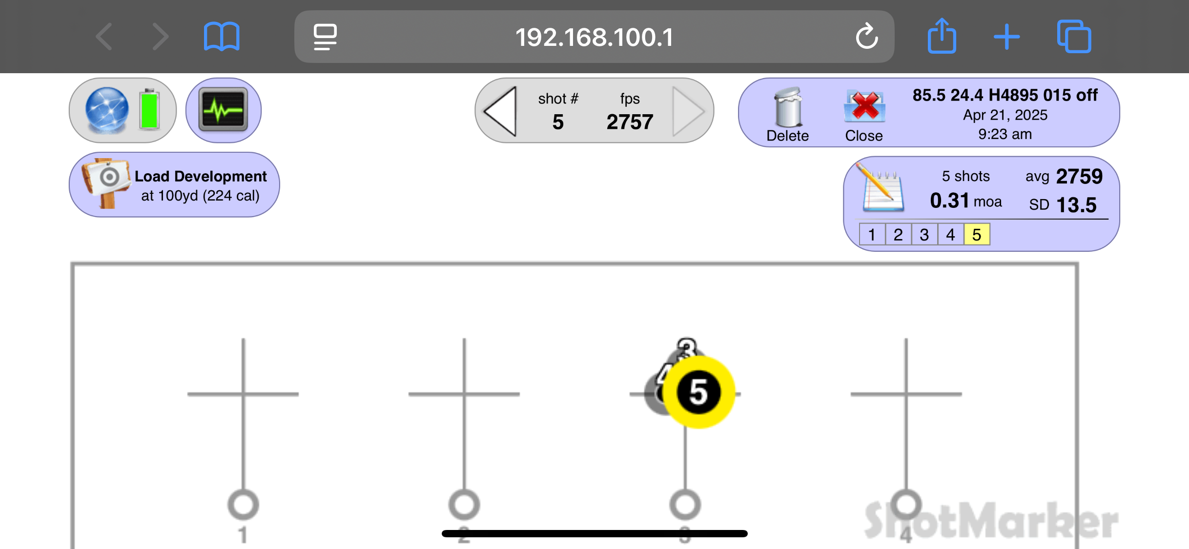

Screwing around with 85.5 Hybrids in a new 223 bolt gun build with .183 free bore, 29.5” Proof competition 7 twist.
Lapua, 205M 24.4 H4895 .015 off
COAL 2.575
CBTO 2.034
2909 AV ES 40 SD 13.4
These are the 50th thru 55th shot on this barrel. Needs more break in….ES sucks
