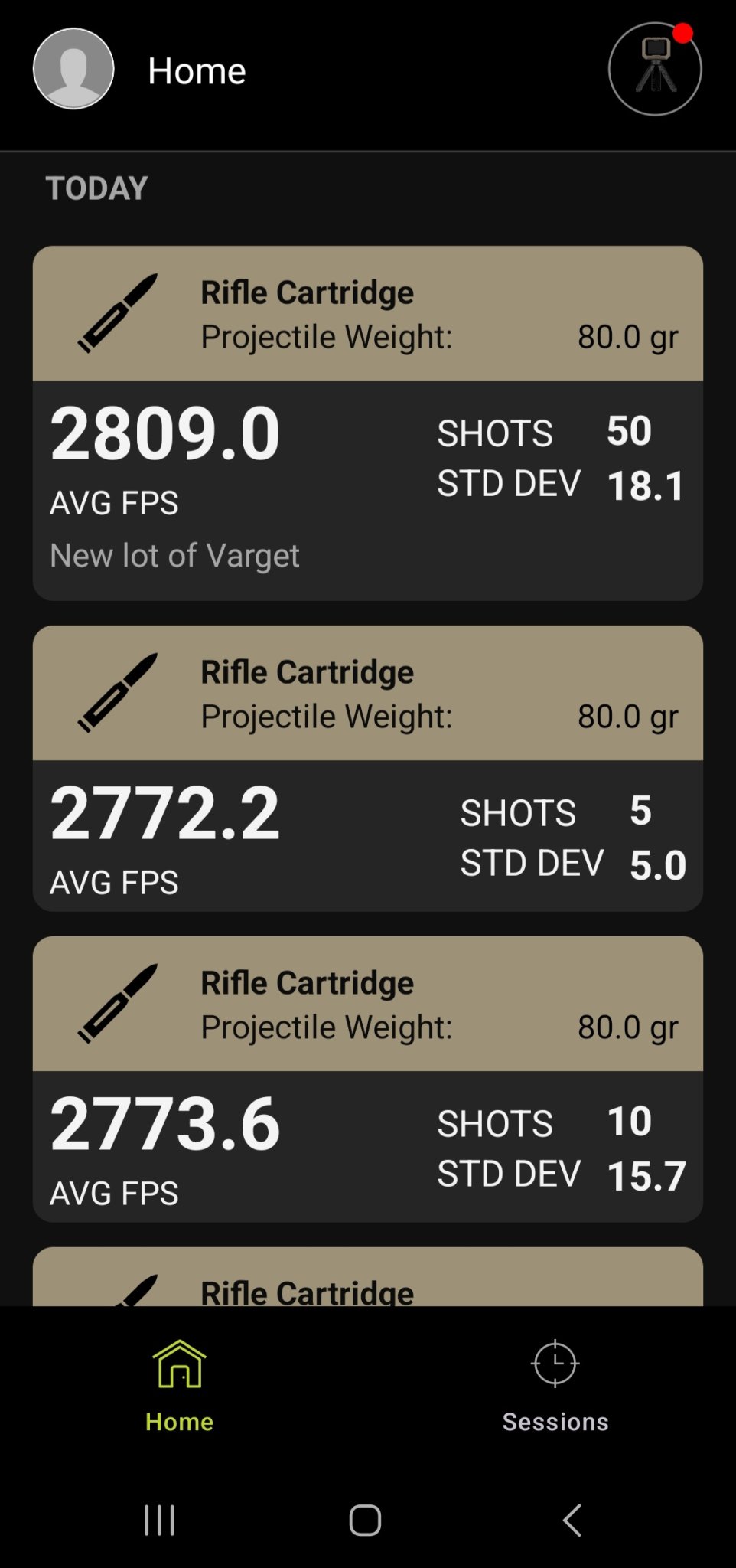

New lot of varget gave me a 40-50 fps bump at the same charge weight. 24.5g varget with an 80g smk in a 24" barrel.

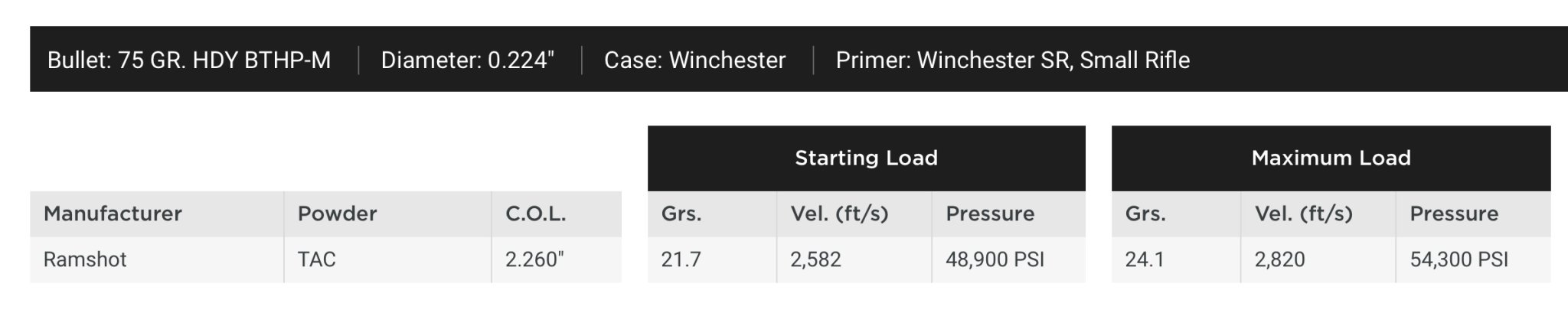

Hi all, I'm going to be making up some reloads for a .223 bolt gun (.223 Wylde chamber) I bought used in the marketplace a few months ago.
I just want to get a reality check to make sure I'm not doing anything grossly wrong.
My experience is that I've been reloading pistol for about 20 years on Dillon 550s and 650s.
I've been making .223 on my 650 to AR magazine length using COALs out of reloading manuals for roughly 10 years.
I've reloaded .308 to very high precision but honestly, I seem to have gotten lucky. Ha.
This is my first time making a precision .223 load.
This is where I am and this is my logic. Any and all input is appreciated.
I put a 75 gr A-max in a sized and trimmed case and ran it into the lands.
The round measured 2.429 COAL.
.062" seems to be a freebore that several people in this thread have said they use. So if we subtract .062 we get a COAL of 2.367.
As far as powder, I have Varget and Tac available. I've had great luck with TAC and will make my first loads with this.
Hodgedon's website shows this
So for powder, I figure I'll start out at the 21.7 grain starting load. Although pressures will be lower than normal because my COAL at 2.367 is substantially longer than their COAL of 2.260
As an aside, I've made up some dummy rounds at both the 2.429 and 2.367 COAL and they fed fine from my MDT mag.
I completely understand that optimizing things will involve adjustments to COAL, powder type, and powder quantity. I'm just interested in a starting point that is safe and reasonably accurate.
Thank you in advance for your thoughts.

Freebore and jump to lands are two different things. Freebore is a single dimension of a chamber. Distance to lands is impacted by freebore diameter, freebore length and leade angle.
That load data is probably for a 223 chamber and 223 SAAMI pressure. 223 Wylde will build pressure slower than a 223 rem. Also, 75 amax and 75 bthp aint the same and will build pressure a little differently.
More pointedly - i wouldn't start at 21.7 if you care at all about velocity. I probably wouldn't start any lower than 23.0 but I have a decent feel for the factors and risk involved. Follow the manual if that is what you do to be safe.

Before i start please remember I have been out of the reloading game for 21 years, just getting back into it. I thought that you measured the length of the round that touches the lands and then back off somewhere around .020 (variable based on what the bullet likes to jump). Is this not the way, I did not think you subtracted the Freebore.
Reactions: Snuby642
@dcmdon
The 75 Amax is a good bullet. I would figure out where the lands are and come back .010". That has been a good starting point for me when I shot them years ago.
For the powder charge, I would use the 75 GR. JLK VLD data as it more resembles the the 75 Amax.
Reactions: oldrifleman
You are 100% correct.
I didn't know that the term freebore referenced a chamber dimension. I thought it was another term for "jump" or how far back from the lands the bullet is set.
Because of my ignorance (it's not an insult. Ignorance is curable and I'm on the right path) my rounds had excessive "jump" of .062" rather than something around .010"
The funny thing is that my round is still far longer than SAAMI spec. So with that in mind, I headed off to the range with my out of spec rounds. I didn't realize that I was wrong about freebore vs jump until shortly before I went to the range. So I just ran with what I had.
I was very pleased. Since this is a new to me gun with a new scope and new stock, I started at 50 to sight it in.
This is my first and only 3 shot group at 50
So I moved out to 100 yards and shot one more group. This was the result.
So far so good. So I moved out to 300 yards.
At 300 I switched to 5 shot groups.
My groups at 300 ran from a bit under 2" to 3". All of the 3" groups were the result of a called flyer (or two).
Sorry, no pics, the guys next to me were shooting and I didn't want to ask to have the range go cold so I could just retrieve my targets.
I was very very pleased. This was my first time shooting a barreled action I purchased at the beginning of the summer for a very very good price. As a Left Handed shooter, I don't have many factory options configured how I wanted, and I was putting off buying a custom gun because of the cost. So this is really fantastic. I've got a GRAIL quality gun (Bighorn action, Bartlein barrel) for the cost of a factory gun. I don't normally get this lucky. ha. Christmas in September.
I'm going to disassemble the rest of the rounds I made up with a .62" jump and reload them with more powder and a longer COAL and see how things go next week.
Thank you all for your assistance here. I've been shooting and reloading for years. The more I learn, the more I realize I don't know. Ha.
