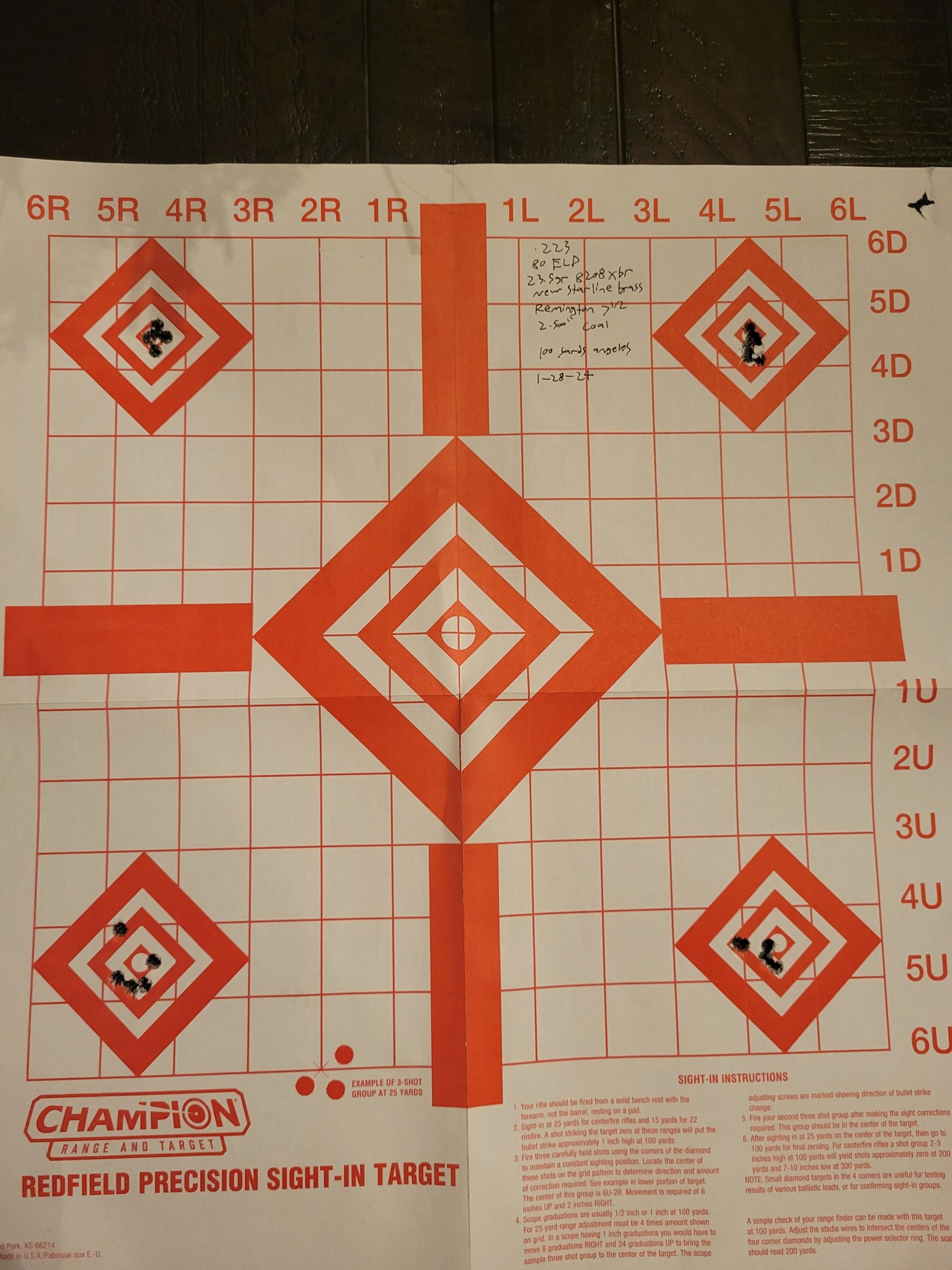

Here's some more data. New starline brass, 23.5g imr 8208, hornady 80 eld, remington 7 1/2 primer. A couple groups were good and the other two had some fliers. Not sure if it's me or the load, very well could be me. Over the 20 shots SD was 15.8 and ES was 43.6. Not sure what my next step is. May try varget as well just because. Are bushing dies a waste if you don't anneal?
I dont have any targets handy to show but I load for 3 ARs and a Ruger American Ranch, and the same two loads shoot at or better than 1moa in all three.

Here's some TAC OCW tests out of my 20" Compass Lake Bartlein AR with 77smk and 73 ELD..
I didn't have great luck with 77smk/Tac at the speeds I wanted. It shot better at lower velocity with this combo for me..
73 ELD shot really well with Tac and had good numbers and accuracy
77smk TAC 100yd OCW
73 ELD TAC 100yd OCW
77smk TAC 100yd OCW
