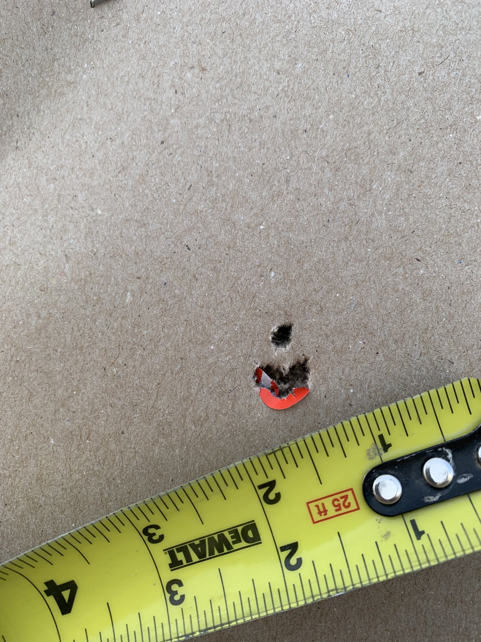

Holding together. 0.218 or 0.219 ?
Got off the phone with Berger.. they are of the opinion they will shoot "fine" out of my 28" 1-7. I didn't expect them to say any different. 🙄
