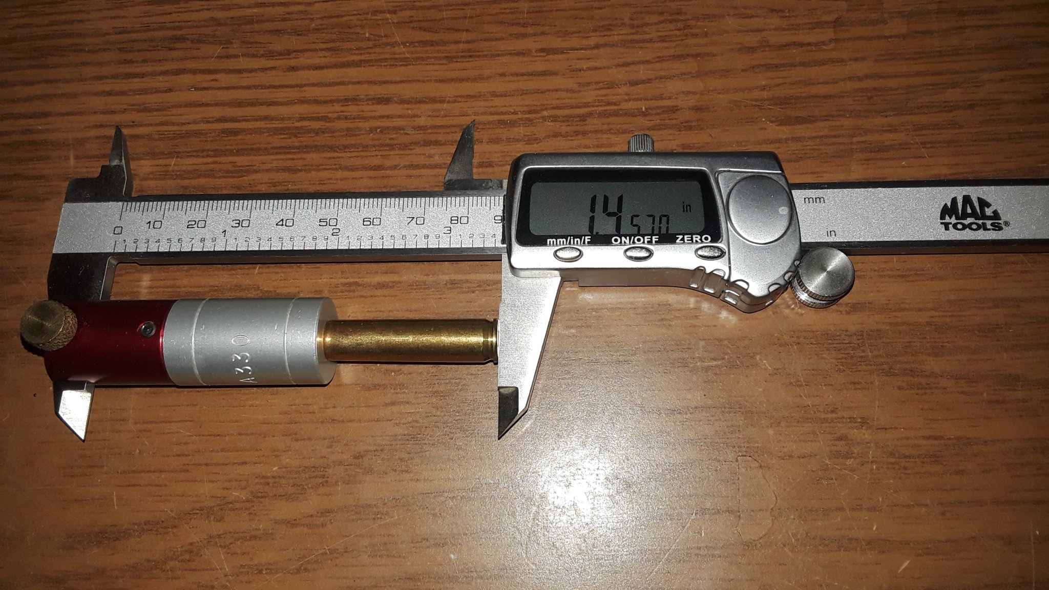

Check where you run into the lands on them. I had to go back all the way to 2.230 coal.
1.760? Bto (wag) without getting up off my but.

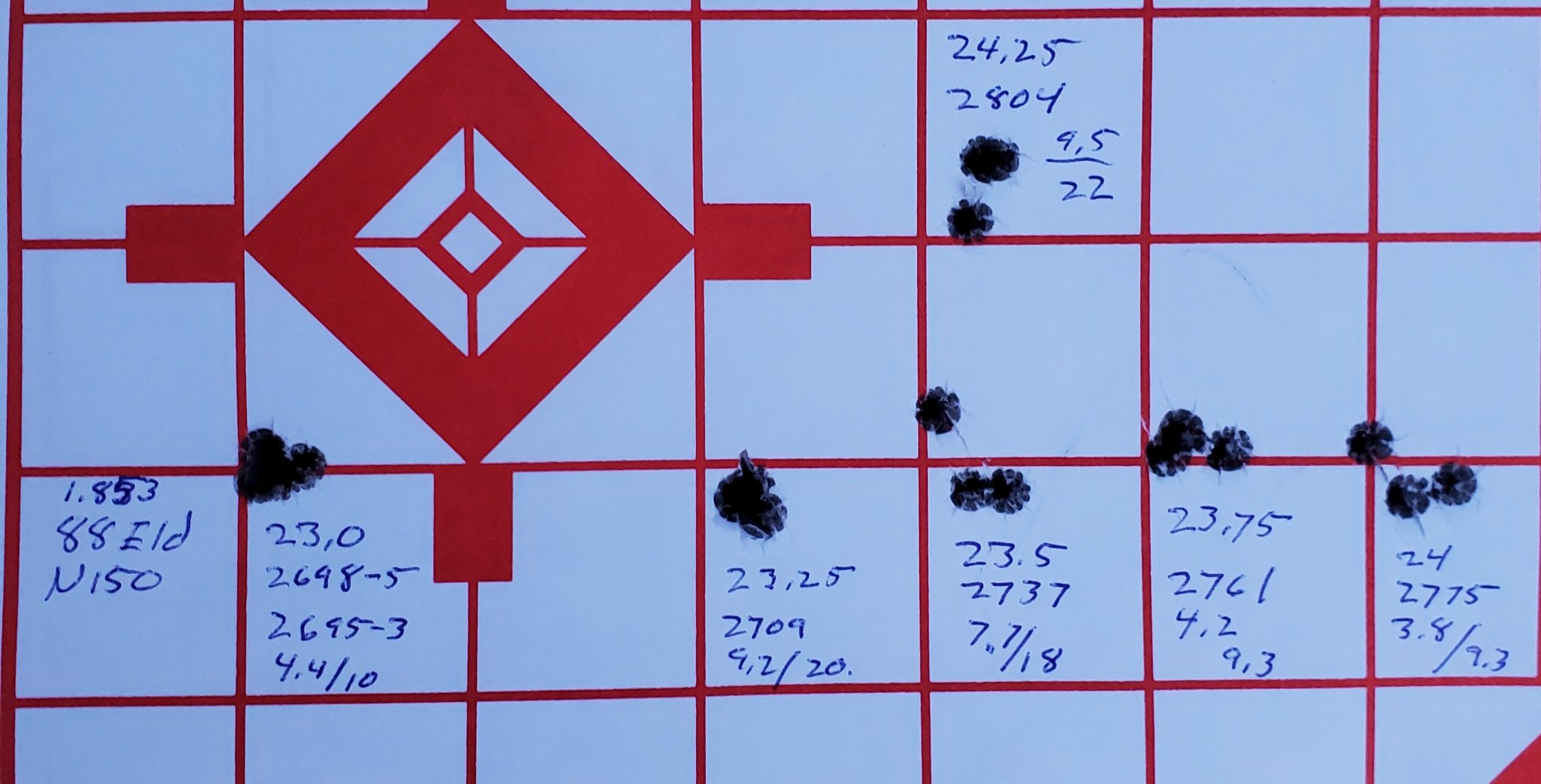

I flowed and popped a batch of primers at 2.250. Now same powder is just flattering them a bit. I may go down another 0.010 thousands since at 24.0g of H335 there is room left. (Book max from Hodgdon 24.3 at this shorter lenght)
Have my next ladder test sitting here but day after Christmas is normally a mess at the range if you know what I mean. Lol
I’ll check. Tbh for semi auto it’s not something I usually think about but it should be. I did have some better results going from 2.26 to 2.25 but it wasn’t a statistically significant amount of shots.
I think people run the heavies in bolt guns and some ar platforms that have extended throats and forget.
That leaves people with more standard spec chambers out in the weeds. Surprisingly it ends up in print from a well respected source and goes from there.
I don't think starting out in the lands is a good idea for an ar round.

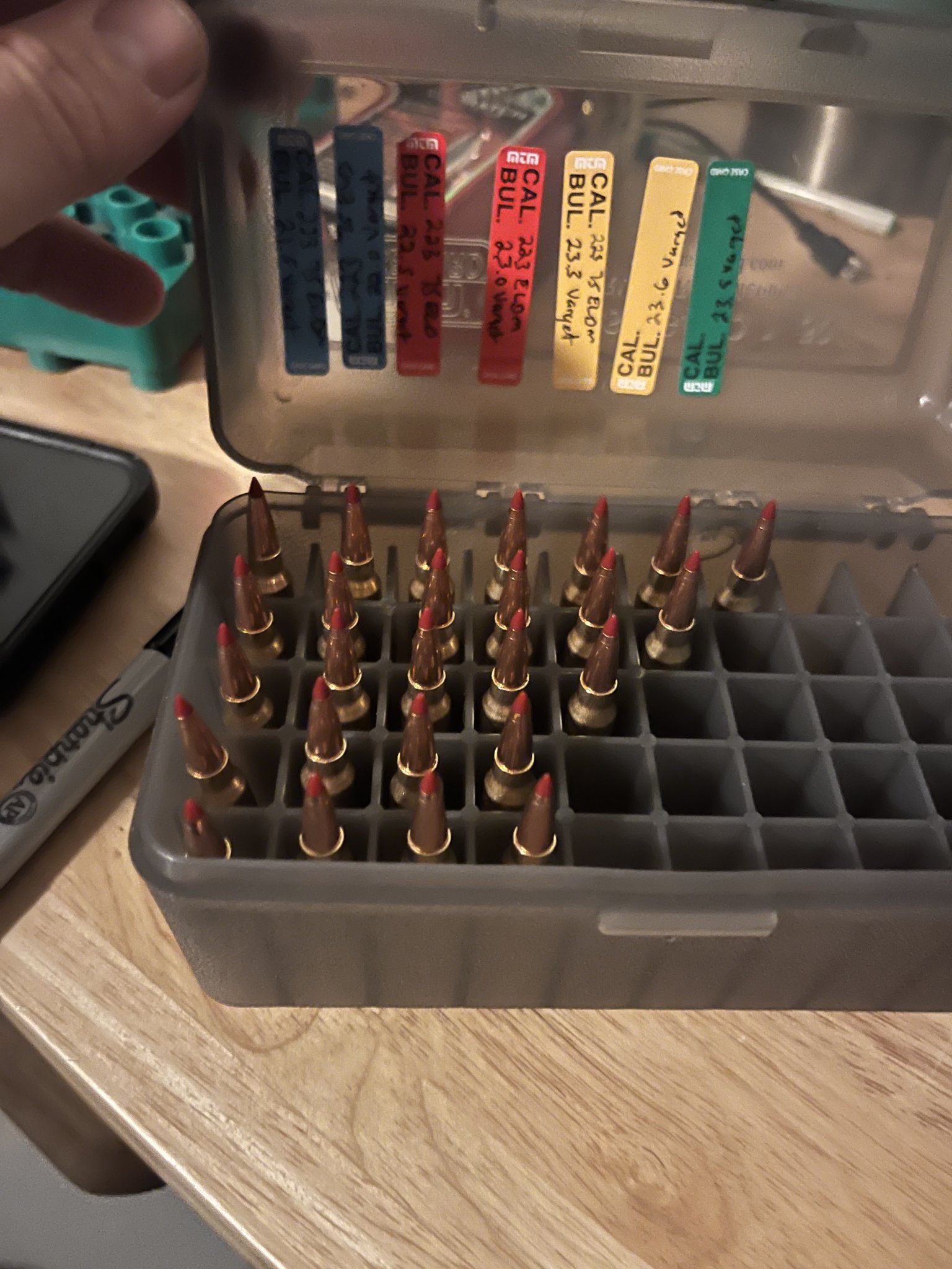

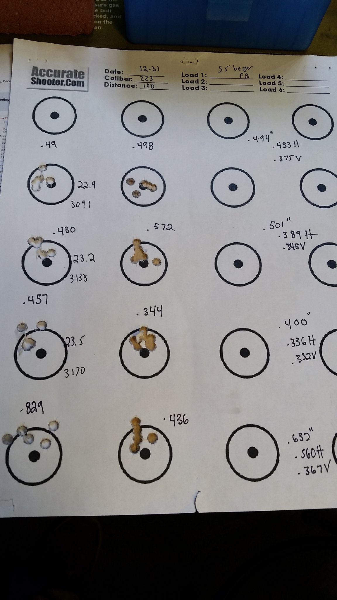

Well my Berger 55FB targets arrived. 2.40" should set them around 20 tho from the lands in my rifle.
Will try some N133 starting at 22.9 and as long as things look good ending at 23.8g. GRT predicts velocity of 3100 for the 23.8g.
I have my doubts they will out shoot the 80.5s in my 1-7T but we shall see.
Always open thoughts/opinions

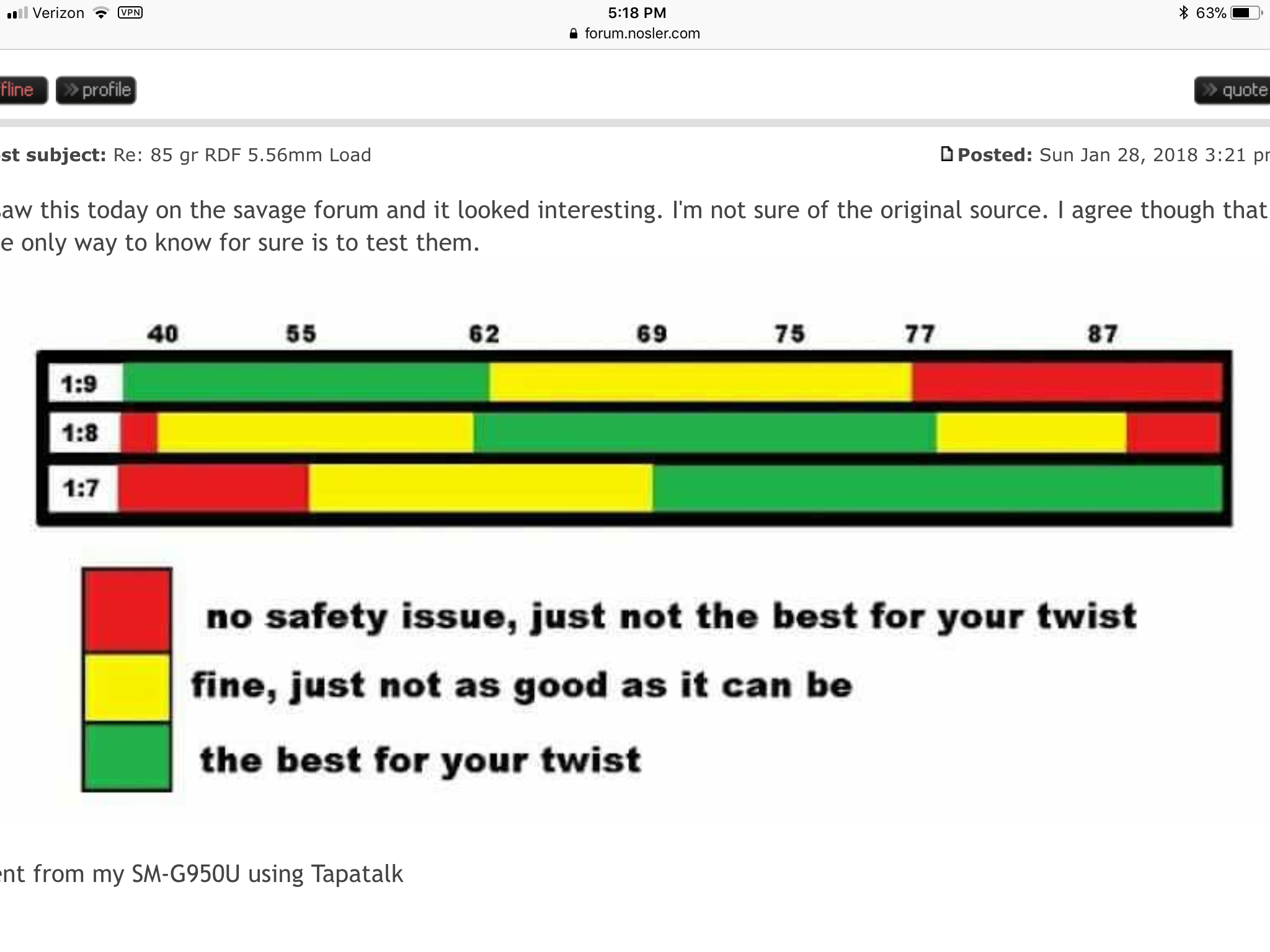

Curious because I was considering the same experiment in my 1:7 tw.
Reactions: Snuby642

No case length (1.75) is generally not a huge determining factor as long as it doesn't effect my slight crimp. I was talking about shoulder dimension (1.4635 + /- 0.0005) in my guns.
I typically run 1.460 -1.461 shoulders for all. that's not super tight an allows for plenty of dirty chambers. I have ran 1.462 but have to keep the chambers clean in cold weather especially if running a can.
So the first factory load I could find is 1.4570.
That's an extra 0.003 thousands slop I dont need at the shoulder and I didn't measure the diameter slop iether.
This is typical of factory brass loaded or not.
The results of the pride and care you put into your reloading will show up better if you use fire formed brass. I think you could see a lot more sub moa days that way.
Got's to go score some steroids, later.
That's funny, I am out of blood pressure meds. Good lick.
Is that fired in an AR chamber? Might have missed it in a previous post. My fired shoulders measure 1.458" in a wylde chamber with the hornady tool. I remember some brass fired in ARs measured closer to your numbers. With a standard lee full length sizing die I can set it up per instructions and it is right about a .002" bump. Just curious really.
Reactions: Snuby642
Yes sir, fired in my ar's.
80% of range brass falls right in there as well.
Take a wild guess what a standard go gauge is.
The fact that our chambers fired brass measurements don't line up better is not a big thing at all.
The Hornady tool is listed a comparator, not a gauge.
They may not match each other.
But the intent to check your brass from your chamber and load to it, less bump measuring with the same tool works regardless of actual measurement.
Also some manufacturers run tighter chambers (or bolts) so factory rounds will fit better
gaining accuracy ( like they did some magical thing lol) and their perceived status as being special.
Here is a hint, I HATE PROPRIATARY SHIT.
I'm guessing your gun shoots factory ammo way better than any of mine.
One of the five I load for was headspaced like yours and did shoot factory ammo the best of the lot.
I put in a different bolt to get it to match the others so I have only one case prep.
If only shooting in one gun the 0.002 bump is what I would use and keep it clean.
In case of emergency on a two way I need any ammo I have crammed into any one of my guns to run hot cold dirty or clean.
Well I got around to shooting the Berger 55g FB Targets through my 1-7T 28" barrel.
Not great, but they didn't keyhole either. 😊
Only did 4 different charge weights (2 groups of 5, 40 rounds total) all seated twenty thousand off the lands. Perhaps I should have seated them at touch, but man that doesn't leave much projectile as far as eating depth goes.
SD's were my typical low teen numbers. Try as I might single digit escapes me on caliber 223.
Reactions: Snuby642 and st1650
Well that's interesting .
Horizontal and vertical dispersion on the same charge weight? Two different groups.
Barrel getting hot?
I don't think so. It was mid 40s day of testing. It's a "bull" contour.
If I had a proper 14T I would be disappointed.
I'll check my numbers and IF I can jam, I'll give that a shot.
Might be a couple of weeks though. Turning a bit cold 4 my likes.
I would pick one of those charges and start playing with seating depth

From another forum long ago…
You can use a stability calculator like the one from Berger or JBM to factor in atmospheric pressure. The lower your altitude and temperature, the denser the air is, and the more gyroscopic stability is needed. Berger's calculator will also show how much a lower Sg compromises the bullet's BC. For JBM's calculator you'll need to use an atmospheric pressure calculator to determine the pressure in mmHg
Bottom line is sea-level in Alaska in winter could result in unstable bullets even when the simpler rules of thumb suggest the twist rate is fine. At high-altitude in the Rockies in late summer the longer bullets can be used with lower than normally recommended twist rates.
I live at 5000 feet and it makes a difference of about 1 inch of twist rate in a chart like that.
@Niles Coyote
Anyway you can split 23.0 and 23.25 loads?
23.5 and above are pure scatter mode, cfe223 does that right above the best node also.
What scale are you using that drops in 0.25g increments or is that just your preference?
I ask because if 23.25 is that close to heavy compression a 100 degree day may get you back to scatter since no headroom for powder left.
I get away with a little compression with varget but there is a lot of space inside.
The 23.75 has a substandard (for you) load on both sides of it so to me it's out.
Nice shooting by the way.
Ya I guess with that scale I would do 0.25 ladder tests as well.
All I can get is 0.1gr resolution.
I'm not sure I can shoot 0.05 increments but it would be nice to try.
0.02 is crazy, how much does one " stick" of varget weigh? Lol
Somewhere around .02 or a little under depending how it got cut. The scale only reads to .02 but if I set the Autotickler on say 23.24 I'll get more drops at 23.22 and 23.26 than if I set it on an odd number... setting the Autotickler on an odd number usually will get me either 23.24 or 23.26 which is close enough for my purposes here.

Long time lurker in reloading, first batch of ammo Ive made
Been getting components for about 6 months now and I finally sat down and tried my hand.
Thanks to a few fellas who took the time to walk me through stuff in person and on the phone I’m off the a good start
These are my 223 loads im gonna be testing:
Starline Brass
CCI 450M SRP
Hornady 75 ELD
Varget
Starting at 21.5 Grains and worked up to 23.9 (being a little conservative for my first go at this)

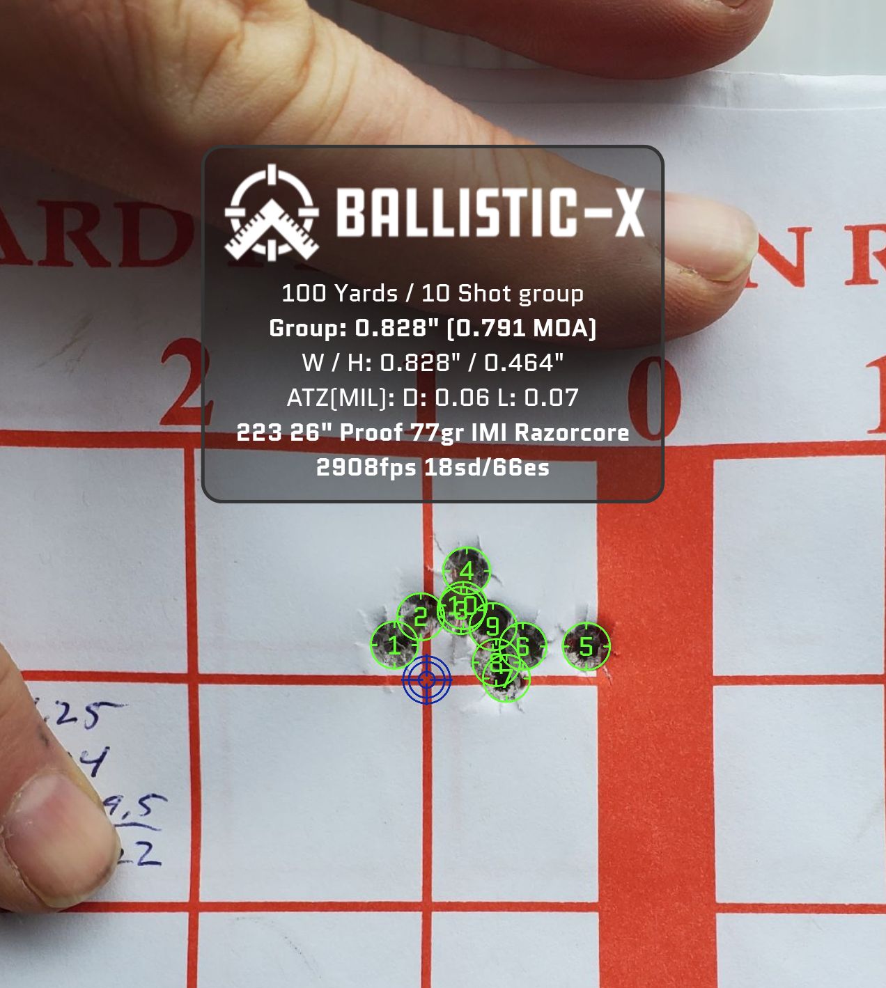

Just in case you ever wondered how 77gr IMI Razorcore ammo shot from a 737 impact action and a 26" proof prefit barrel... the shot that went wide was probably my grip pressure and technique.

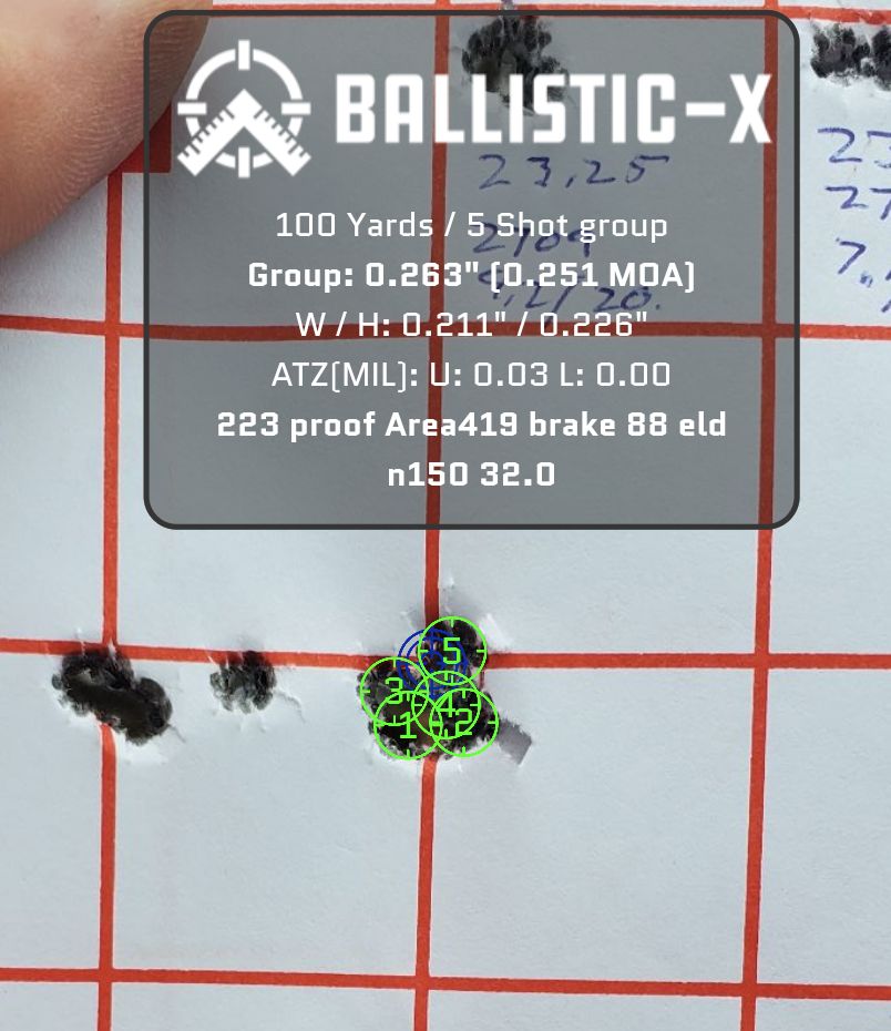

23gr of n150 ( not 32 🤣) and 88 eld's are still preforming well.

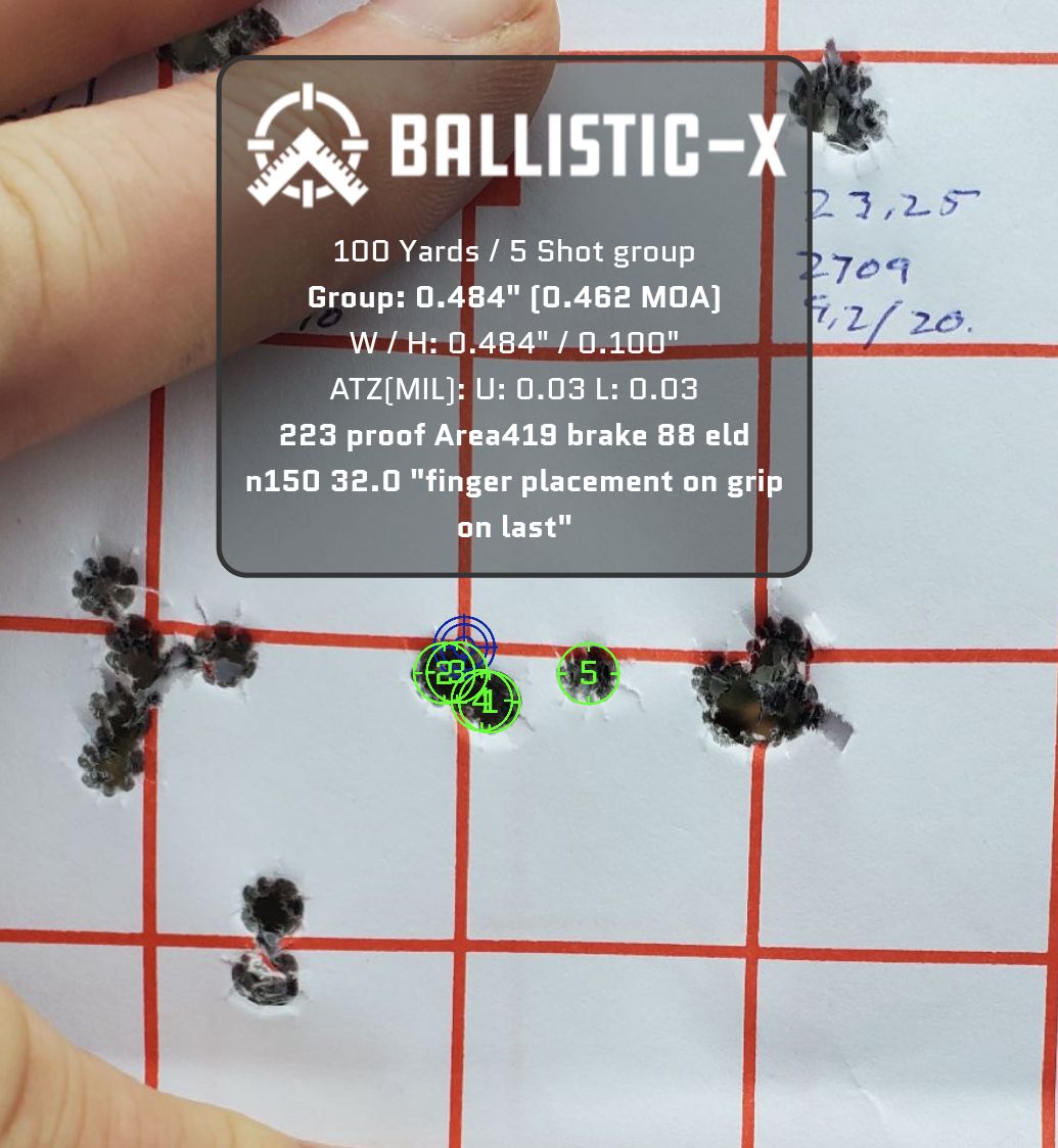

That right flier below was 100% influenced by finger placement on the grip.
