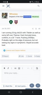

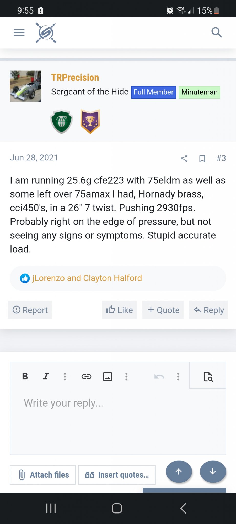

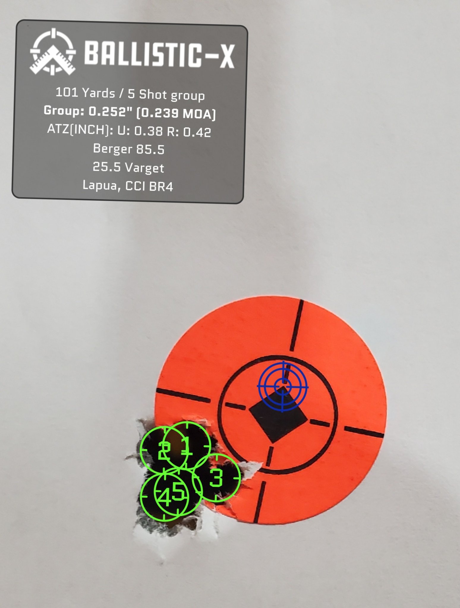

Had really good luck with 85.5s touching the lands at 2.018" cbto, 25.5gr Varget. Very slight primer flow but they're still round not flat. May back off .1.
Matchs 6.5 wind and less drop.
Gonna continue and try RL15.5, might be a touch less velocity but a good amount less pressure. Now if I only I can find some more of it.
*Obiviously not a standard throat, start low work up.

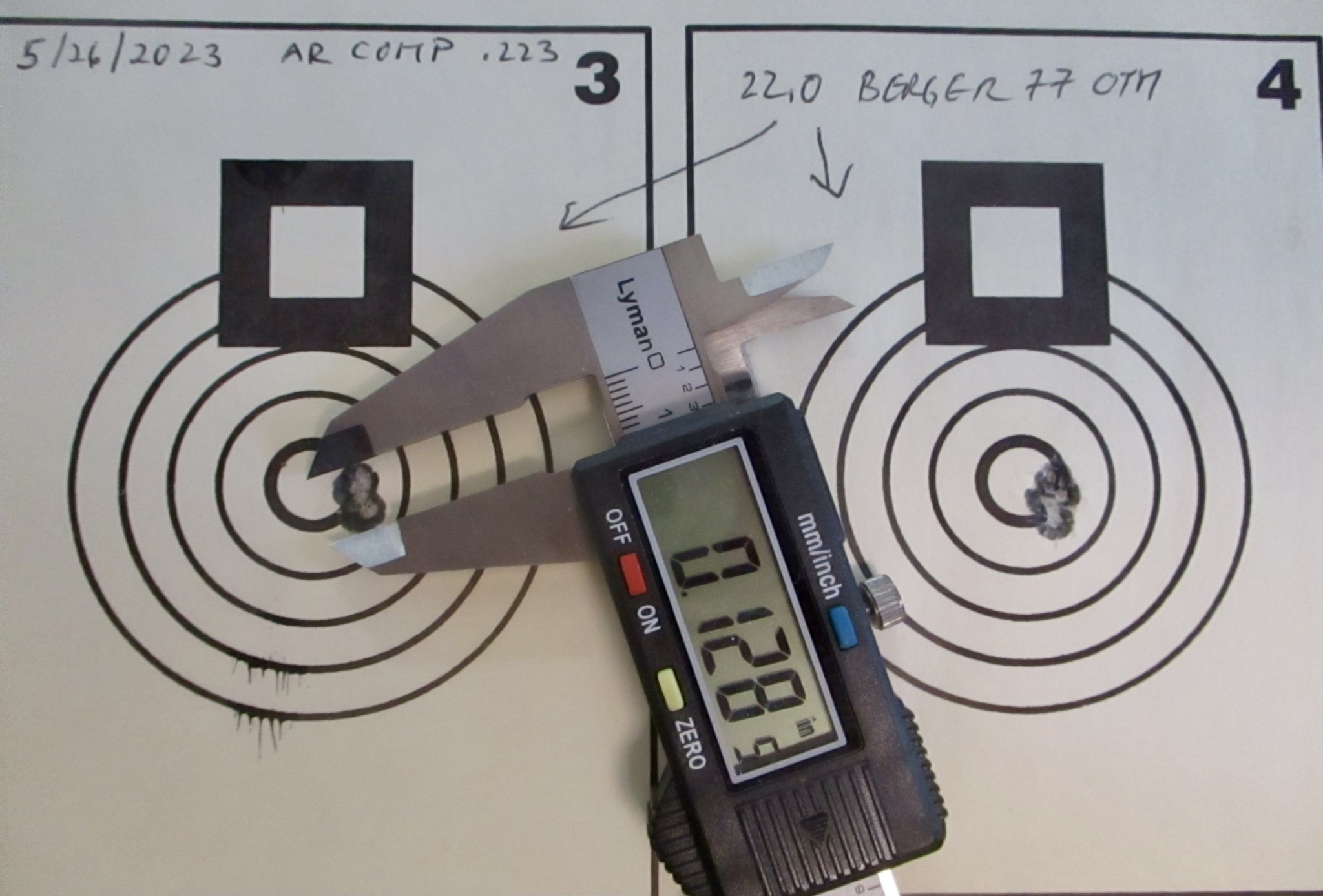

Well I got my new 223. So far all I have tried is the 85.5 bergers and AR Comp. Quickly found a load that is shooting pretty well.
Load data:
Starlink brass F-0
CCI BR-4
AR Comp @ 23.1 grains
Berger 85.5 GR hybrids
CBTO 1.945”
Rifle has a 28.5” kreiger 1:6.5 twist barrel. 10 shot string averaged 2855 fps with SD of 11 and an ES of 30. Hoping to pull down the SD and ES a little now that I have some once fired brass.
10 shot group at 100 measured 0.59” with a little bit of me making it bigger than the rifle wanted it to be.

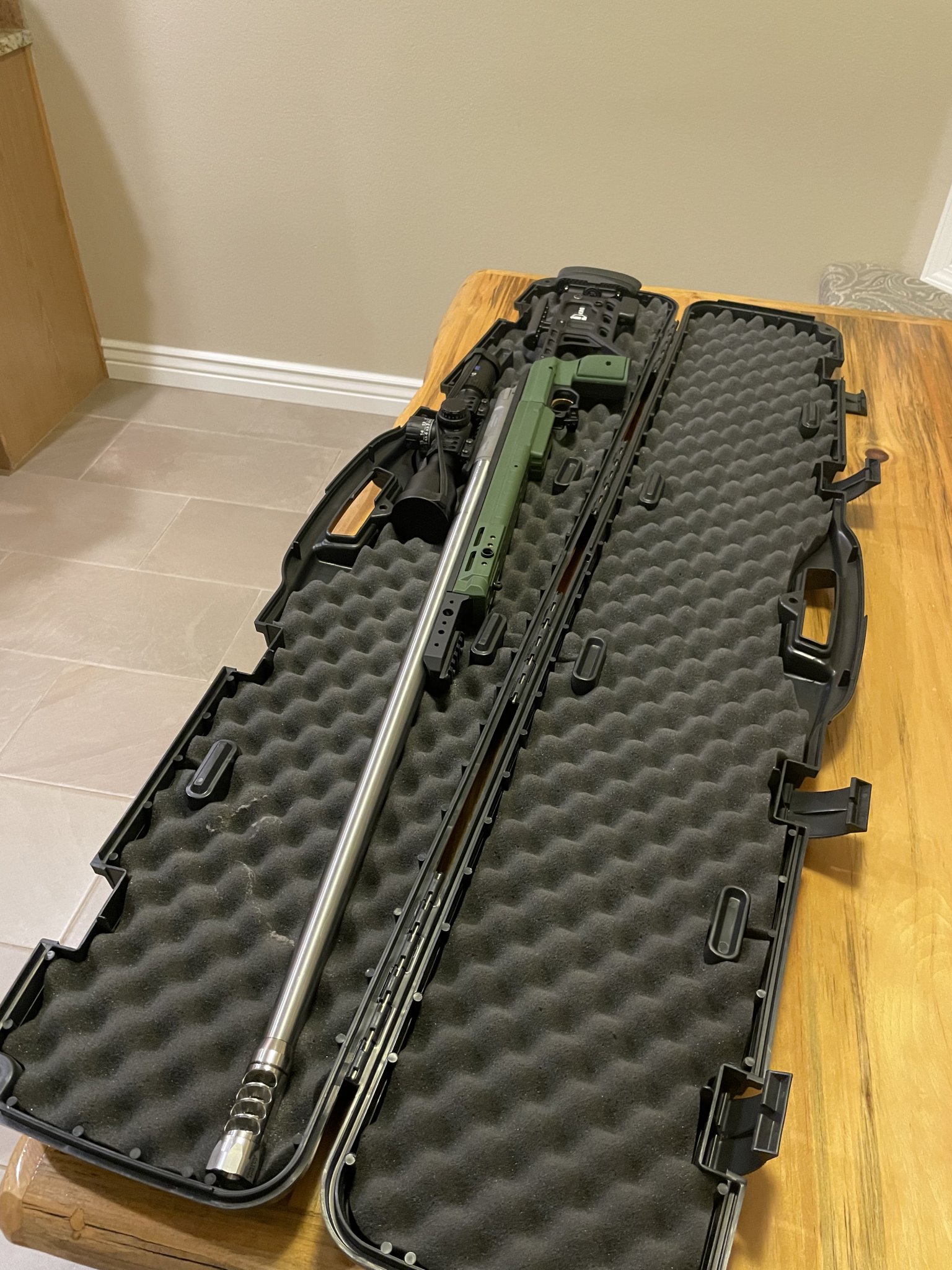

And just for fun here is the rifle

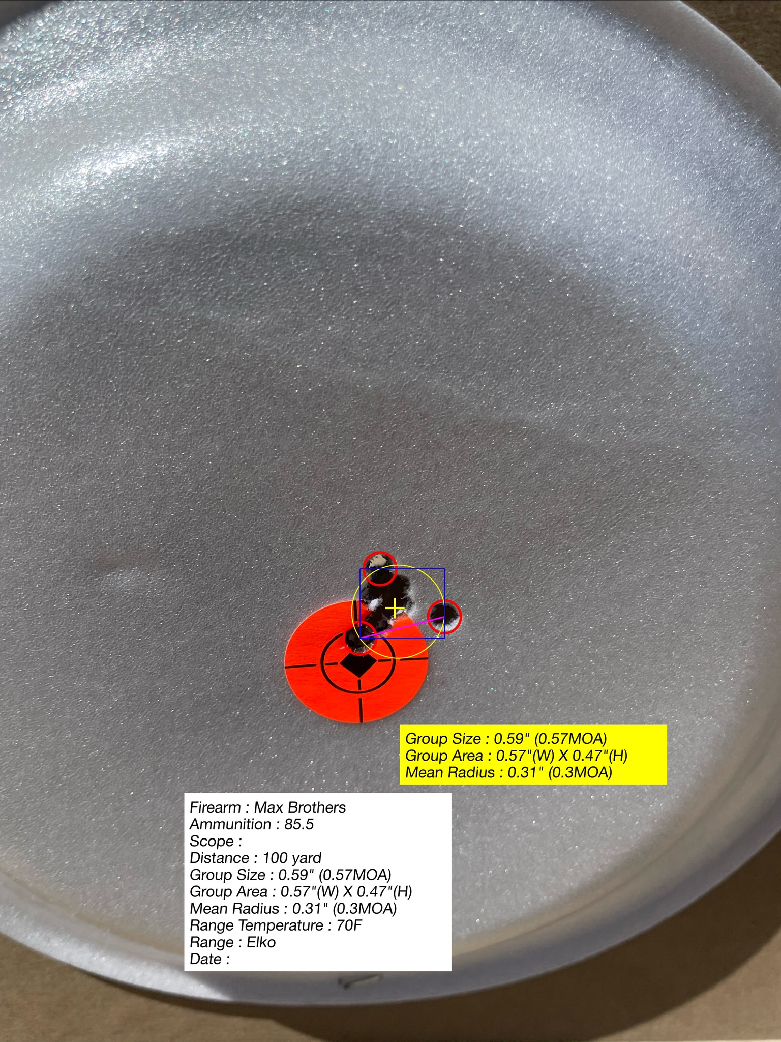

Load data:
Starlink brass F-0
CCI BR-4
CBTO 1.945”

I was seeing 2930 with 25.5 Varget @ 2.018 cbto, 26" barrel,
.015" off hard jam still but still leaves slight rifling marks on the bullet so it is touching. Wouldn't go any higher than that but primers (BR4s) and brass(Lapua) look good. Moving to try RL15.5 with the 85.5s and save the varget for the 80gr smks @ 600y line. I don't think I can fit enough RL15.5 to create pressure, 25.8grs was a tiny bit crunchy with the 88gr ELDs and showed no pressure signs.

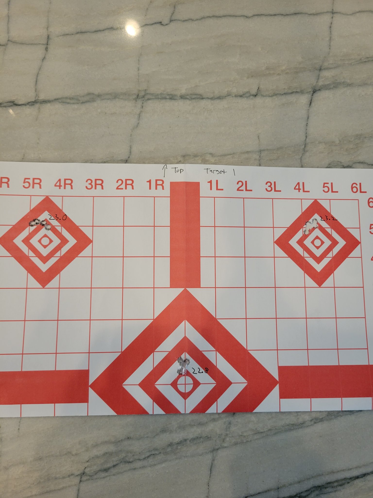

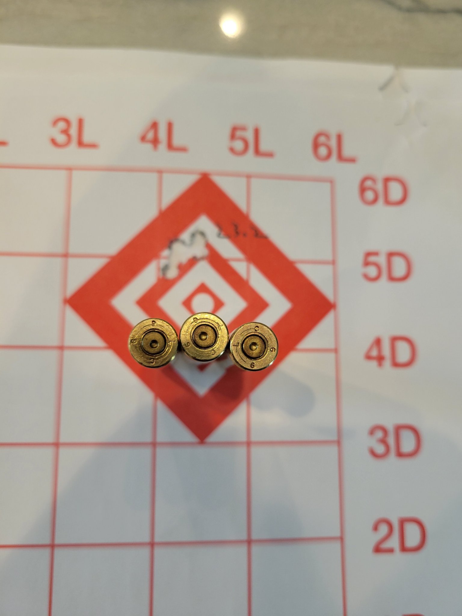

Here are my results. Are groups are shot with the magnetospeed attached. Rifle is a bighorn origin action with a bartlein 223 wylde 1-7 twist 24" shouldered prefit from keystone. Load is the hornady 80gr eld with lake city 69 brass, Winchester srp, imr 8208, 2.500 coal. I've never used a chrono for load development so let me know what you guys think of the results and what the next step should be. Zero experience with analyzing data like this first hand. Pics of some of the fired cases are shown next to their corresponding charge weight. Based on the looks of these and the velocities should I keep going up in powder charge? Ignore the center target that doesn't have a charge weight written next to it, completely different load.
22.8 gr
2693, 2720, 2697, 2703, 2686
23.0 gr
2748, 2722, 2722, 2726, 2713
23.2 gr
2711, 2745, 2752, 2798, 2739
23.4 gr
2766, 2764, 2762, 2762, 2761
23.6 gr
2769, 2803, 2781, 2781, 2769
22.8 gr
23.0 gr
23.2 gr
23.4 gr
23.6 gr

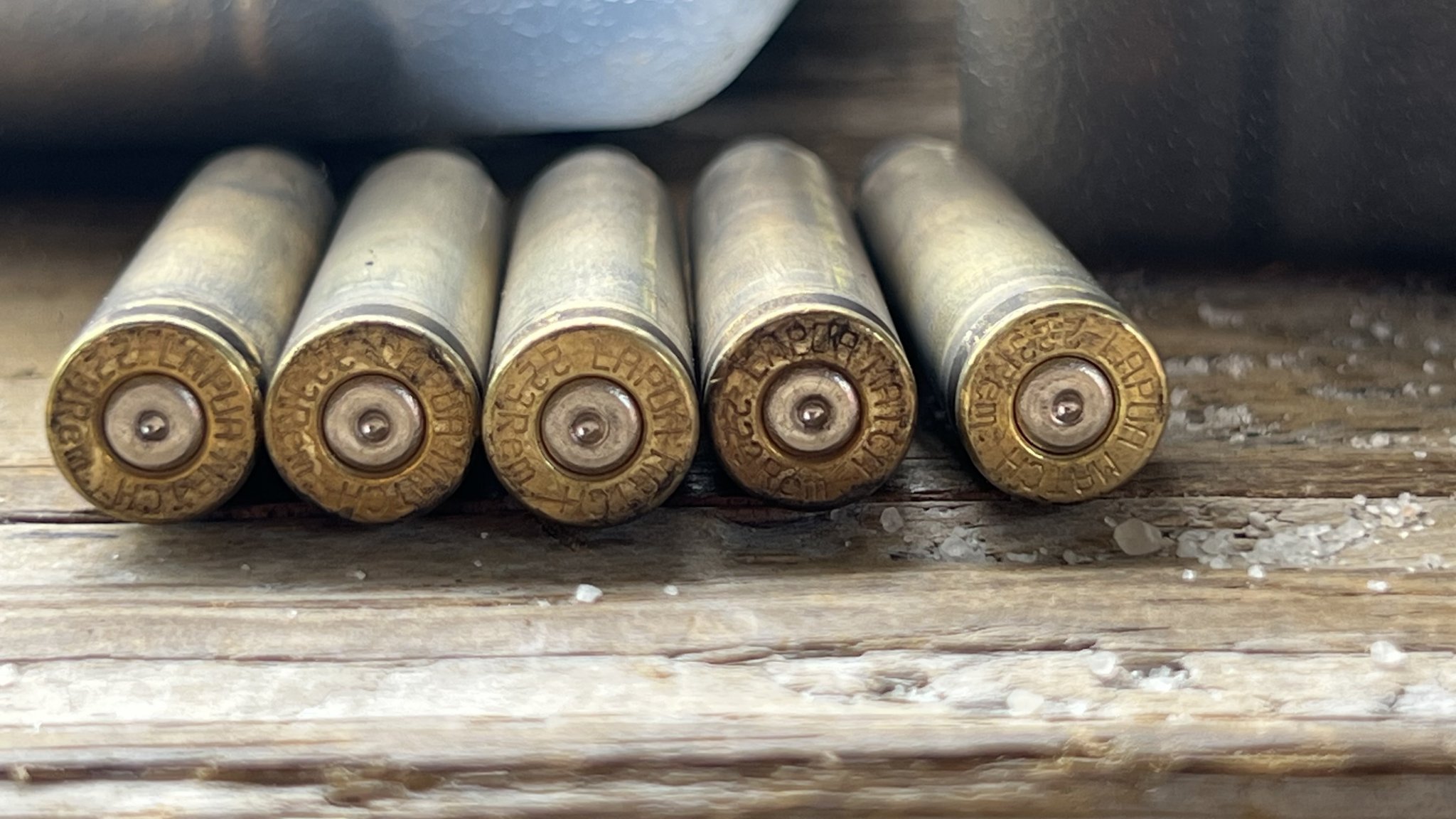

I would say if your happy with the velocity keep fine tuning. If not maybe try Varget. Less pressure than 8208 with heavier bullets.
Are those primers blanked? As in releasing pressure back into the gun? If so reduce charge. Do you know where you are in relation to the lands? Los like the barrel shows some promise. Personally when I am looking to test maximum accuracy capabilities of a barrel I will shoot some Sierra and some Berger Bullets to get an idea.

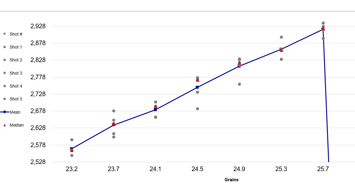

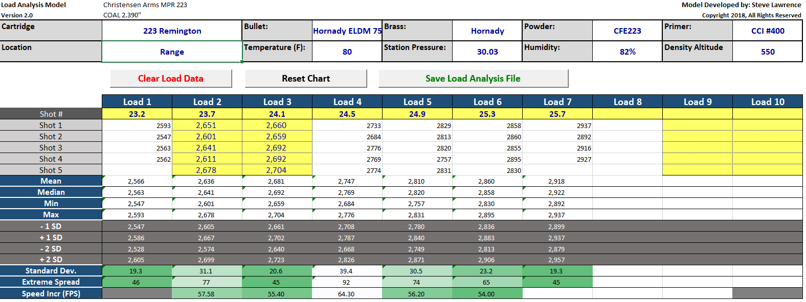

I picked up a Christensen Arms MPR in 223 rem, 20" barrel steel, 1-8"
I mounted a Zeiss V4 4x16x50 on it.
I'm trying to load some 75 grain Hornady ELDM
Was just doing a load workup and the initial results were not good
The groups were not good at all, most +2", I started to get pierced primers at 25.7gr and my book says 26.5 is the max load so I stopped shooting.
I checked Jam on my rifle and got 2.471" and think I might rerun the test with the bullet seated much longer.
I don't really see anywhere to start!
View attachment 8175821View attachment 8175822
Hodgdon shows 25.0 as max for their 75gr data and you have higher velocity at 20" than their 24" test gun. So yes likely way too much pressure.

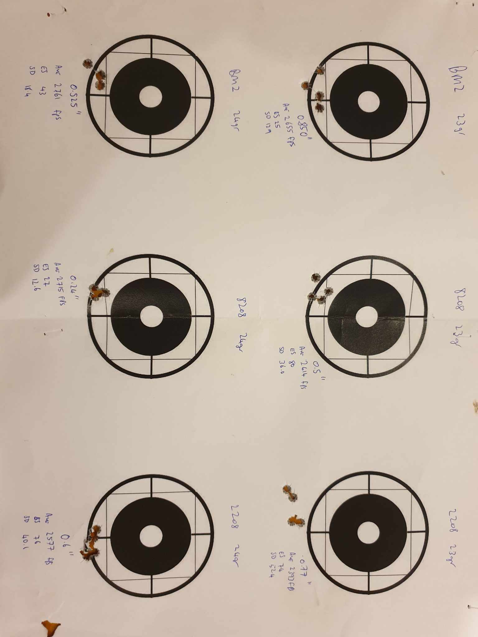

I carried out a velocity test with 75gr HPBT (Hornady) using three different powders, and got some very strange results.
All the powders are ADI powders; 2208, Benchmark 8202, and Benchmark 2, these are the same as; Varget, 8208 XBR, and Benchmark.
I tried 23.0gr and 24.0gr, 4 rounds of each and found the complete opposite of what I was expecting.
Varget being the slowest by a long way, and Benchmark the fastest.
This was from my Tikka with a 18" factory barrel.
See the picture for the velocities of each group.

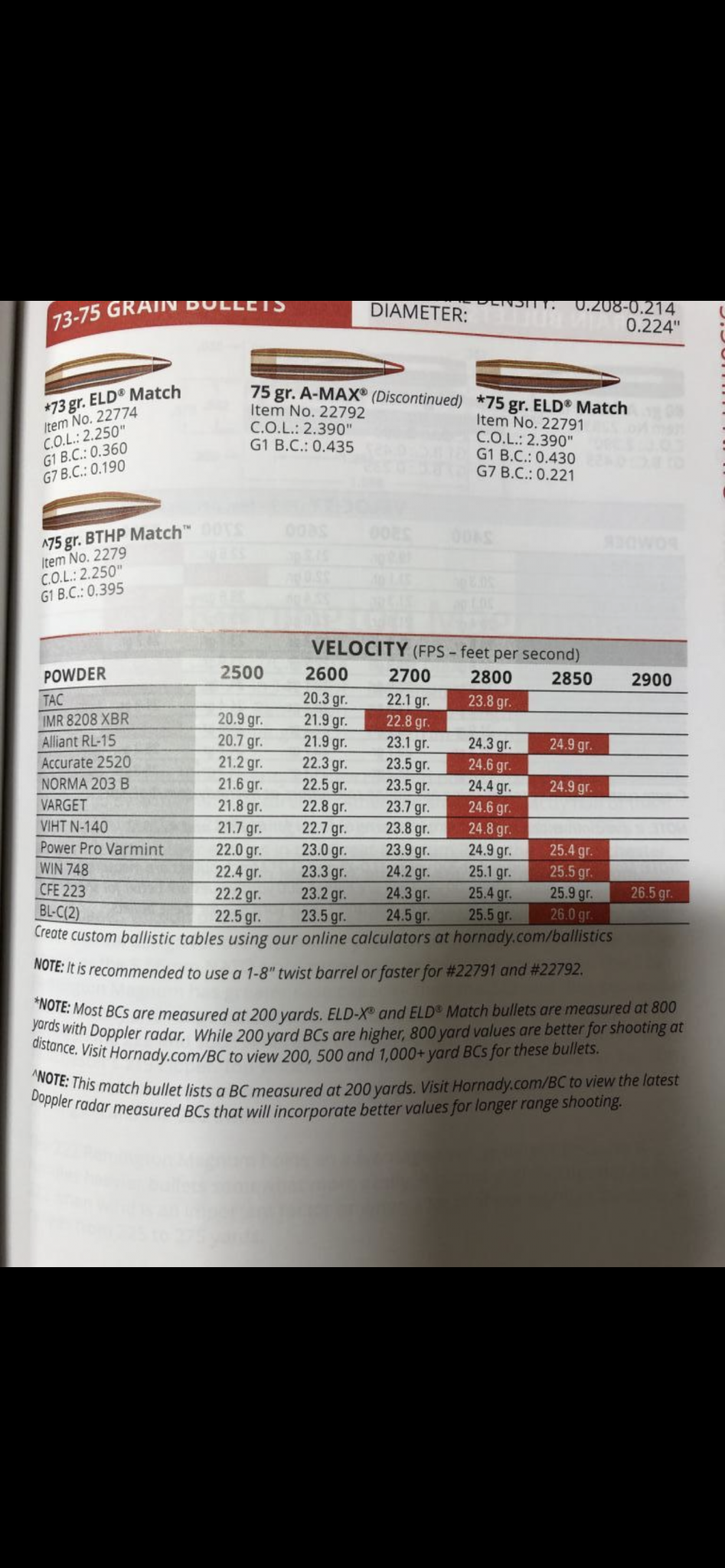

Do any of you folks have the new Hornady manual? I asked them if they had any data for Lever and the 88gr eldm bullet. They referred me to the 5.56 section of their new manual which I do not have access to. Wylde chamber.
I use 25 gr's of LVR & the 75 gr Hornady BTHP in my Venture II bolt action @ 2.360" shoots nickel groups.
Another one you don't usually see is ww 760, I like 27grs of it with the same bullet & length. Same POI. I have a Chorny but have not put them through it yet. This is my best shooting bullet through the rifle, 1 in 9 twist - 5R rifling. Don't know about the 88 gr but I know are starting to use LVR with the 75 & 68's.
