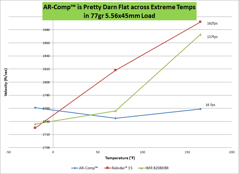

"AR-Comp Offers Uniform Velocities over a Wide Temp Range
Tests were done with .223 Rem and .308 Win ammo, loaded with AR-Comp and maintained at temps from -20° F to +160° F in a controlled test center. The ammo itself was heated or cooled to targeted temps before testing. Across that range of temperature, -20° F to +160° F, the ammo loaded with AR-Comp showed a variation of only 20 fps in muzzle velocity. The primary bullet type tested was a 77gr .224 bullet and the secondary was a 175gr .308 bullet.
Burn Rate Like Varget: Though this is a reformulation of Reloder 15, the burn rate of AR-Comp is slightly faster than RL15. Alliant told us: “Reloder 15 is slightly slower, in burn rate, than Varget. The new AR-Comp, with the enhancements, ended up slightly faster than Reloder 15, so it is now very close to Varget in burn rate”. This is the result of the “tuning” of the powder to be much less temp-sensitive.
Meters Like Reloder 15: AR-Comp is a small-kernel, double-base extruded powder like Reloder 15, so it will continue to meter just like Reloder 15. The load density should be the same as Reloder 15.
Loaded Ammo: We asked if any manufacturer will be using AR-Comp in loaded ammo. Dick told us that: “he’s not allowed to release that information at this time.” Draw your own conclusions, but remember that Alliant is owned by ATK, which makes Federal rifle ammo."
Reactions: 260284 and lte82

From my own personal experience having used a handful of kegs of AR Comp, it’s very temp stable, more so than varget even, but it has a faster burn rate. It’s a very low heat powder and barrel life is very very good. Accuracy is the best of any powder I’ve tried for 223/308, with very low SDs.
Back to burn rate.I’ve used it with 6br and 6 dasher, and while accuracy is amazing I’ve run into pressure issues at velocities that seem low. Varget is also really good in my 6x47L but AR Comp won’t produce very good velocities without pressure. It works in 6.5 creedmoor with the 120 class bullets though velocities are pretty mild, but for heavy bullets it’s too fast burning to get decent velocities.
