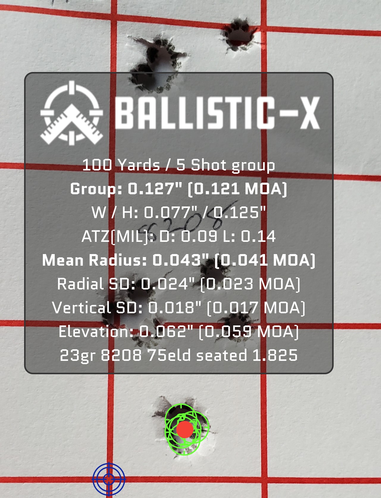

I just recently came across a box of 69 grain berger match burners that I had never tried before. I loaded those in lake city brass with 23.5 grains of TAC and got .75 MOA. Easy on the wallet on tight groups. Also work well with 23.5 grains of CFE 223

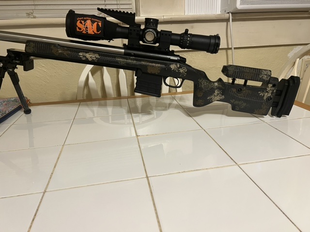

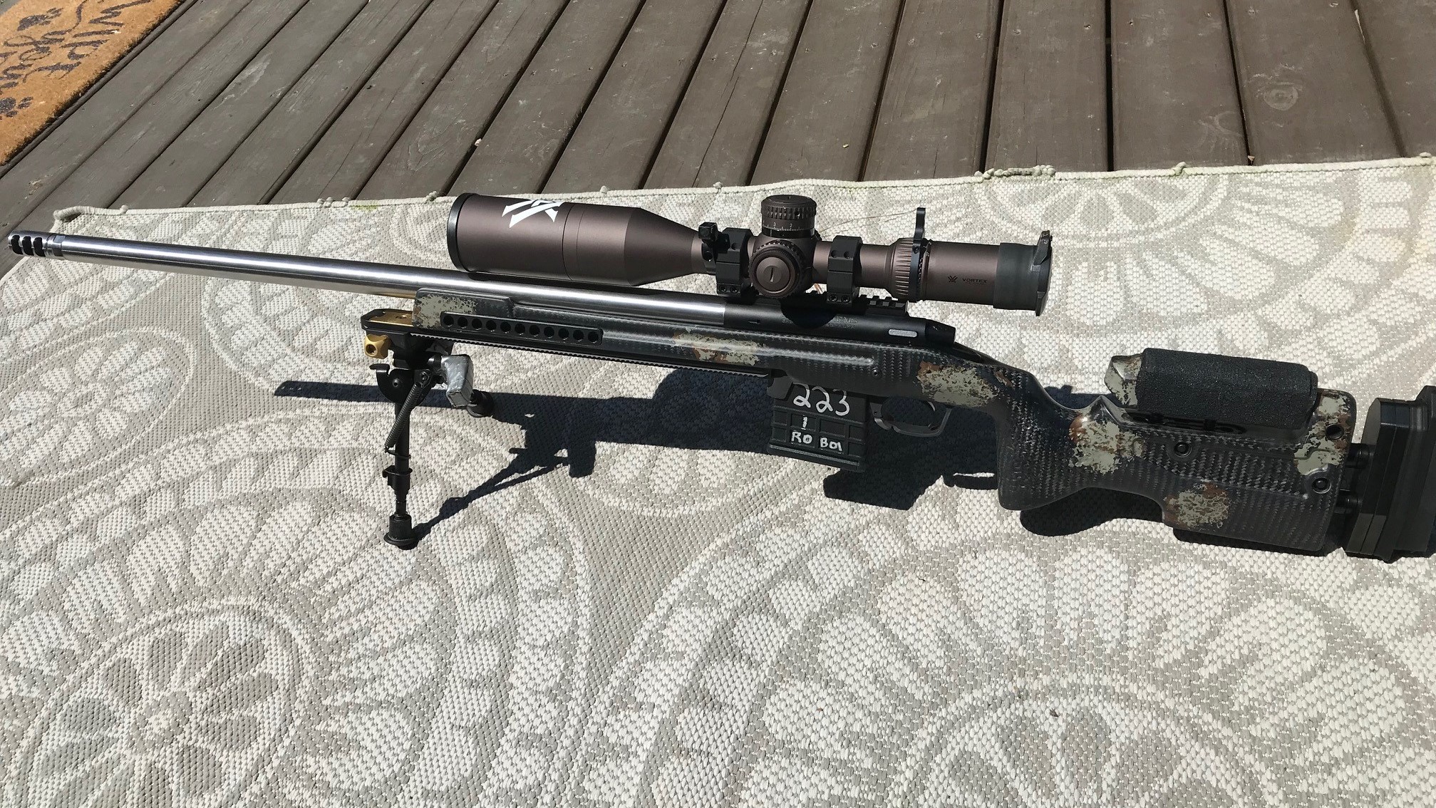

Got my .223 TAC class rifle together recently and bought two cases of the Berger 77gr OTM loaded ammunition to break in the 26” Proof Prefit. I have 1500 75gr ELDM’s and 500 new Lapua brass but just curious which powder has the best results normally with that combination. I have 8-10lbs of Varget, 10lbs of N-140 and 2lbs of 8208 at the moment.
Did you steal my rifle and put a NF on it? LOL Any of those powders will work. I have used Varget and 8208 with 75s and I know others use N140. I would try using the powder you don't use for something else between the Varget and N140 as only 2 pounds of 8208 will only load about 550 rounds.
Reactions: Lichn8r
Funny thing is I did have my Razor Gen II on it before I put it back on my .22lr. I actually switched my ZCO over to it the other night because we have a night shoot coming up in November and if needed I like the reticle illumination better on the ZCO than the ATACR.
Reactions: Rob01
I thought I saw something about that maybe on facebook but not having a NV or thermal I didn't pay anymore attention. Have fun.

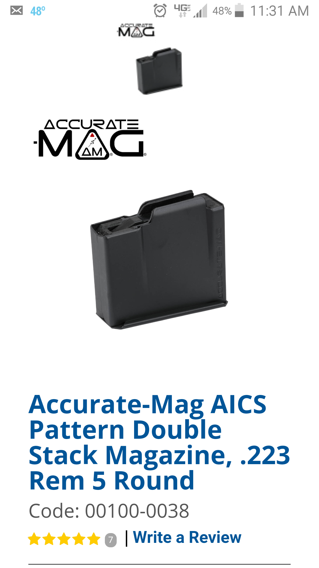

Anyone run one of these mags in a MDT style chassis?
The 10 round MDT mags work flawless. However I'm looking 4 1 that's shorter.
I just want to make sure it runs OK before purchase.
I run the 10rd accurate that uses the same insert in the AICS footprint in my ACC. Runs fine. Can't imagine that the shorter flavor will work differently. Haven't heard reports of them not running smoothly.
