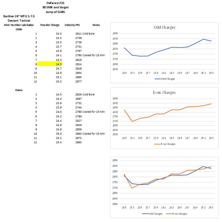

My go-to load on this has been 24.5 grains of Varget and 80 SMKs at 0.045" off... 205Ms.
Details:
Defiance Tactical SA RH​
Manners PRS1 stock​
Bartlein MTU at 24" and 1-7.5 twist​
150 rounds down the tube now - Lapua brass​
Odd chargers from the data file below.... total of 12 shots...
Both of those are pretty conservitive especially if loading longer. I found my 75 ELD-M and 8208 load at 24.5grns but my OAL is 2.470". They give you a place to start and work with just like most manuals.
My gun likes that very same load combo. 24.4 if its really hot out. I just did a seating depth test and found 1.952 CBTO shot the tightest.
