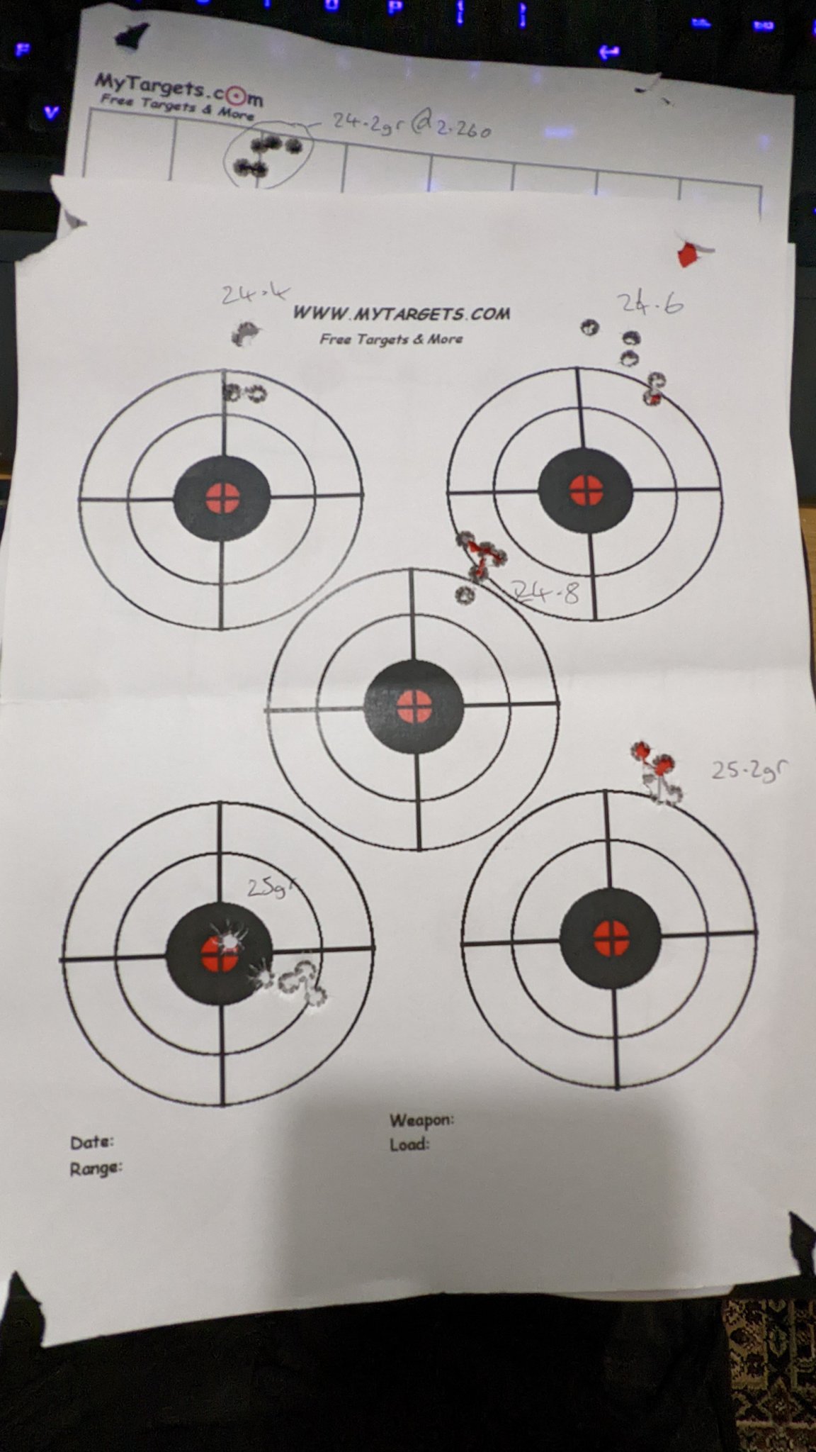

I managed to get out last Thursday to the range to try out some loads. After the chat on here and with a few friends I decided to seat all bar a few rounds to 2.260" just because so many say it seemed to work okay.
I left a few rounds as I'd set them from my last batch and then seated the rest to the 2.260 length to give a bit of a benchmark. I loaded 30 rounds to the same length and started off with 23gr N140 and went up to 25.2 in .2gr increments.
To my eye, the 25.2gr loading seems to be the best so far. When I looked at the cases, I didn't see any pressure signs so I may try 25.4gr to see if they tighten or loosen up. If they open up, I'll try working out a good seating depth next.
In summary:
Ammo:
75gr Hornady HPBT
Lapua Case
CCI 400 Primer
25.2gr Vihtavouri N140
2.260" OAL

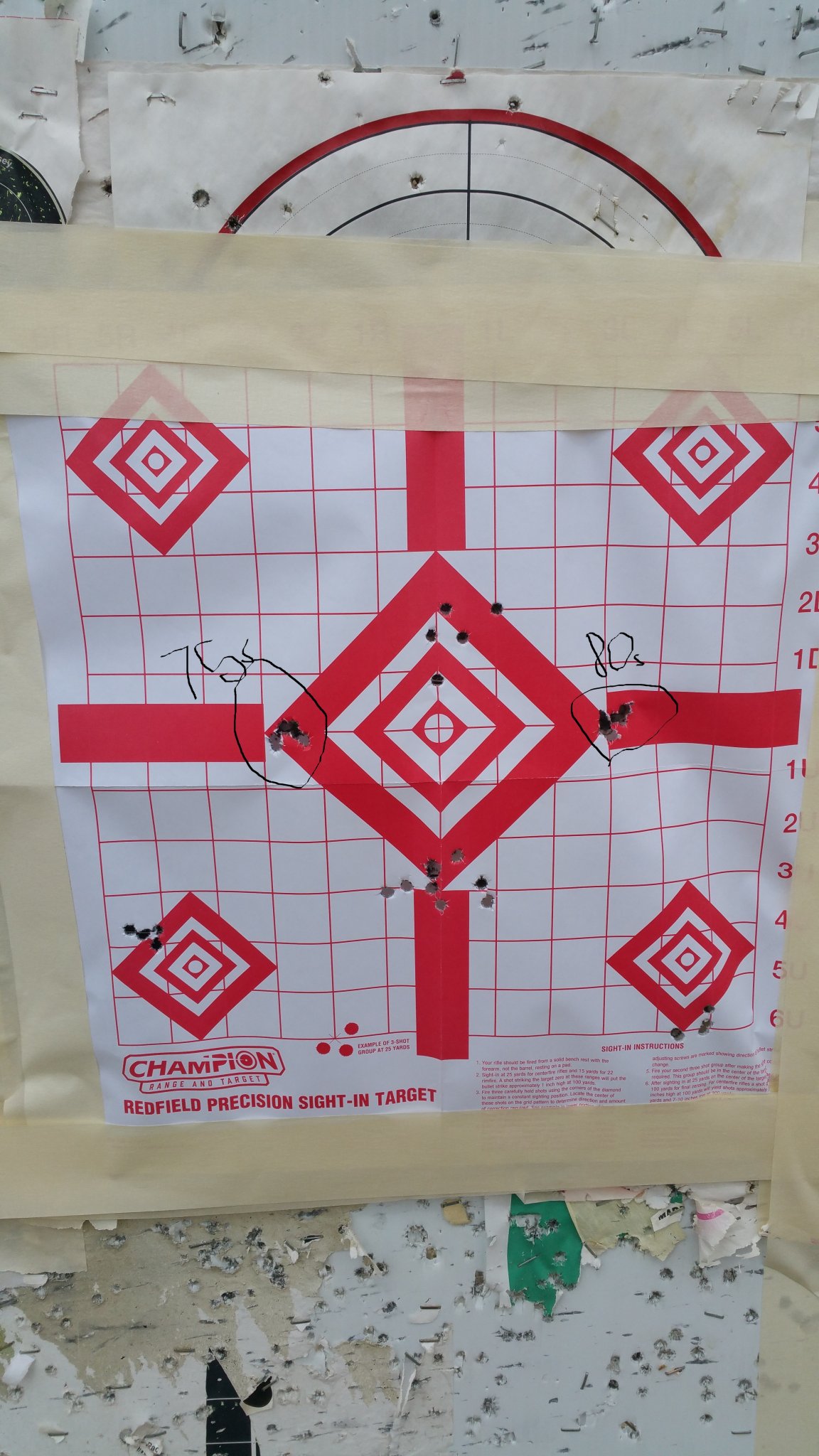

Here is what I got with N140, 75 and 80 gr ELDs. 26" 7.5 twist Bartlien.
Those are two 10 shot groups, each round increasing in powder charge by .2gr, still grouped great despite being different charges.

Anyone have opinions on 75 vs 80 eldm? I have a box of the 80s but am wondering if I'm better off with 75s. Rifle is a 24" bartlein barrel 1-7" twist wylde chamber. I want to use 8208. Of course the hornady manual has data for the 75 with 8208, but not the 80. What's a good powder range to work up a load in?
