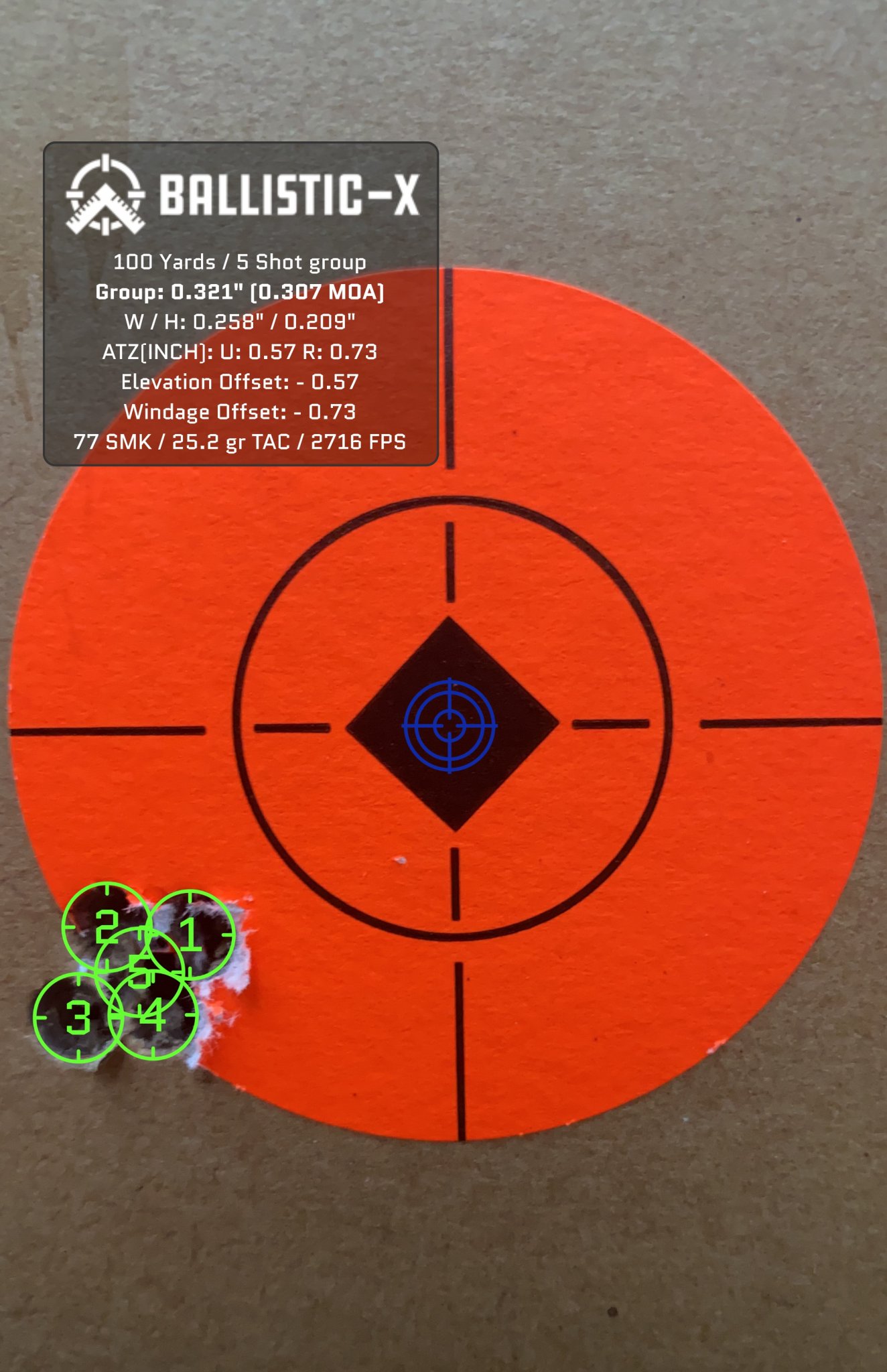

This is above book value but I run roughly 2875 FPS with 23.5 XBR, 75 ELDm on a SAC 223 22.5" barrel. 1/2 or better at 100 and gets me to 1000yards supersonic. Can't complain.
I also do 2875 with 24.8 varget and 80 SMK/80 ELD-M. The 80 SMK is way more accurate at short distance but the 80ELDm is better past 800yards.
What velocities are you guys getting with a 24" barrel shooting 75/77s? Going to buy a Tikka Varmint and want to run the more widely available bullets like the Hornady 75 bthp/eldms and Sierra 77s.
I run the 75gr EDLM in my Tikka Varmint over H4895 in Nammo brass. I get 3005-3025 fps suppressed. I have some of the 80 gr ELDM, but I haven' tried them. I am using the MDT AICS magazines and loading them 2.49" COAL. It shots everything good so far, 53gr V-Max, 65gr SGK, 69gr SMK, 77gr SMK. The coyote below took a 65gr SGK in the chest at 250 yards.

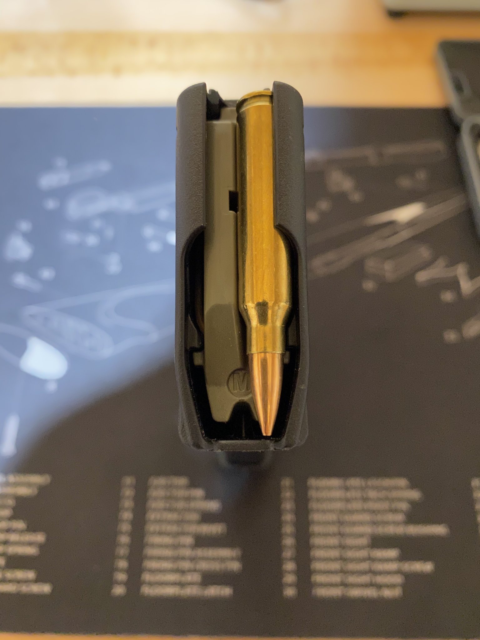

I have a Tikka T3x Varmint in 223. It's in a MDT chassis and I use their MDT AICS 223 mags with it.
I'm using the Hornady 80gr ELDM bullets. I'm getting 2770fps out if it and it's very accurate for me. I'm using N140 powder.

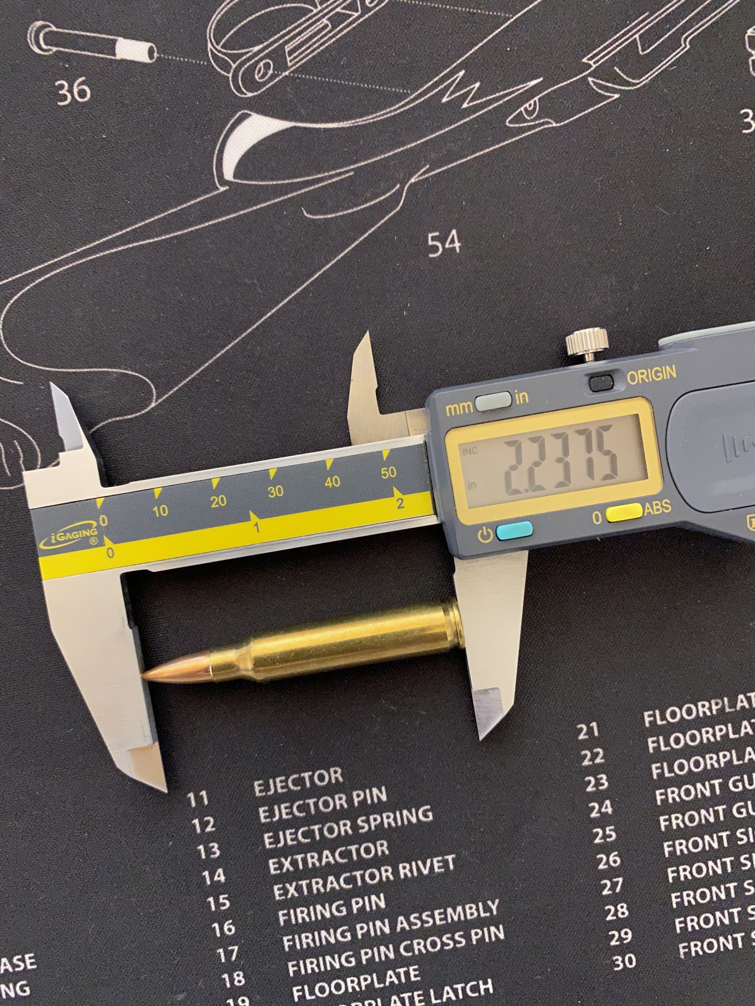

As stated earlier in this thread: I run my 223 with 88 ELDM bullets seated to 2.625 OAL and feed from modded Accurate Mag with no issues. Velocity is 2900 FPS easy with no pressure problems.
Accuracy is 1/2 MOA.

The load I eventually ended up with was 24.6 grains of 4064 loaded to magazine length, which gave me 2593 FPS (ES 31 / SD 13).
4064 meters like hot garbage, but the load itself is so tolerant, I can bang it out on a progressive and not have to worry about a few tenths swing in either direction.
I tossed a few rounds aside that either had dented cases or didn't pass the gauge. Think I might've even loaded one of them with a pistol primer by accident. Used them as foulers the other day while proofing a couple of Varget loads, and they still shot better than the ones I hand weighed and measured:

Not 100% sure, but it is hard to fault the MDT polymer .223 mag https://mdttac.com/223-mdt-polymer-aics-magazine/ which allows 2.550". I went with these mags with my Tikka Varmint .223 in the XRS chassis.
^this if going chassis with AI pattern.
waters rifleman and mountain tactical make longer coal mags for factory bottom metal. I’ve not had great luck with mountain tactical.

23.5gr xbr
77gr tmk
2.25 coal
cci 400
formidilosus on rokslide recommended it. shoots 5 less then 1" in 3 different rifles.

My 223 mdt aics mags allow up to 2.8 inches coal
David
Seriously? Without modification?
Is that the new metal mag?
The MDT web site says:
  • 2.50” max cartridge overall length (COAL)
I run Accurate Mags that will feed up to 2.650" OAL, but I have to modify them to do it. Out of the box unmodified 223 Accurate Mags are only about 2.3 or 2.4 inches.
