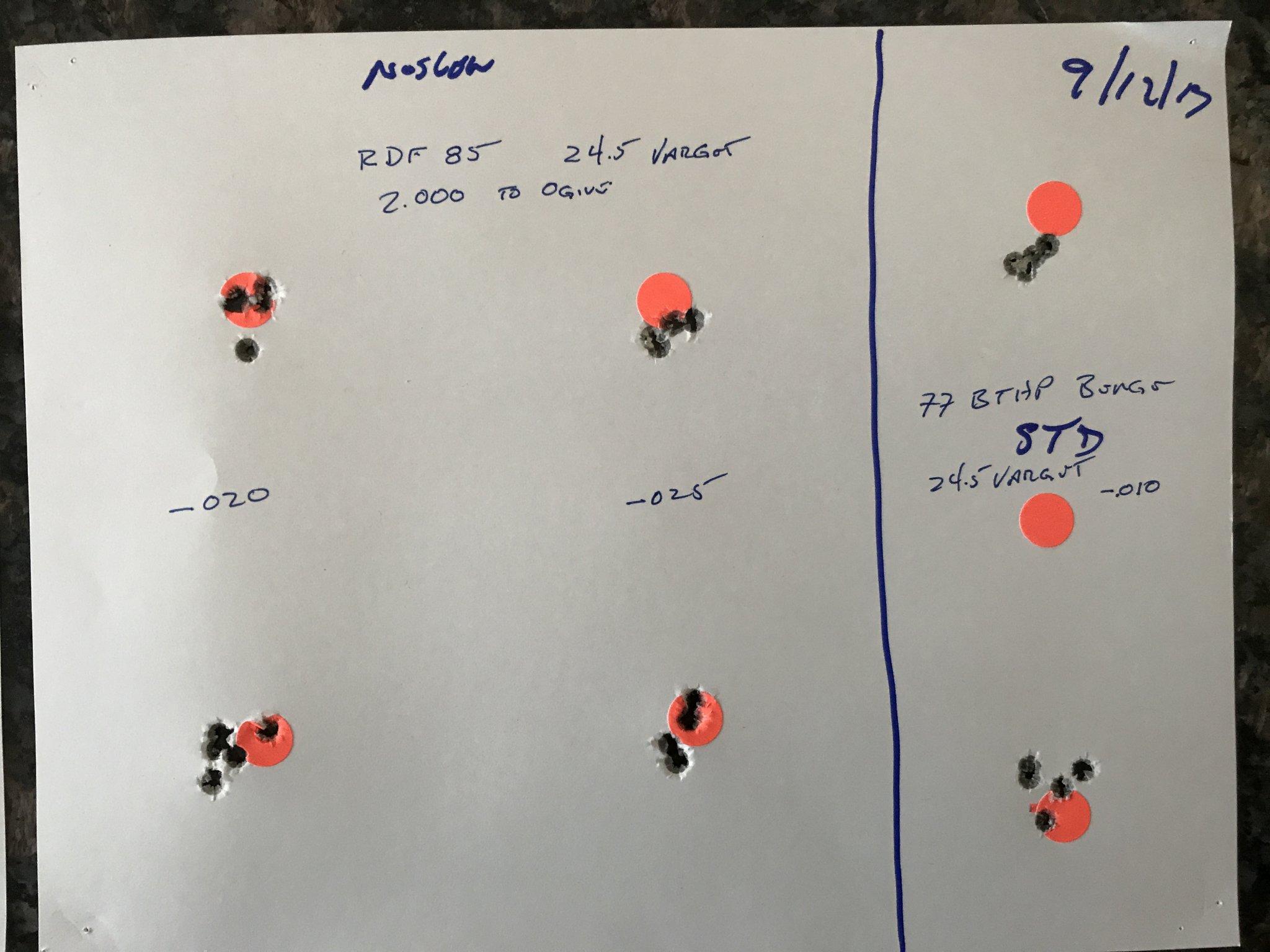

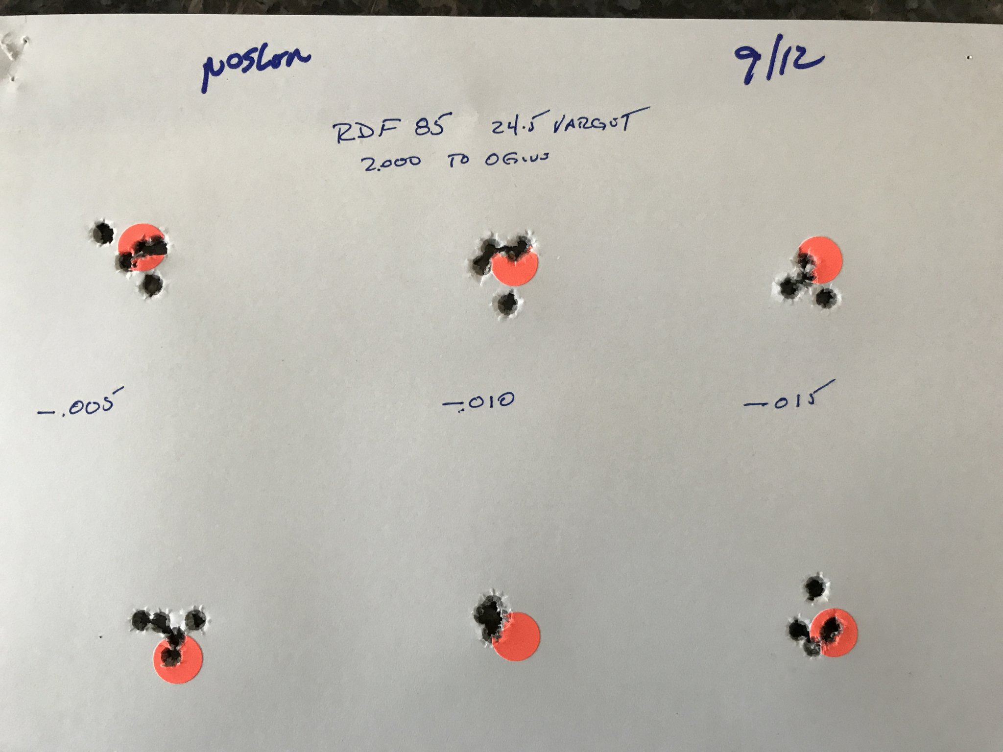

At the range and the 85RDF with 24.5 Varget is at 2881

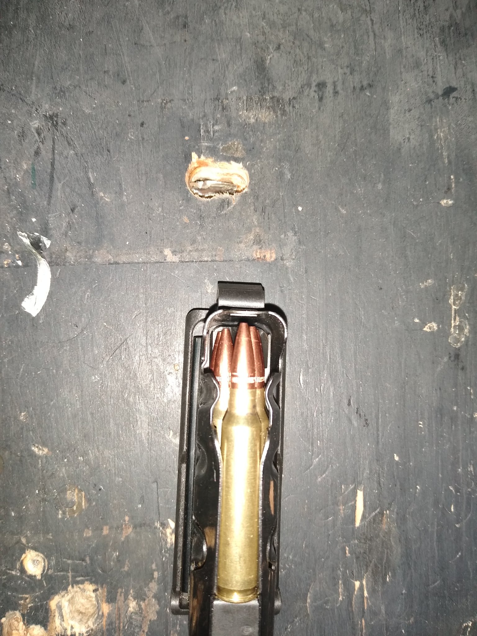

The reason I ask is because I was given a Savage model 11 in 223. The rifle is pretty accurate with the same ammo I use for my AR pistol. The magazine is stupid long for a 223 round. I bought a 223 Hornady modified case and from base to ogive was 1.960 with the 75gr bullet. If I remember correctly the mag will let me seat out to 2.455 for the cartridge.
i made some dummy rounds and they are 2.331 COAL. Here they are sitting in the mag. I'm going to be using this rifle for my son and as a trainer rifle also.

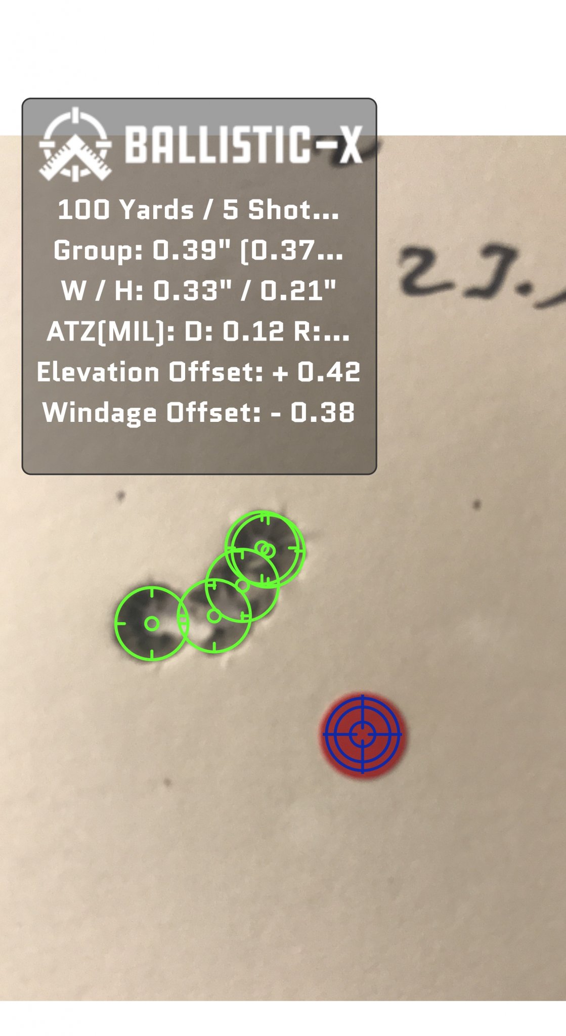

Well I tried the RDFs. View attachment 7146407View attachment 7146408 RDF 85 24.5 Varget. The bottom row was shot first a then the top. Looks like the .010 is the one I will be working with.
It's weird because I could never get the 264 RDFs to shoot out of my RPR. A lot of people have have said they love a huge jump, like .100 of a jump. I gave up trying with them. Glad to see you found a good grouping with them.

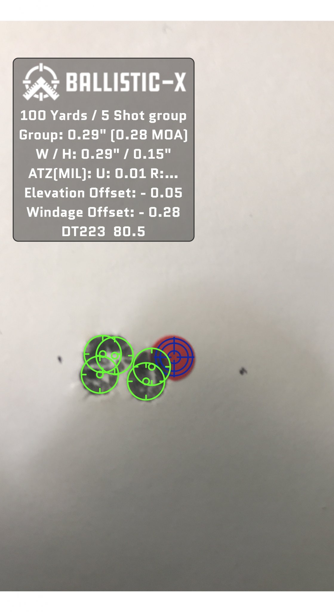

Did some load work up on a 25 inch Bartlein. Haven’t tried the 85.5’s but the 80 eld is hard to beat the BC and price

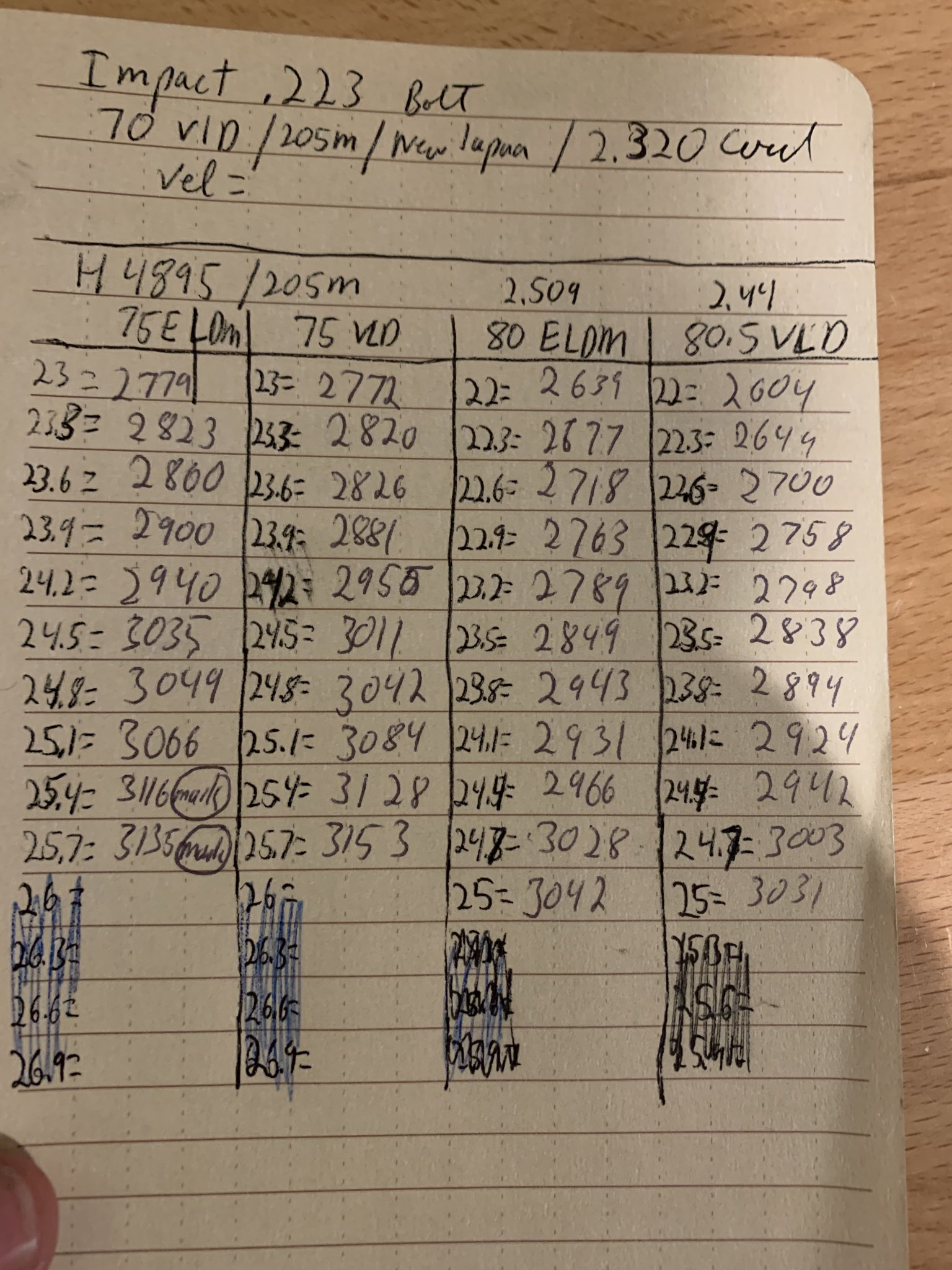

I have impact Bartlein 24” 1-7 barrel, assuming it’s just a SAAMI spec chamber.
I cannot find a consistent accuracy node, I’ve tried .020 to .050, does this round like to be AT the lands? It’s grouping at 1moa. Comparatively with 77gr BlackHills I easily get those sub .5 groups all day, and those suckers are under mag length and jumping forever.
What do you guys think?

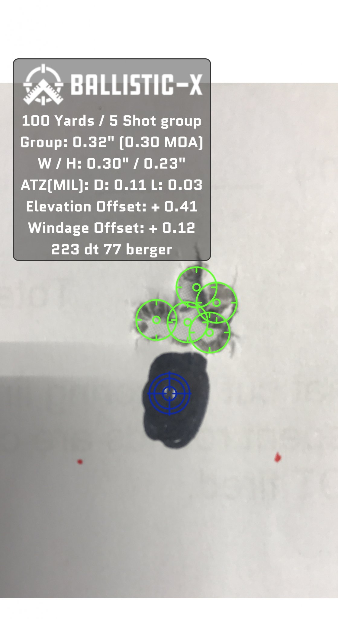

This was my initial test using a 22” .223 Wylde barrel at .030 off the lands. This was last year and haven’t tried closer to the lands yet. I was using 8208XBR.
Id pick 23.2 and try some seating depth. Thats a great little node.

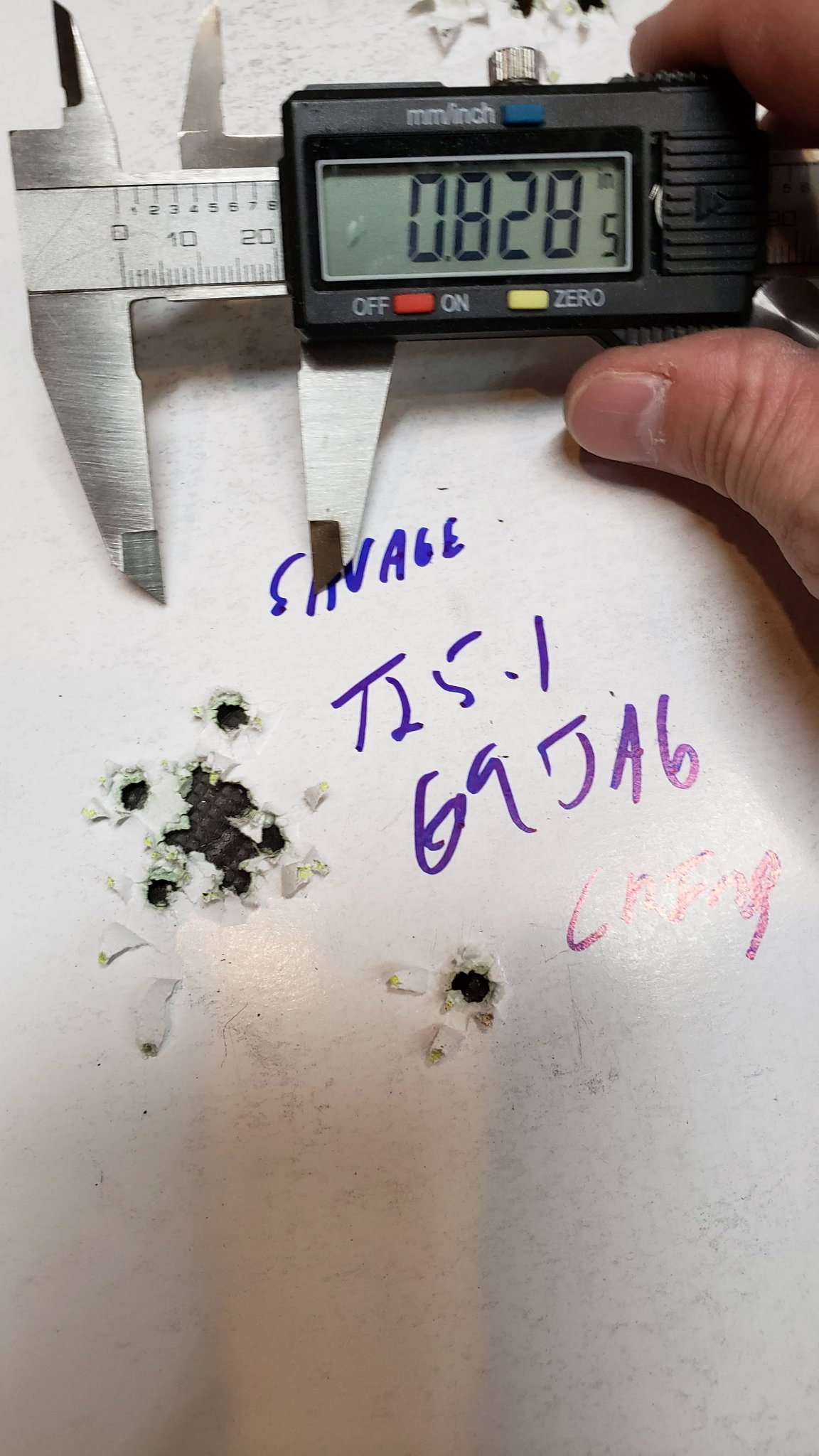

I can't find a 25.3 target but attached is one with the 25.1 load fired out of my Savage MSR15 Recon.

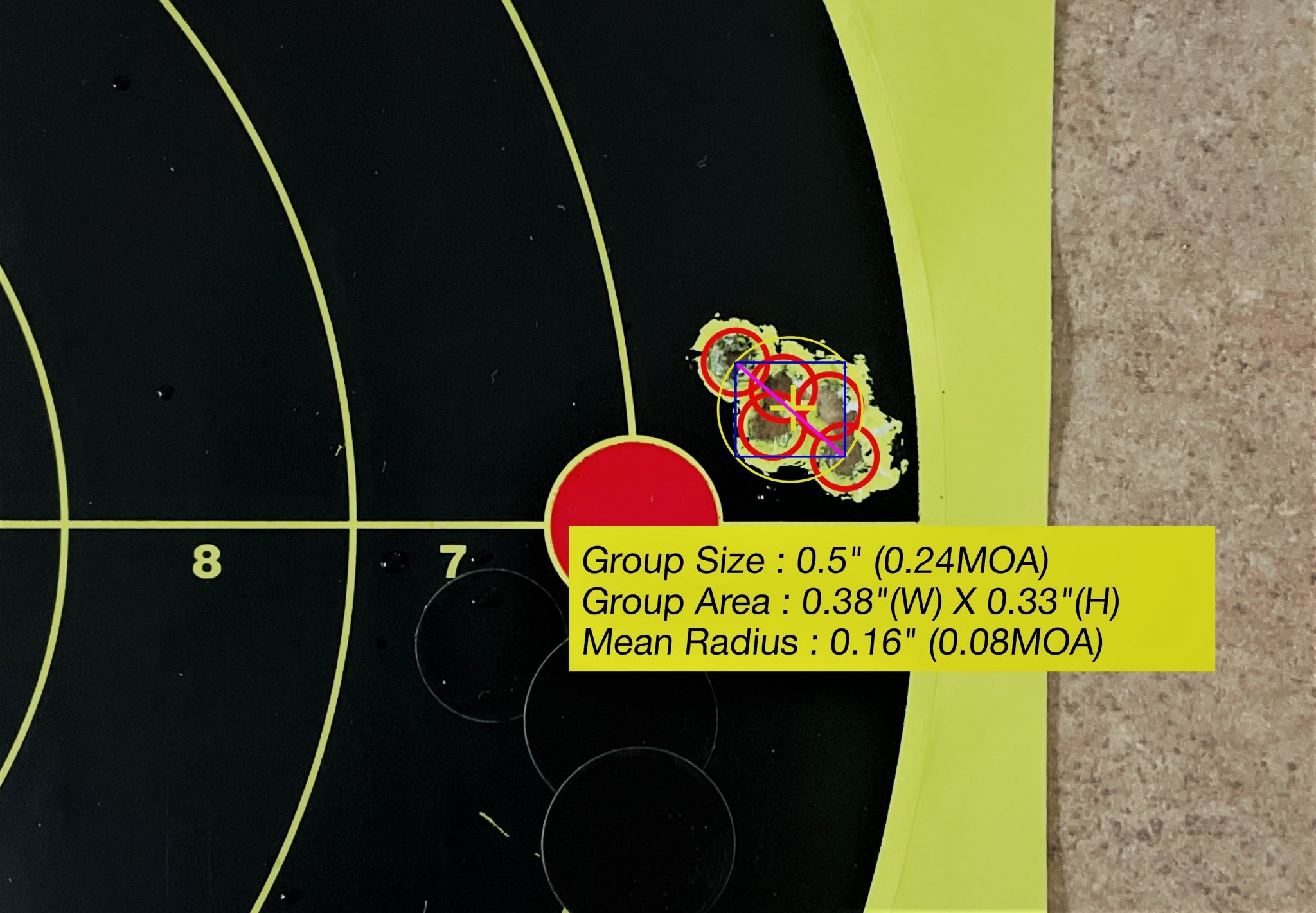

Gun: Savage Model 10 LE
20" Heavy Barrel 1:9 twist
Vortex Crossfire 6x24 50mm lens
Load:
53 grain Hornady BTHP Match
IMR 4198 21.0 grains
Lake City Brass CL 1.748
COL 2.250 +/- .02
CCI 400 SRP
200 Yard 5 Shot Group
.5" (.24 MOA)

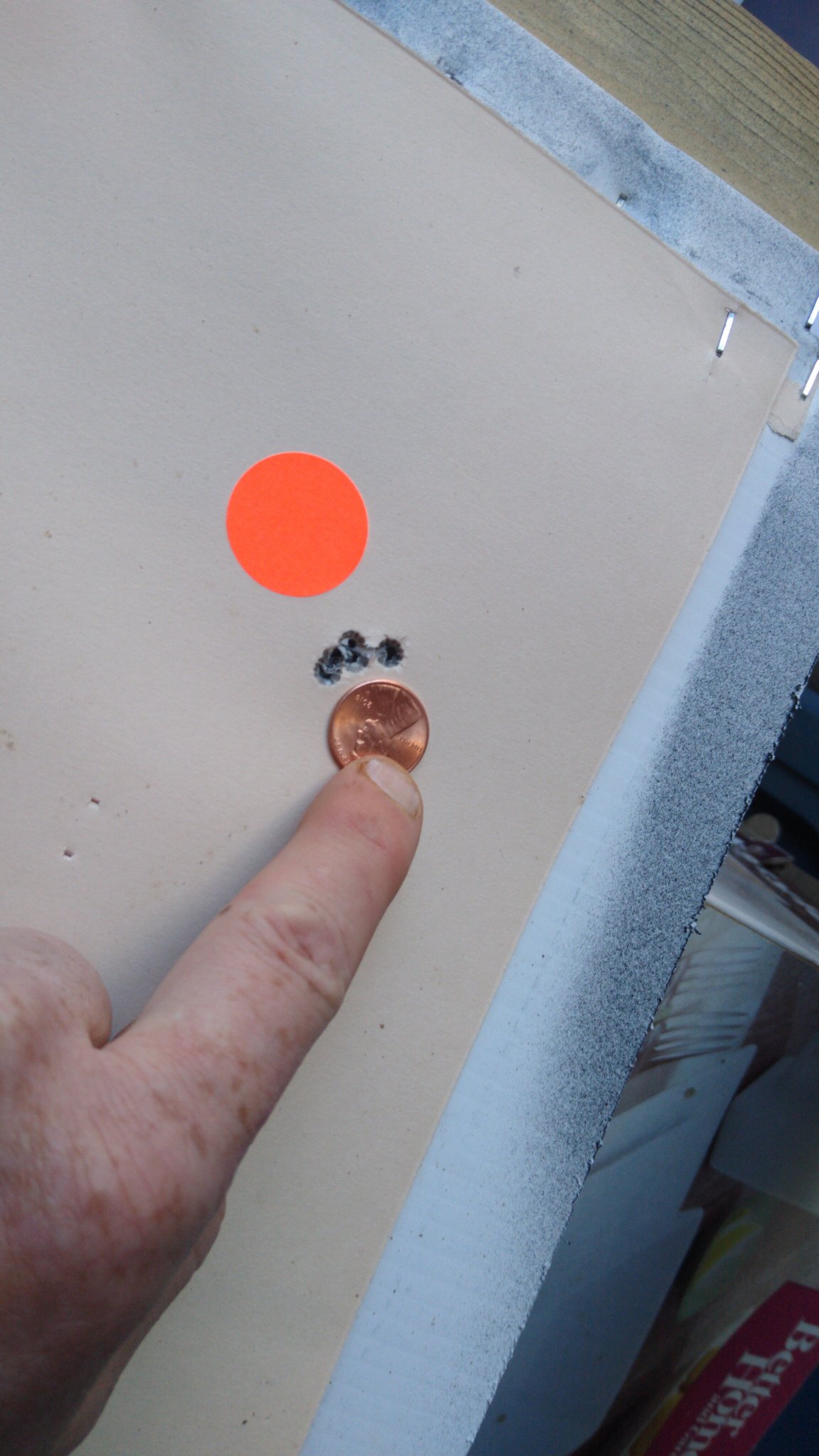

Accuracy 1/2 MOA.

Going to start working up loads with a 75ELD-M with Lapua brass in a 1/7 twist 26” barrel. I plan on doing an OCW test with a couple different powders listed below. What should my starting and stopping charge weights for each powder be?
8208: 23- 24.5 in .2gr increments?
Varget: 22.8-25
H4895: 23.5-24.8

Don't think I ever chrony'd it but it shoots sub MOA and has killed everything that Ive ever shot with it.
