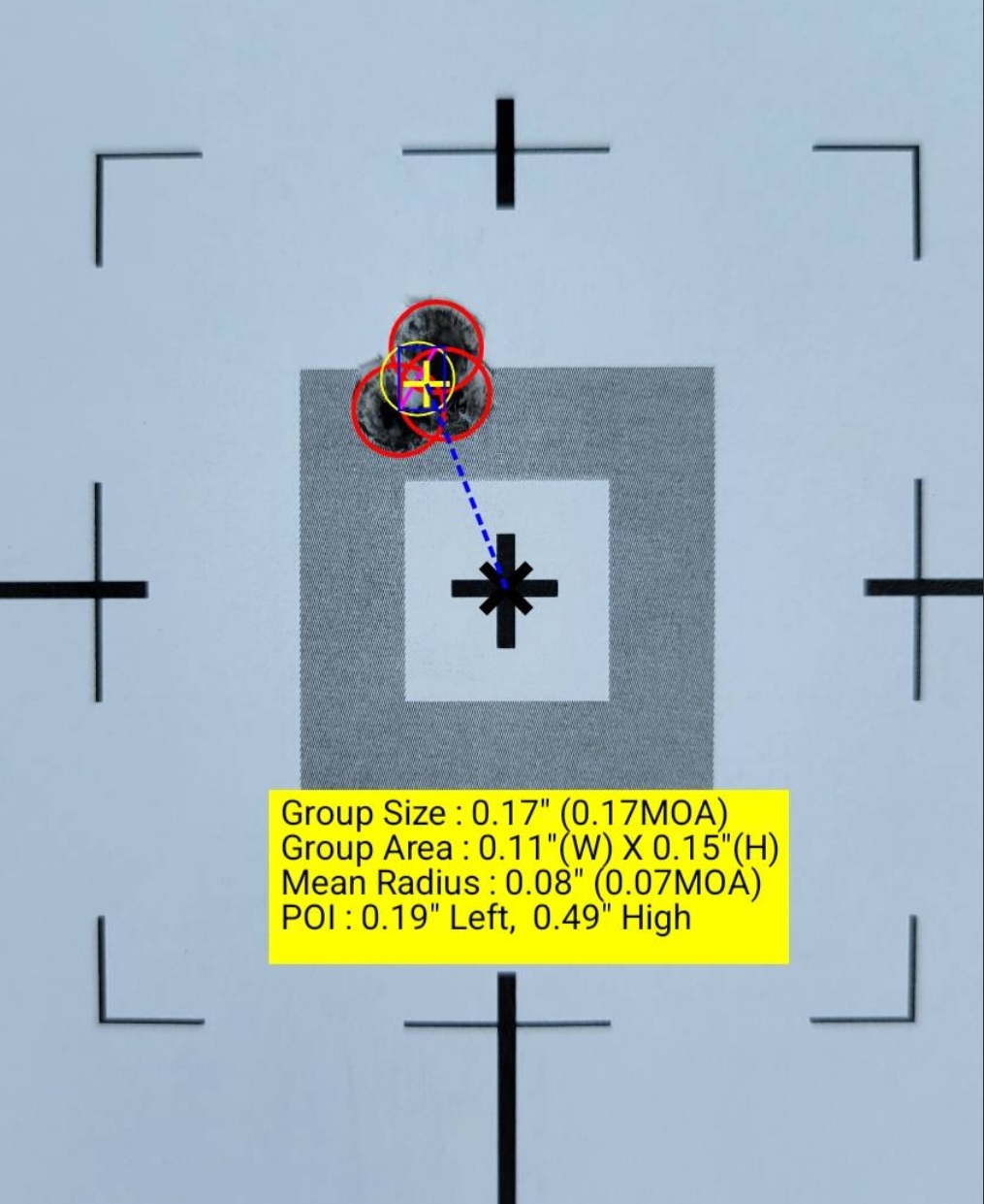

Looking at your groups, the dies you are using are not holding you back. If you were seeing the occasional flyer, I would adjust neck tension, but make sure it is the ammo and not the gun, shooter, or wind.
Wind can be a factor at any distance, but even more so when you go past 100 yards. Learning to read wind can really help you.
I do not crimp bolt gun ammo.
That's what I was thinking. I'm a mediocre shot when shooting from the type of positions used in PRS. I think this quick and dirty session shows that under most circumstances this gun/ammo combination is going to be more accurate than I am.
I'm looking forward to bumping up the powder and setting COAL correctly and seeing what it will do.

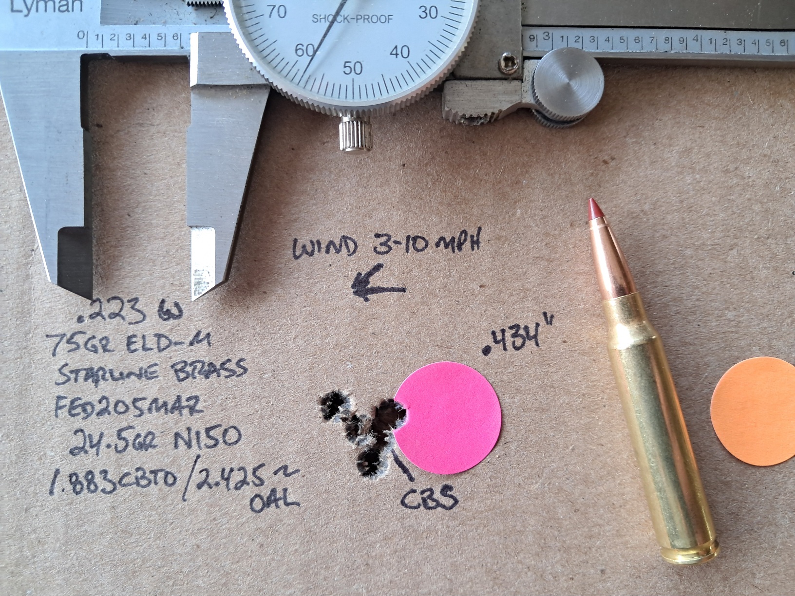

In regards to all this bushing and expander talk - I played the bushing and mandrel game for a bit and the last handful of cartridges I've
moved to just getting forster FL sizing dies honed to not overwork the necks and use the expander balls. Maybe benchrest guys can tell the difference but I cant and it's one less pass through a single stage press this way and dies are economical. Less of a deal if each is a stage on a progressive press but i'm not wasting time on it with a single stage.

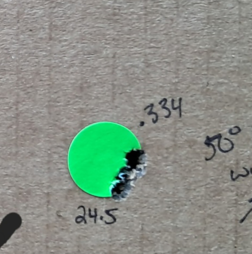

Not really a bench rest shooter but load development is done on a bench with sand bags. Cuts down on variables.

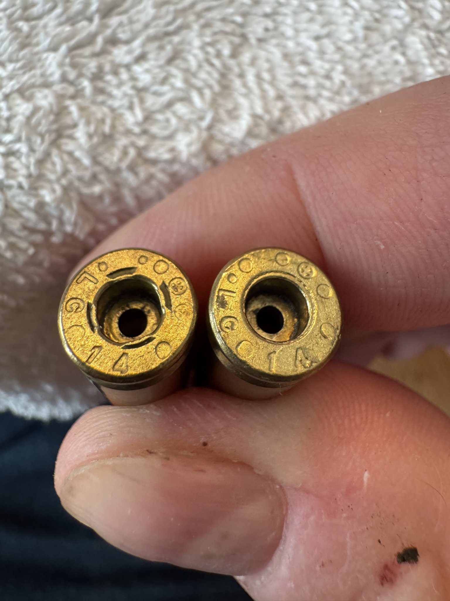

I've been sorting brass by head stamp. I've always had good luck with Lake City brass with the same head stamp.
I fulll length resize, trim to length, then weigh them. Since the resizing and trimming defines the outside dimensions, the variance in weight is caused by difference in wall thickness and by extension, volume.
However, I've noticed a strange variance among brass with the same head stamp.
One primer is crimped in using a totally different method than the other. Does anyone have any wisdom on if this is something I should care about?
Same brass, they just probably have multiple crimping machines that use different methods? Are these vastly different and made in different factories with different batches of brass?? Should I care?
Should I just suck it up and buy brass? Ha.

No don't buy brass.
I use a lot of different brass I get off a nice clean range.
Lake City brass may be made at multiple locations for the contracts. That's why I don't use it for precision rounds if I can help it.
Go to a range that has yuppies buying thier range brass.
Sort those out as the predominant brass. Use that, no one will use some of those brands because the cheap store round wont group.
There is nothing wrong with it, that brass is good to go.

Thank you. I guess its all about knowing that all the brass in a batch is as consistent as possible.
As long as it's matching headstamp LC it shoots excellent and as good as lapua in my bolt guns... mixed headstamp is a different story.. I'll group in 100pc batchs by headstamp for precision AR ammo.. LC 09, LC 12, LC 14, LC 07, ETC
