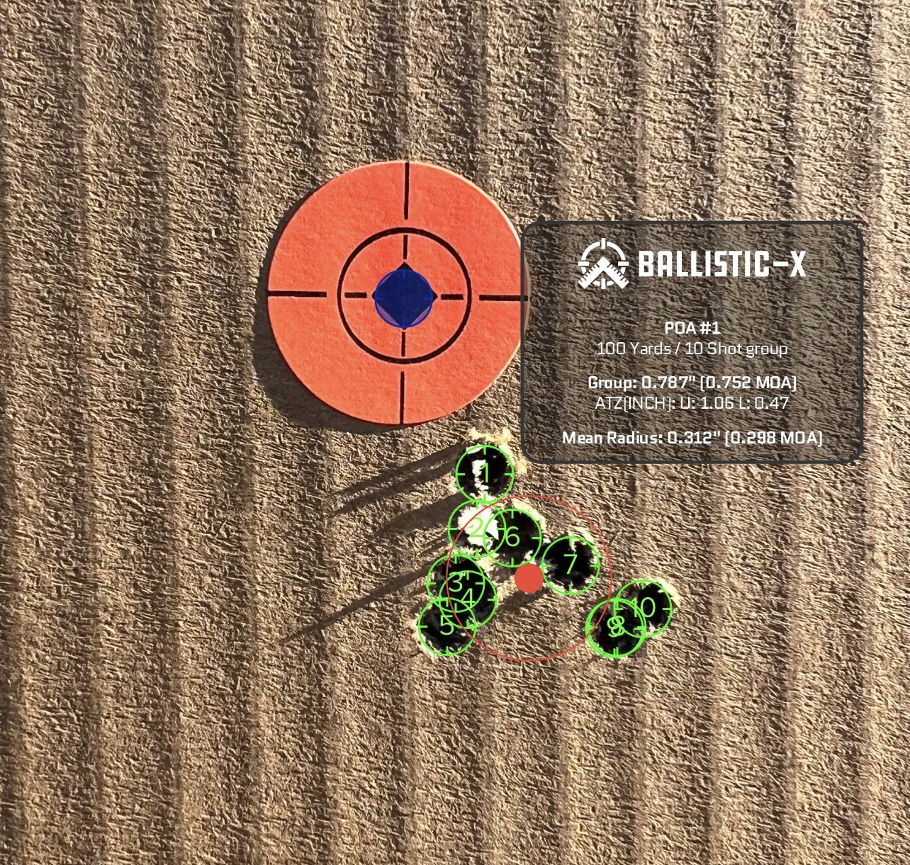

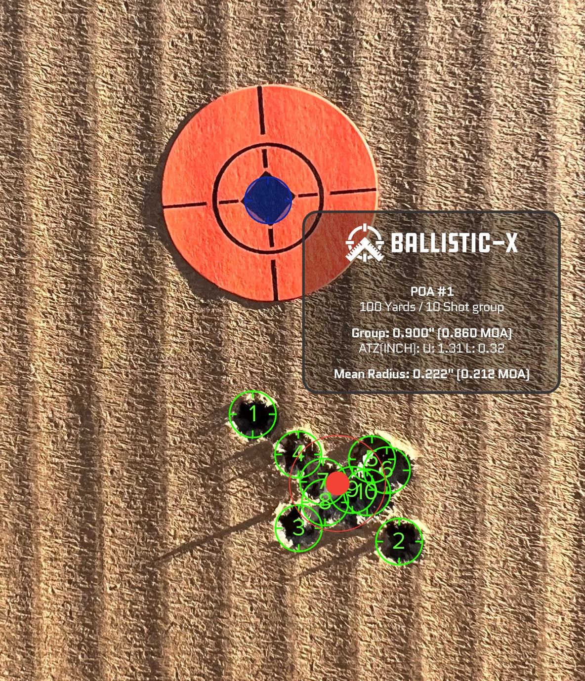

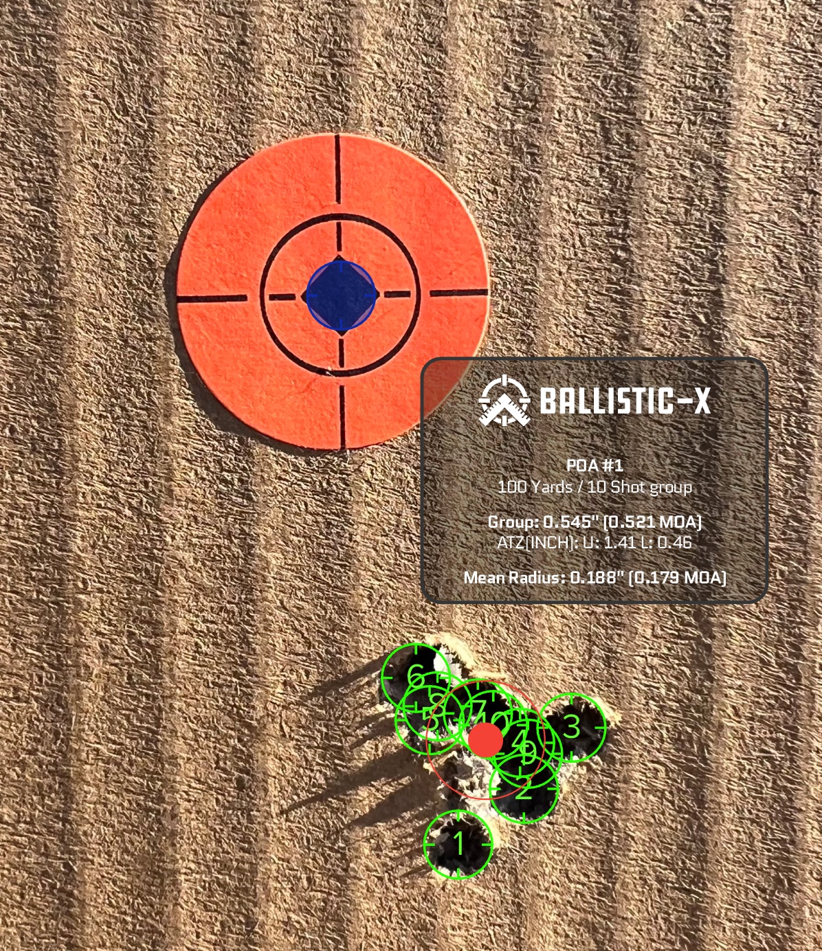

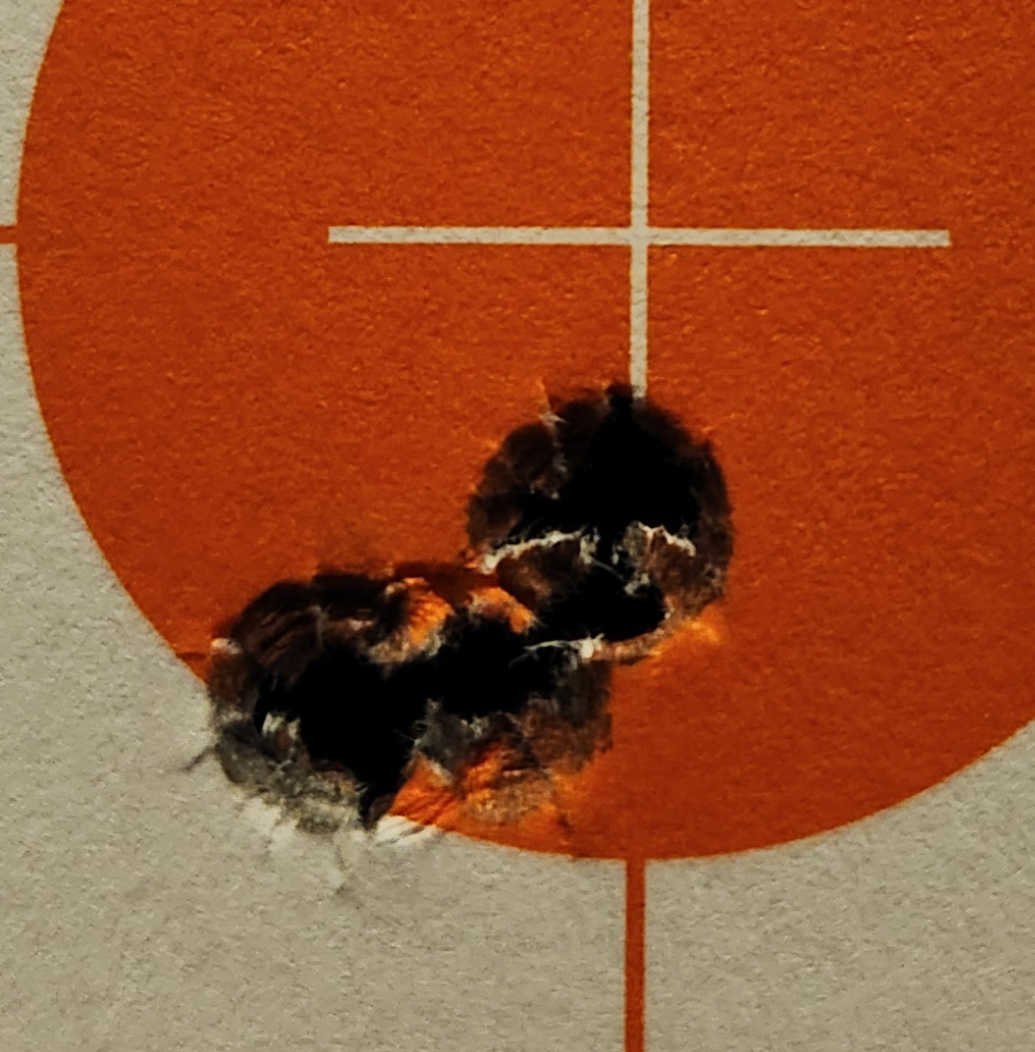

I finally got to do some load development with fire-formed Lake City Brass, N140 powder and Berger 80.5 gr. FB bullets. I did a ladder of 3 shots each for 10 powder charges increasing by 0.3 grains each. I'm super pleased with the results on targets. The largest 3-shot group was 0.6 MOA, but most were 0.3-0.4 MOA. See below for some of the highlights, and yes, each picture is 3 bullets. I got up to 0.5 gr and 75 fps over what VV lists for standard 223 Rem with this bullet and powder with zero pressure sign so far. Unfortunately, my chrono kinda puked when I got home and I may have lost all my speed data. Fingers crossed I can retrieve that. And FWIW, my ARC CDG ran perfectly, albeit for only 30 rounds.

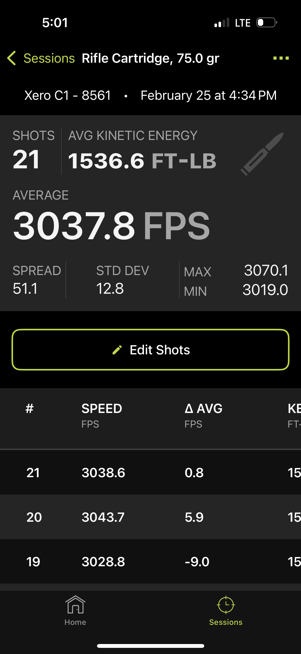

I was 2540 fps up to 2820 fps with pretty conservative loads and zero pressure signs. Ultimately, I don't put a whole lot of weight into these preliminary loadings. I was mostly looking to find max pressure and speed (not yet achieved). Group size, ES, SD, were fun to look at and share/brag with friends, but these will need a lot more data to become meaningful.

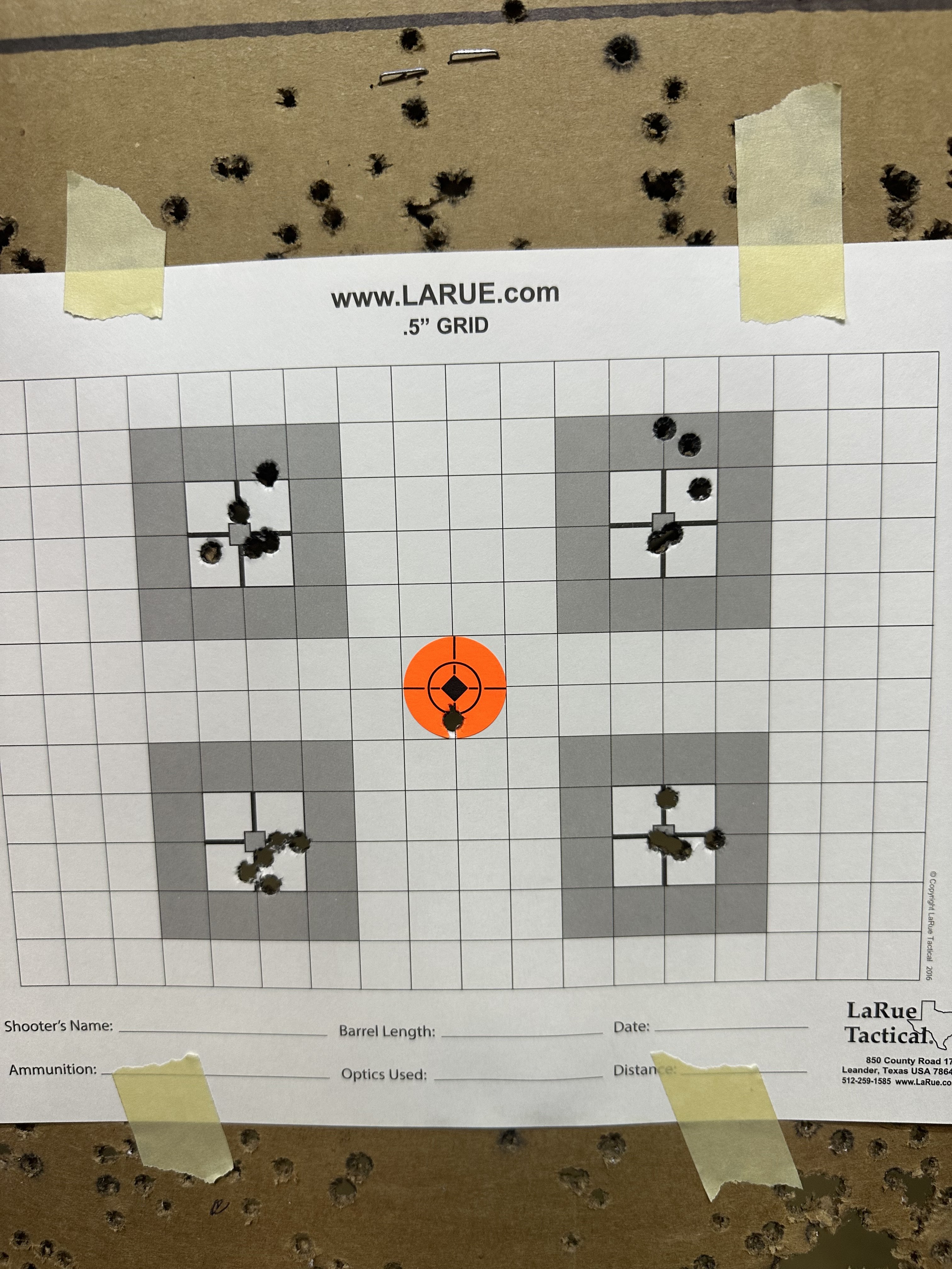

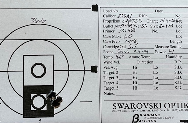

Did some more fire forming today. Load consisted of new HSM brass, Federal 205 primers, Hornady 55gr VMax, and a mild charge of H335 at 22.5gr. ES/SD’s were trash but the groups speak for themselves. All 50rds were fired consecutively within about 20 minutes.

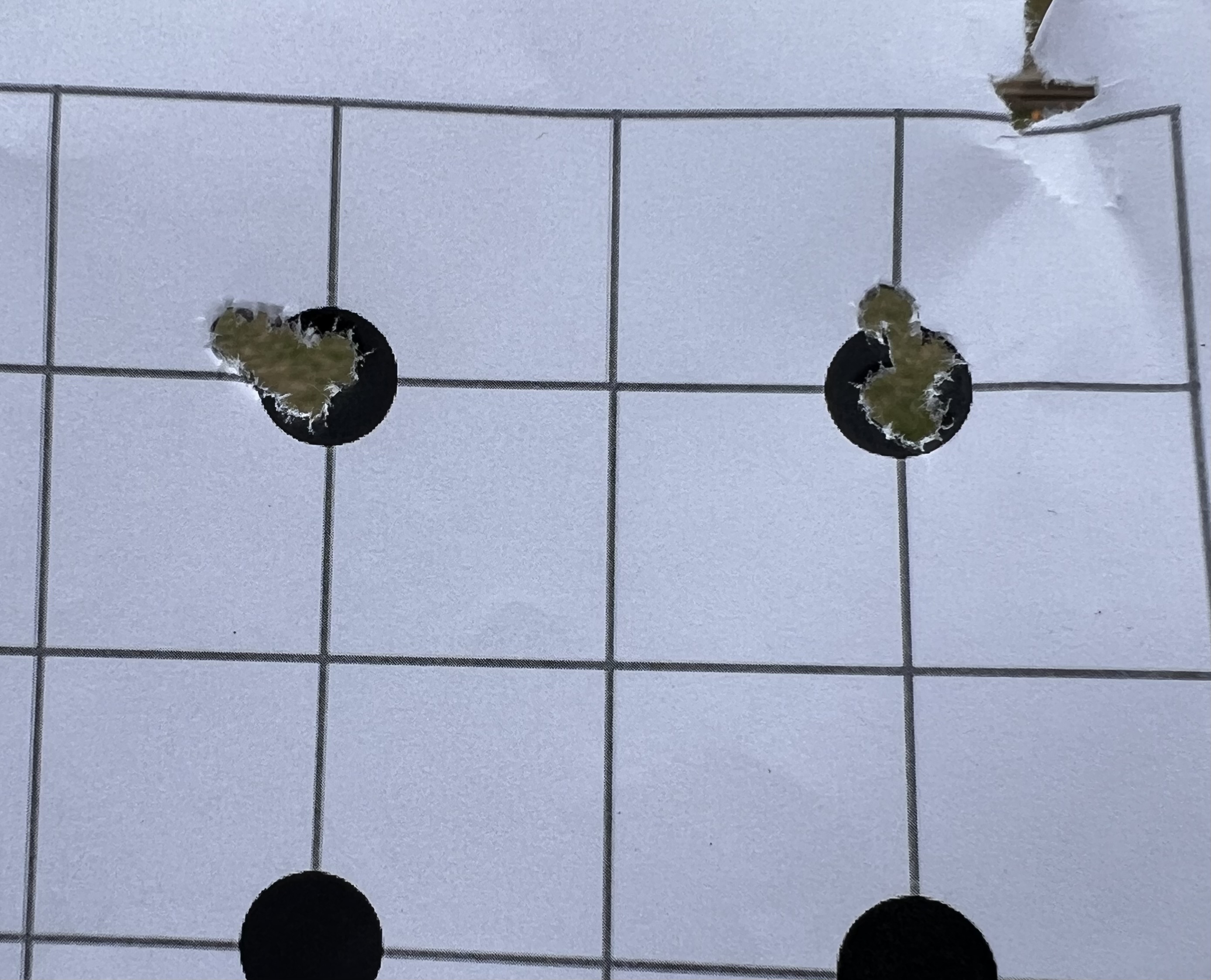

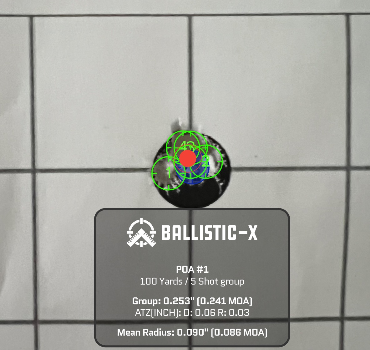

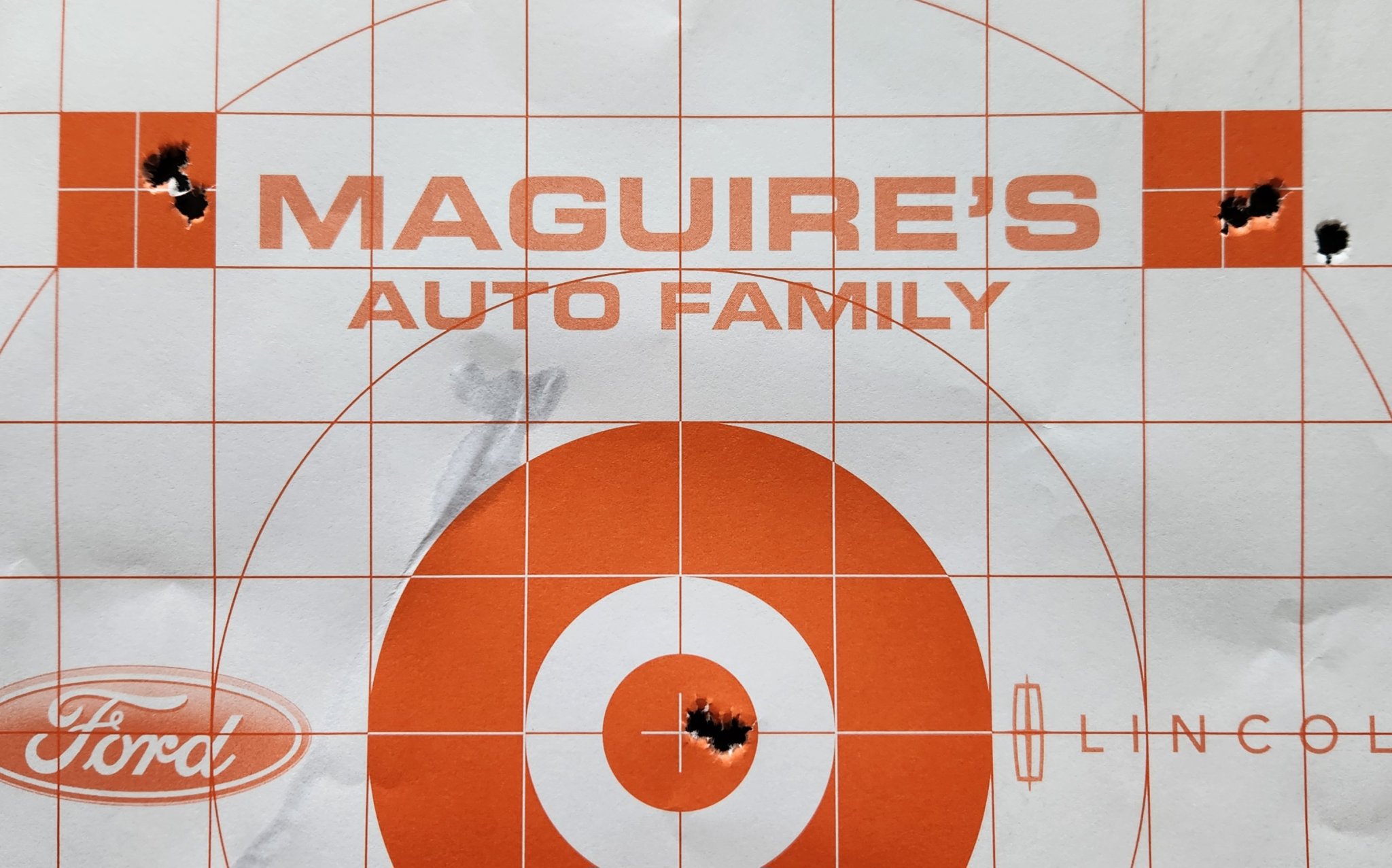

Picked up my PVA barrel the other day and worked on break in / fireforming brass this weekend. I've mostly been using handloaed Lake City brass with cheapo 62 gr FMJ which don't group for sh*t. But, here's 5 shots in .335" @100 yd with factory ELD-M. I can't wait to get enough brass formed to work up a real Ackley load with quality match bullets. Any suggestions for bullets to try?

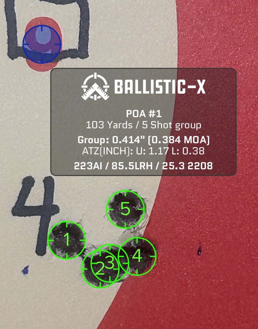

Lake City Brass, Federal 205 primer, Berger 85.5 gr LRHT, 24.5 gr VV N140, 2788 fps. It was only 30*F today and primers were starting to show a little flattening, so I would NOT recommend this load. I'll start backing down the powder looking for a lower node now.

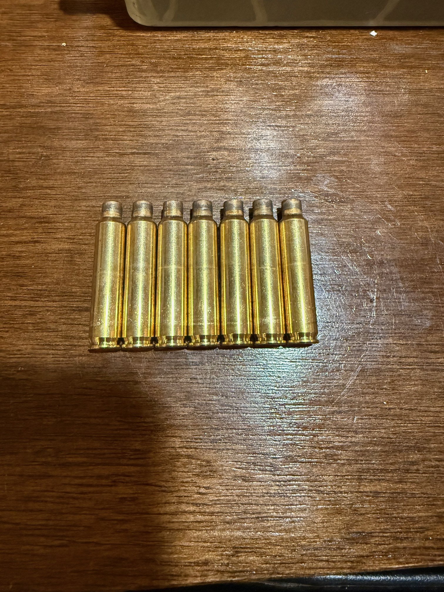

Fireforming Load:
Recently I decided to fireform some additional brass for a couple of .223 Ackley Improved rifles that I own. I ended up with the following:
TZZ once fired processed brass/Lapua New Brass, and Starline 5.56 new brass. <different brass for each firearm>
In the TZZ brass, I used RP 7.5 primers, Lapua and Starline CCI 400's.
26. 0 Benchmark
53 grain Hornady Vmax.
In the 7 & 8 twist, COL was 2.41, shorter COL in the 12 twist because of a short throat, but all shot well on paper and steel. ~.75 MOA
Velocity is in the neighborhood of 3200 fps, but varies a bit depending on which rifle I am shooting them in because of barrel length.
What I found extremely interesting and fortunate, was that this fireform load, in three different rifles, was very close (within .1mil approximately), out to 500 yards> of the 75/80/ and 80.5 grain Ackley Improved loads. Perhaps its the high BC of the 53 grain Vmax, but it's nice to be able to use these without having to have a new dope card. Past 500 more elevation has to be dialed in.
While I didn't pierce any primers, the 400's were VERY flattened (excessive) in the Lapua Brass, probably will have a muffin top when I punch them out to reload. The fired Starline brass looked okay, and no issues with the military TZZ brass. Cases were well formed, no rounded shoulders. I also loaded a few LC cases with the brass colored Ginex SR primers, and they were excessively flattened, leading me to believe that they have soft cups like the CCI 400's. I would not recommend either of these... unless the fireform loads are reduced which will probably result in rounded shoulders on the fireformed brass.

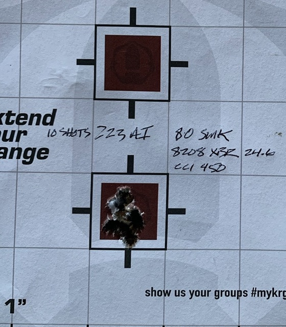

26" 1/7 barty.
Was between 2800-2900. The 24.1 h4895 was mid level pressure and 25.3 and over n140 was hot.
Lapua brass held up to the pressure, but I blew primers with LC quite often when I got over 25.6 of n140.
25.2 n140 with 90smks held 6-7 SD and I had minimal issues spotting impacts to 950 or so
XBR 8208 and varget are also excellent choices. XBR got me the most velocity with pretty good accuracy.
