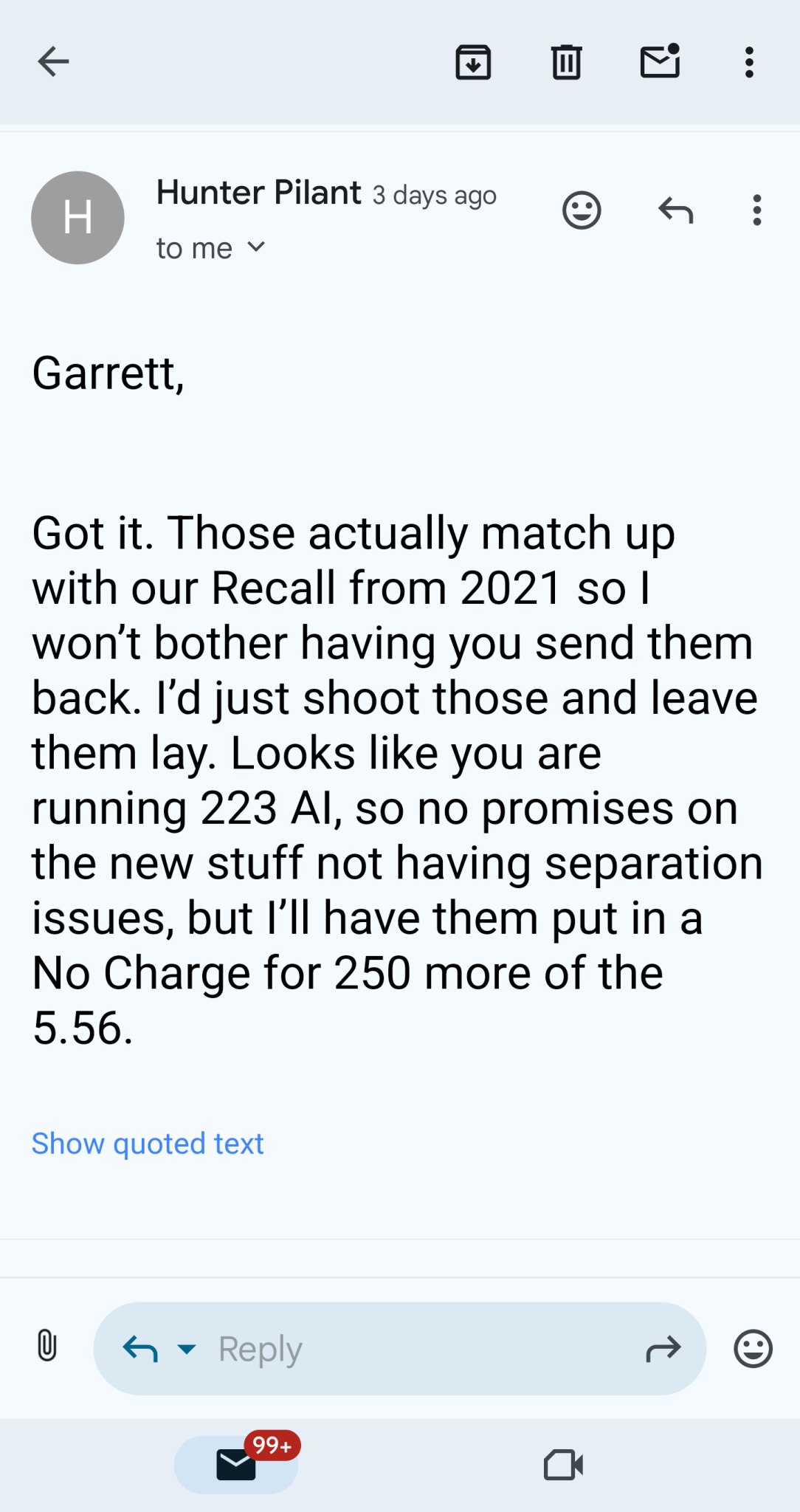

Starline support is working with me thus far. I will keep updated
What’s the word from Starline so far? I don’t have the vertical fractures that you have, but that case separation midway up the body is exactly what I’m getting with 69SMKs through 88ELDMs using CFE. I’ve tried adjusting charge weights up and down during fireforming, and every time I get what I’ve started calling a “speed bump” right where the case eventually separates. I’m really interested in what they have to say.
My brass is 2 different lots of Starline that were bought within the last year or so.

Sounds like they had a known bad batch of brass (from 2021), so would've hoped they replaced it.
This is the only brass issue I've heard of from Starline, so hopefully it was a one off as I'm going to try get starline brass for my 223AI (if the barrel ever turns up....).

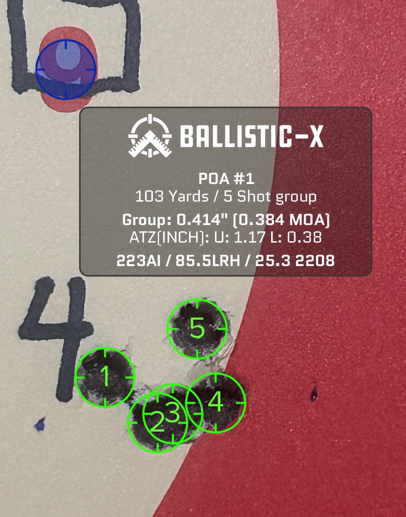

Out of curiosity, has anyone played/experimented with or found a decent load using the Berger 85.5gn LR Hybrids in 223AI?
There is a decent availability of them local to me and was hoping there may be some experience in terms of starting loads or even optimal loads.
I think the 80 Berger’s would be a better fit but I know some people run the 88 eld’s. I’m sure you could make them work.

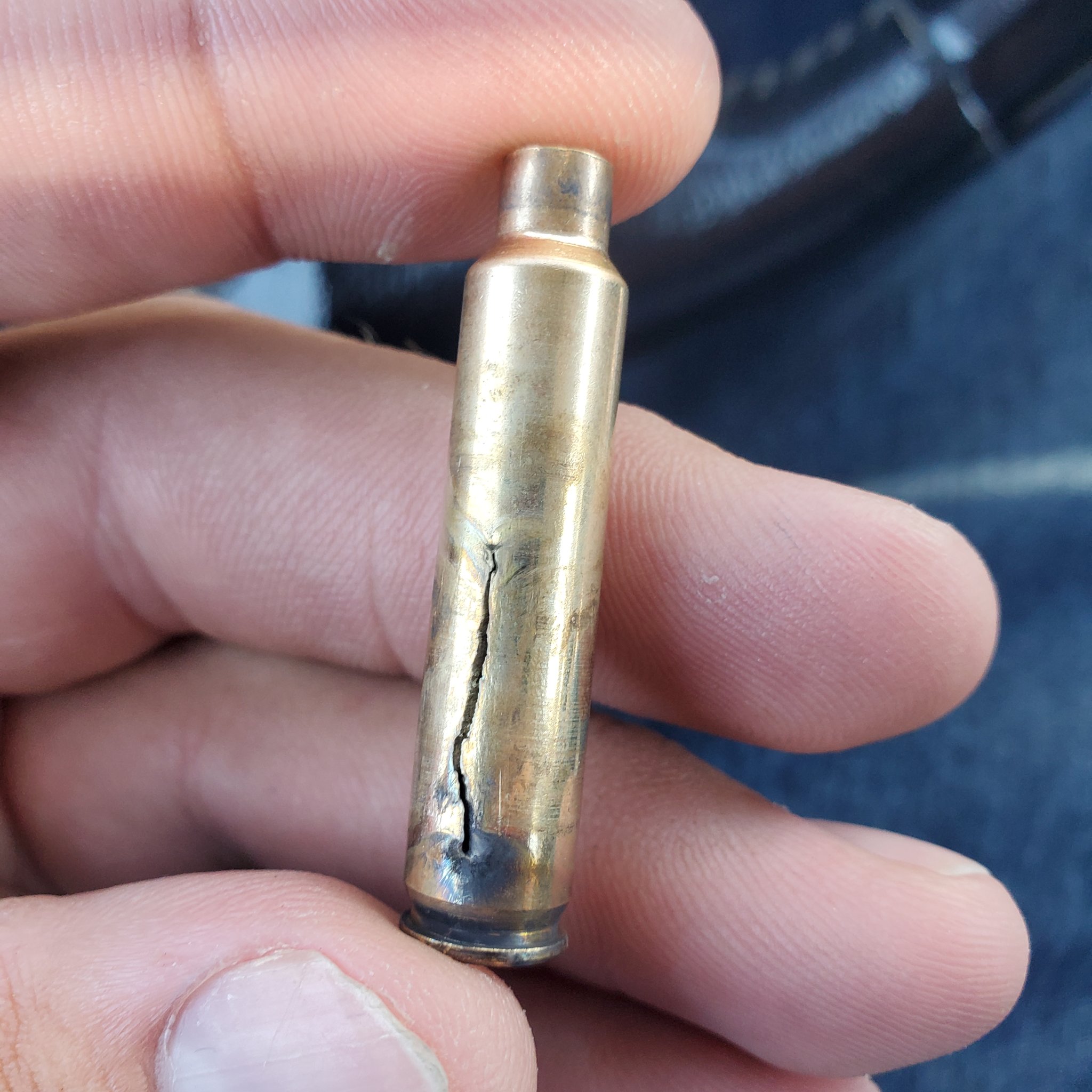

Got the replacements. So far one of the twenty I have fired split in the same way as before. Gonna contact starline again for recommendations.

Have you tried other brands of brass? Is it possible your chamber is oversized? I have run hundreds of starline brass forming into 223ai without issues.
This is their 5.56 brass. They say they change the metallurgy of the bottom half as compared to their 223rem brass.
Yes I have tried Lapua, Federal, PPU. All with same or greater loads. No issues.

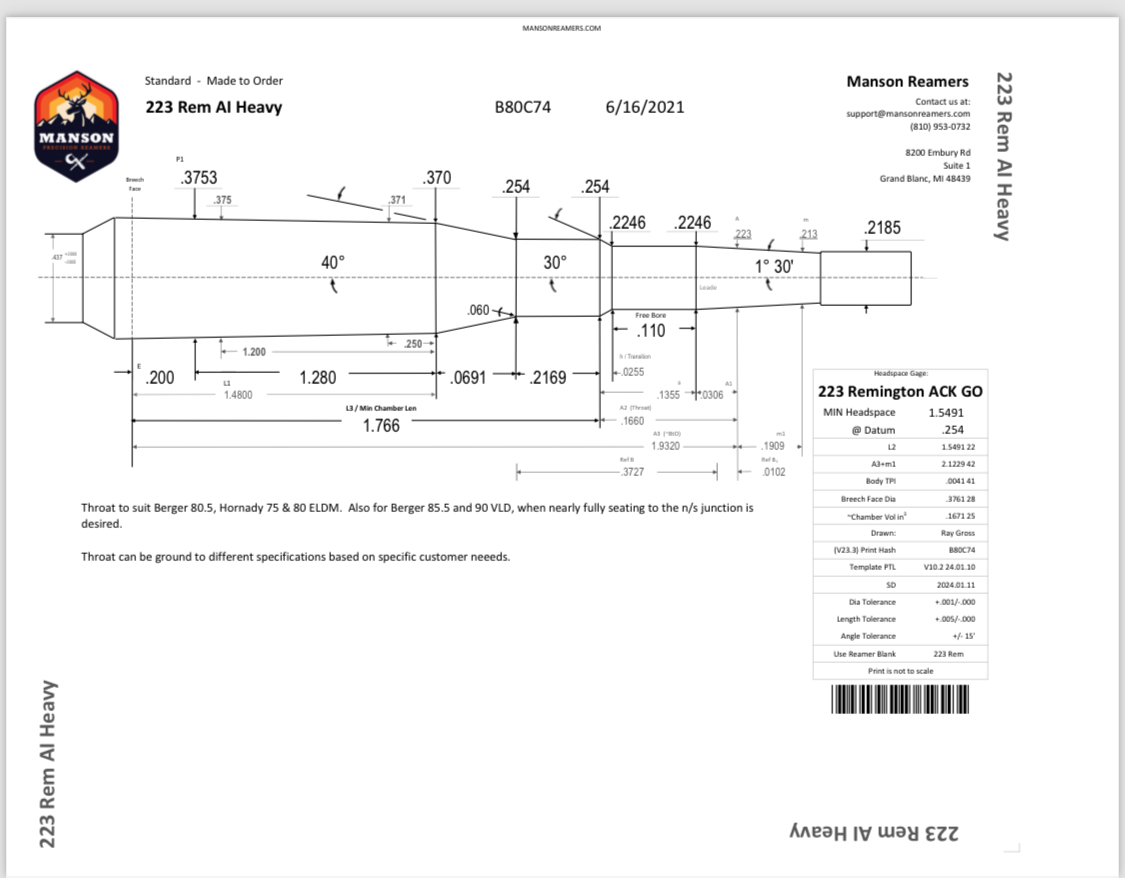

Did you mail in a dummy round? Chatted up pva on the phone - they said their Ackley reamer has the .062 freebore but they can hand reem to whatever.
Nice groups!
I’ve got a uni-throater in 223 and 6mm. I cut to fit my needs.
I recommend having them hand throat it. Measure your magazines, figure out your desired OAL. Measure your ogive at that desired OAL, and that will give you a rough idea of what your freebore should be to support your desired ogive distance.
I have had good experience with the 80gr ELD-M projectile set at a COAL of 2.45”. Rifle has a 26” 1-7tw Preferred Barrel Blanks barrel.

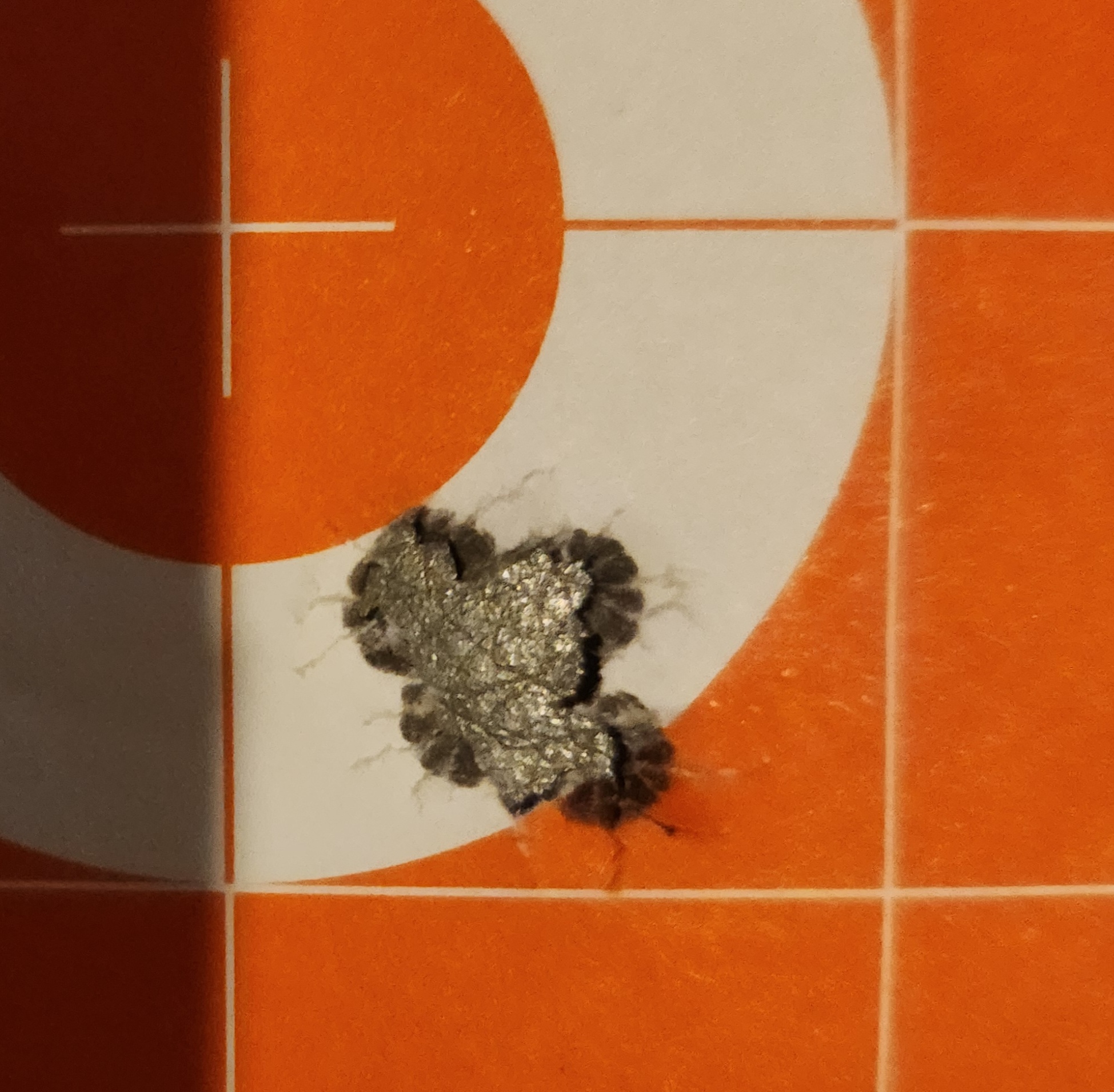

Picked up my PVA barrel the other day and worked on break in / fireforming brass this weekend. I've mostly been using handloaed Lake City brass with cheapo 62 gr FMJ which don't group for sh*t. But, here's 5 shots in .335" @100 yd with factory ELD-M. I can't wait to get enough brass formed to work up a real Ackley load with quality match bullets. Any suggestions for bullets to try?

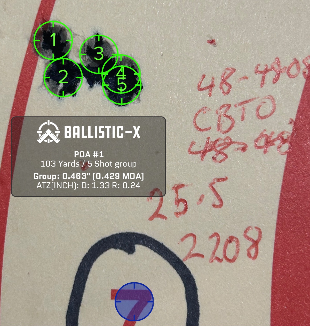

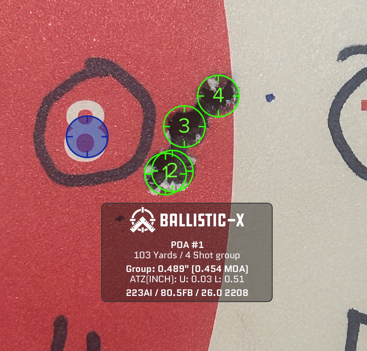

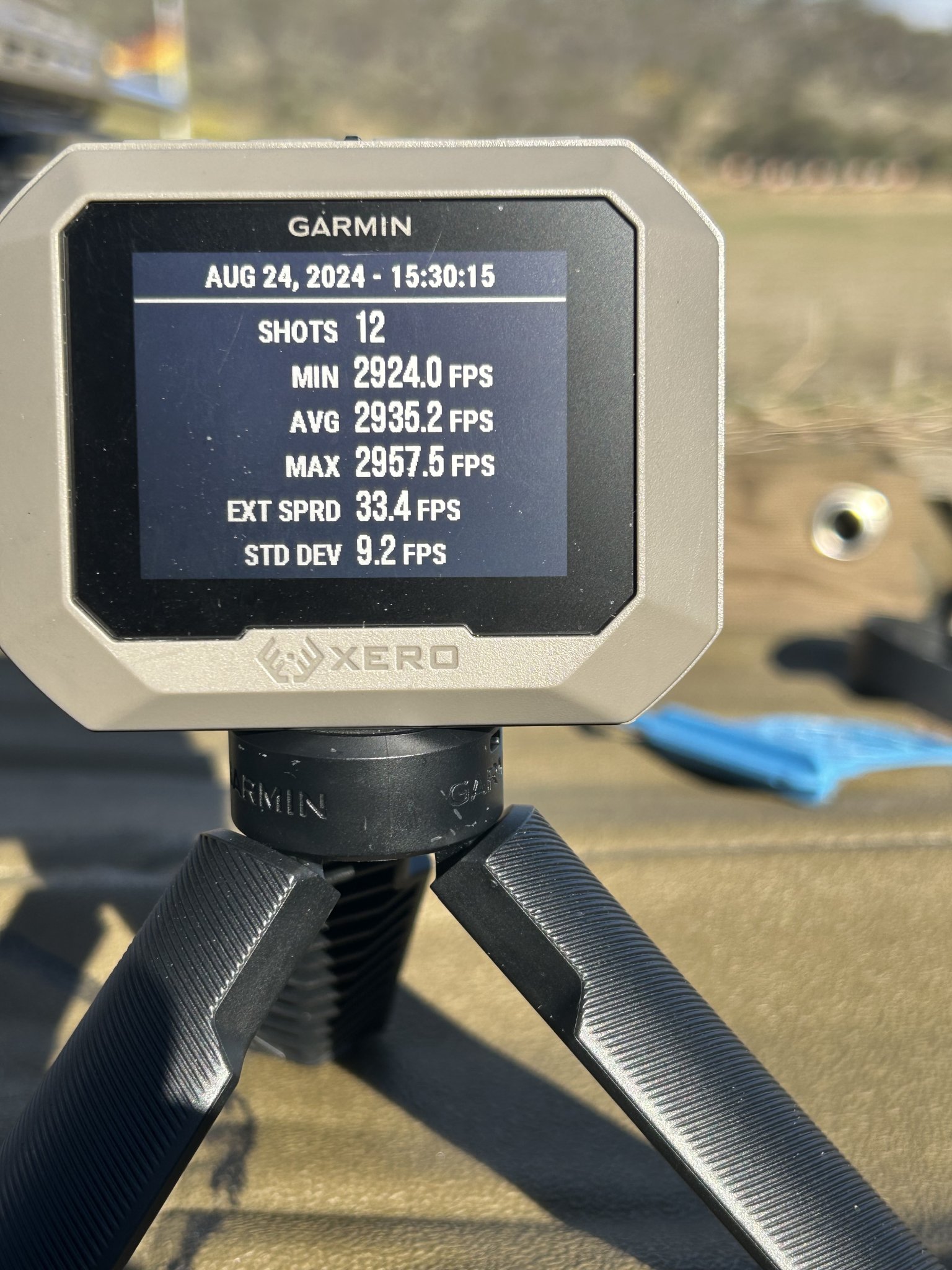

I’m getting excellent results with Berger 80.5gn FB and 26gn of Varget out of a 26” 1:7 twist barrel 2935fps
  • image_cropper_12CF149F-9AFD-4AC6-BB2B-3146157AEF47-12059-00000DA68285DDD0.jpeg

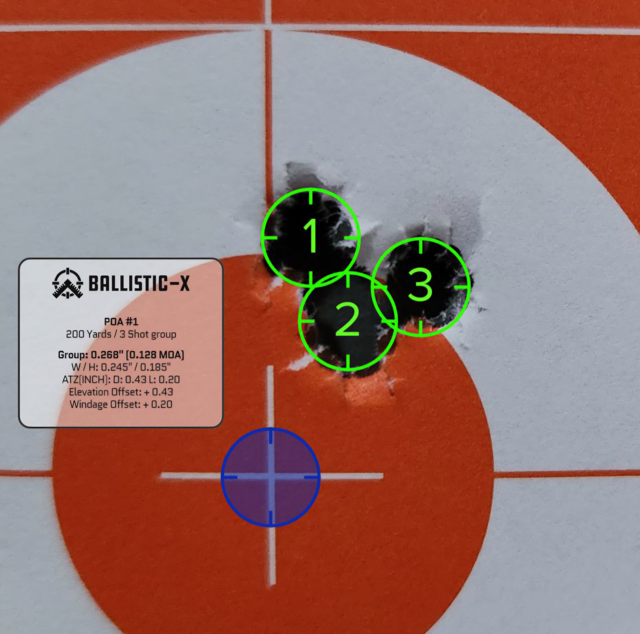

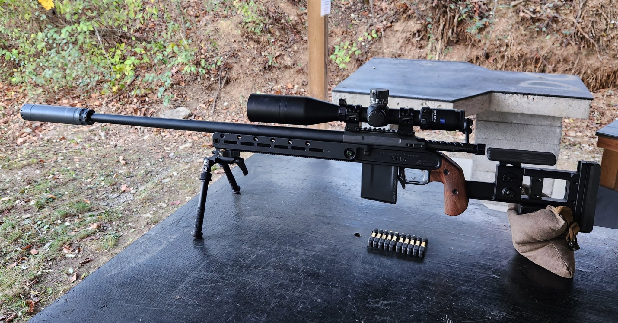

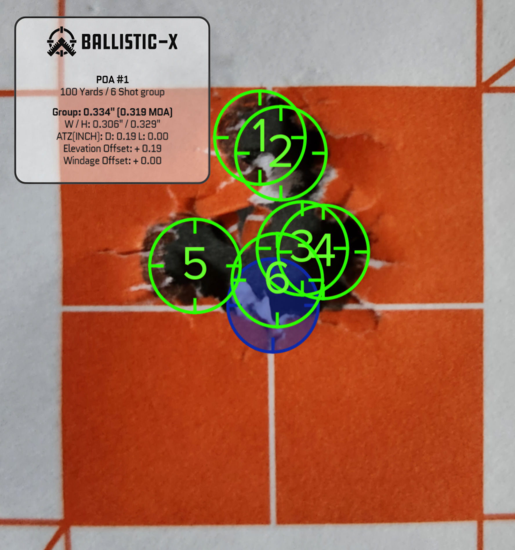

More factory 223 Rem through my PVA 223 AI barrel. This time, Norma Golden Target 69 gr HPBT, shooting 5 shots into 0.319 MOA at 100 yds and 3 shots into 0.128 MOA at 200yds. I now have ~175 pieces of fire formed brass and the barrel should be broken in. Looking forward to load development with fully-formed AI cases. Thank you @bohem for this SWEET barrel and ARC/Ted @karagias for the CDG action and Xylo chassis!
