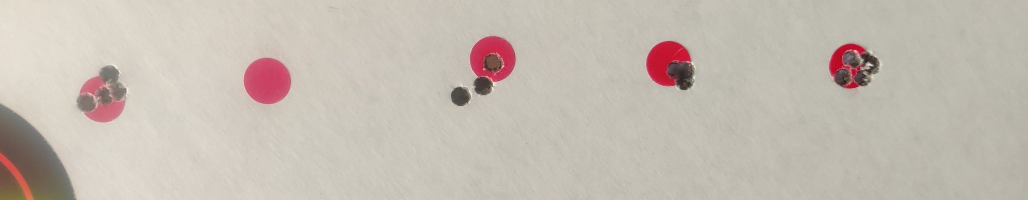

Starline fireformed brass (1F)
25.2 H4895
Fed 205m AR primers
80 grain Hornady Amax
25" 7 twist Bartlein
Neck sized
.248 Bushing
2.52 COL
2996.7 FPS 8.6 SD w / 8" Suppressor (ave of 20 shots) @44 degrees
I hope to try it out on a coyote in the very near future.
What is somewhat interesting is that with 75-80 grain bullets in 3 different platforms, 25-25.3 grains of H4895 have worked extremely well. I also have a couple boxes of 80.5 grain Bergers I want to work up a load with, and try on coyotes as well hopefully.
