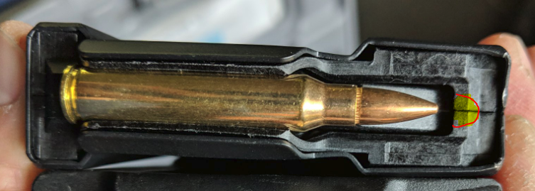

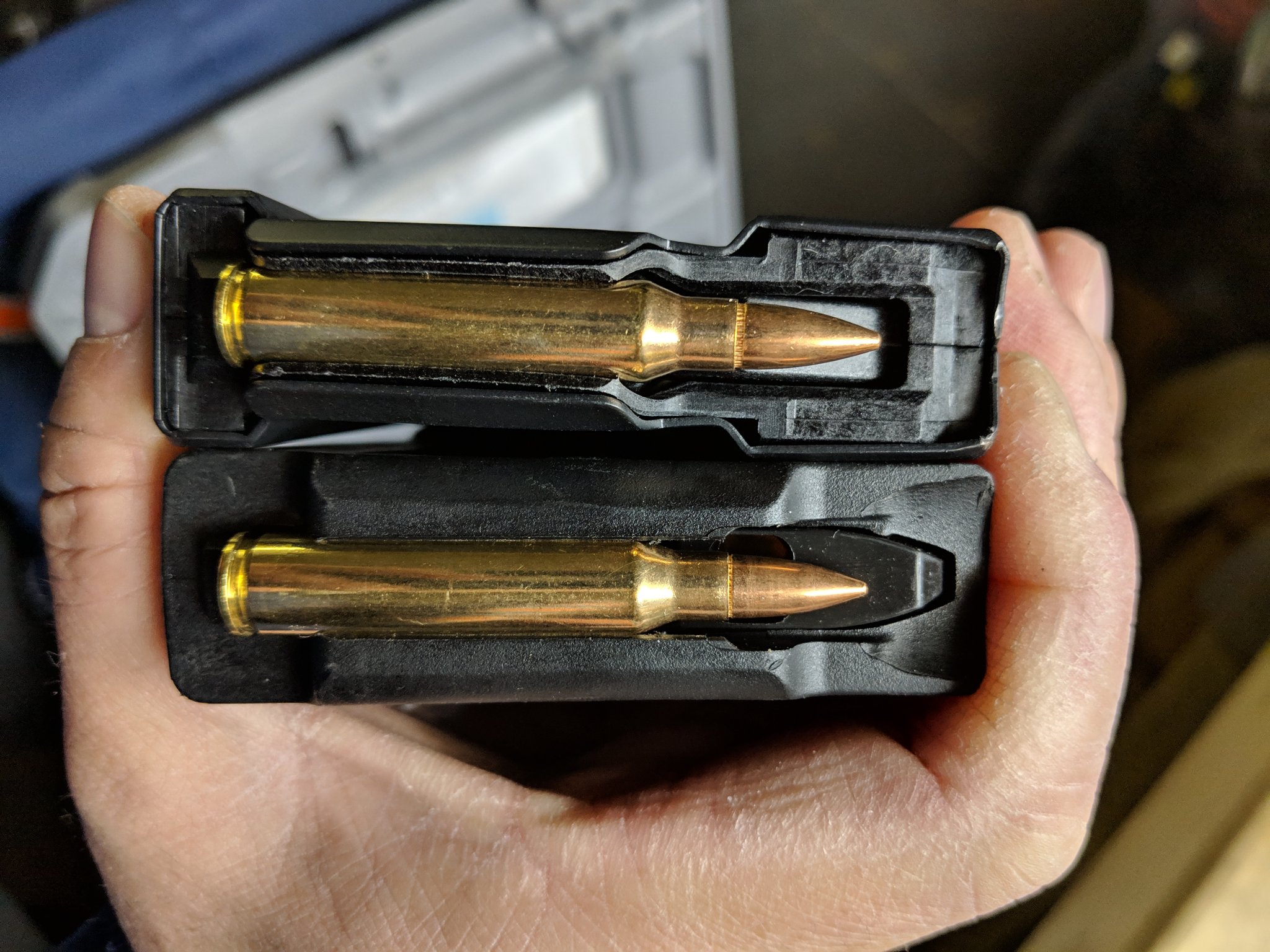

For those who interested, the Ruger mag actually has more room for longer bullets WITHOUT modification.
And my question is, how to modify Accurate mag to take longer bullets? I read somewhere that you can do something to make more room.
Top: Accurate mag
Bottom: ruger

For those who interested, the Ruger mag actually has more room for longer bullets with modification.
Top: Accurate mag
Bottom: ruger
You can take a rat tail file or a dremel and remove this material.
If you take the accurate mag apart (slide the bottom plate off, its really tight, takes a good whack with a hammer, dont bend it though) you will see that the inner liner is two halves and the top portion has has a lip that isnt there the for the rest of the mags height, file it away and you get the full length.
Top: Accurate mag
Bottom: ruger
Thanks for the post. Great info. Frustrating that both companies make mags with opposite advantages and disadvantages! You would think someone could make one that has the best of both worlds! Am I asking too much? Probably.... For $70 you shouldn’t have to modify a mag, imho.
Yeah but it does allow it work work for every action without getting caught under the feed ramp yet still allows you to open it as desired.
How pissed would you be if you bought a mag that didn’t fit because some guy wanted to push the boundaries instead?
Thanks. This is what I am looking for.
