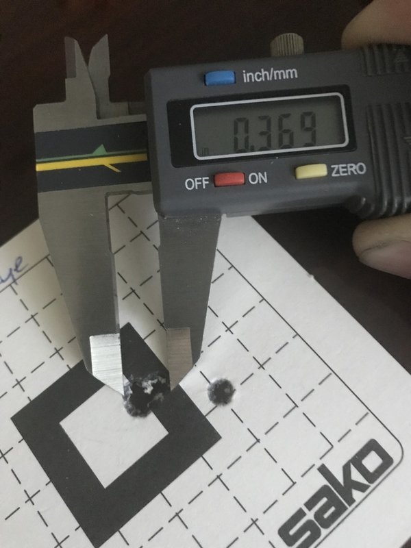

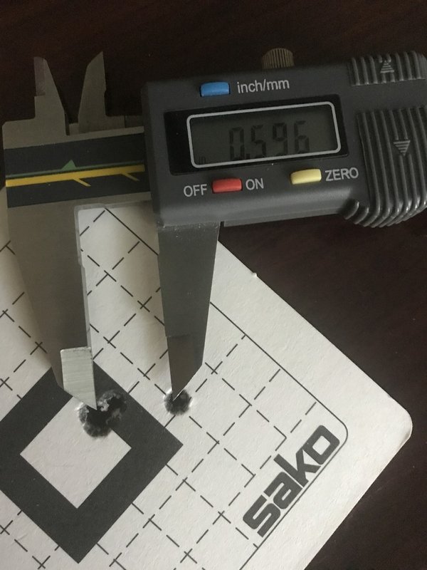

113 yards, 5 rounds
80gr Amax @ 2.45" COAL, 24.9gr Varget, Lapua virgin brass, CCI-450 (no pierced primers)
I suspect the flier wasn't the rifle, but either neck tension on the virgin brass or perhaps my driving. Either way, not too shabby. I plan to proof the load and get velocity next time out.
