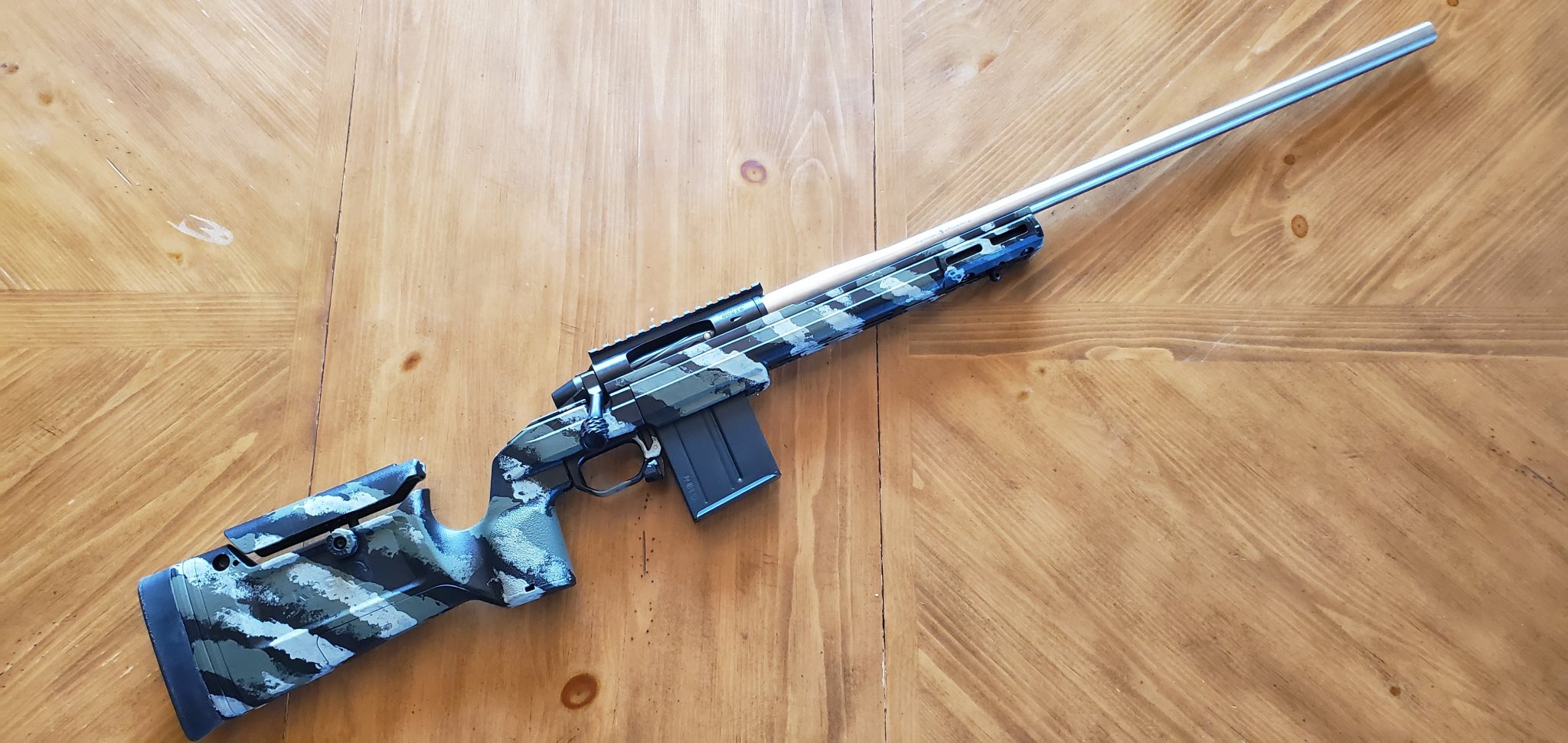

I've had my 220 Thunderbolt barrel for a little while now and I've put not quite a hundred rounds through it. I got out and shot a practice match (NRA Highpower) this morning but got pushed off the range by a thunder storm. The 220 is awesome. Such light recoil it's almost cheating for the speed and accuracy. Last year I shot an Eliseo chassis in 6mm Comp Match and I even had a 95gr reduced load for standing, the 220 is much less felt recoil with the 88gr ELD-M's going 3050 - 3100fps.
Yep, here's the update. Received both the 224 1:7 MTU blanks from Bartlein as promised to compare to the Green Mountain button barrels. The 224V I just picked up and its screwed onto one of my TL3's. It was chambered exactly like the GM with my long freebore reamer. Going to load up 50rd of the load that worked best in my GM and then I will do load development using PP2000 and 90smk to see how that does.
Here's the Bartlein 220TB, which is 90% finished, just needs the chamber put in it. Will be picking that up next week.

I just want to say, Damn! Nice selection of barrels there.
That is all.
