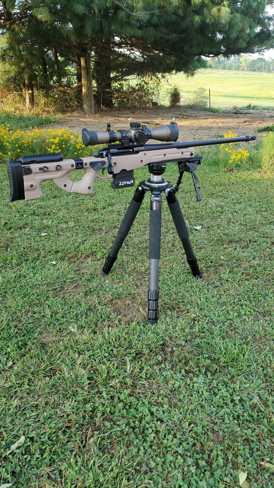

Just finished load development. Bighorn Origin, 24" 1-7 X-Caliber. Tried 85.5s first with multiple powders. Grouped well at 2725 but fell apart if I tried to push any harder. Went to 80.5 Fullbore and N550 powder. 26.7 grains got 2925 and single digit SDs. They like a .020 jump. Happy with this, just going to run it. That's 4 at 100 yards.
Reactions: Longshot231
