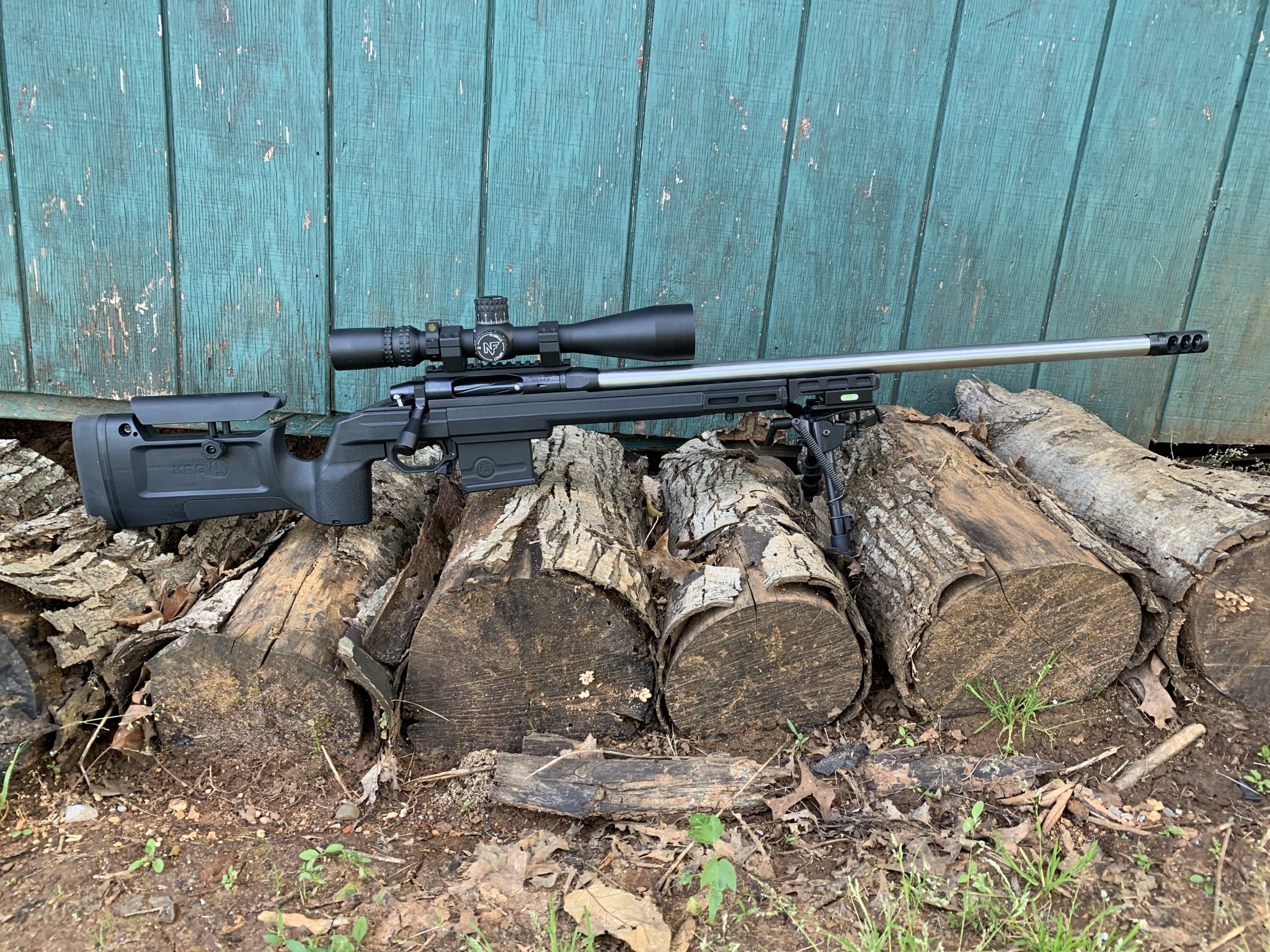

Is anyone loading for a bolt gun. Went out this weekend to find the velocity nodes for my new 24in barrel and at 25 grains of shooters world precision with a 88 eld-m I am only getting 2760 fps. Which to me seems slow but not for sure.
2760 is just about right for the 88 eldm, at least out of an AR anyway. I imagine you could go faster, but it’s not needed.
You might want to take a look at 6.5 sta-ball. Running the 88's in my 22 nosler, I got 3000 FPS from a 22 inch barrel. I'm loading long, just a bit over listed max load.
the nosler has a bit more case capacity than the valk.
Winchester list the velocity right around what your getting, pressure at 53,000 psi. You should be able to load longer than ar15 mag length, which gives you a bit more capacity.
I don't have 88eldm data for a bolt gun, but I did Chrono Berger 85.5s and saw a Max velocity around 2800 in a 26" barrel. My notes show terrible groups above 2750fps. Like 3-4+ moa.

My Valkyrie Boltgun is a 7.5-6.7 LH GT and has no drama shooting anything.
I am still not getting all these accuracy issues, I find it really hard to wrap my head around what people are doing. Granted the only handloads I have shot were Brian Whalen's but I have absolutely no drama with my JP or Boltgun shooting any factory loads from 60gr to 90gr. I tend to stick with the 88s and on the cheap the 75gr but man, I see no issues.
I even shot the old Federal load out of the Boltgun and it's working fine, I can shoot it and it holds sub-MOA. Nothing I am shooting is going over 3/4 MOA, not gasser or bolt, the bolt has been consistency 1/2 MOA.
Weird for sure

I dont have a bolt gun to compare. But I am totally confident a Valkyrie bolt gun is a thing a greatness, and I bet .3 MOA is achievable with proper tuning and good markmanship. In 224 Valkyrie, I have been "generally" shooting lights out groups for an AR with all match bullets I am able to properly tune the distance to lands. Generally with "tangent" Ogive bullets 20k to lands is lights out. <80 grain bullets like Berger OTM 77's. Being that my experience tells me near touching lands is good for VLD type bullets, I cannot do that, or even close, in the AR(80+ grains) with magazine. The 70 grain Berger's I tuned closer to lands, where lights out fine. I do not have enough experience, yet, to make conclusions, I am testing AR platform only.
I think I will chop off the end of 1 magazine, so I can load 2.245 or whatever is required to touch lands, and go back from there. I think that will teach me a lot.
