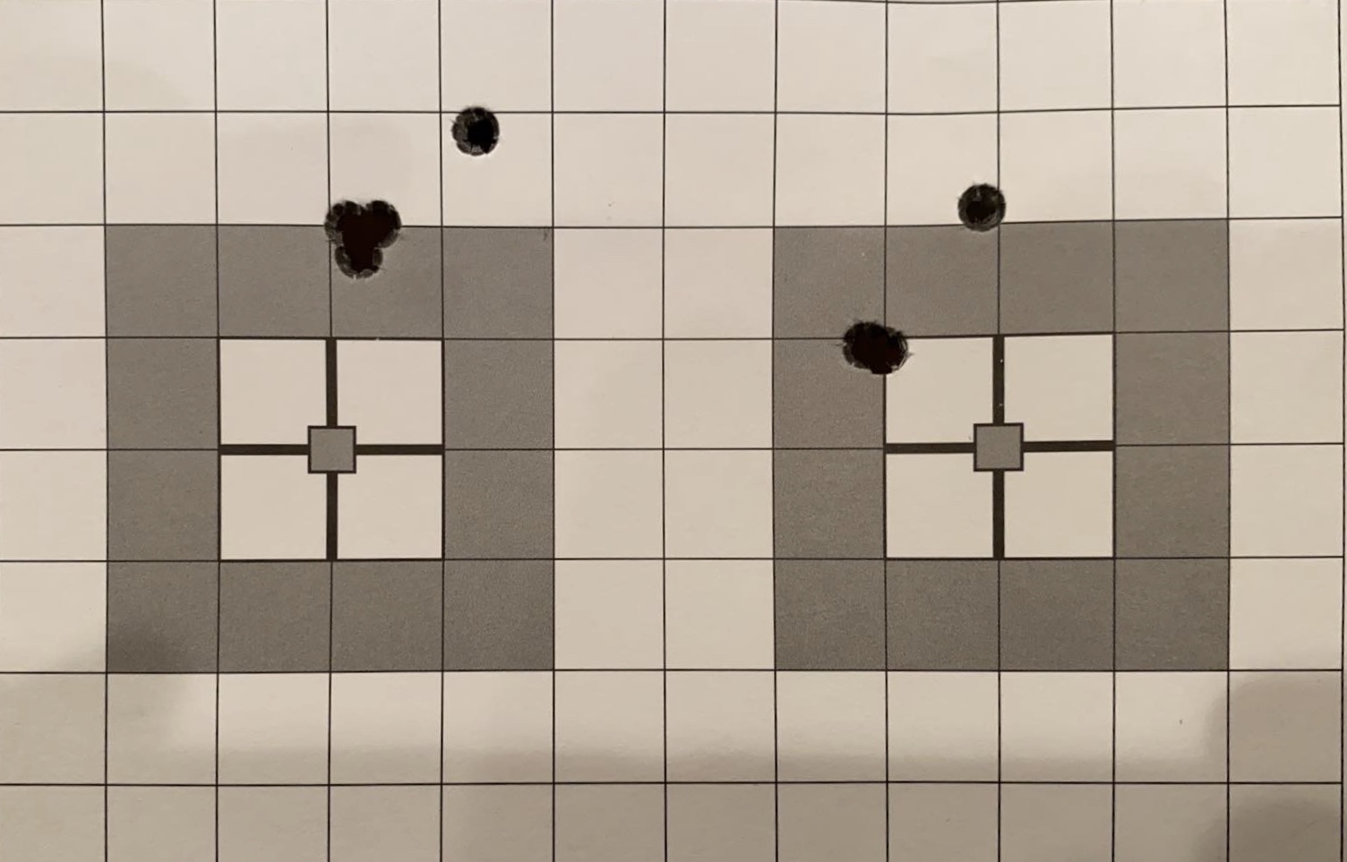

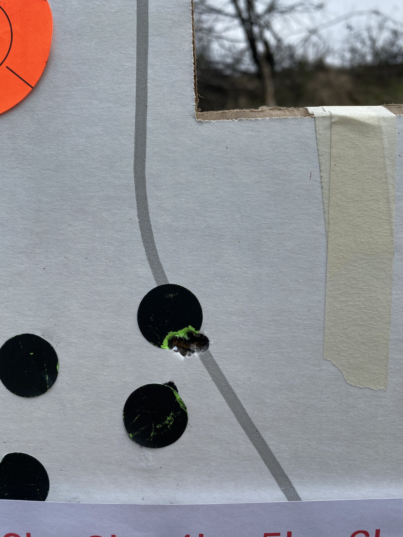

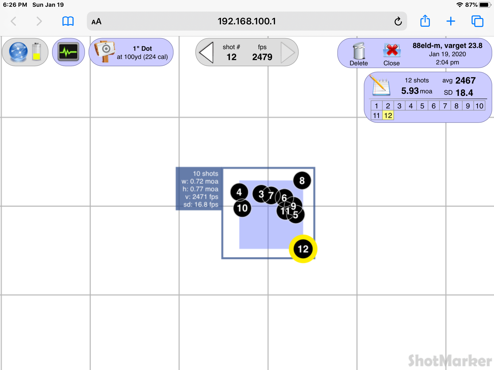

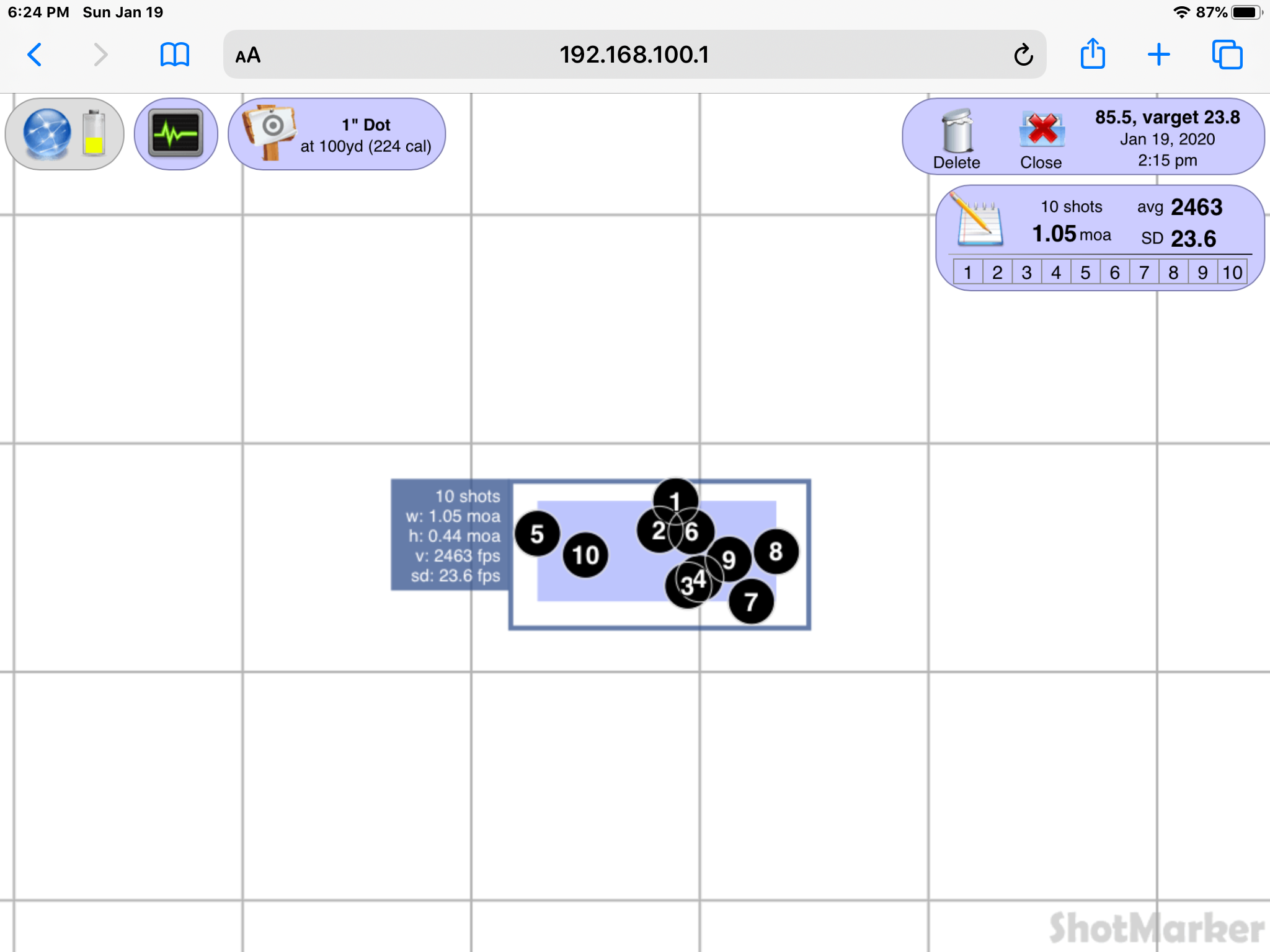

I’ve installed JP enterprises adjustable gas block, Went to the range today and shot my control ammo 88 eld-m and 85.5 Berger’s
the left picture is my control ammo (third shot is the one at 1 o’clock)
rightside picture is the Berger’s
100 yards raining and 42 degrees

10 shot group of my 88 eld-m and the berger 85.5
both loafed with 23.8 of varget

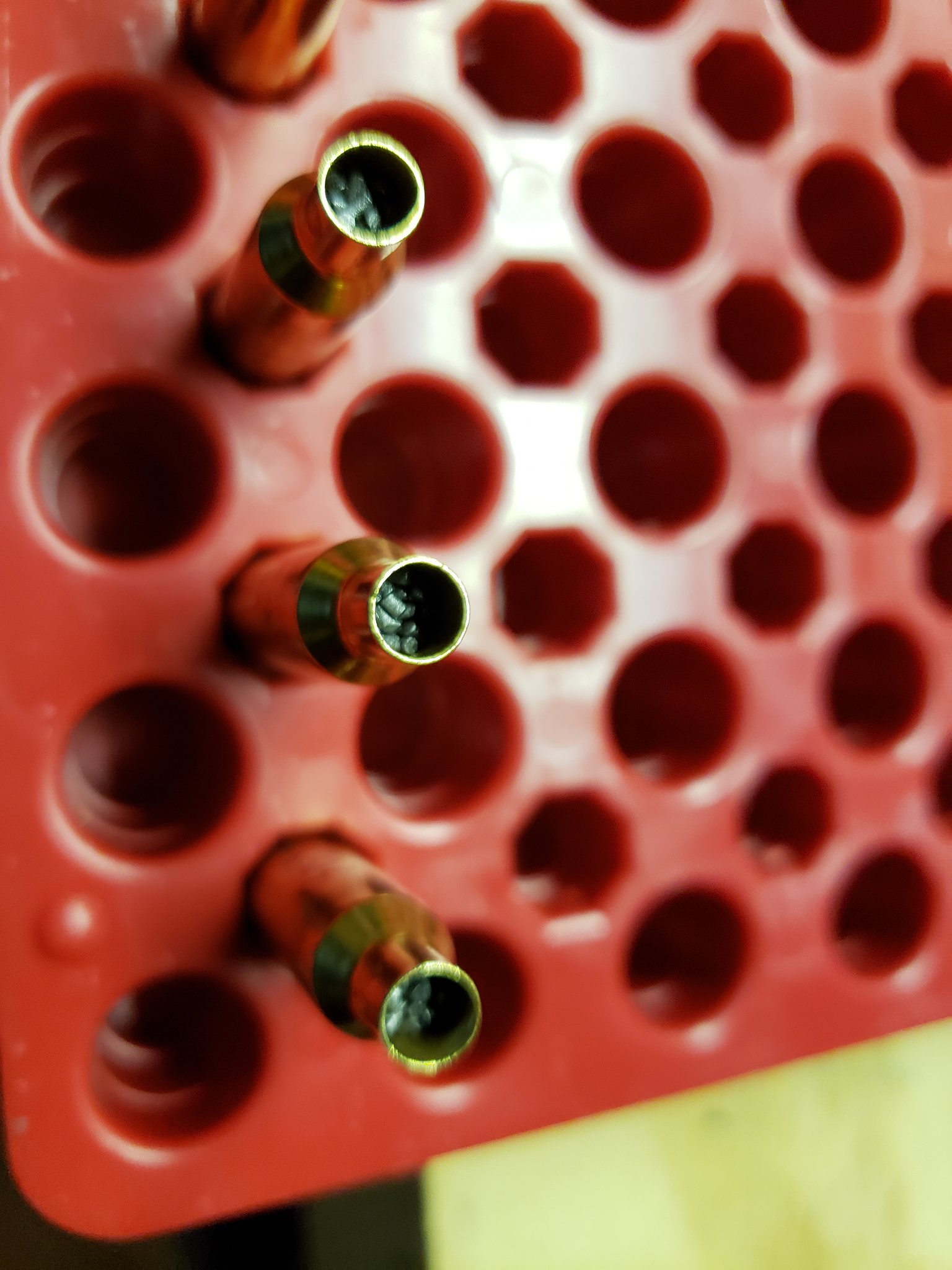

I did a test with different ages and treatment of brass since I am relatively new to this reloading thing. All Starline, I tried new, once fired and once fired annealed brass all loaded to the same specs. The best groups came from the annealed brass with the new brass coming in last place. The fired brass was shoulder bumped with a Redding body dye .002-.003” before neck sizing, which is why I think the new brass came in last. Anyone else have this same result?
The annealed brass definitely has a more consistent seating feel. I also add a little, and I mean little, bit of sizing wax to the sides of the bullet before seating. Seems to work well.
NCLR224
How are you prepping the virgin brass?
How far are the shoulders moving from virgin following the first firing?
With new cases, Starline, I run them through a neck sizing die, Redding, first ( it seems like the .224 cases seem to take a shipping hit that bangs up the necks), then I champher the inside with a VLD tool and the same to the exterior to remove burrs and shape.
The brass seems to jump about .006-.007”, based on a Hornady comparator, from virgin to first fire. I bump the cases back, when prepping fired brass, about .002-.003”, with a Redding body sizing die first, then use a bushing neck die, which is also used on the virgin cases, for necks. The bushing is the slick coat one from Redding that doesn’t need lube.

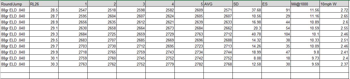

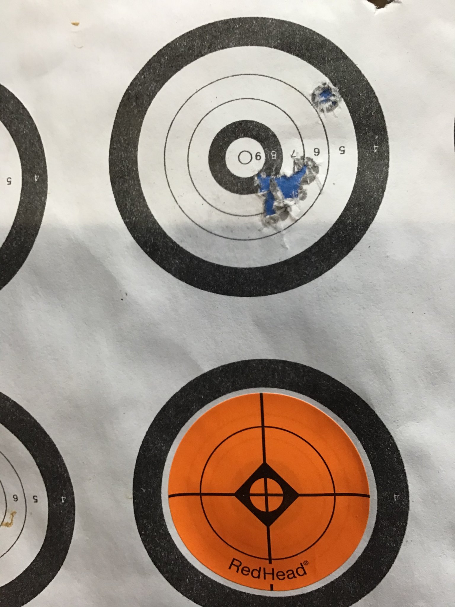

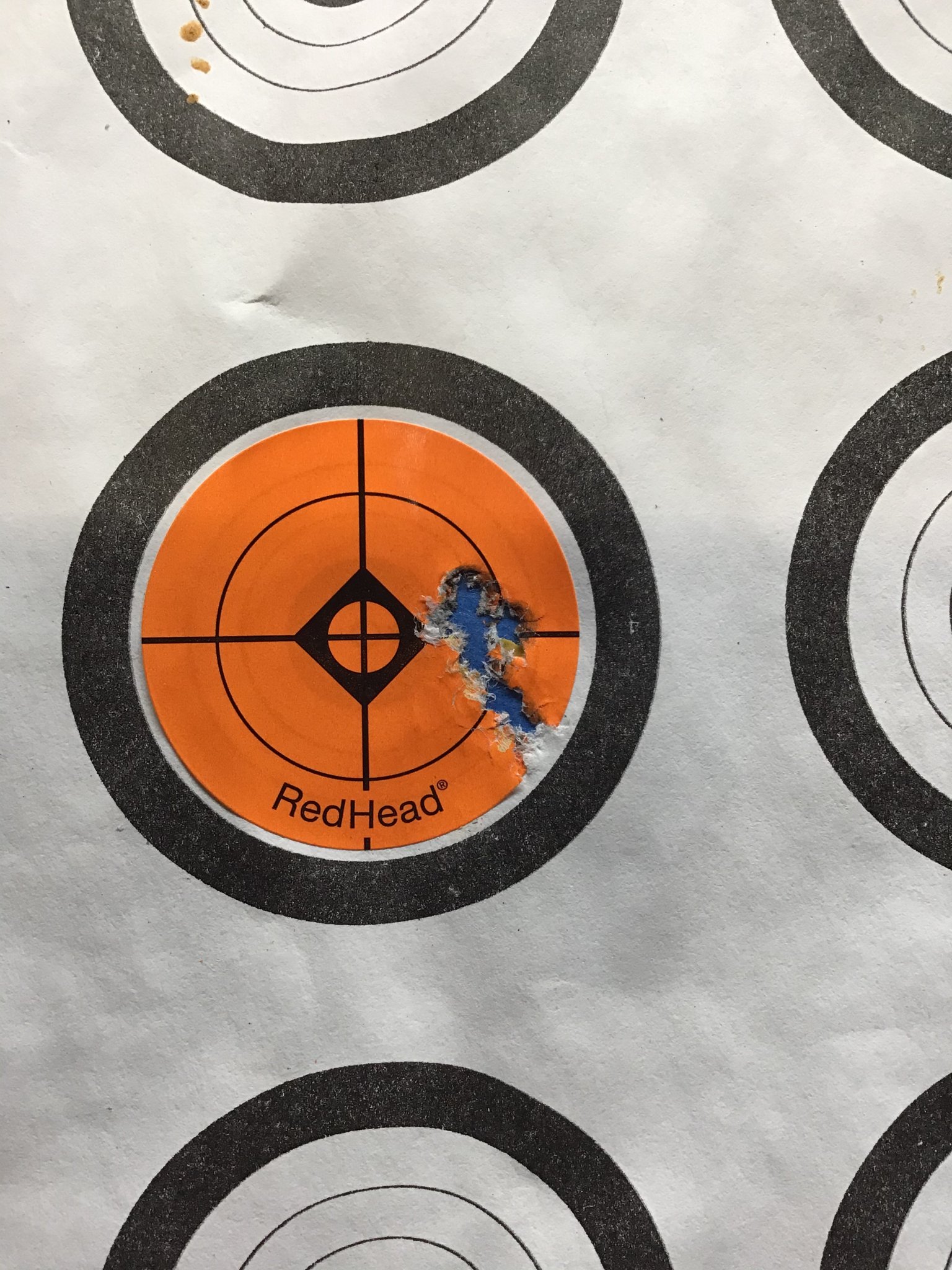

Did some initial testing with RL 26 and 88gr ELD-Ms a few weeks ago, just getting around to compiling the data what with the insanity and all (essential employee my ass...)
All rounds were 1x Fired Factory Federal Brass (75gr AE), torch annealed, with CCI Benchrest Primers. Jump on all test rounds was .040. Temp at time of shooting was roughly 45*
Rifle is a custom build, 1/6.5T 24" FAXON barrel.
Based off what I hear from some people, I was somewhat disappointed by the speed seen, however I think I may try to refine the load right around 2750. There appears to be a node there for my barrel, and while H4895 achieves similar speeds with less powder, it also has function and pressure problems in my rifle.
Even at may charge I could fit in the case, the RL26 showed no pressure signs at all. I may be able to fit more in when I buy a longer drop tube, but at this time there was no way I could fit any more powder in that case. You can see a picture of the case fill level of the max charge attached. Filling this much required the use of an electric toothbrush to even get all oof the powder out of the funnel...
Ultimately, I think I will be trying a jump test at 30.1gr and see if I can find a load that groups well with good numbers.
Right now though, most of the stores that sell reloading supplies in my area are closed (even though they were declared essential by the Governor here in Ohio, the only gun shops I know are open don't carry much in the way of reloading) so until I can get my hands on more Primers/Bullets I won't be able to do anymore testing.
Also, I think some of my powder got contaminated recently, so I may pick up a new pound of RL26 just so I can be sure I'm getting accurate results.

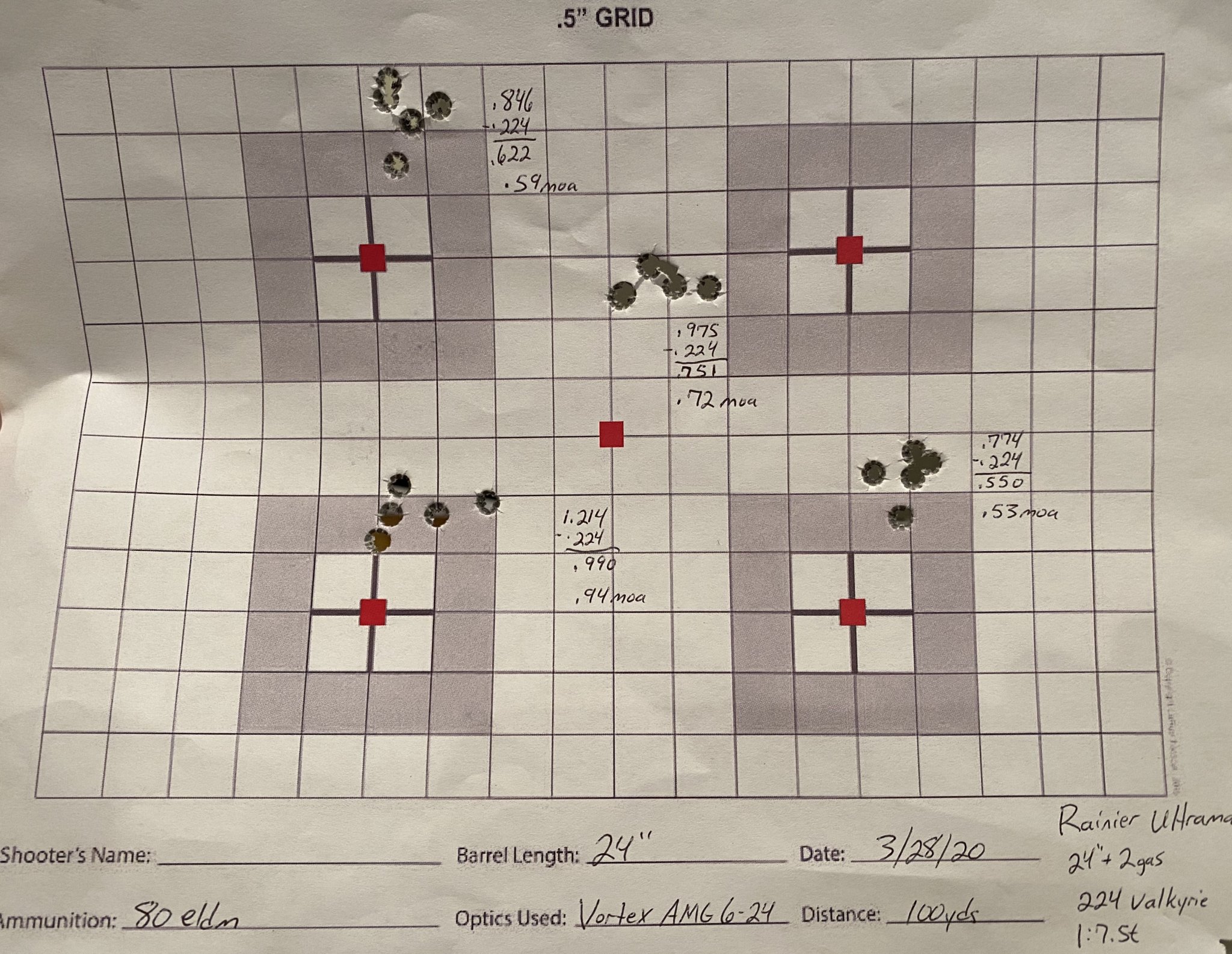

I’m still a big fan of the 80 eld’s and H4895. Initial load development with 4 different loads, 3 w/ 1x Federal brass and 1 with virgin Starline. Velocity should be in the 2950-2990fps based on running these same loads in another Rainier 24”.
The Berger 85.5’s are showing some great potential, despite the first rd going high with both loads tested.
