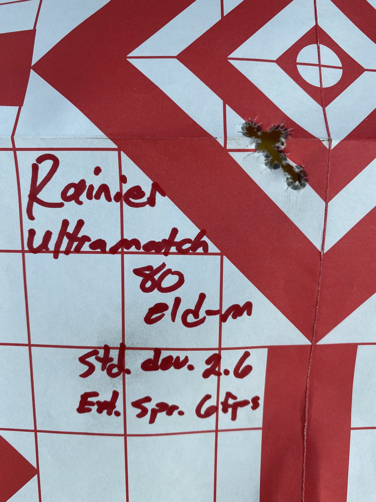

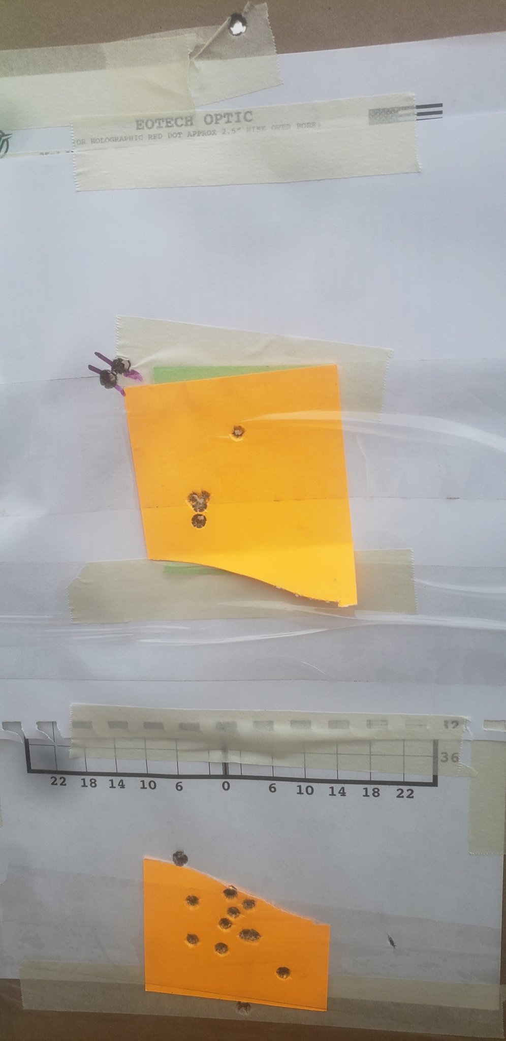

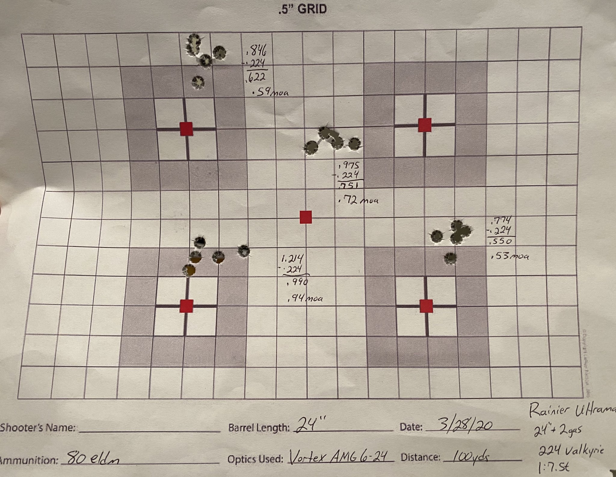

OK, 5th barrel for Valkyrie arrived. RAINIER ULTRAMATCH MOD 2 1:7.5 22" Installed it, made like 38 different loads, and went to to the club.
617c6535-6efb-4cac-9bc0-716ccbaef5e0
More
3ba468ac-072e-4d1a-ae8a-fedc54b0d358
Well, this barrel could be the best of the 5 I have installed so far. Maybe. It seems to shoot 88 grain ELD-M's just fine, so I am super curious why almost the entire market is selling 1:6.5 barrels? The more barrels I get in, the more I think 1:6.5 is a problem.
Anyway, Berger OTM 77 always do good, in every gun, every barrel, with almost any load. That bullet is very versatile. so all in all, out of maybe what? 38 groups? A little under HALF were 1 MOA or better? But this is only 5 shot groups. If I did 10 shot groups instead of like 18 or so MOA groups or better, it might be like 10?
I have about another 60 loads with this Barrel planned for within a week...so after this week, I will have data on about 100 loads through this barrel.
about 5-6 of the groups could have been better. The gas block was too light, and it caused a whole bunch of jams, which dented the crap and scratched the bullet up, some tips too. I shot it all dented, smashed tips, etc. After adjusting gas block (superlative) the recoil at 100 from the bags, was the muzzle came up maybe 6" or less off POI.
I held trigger down 2 seconds after after shot before release, and there is no I jerked a bunch of shots, because I didn't, and I didn't, every time I pulled the trigger the crosshair was within the highlighted area, with white showing on all sides. Margin of error maybe .15 MOA I would fathom to assume.
this is using a trijicon 5x50 x 56MM Accupower scope, at 50 power at 100 yards. Feels like cheating.
I like this barrel overall, its the best VALUE so far, for sure, and I like how it shoots 55 grain bullets very well, as well as up to 88 grain so far...I will test 95 grain SMK's in it soon.
This has a SAAMI chamber, I measured it. I think rainier used sound logic making a 1:7.5 Valkyrie barrel. Just guessing, but they probably got the idea from Krieger's 1:7.7 twist 5.56 barrel that was winning competitions using 80 grain bullets 10 years ago? So they figured, make it slightly faster so it could do slightly heavier? Seems good. ZERO issues with bullets coming apart or keyholing in the 1:7 and 1:7.5, but ALL the 1:6.5 barrels I tested Keyhole and destroy a "few" bullets.
Learning more and more about this cartridge. I should have done this 2 years ago. I have 3 powders backordered, then I will have every powder possible for use in Valkyrie.
So far, I see no reason to use the slow end of the powders in up to 90 grain. The middle of the road powders like VARGET, TAC, XBR8208, N140, RL15, SW Precision Rifle, Accurate 2460, seem to do just fine or better than the slowest ones.
More

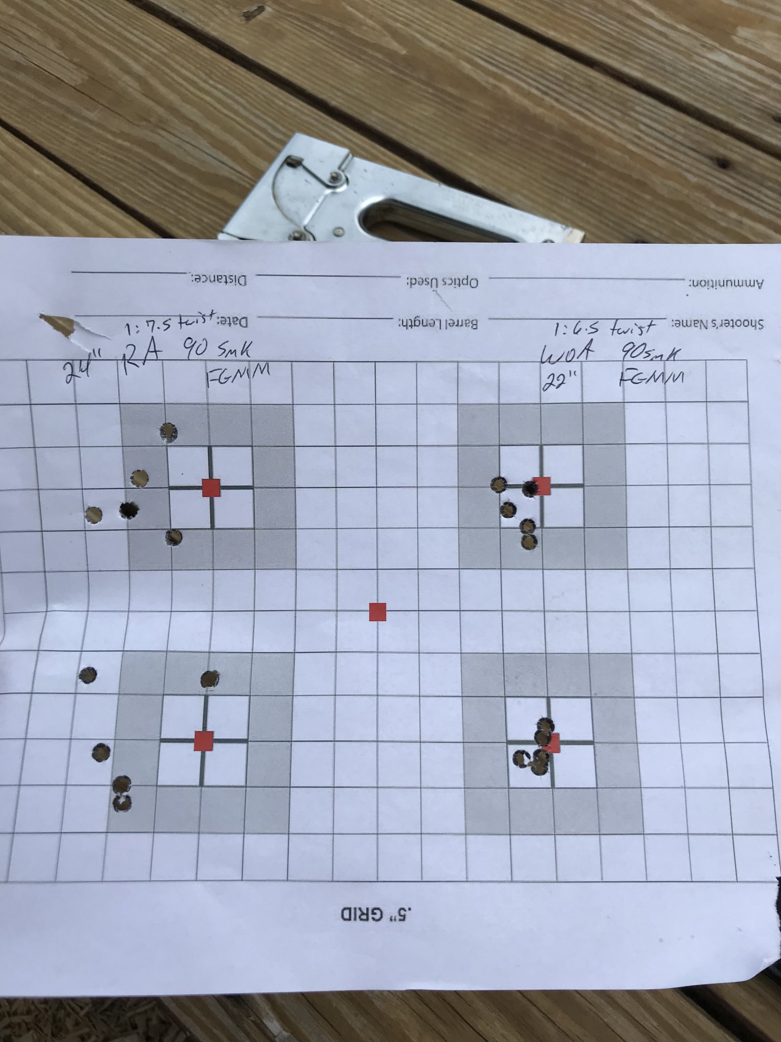

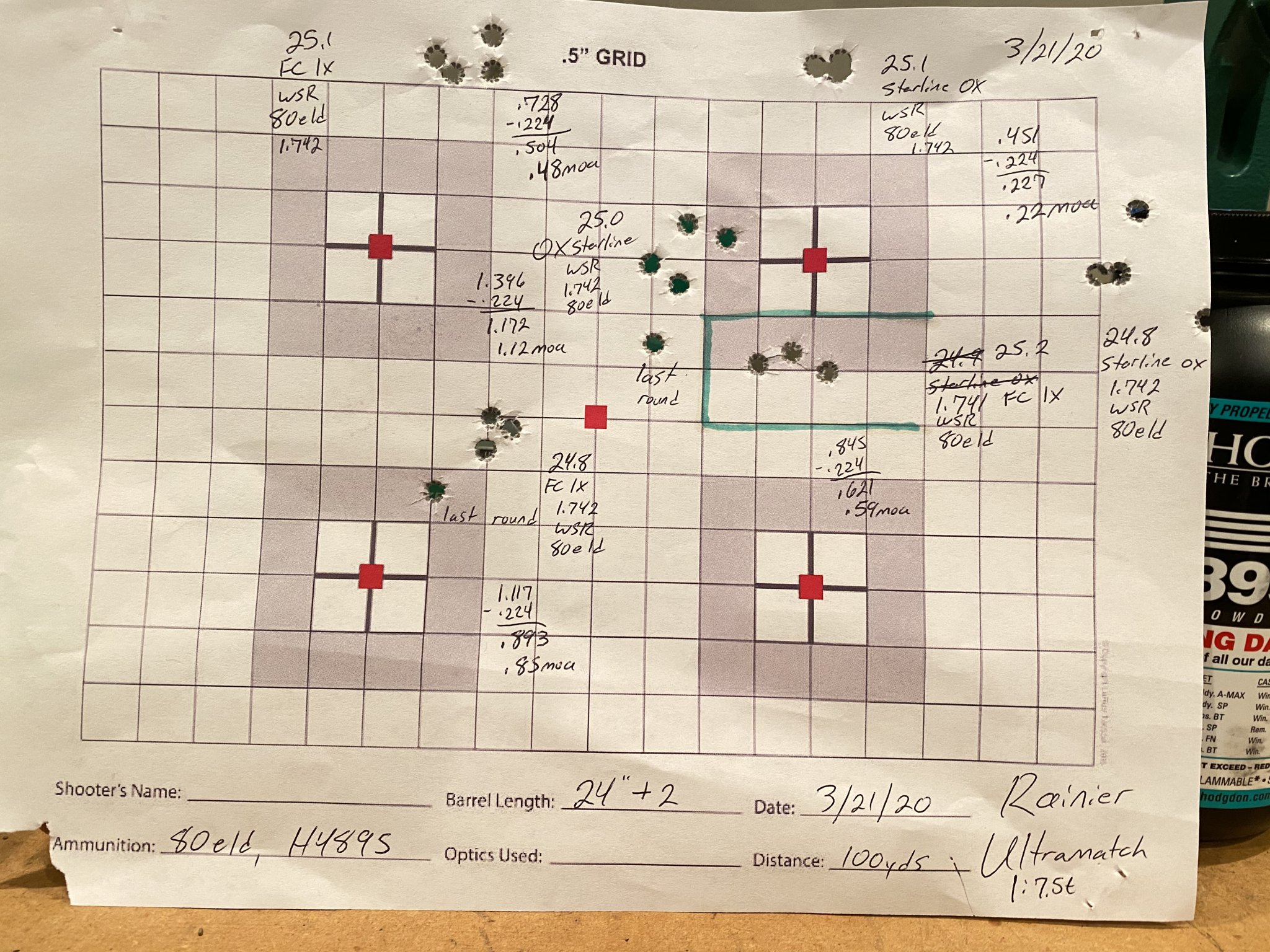

Ive been using a 20” Rainier Ultramatch Mod 2 224 Valkyrie barrel in competition this year after putting over a thousand rounds through it while testing loads
My primary load is the “red rocket” 80gr ELD with 24.8gr of H4895 and CCI BR4. I tested up to 25.2gr in the same node but accuracy wasn’t improved (Pushing this caliber too hard doesn’t seem to be ideal) and velocity wasn’t enough to justify the decrease in primer pocket life.
I’ve used: 69gr SMK/TMK, 77gr SMK/TMK, 80gr ELD, 88gr ELD, and 90gr SMK all with success using RE15, Varget, H4895, CFE223, and 2000MR. Of course not every load is a slam dunk but that’s what testing is for.
I did work my butt off finding what bullet and powder combos were the best in my rifle but once I put in the effort the results have been great.

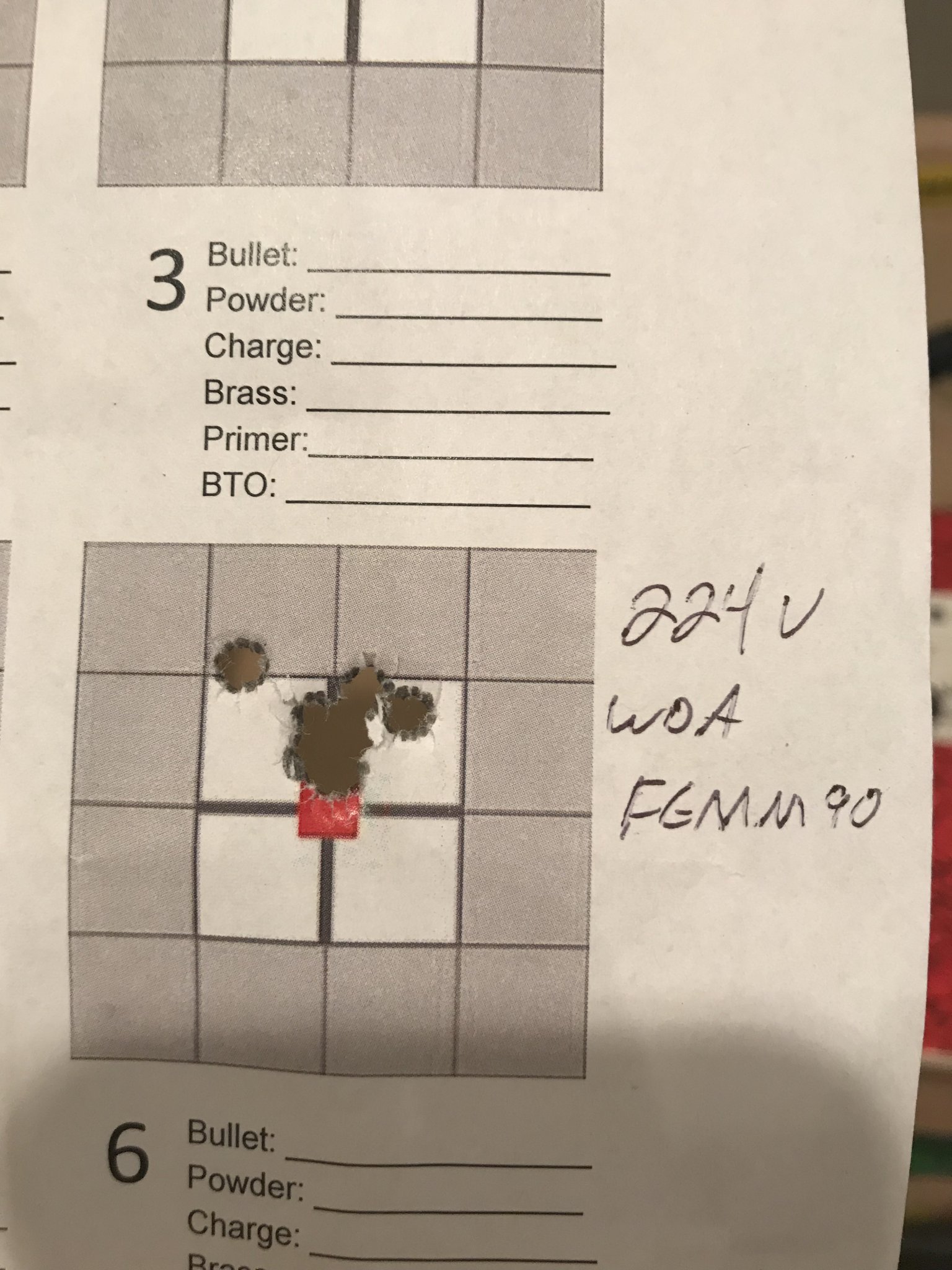

Why the 1:6.5t? It seems to work with a good chamber. I can run AE75 up to FGMM 90’s and 95smk handloads in my 1:6.5t 22” WOA. It’s actually shot several sub half moa groups, a handful of sub .3moa groups, but averages closer to 1moa with the AE75’s.
My Rainier Match hammers with 80eld’s, but the 1:7.5t doesn’t do well with the FGMM 90’s, as there was some stability issues observed. It’s solid with the FGMM 80.5’s though, which works for me. I’m still a firm believer that the 80 class bullets are the best option for this cartridge if shooting inside of 1100yds.
Load confirmation this past weekend. RA ultramatch, 24” +2, 1:7.5t
24” +2 RA Ultramatch 1:7.5, 22” RLGS WOA 1:6.5 (FGMM 90 test)
WOA 22”, 1:6.5t FGMM 90

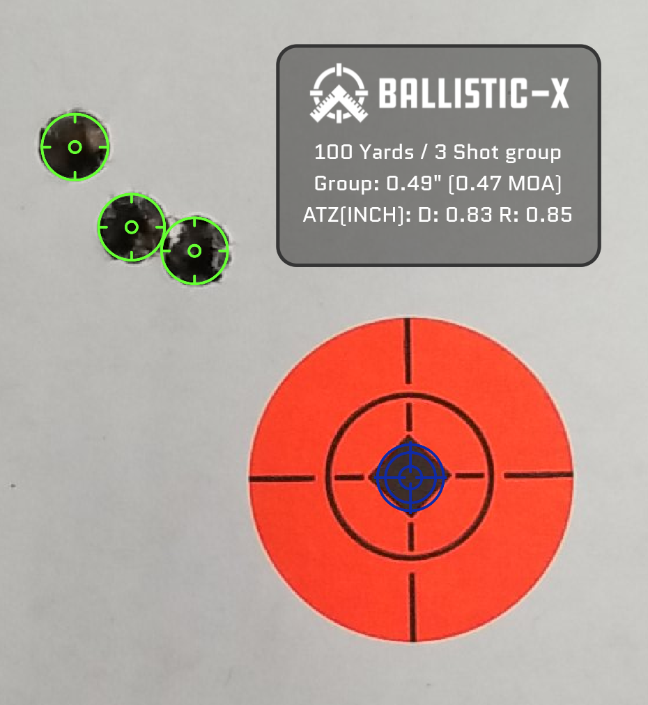

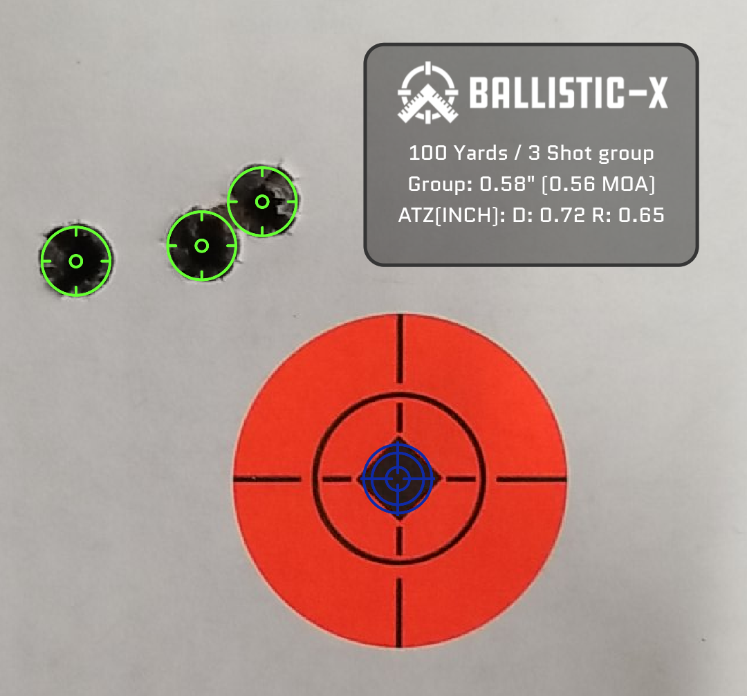

Seating depth test today with berger 85.5's. .085" jump. (2.271" COAL) 22.8 grains of AR Comp. (2610 fps) Once fired starline brass, cci 400 primers. 18" craddock precision criterion spr profile barrel. Will do charge weight test next then confirm seating depth +/- .010".
Ballistic-X-Export-2020-05-27 20:31:56.391624.png
Ballistic-X-Export-2020-05-27 20:33:25.436233.png
I had issues with the first iteration of the FGMM 90SMKs grouping around 1.25 MOA
The newer stuff hovers just under MOA but much Handloads are much much better than both

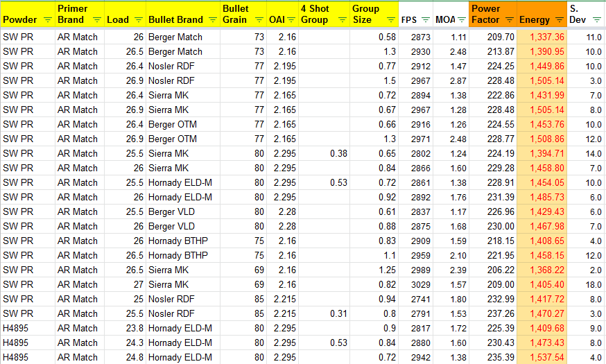

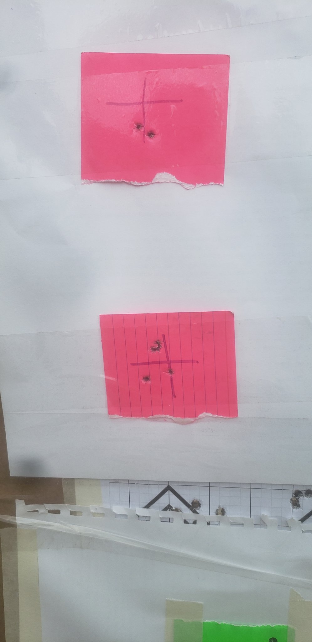

Todays results, results were at 50 yards, converted to MOA for reference. these are 5 shot strings. This is a 22" Rainier UM Mod 2 barrel. zero blown primers, or any issues shooting any of this.
PowderPrimer BrandLoadBullet BrandBullet GrainOAL4 Shot GroupGroup SizeFPSMOAPower FactorHow many bullets each stringGunDateWind1.047CommentsComments 2Energy
Big GameAR Match27.5Hornady ELD-M802.2950.7927971.51223.79Rainier 22" UM5/29/20203 MPH0.51,389.73
Big GameAR Match28Hornady ELD-M802.2950.6928211.32225.64Rainier 22" UM5/29/20203 MPH0.51,412.85
AA2520AR Match26Hornady ELD-M802.2950.6528721.24229.78Rainier 22" UM5/29/20203 MPH0.51,465.17
AA2520AR Match26.5Hornady ELD-M802.2950.829301.53234.42Rainier 22" UM5/29/20203 MPH0.51,524.94
AA2460AR Match24.5Hornady ELD-M802.2950.628531.15228.24Rainier 22" UM5/29/20203 MPH0.51,445.60
AA2460AR Match25Hornady ELD-M802.2950.5428941.03231.50Rainier 22" UM5/29/20203 MPH0.51,487.19
TACAR Match25Hornady ELD-M802.2950.20.4928430.94227.41Rainier 22" UM5/29/20203 MPH0.51,435.14
TACAR Match25.5Hornady ELD-M802.2950.628961.15231.68Rainier 22" UM5/29/20203 MPH0.51,489.50
VarmintAR Match25Hornady ELD-M802.2950.7328051.39224.37Rainier 22" UM5/29/20203 MPH0.51,397.03
VarmintAR Match25.5Hornady ELD-M802.2950.5828791.11230.35Rainier 22" UM5/29/20203 MPH0.51,472.41
W748AR Match25.5Sierra MK802.2950.2827790.53222.32Rainier 22" UM5/29/20203 MPH0.51,371.58
W748AR Match26Sierra MK802.2950.5428351.03226.82Rainier 22" UM5/29/20203 MPH0.51,427.66
XBR8208AR Match25Sierra MK802.2950.5328771.01230.13Rainier 22" UM5/29/20203 MPH0.51,469.68
AA2460AR Match25Sierra MK802.2950.230.5829131.11233.04Rainier 22" UM5/29/20203 MPH0.51,507.04
AA2520AR Match26.2Berger VLD802.2950.729061.34232.48Rainier 22" UM5/29/20203 MPH0.51,499.80
AA2460AR Match25Berger VLD802.2950.380.7728991.47231.89Rainier 22" UM5/29/20203 MPH0.51,492.24
N135AR Match23.5Berger VLD802.2950.280.4627650.88221.20Rainier 22" UM5/29/20203 MPH0.51,357.79
IMR4166AR Match24.9Sierra MK772.2950.350.6527941.24215.10Rainier 22" UM5/29/20203 MPH0.51,333.96
CFE223AR Match27Berger OTM772.2950.5228960.99222.95Rainier 22" UM5/29/20203 MPH0.51,433.15
2000-MRAR Match28Berger OTM772.2950.40.5829351.11226.03Rainier 22" UM5/29/20203 MPH0.51,472.92

Updated range information for today, decided to test SW Precision Rifle (Varget alternative) and it yielded an average of 1.7 MOA across all loads with the best being 1.1 MOA I think. The same as all the other barrels, there is pretty much 1-2 flyers that ruin good groupings. To be 100% sure, its not AR15 "first or last" shot fired, ZERO of the below groups had "any" first or last shot in the 5 shot group. All groups below are shots 2-6 of a magazine loaded with 7. Flyers all over the place, just like the other 4 barrels tested. I pulled 0 shots, rock steady rest, almost zero wind. I was aiming at a sharpie pin prick at 50 yards, using 50X magnification. This is Rainier 22 UM Mod 2, 22". Almost all the loads here with the higher load of the 2, that was over ~1475 Energy left ejector marks and/or raised burs (Slight) on the brass. Zero blown primers, or bad primer cratering. I spent a good amount of time making sure these loads were made with care, and from the decently good SD numbers, apparently they were. The SD's over ~10 had 1 shot in there that was high ES and ruined SD, otherwise, except for that 1 in the group of those, everything pretty much under 11.
I know a lot of people like H4895, but as you can see here, even if I count 4 best shots in each group, nothing is sub MOA. Next week, probably similar test with RL16, using a variety of bullets, and a retest to confirm good loads so far using this barrel.

First day at the range with the new WOA 24 inch 1:6.5 twist
Shot both 75 grain federal factory and 88 grain eld hornady, both ended up sub MOA.
Shot 10 shot groups for both accuracy (100 yards only) and velocity on magneto V3.
75 grain
Average = 2973
SD = 16.2
88 grain
Average = 2680
SD = 14.1
I put a Gen 3 lil bastard muzzle break on it also, and combined with the +2 rifle gas tube, there was no recoil at all.
Mounted a 5-25 PST GEN 2 on it and can't wait to stretch it out next week.

Hi Guys. CR_SLacker, thank you. You were right. The scope mount was the issue. I just mounted it for that page of groups above, and that is why its all 1.5-2 MOA, etc. I went back to older mount from previous group testing pages, where I did sub MOA on several groups, then I loaded up some 80.5 Berger Full Bore, and I went to 200 YARDS. Where I aced some groups, super good.

Hey guys question, Wilson combat SS that I bought one of there 20” Valkyrie barrels for to convert over for my wife to get her feet wet in the long range game eventually once the brass is piled up will reload I suppose even though factory shoots great. I have a substantial amount of 69 smk left over from the 20” 5.56 barrel that was on there and was wondering if there worth it out of the Valkyrie she will mainly be under 600yds
Worked with the WOA 24 Inch today,
Less than .50 moa all day long, it was shooting both 75 grain federal, and 88 grain hornady factory rounds.
I was surprised at 100 yards all of it was shot and the 75 grain did not have any huge poi change from the 88's.
Tried just using bipod and rear bag today and surprisingly it was very accurate, better than I expected.
